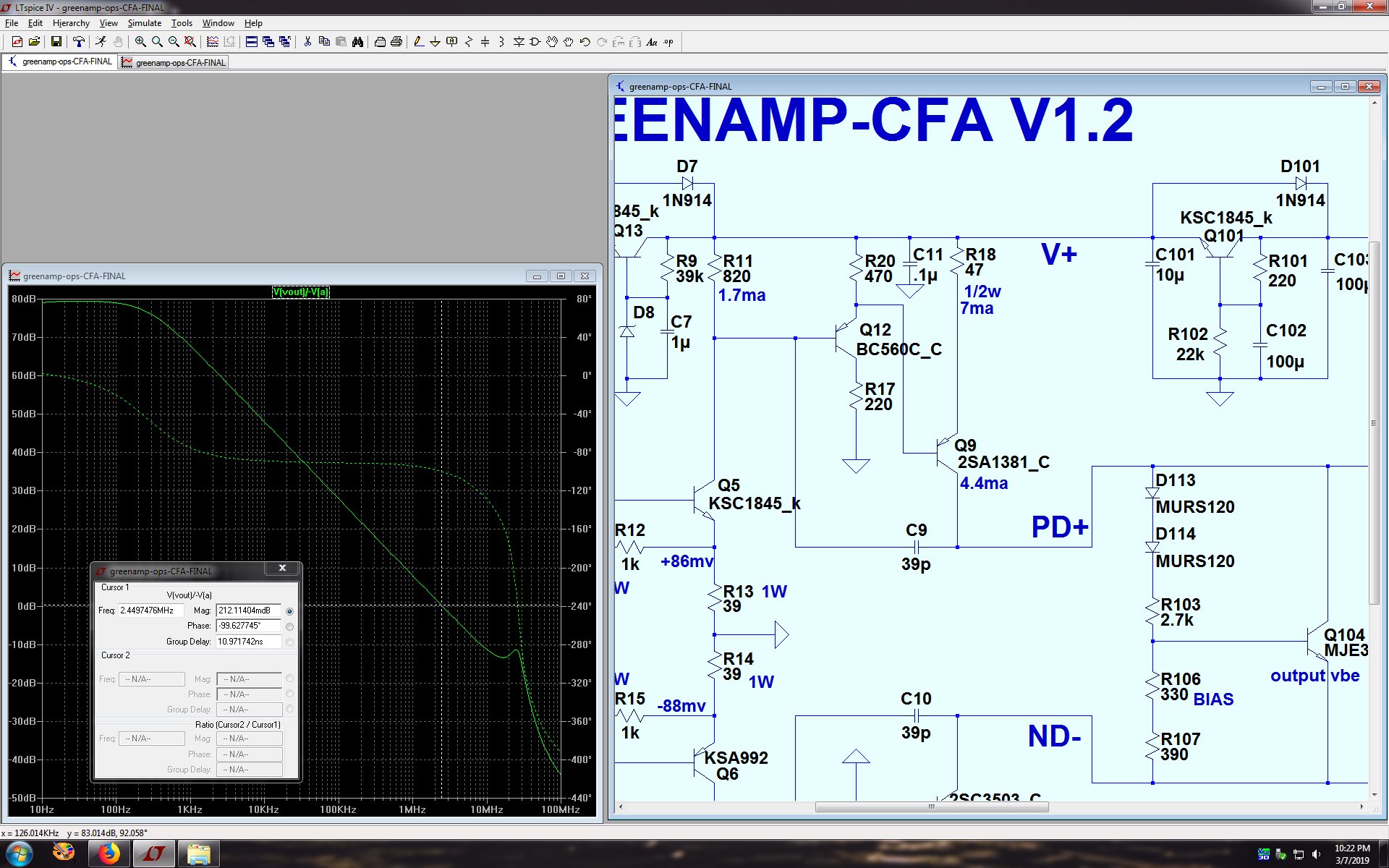

Don't say I did not try it.
The return ratio at 20K slightly suffers. (below)

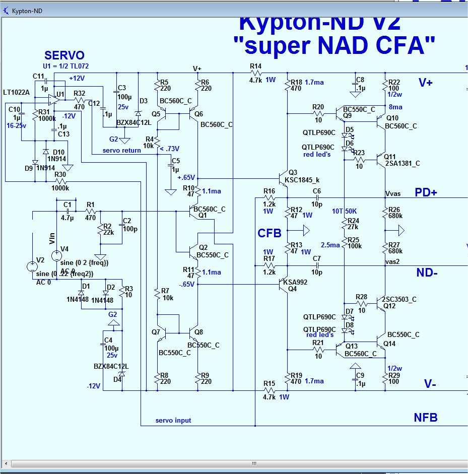

This basic IPS was actually prototyped by my friend in Greece.
We did 3 variants
1. Just a plain non-enhanced EF VAS. Good basic CFA.
2. Beta enhanced EF , the best slew rate ... nearly as good THD as the boxall.
Had to use 2 X double red led's in the CCS's to offset the VAS thermal
co-efficient.
3. Finally got to the "kypton ND" (this design-below #2). Could run it at 4.xx mA
and get the same (or better) performance than # 2 above. Slightly slower
slew rate but higher 20khz margin.
The double led's in the cascode negated the diamond / current mirror thermals.
The CM's were also the basis for the DC servo.
I used this IPS from 10C-40C , clipped it for parties ... abused it literally -
tried to blow it up.
Well thanks everyone , I have been enlightened to the 39Mhz peak and the reverse BE issue.
I'm quite confident it would be even less likely to fail in it's present form.
PS- BCxxx noise ?? I did did not hear any noise. My Greek builder had - @ < -110db noise floor
in testing. NO Jfets !! 😀😀

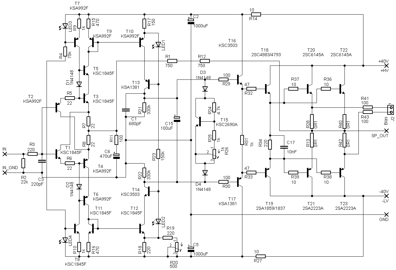

There can be a problem with the input impedance, and the DC offset. I use same input, and my amplifier dead silent with 90dB/W loudspeaker, even put your ear close to the HF driver.
Sajti
