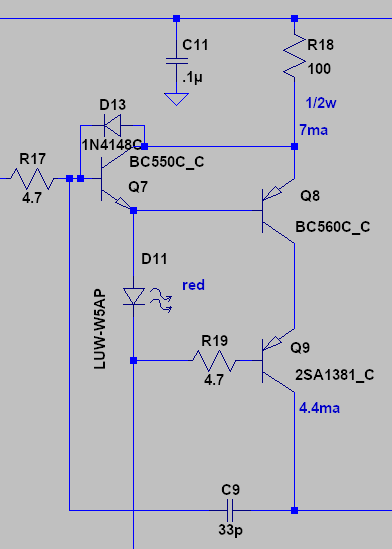

This brings me to a lot of advice that I have been given recently.
1. Bespav was right , any loading of the cascode VAS "wastes" gain.
## Corrected for this project and any slewmaster - since those 680k's were
(optional) anyways.
2. I respect the opinion of our long standing member Mr. Zan , but why do
NONE of the OEM's ground the predriver Ccb shunt ?? They ALL shunt to the rails.
3. Overload of the greenamp CFA. I have built /tested (as have others) ...
NO killing of this design - I do see that reverse BE issue , but only at 2X
clipping level (3+ volts).
Even here, the uA is not enough for heating (or punch-through) of the semi junction.
Worst case , with a 10V p-p preamp out overloading this amp , 20V reverse BE.
This might be bad ... but to what level do we make something "idiotproof".
My simulation of many OEM's shows even worse behavior on "gross" overload
- as do many of the present designs here at DIYA.

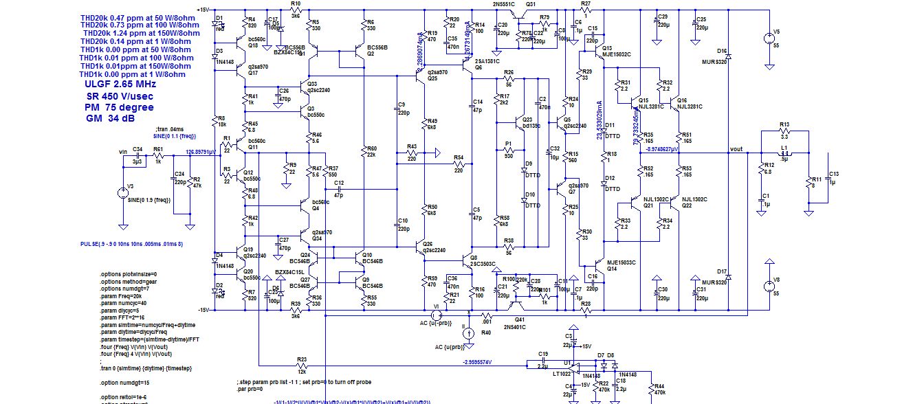

What about triple OPS CFA with active IPS load and IOTPC (output inclusive two pole compensation). I never built it, to many amps.😀
Best wishes OS with your green amp
Damir

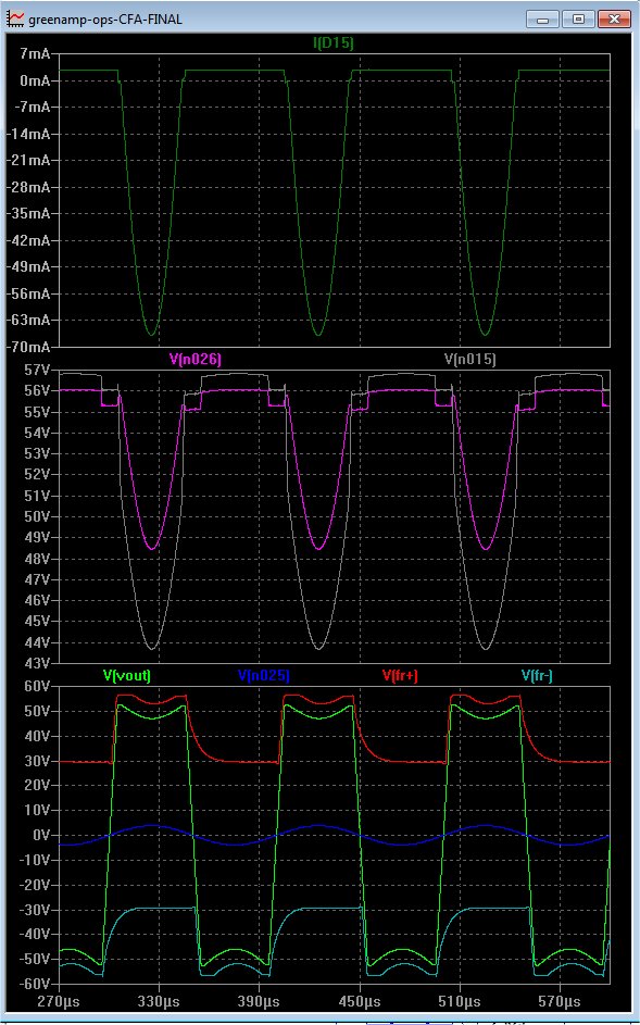

Rail switcher ?? Class G.
Just a position swap of the SiC diode and the omission of a few un-needed
components make for class G "rail-switcher".
I will add the (D-PAC SMD) pads on the OPS PCB to allow this.
I notice that in class G mode I get that 1K >.05% THD , just like the OEM's.
H is better , more SOA and efficiency.
I like this on a project , greenamp will accept any input stage AND
allow AB/H/or G. Fun for all !! This is how I layout the board.
PS - I could even make it LATERAL compatible ! I did this on the slewmaster
by allowing the predrivers to be omitted.
OS
Damir
Questions ??
1. Why , with 47pf shunts of the VAS/predrivers , do you need to also shunt the main drivers with 220pF (C15/16) ?
2. I LOVE Q33/Q34 , cascoding the "current pair".
3. With 5.6/6.8R degeneration, only at 2.65Mhz UG ?
Greenamp will be at 2.5Mhz with 22pf millers and 22 Re .
(33pF and 33Re is >2Mhz).
PS - notice the same redundant values in greenamp - easy sourcing !!
I still want to keep parts count down. I know transistors are cheap,
but builders will gravitate to simple designs. Why APEX has the most
builds. If I added IOTPC to the IPS/OPS , some would consider it
"complicated". An older class G/H thread here at DIYA discussed this
as a drawback to the technology. 🙁
Possibly because with RC filters for the frontend rails, there was no significant improvement in distortion (depending on the specific design). I think the best way to handle this would be to have decoupling capacitors right at the predriver collectors, and move the 47pF caps to the ground side of the decoupling. That way you don't increase the loop distance between the base and collector through the capacitors. But unless there is a real benefit, save your energy for things that do matter.
Cross purposes?

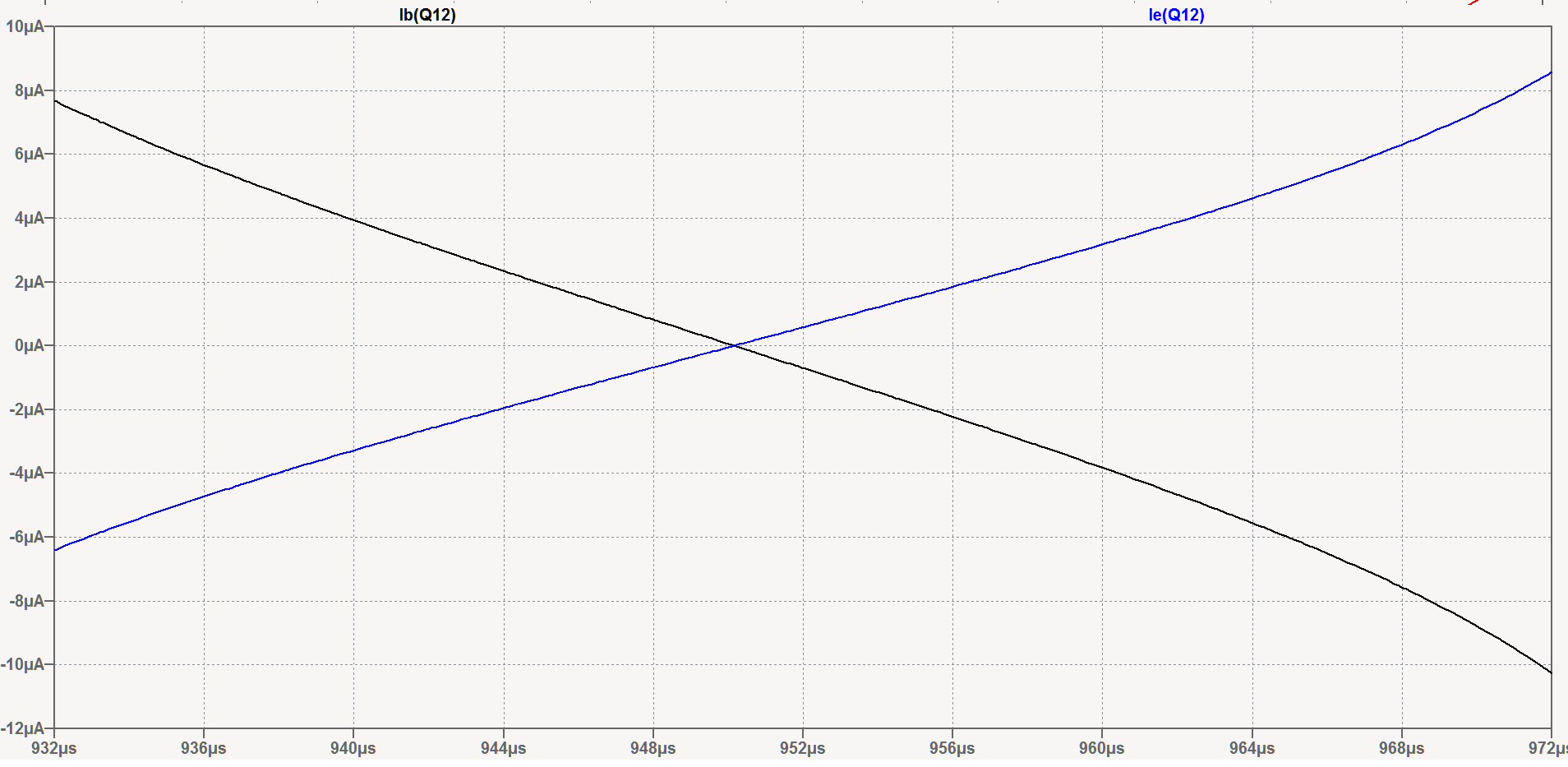

I see what you mean - Q7 reverse EB breakdown is approached at VERY
high overload.
But I noticed that Q7 emitter current falls to absolute Zero when this occurs.
The BC550C reverse V breakdown is 5V at 10 uA , we have 0 .
This is why it survives in real life.
What we have is a solution without a problem that becomes an ineffective solution
if the added diode leakage current is greater than the EB leakage current.
Still , this is far better than the beta enhanced EF phenomena.
OS

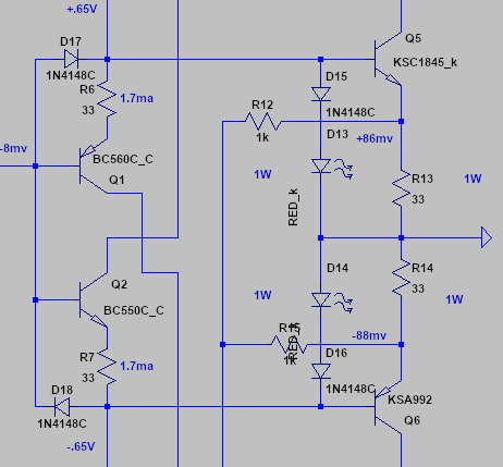

Hi OS thank you for your courteous, well considered and dilligent response. Much appreciated.
Firstly, the image covers base emitter currents only beyond the 6 volt abs max threshold. I can't recall the proper smooth function but it is likely non linear and in all probability very individual device specific. So 10ua at 6 volts could well be far lower at 10v and even lower again for the next sample.
Secondly, a brief caveat about data sheets. Where; what you read, can be much less important than what wasn't included.
Thirdly, just a comment from memory which, as I am looking back to over 40 years ago, may now well be failing with age.
There are probably at least two major phenomenon to consider. The first is, as above, at the junction.
The other is in the central region of the emitter land(s) where these really very small currents can get damagingly intense. With increasing e-field strength, charge becomes localised to tiny groups of just a few atoms where it is then sufficiently concentrated to cause one lattice disruption after another and so on. This can happen not only from implantation/diffusion irregularities but also through clean room/process contaminants.
These and some other causes can leave the device still operational. But only around the periphery of its emitter. In all likelyhood, after this, some aspects of its performance may be at best marginal against its original condition.
Unless memory fails, back then in the dark ages, the chief culprit for this 'pepperpotting' was eventually identified as Iron. But it will, in any event of these bias conditions, still happen due to ordinary lattice field variations.
My take away from all this is:
Down at that scale; its much more to do with the voltages than currents; of which, any are probably enough to do some damage.
Finally though, a happy conclusion, because I can't imagine a better job for a transistor that could well have endured such treatment than the light duties of first in a super pair.
Good luck and success with the project.
cheers, ian

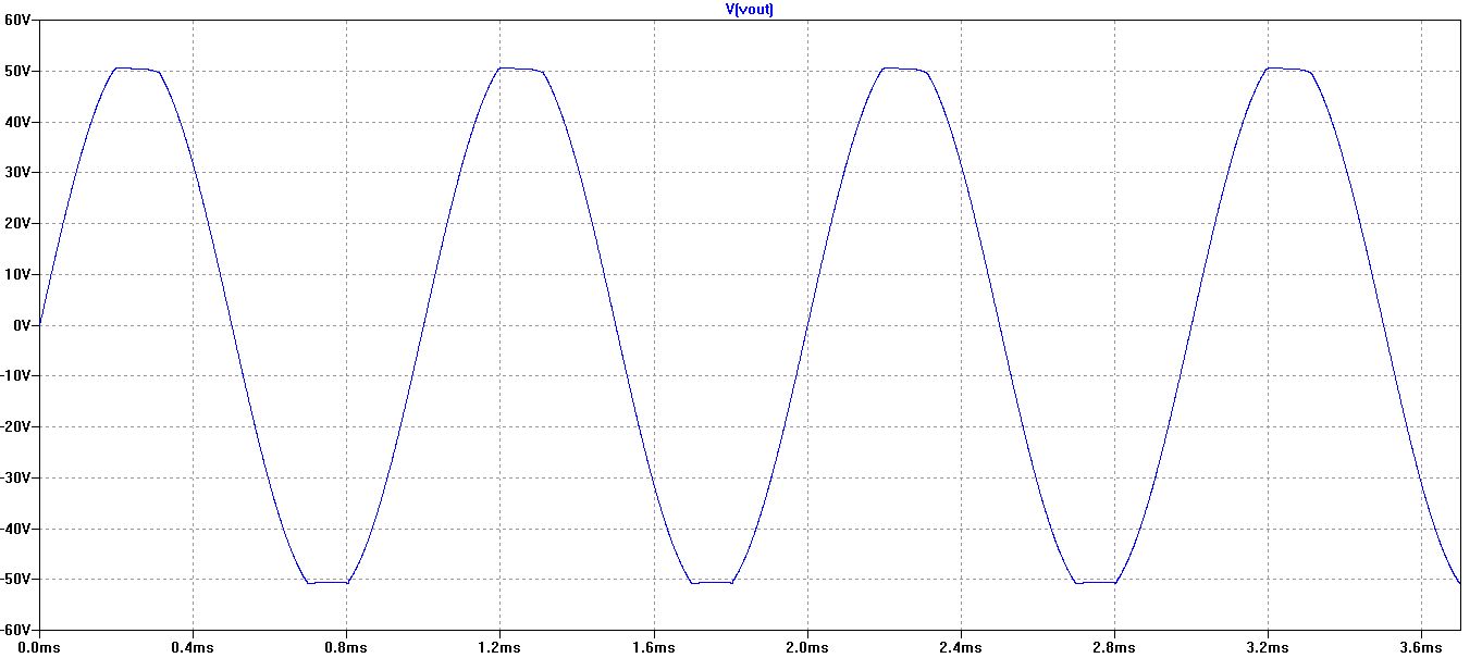

I was told that a transistor degraded from reverse BE could be recovered using a forward BE current large enough to heat up the junction.
The SPICE models don't have reverse BE breakdown. The emitter with reverse voltage behaves something like a 5V zener diode, so once BVeb is exceeded the reverse current will be as high as the preceeding stage can sink.
On clipping the Veb of the Boxall drivers goes to 70V. In real life the BE junction would enter reverse breakdown.
A 1N4148 across the BC of the Boxall drivers would probably be enough to prevent degradation. This is pretty much the same as Logician's solution in his schematic. No penalty to THD.
With this I think it's more likely the Diamond follower will self-destruct before the Boxall drivers are degraded. So then the question is how often does this occur in the field?
So , no avalanche in the models.
A way around this is to "jury rig" a reverse 4.7V zener to see. OOh , 65ma @ 4V global input.. Not good. (below - D15 is the zener).
Keen , show (the "Boxall" - you got it right !) which BC (Q7-8)?
Might we limit the input to the diamond ? This effect does not occur until
input is >3V (6Vp-p) ?
PS - "in the field" , they are more likely to place a wrong servo op-amp or
use EBC instead of BCE when assembling. Or , reverse a zener. I have
seen it all , but they have not exploded into fire. Maybe a OPS stuck to a rail ! 😀
Edit - I see , Keen. Was not logged on.
OS

Some LEDs can be used to limit Diamond current. Of course once you start looking for clipping faults, you find them everywhere. The LEDs need a series diode to prevent them from going into reverse breakdown (maybe this is okay if they are more durable than BJTs). The Diamond drivers need B-E protection diodes as well, because when the LEDs start conducting the drivers then become reverse BE driven.
