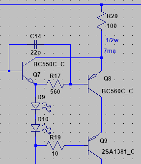

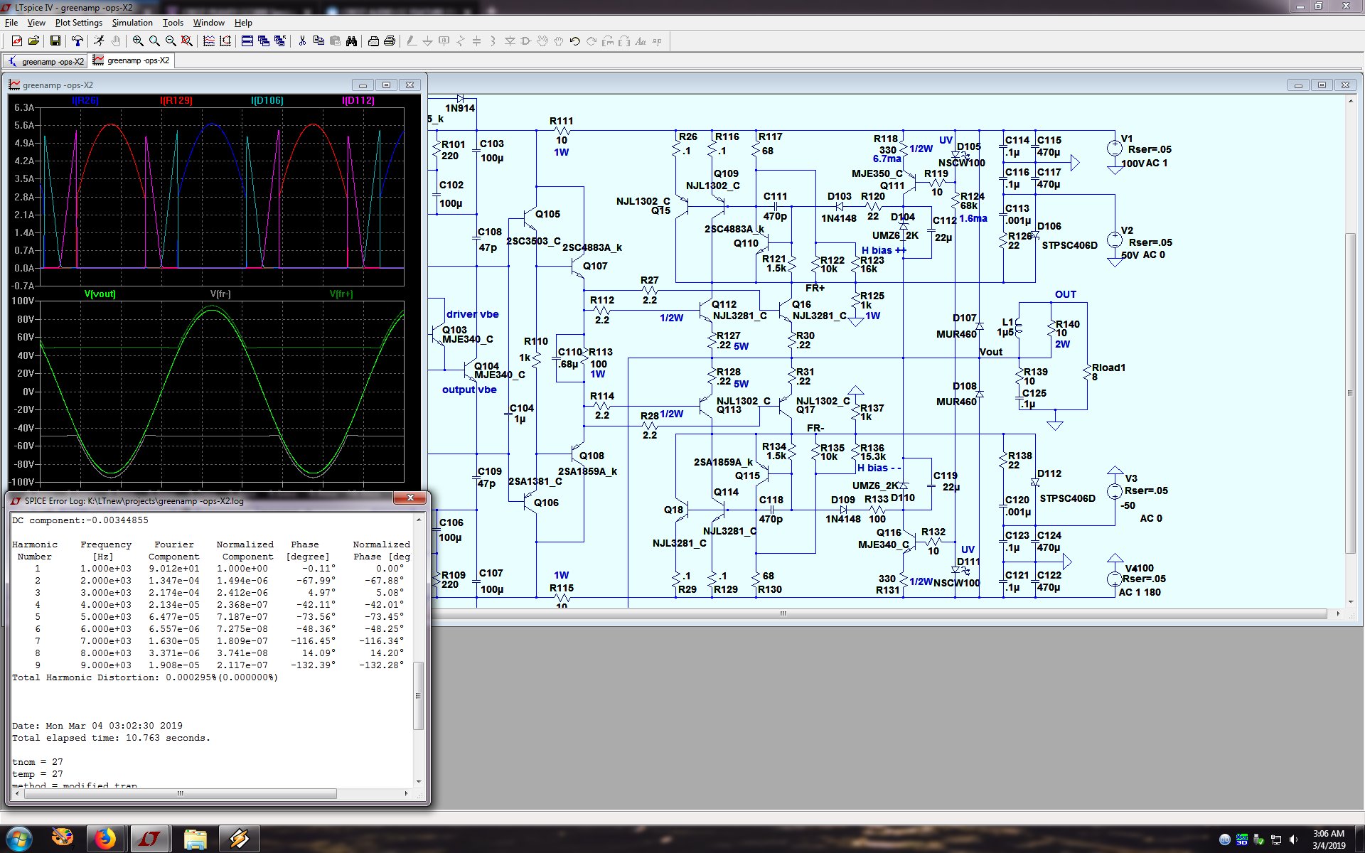

This seems to work pretty well. It reduces base recirculation at the problematic frequencies at the same time as it provides a constructive path for drive current for Q8, salvaging the most gain and bandwidth. Base recirculation of the cascode is not hindered either. I think this is close to optimal.

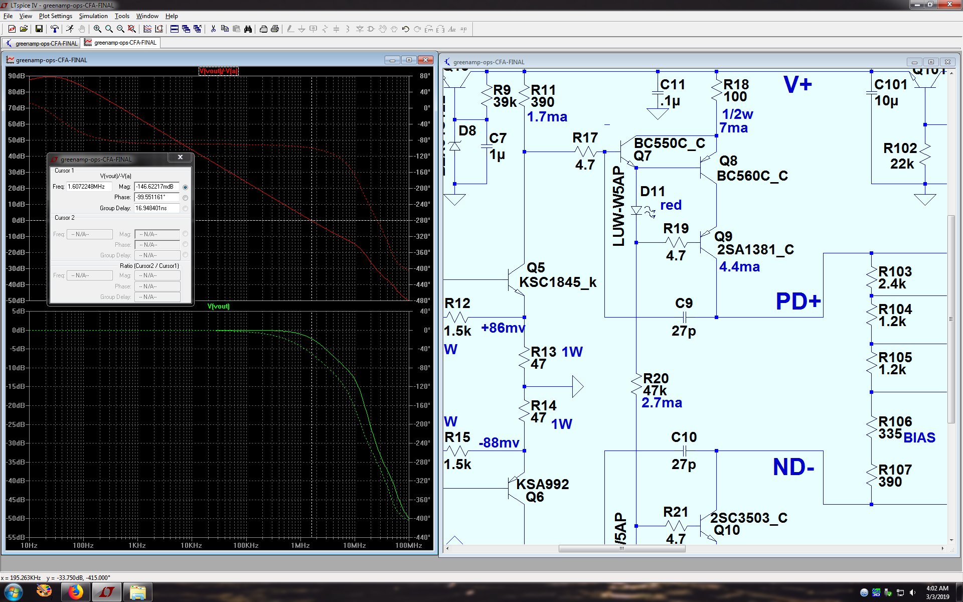

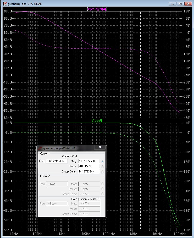

Attack the SP directly !!
Works with the Bode , 39Mhz hump is gone. (below 1)
Lowers unity gain - no problem. More margin.
Will play with it.
OS
Original was direct lead compensation from the current FB.
Here I try a simple miller wrapped around the SP/cascode.
Same result.(below 1). No "hump" at 39Mhz.

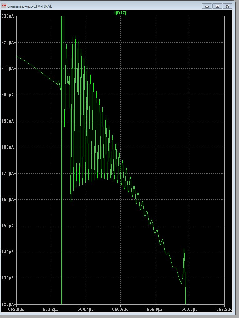

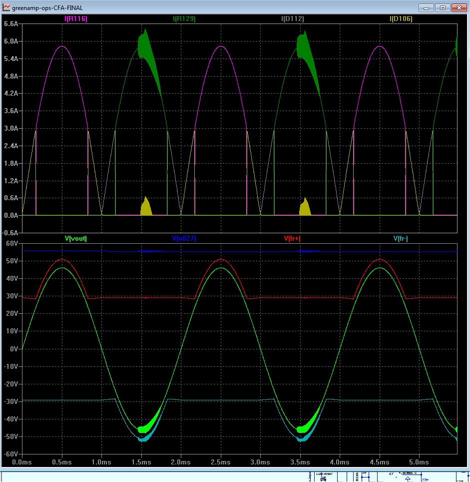

When excited by the schottky "glitches" , your method produced a less
damped result than now . Still , a hard clip affects the super-pair. At the
output , it still looks nice and rounded. (below 2)

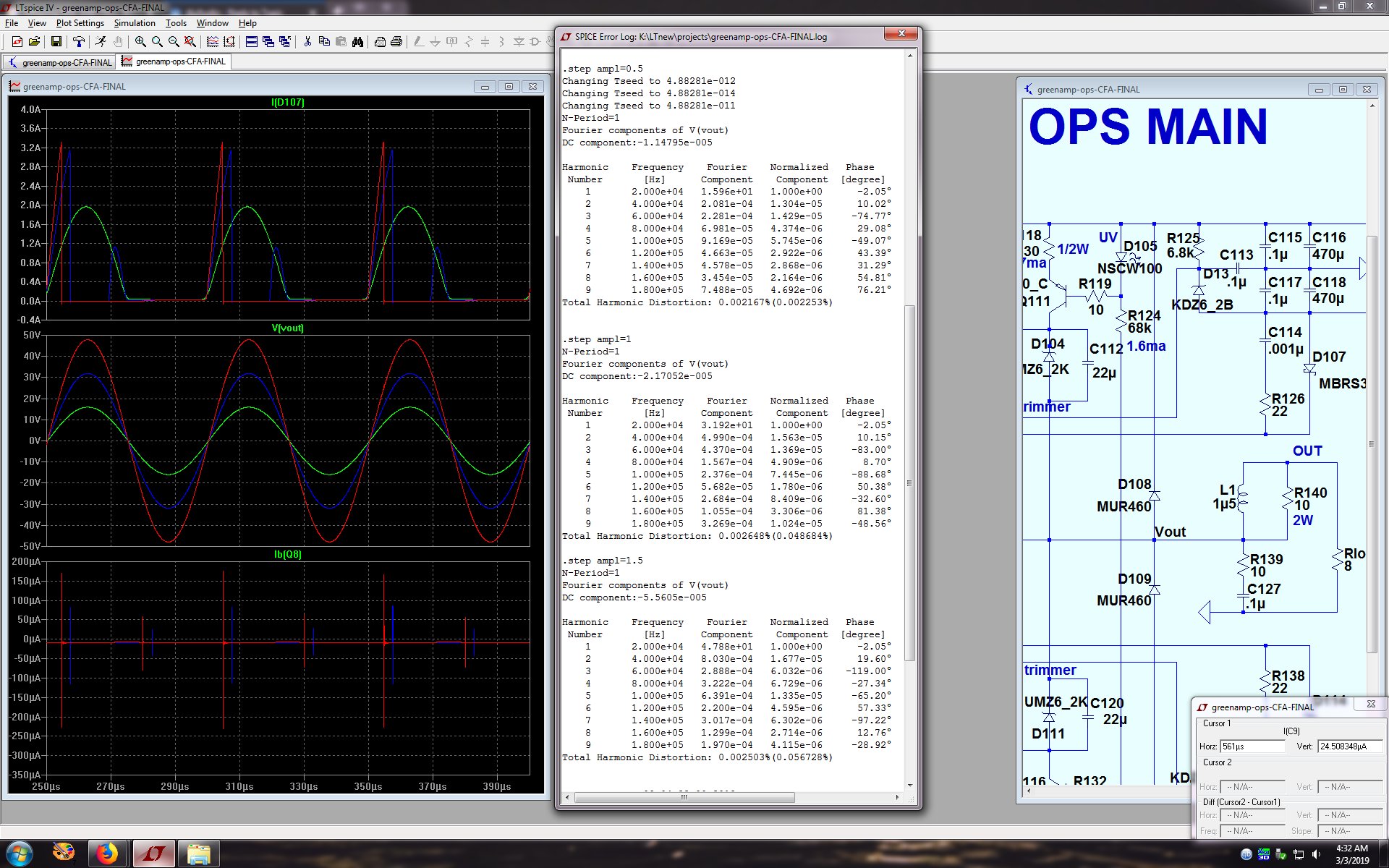

Performance is the same , despite the bloody diodes. (below 3).
The CFA's speed absolutely outperforms any VFA in correcting class H
"errata".

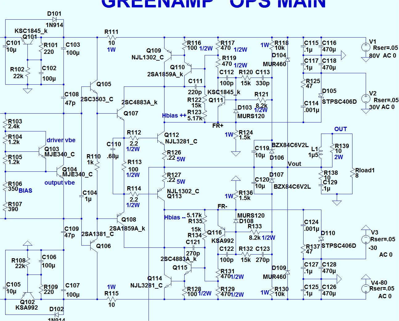

Ok, let’s investigate your design from the end.
First of, and maybe the main goal of amp’s design - is to create powerful but yet stable at all load conditions OPS.
I must let you know, that EF3 without special care are unstable at all. Symptomes are - you run the amp, set bias, all are first see similar to the sim.

I really won't miss seeing the designs and performance details of one of your power amplifiers, can you please share them here!
This EF3 is the "slewmaster". At least 500 built. Search for slewmaster.
I have one. No issues.
VZ audio (russia) uses similar output stages , no problems.
The only part of this design new is the class H outer device circuits.
the rest have been on hundreds of oscilloscopes and other testings.

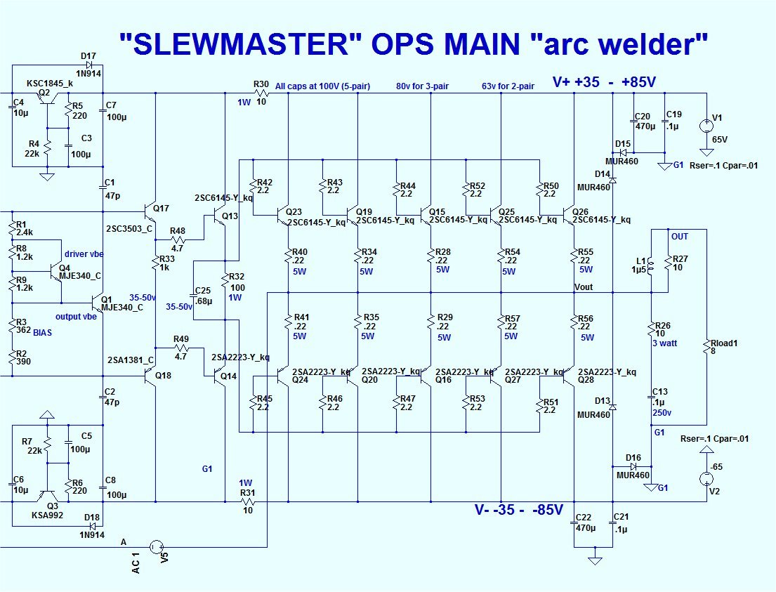

OK.
It's hard to do your #1 , we have fast devices.
We are kind of forced to do #2 , we use real fast pre-drivers and drivers >100Mhz ft ,
and isolate them with a R/C from the outputs .

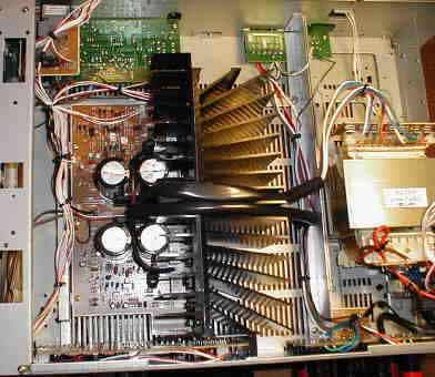

This OPS (the EF3) is really similar to a Harmon Kardon 680 (below 1) ,
perhaps one of the more reliable and revered of HK integrated amps.
Here (below 2) is the one I have - the "slewmaster".
As far as class H reliability , this circuit is a based a CREST (pro amp) design .
These amps last 20 years in hard professional use. CREST rates only at 1Khz full power
with .1%THD . I have refined it to ...... (below 3).
I think I have them "WOOPED" bad !!! 1PPM 1K.
BTW , the oscillation was the super-pair - definitely. changing compensation
fully fixed it.

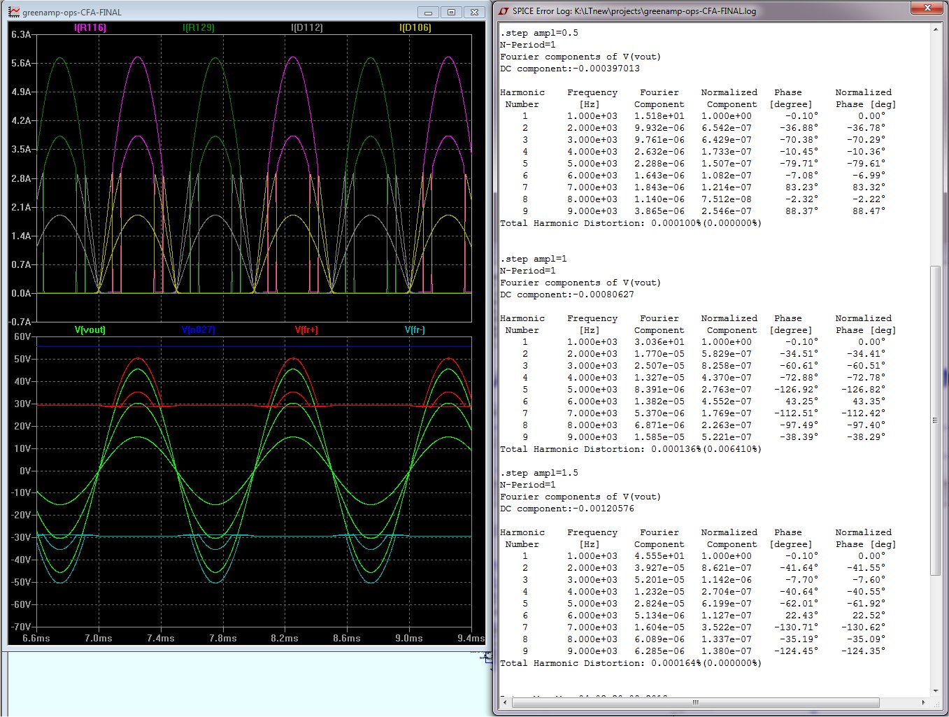

Do you want to see "greenamp X2" ?? COMING this spring !!Was not too bad with -say- 500-600W output power. That amplifiers was developed to survive everything, but not to reach the best sound quality...
Sajti
I'm on it now - OK , same 8 device total as the 1800. 100V rails.
And 400W at 3ppm. Got em' beat by X100 !!

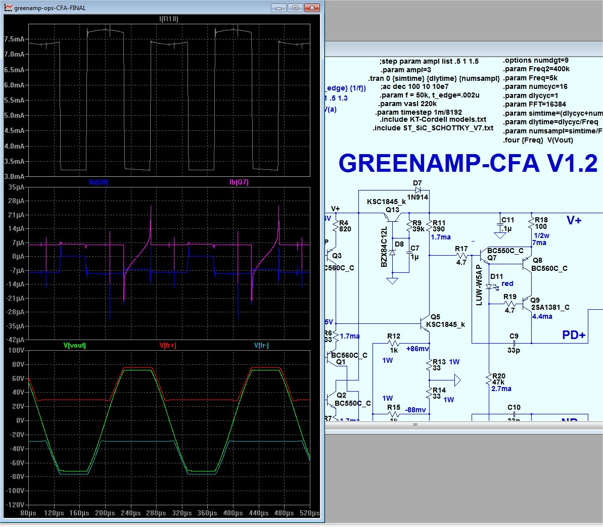

Check this out ....
Was not (entirely) the super- pair , after all.

Where do you see the problem.
(below) is the Q7 and Q8 Ib and the total current through R18.
uA and native clamping from 7ma to 3ma on overload.
Edit - EF beta enhancer has slightly more gain but issues compared to the super pair .
Edit 2 - In the slewmaster thread , this IPS was built as the "kypton ND" , we ran it at clipping (overnight).
IPS VAS heatsink was cool in the morning (still clipping).
OS
I see what you mean - Q7 reverse EB breakdown is approached at VERY
high overload.
But I noticed that Q7 emitter current falls to absolute Zero when this occurs.
The BC550C reverse V breakdown is 5V at 10 uA , we have 0 .
This is why it survives in real life.
What we have is a solution without a problem that becomes an ineffective solution
if the added diode leakage current is greater than the EB leakage current.
Still , this is far better than the beta enhanced EF phenomena.
