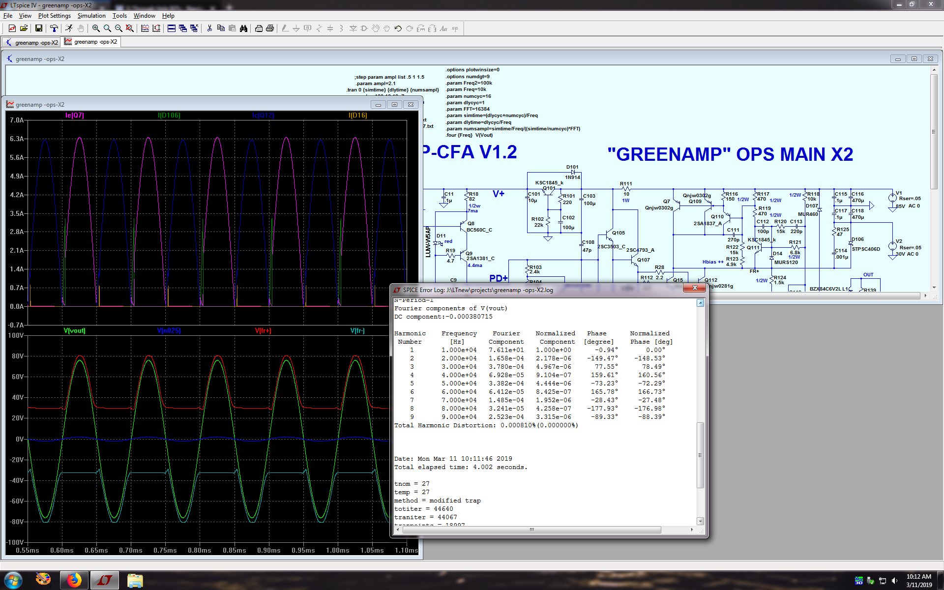

#1 - I just did the simulations on the MOSFET's. They work great for the typical "switched" modulated class G. Very hard to get them in a idle state(for H). I expected this , they do not work as well as a BJT in the linear region. The modeled gate capacitance does have a "lag" effect on the modulation vs. frequency.
With the BJT variant , easy idle ...and you can control the capacitive "lag" up over 10Khz.
#2. - How much power do you really need ? With that efficiency the 8 device (below) would blow you out the window. The X2 is the same as the Crest (cc1800) @ 400W/8R. But .. at 8ppm-10Khz , it scales nice. .ASC is set to idle the modulator devices at 15mA -run 150V p-p @ 10K.

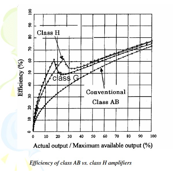

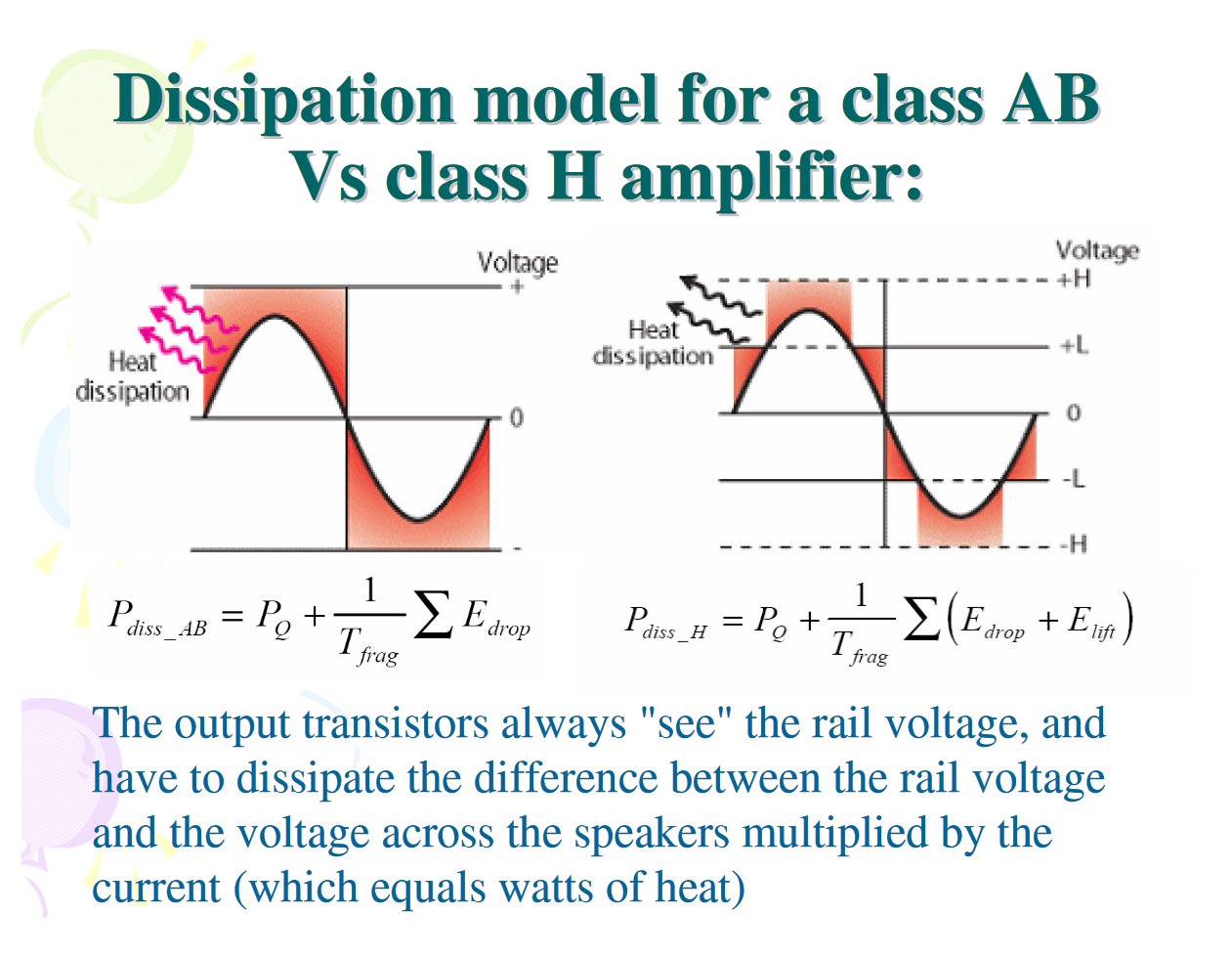

When you just break the class G switching barrier , You have the full voltage of the upper rail switched on even as it is un-needed (by the inner pairs). Class H only applies an extra 4-6V over what the signal requires. Which scenario would be more efficient ? The upper device is always at some level of Vce instead of being fully "turned on". You would think these factors would negate each other. Actually , the reduced loss from the inner pairs more than negates the outer pair's increased losses.
Nope , from ADSL drivers to audio .... class H is 5-10% more efficient overall than the "dirty switcher" (class G). Most of this efficiency is shifted right to the transition between AB and H operation.(below 2). The dirty class G gets it's peak before transition. It also seems class H gets just a little more efficiency all the way to full power. This information seems to be consistent across the internet , once you go beyond the dummies that do not even know the difference between G/H.:D

Nope , from ADSL drivers to audio .... class H is 5-10% more efficient...
In simple theory they should be the same, probably depends a little on the details in practice. In any case, I was a bit careless in what I wrote, just meant that I was prepared to take some penalty on efficiency to have less "dirt" on the rails. Didn't mean to imply switchers were necessarily more efficient. I did consider a switched buck down-converter, which really would be more efficient. Now I come to think it over, the fact that they aren't (in this case) means less to worry about and makes the choice simple.

Then we need to make sure the rail tracker isn't the choke point once we save a few volts in the earlier circuit..we need to keep both sets of overheads in correct relation...
Now I think some more and see the rail tracker should waste minimum volts because this means we can keep more Vce across the inner transistors near the peaks. That helps keep their Ft up and improves stability. That makes the common source (or BJT CE) rail tracker still look like the choice.

Sims with the IXYS VFETs as the outer transistor are beautifully clean, no transition spikes or twitches at all. Unfortunately the VTO is 4 volts so we lose a bit more overhead than a BJT. It's not easy to use Common Source and pull the FET "down", as I learned when I tried. I want the VFET benefits but want to avoid excessive losses. Winfield Hill had the clever idea to create boosted rails with a tiny, isolated DC-DC power supply. Seems to me it would be possible to do a similar trick here, rather than boost the rails just boost the Gate of the FET. Kind of a linear hi-side driver. The power is tiny so even the smallest part should work, there are some on D.key for less than $2. Any noise should be outside the audio band and can be well filtered, plus it's in the OPS, not the sensitive input. Has anyone seen this done or have ideas?
