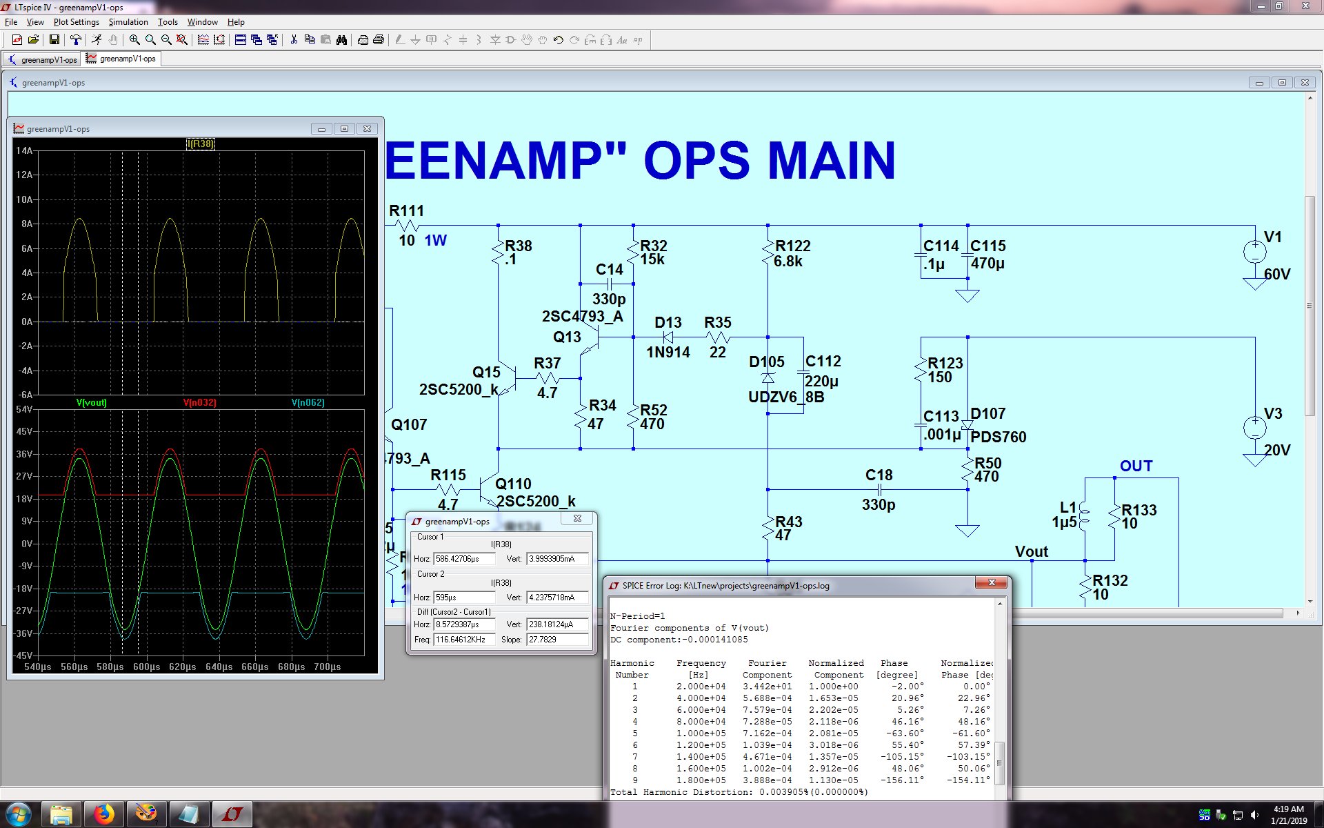

:confused:strange, I almost do not see hf harmonics... this is the first time in gnfb amp I can see hf harmonics are descending so quickly;)
That was before I fixed a reversed driver in the OPS. Now (below).
14ppm with class G - 20K , near full power /4R.
Look again below , there are some H7+ , 2nd is dominant.
Veysel - .1u to 10u parallel with R25 .... no effect - explain ?
So close , should I even add error correction or non-switching
to the OPS ??
OS

I did some simulation about this solution, without any success. Maybe I was not careful enough, but there was no significant advantage to keep some bias current for the outer devices.

You think so ?? I succeeded . non- switching steps make this output stage "sing".
(Below) - positive step example.
- Steps always idle at 4-5ma , had to load the step rail (R50).
-(R32) establishes the bias , I might upgrade that to a simple CCS in case
of ripple in the higher 60v rail (or "settling" issues with the stepped rail).
-(R43/C18) filter was inspired by Hitachi. :cool:
-EF works better than CFP. More stable.
(D13) step voltage diode , if it is carefully snubbered (33pf/150R) can be
cleaned up further. Althrough , R32 as a CCS would mitigate the diode
switching , it is only nA level.
I swapped KT/Cordell/OEM drivers/outputs , all the same goodness.
2R , 100khz ,transients , clipping . No glitch , no problem.
I will try the CCS ,and a few more refinements.

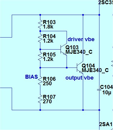

This OP stage uses the fancy harmon/kardon Vbe , with a second active device
(which could be adapted)for the outer device drivers.
I do agree ,aggressive high rail operation will require thermal FB.
I might add .22Re for the outer devices. The .1R was just to monitor current.
