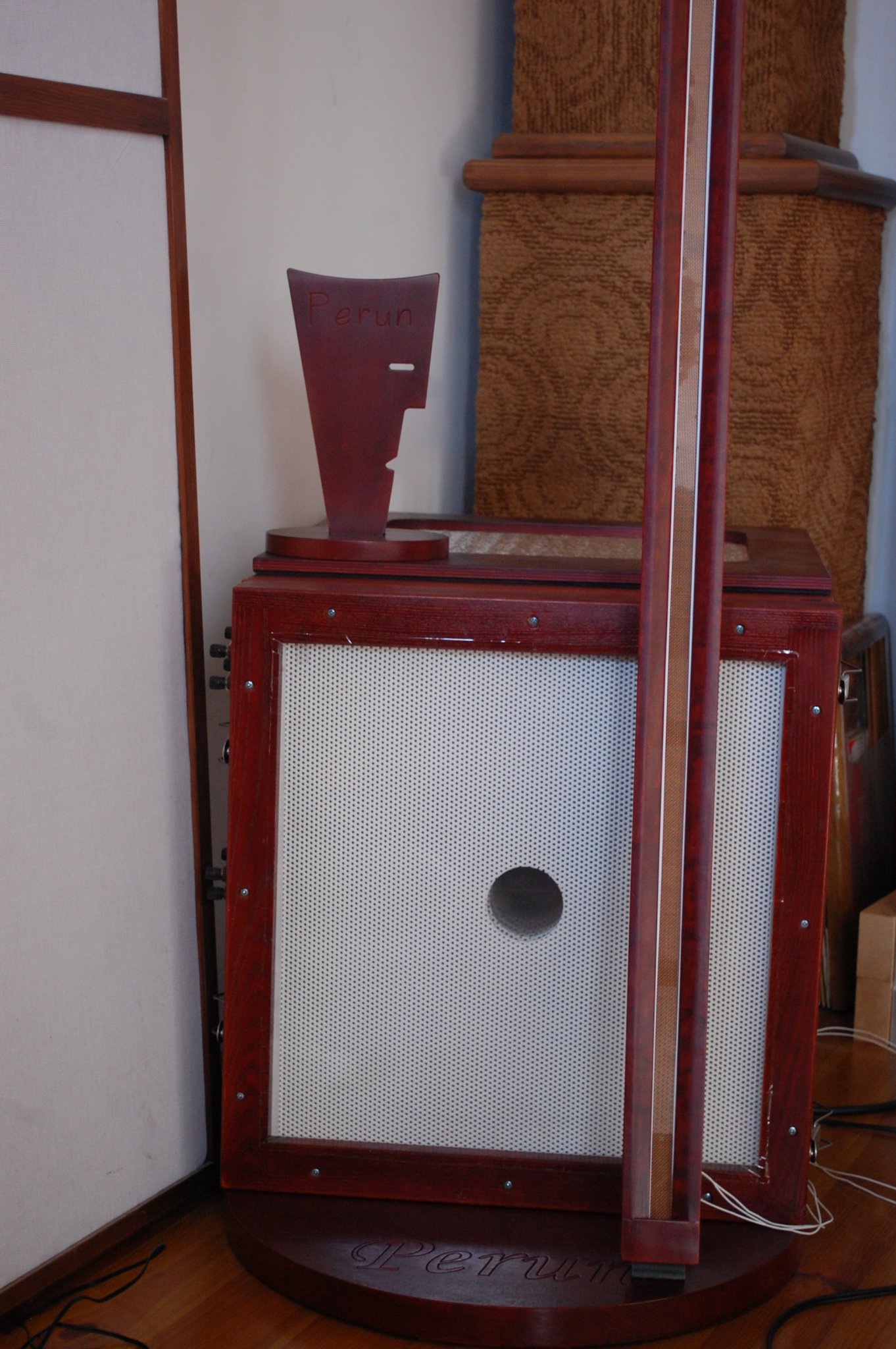

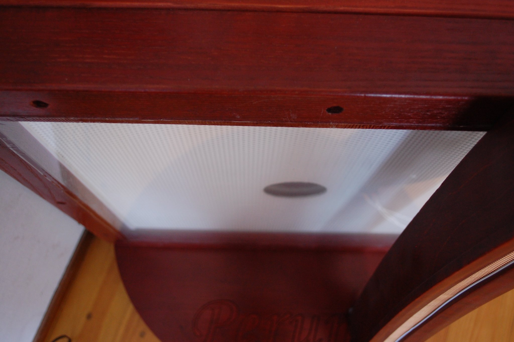

In addition, I want to write that I tried to acoustically design subwoofers using boxes, but I didn’t get anything special except for the color of the box.
Therefore, I used only one element, this is a top cover with a specific "membrane".
This cover cuts off the half-ceiling connection behind the subwoofer and this plays a rather large role in suppressing parasitic resonances in the wide range of 120-500Hz.
I used a tone generator to "aurally" identify peaks and dips in the frequency range associated with room acoustics, there are some nuances, but more on that later.
I have a strong desire to make the frequency of 30-500Hz the most even. Everything that is higher in the range suits me completely.

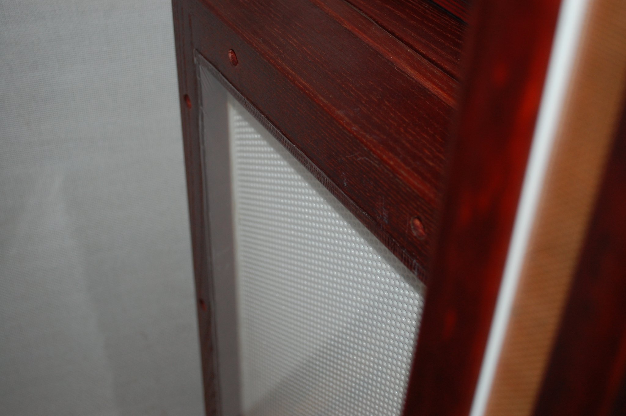

Perhaps I already wrote it, but I glued additional passive membranes on both sides to the subwoofer in order to attach an additional mass of air to the membrane package and thus increase the mass of the movable membrane system, as well as to eliminate a number of parasitic resonances. Well, dust will not get inside the package:

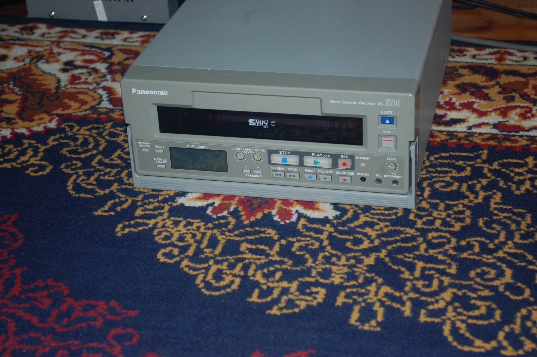

Hello friends.
Recorded a few percussionists.
Played on a Panasonic 5700 VCR.
As we all know, the video tape recorder has excellent technical characteristics, and this is a frequency range of 20-20000 Hz, a dynamic range of 90 dB. And all this is analog recording and playback.
In this case, a digital record.
But on this tape recorder I record the vinyl analogue of my friends, those records that I don’t have, but I don’t have much .

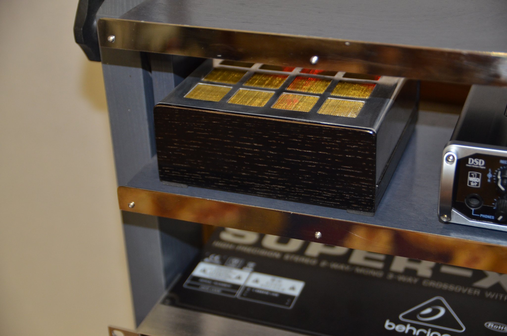

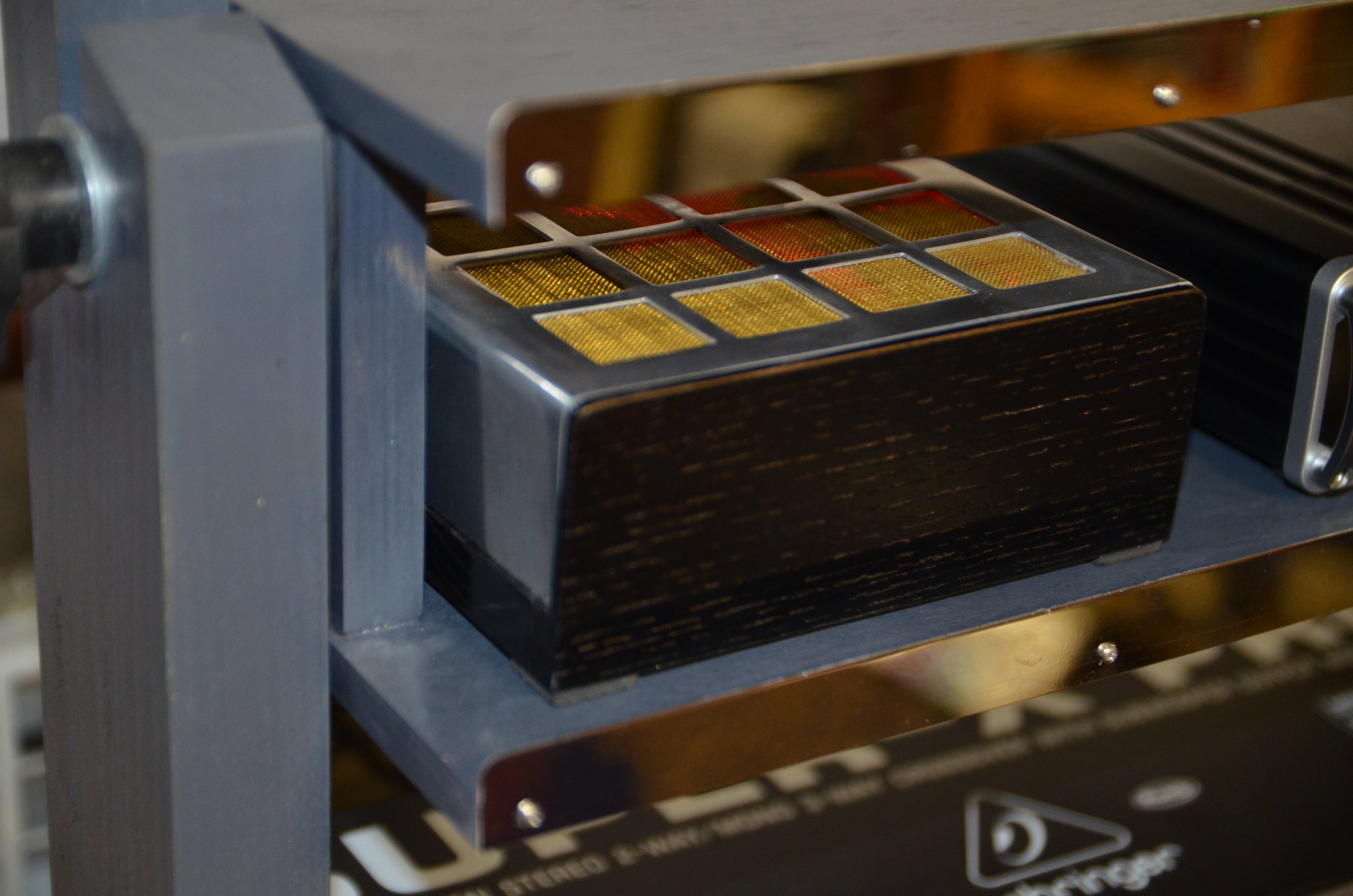

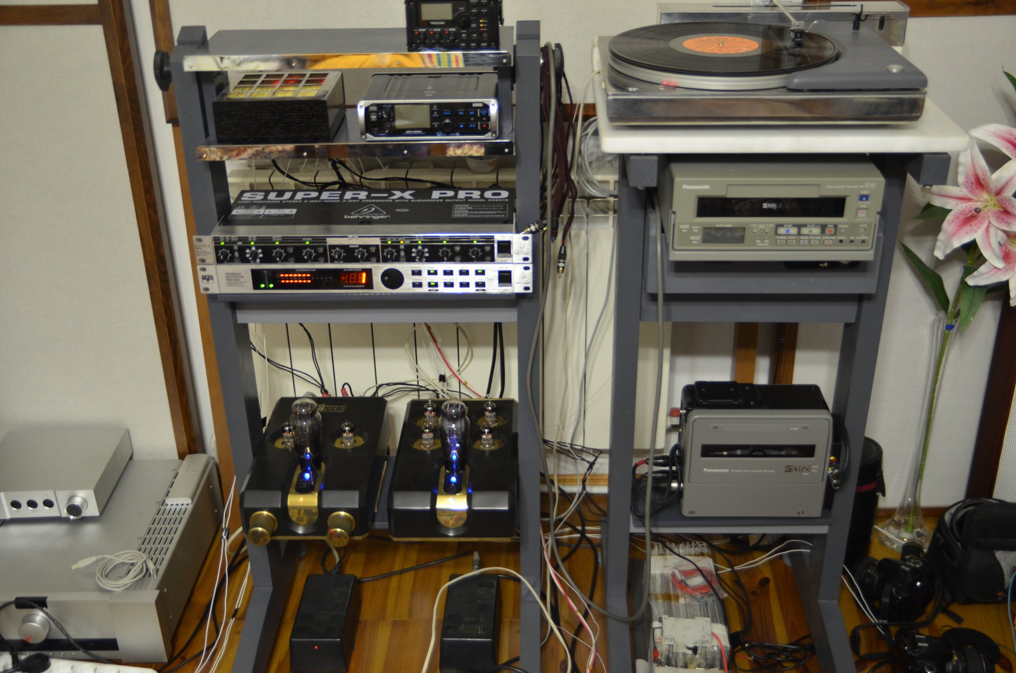

Hi friends.
I decided to make a house for a pair of class D amplifiers from ash and aluminum.
They are assembled on a 3255 chip.
They drive the bass bar and treble bar with ease. They are battery powered by a 36V mid-point LG Li-Ion battery.
The capacity of 48Ah is enough to discharge the battery from 38V to 34V for half a month of everyday listening to music. I am delighted.

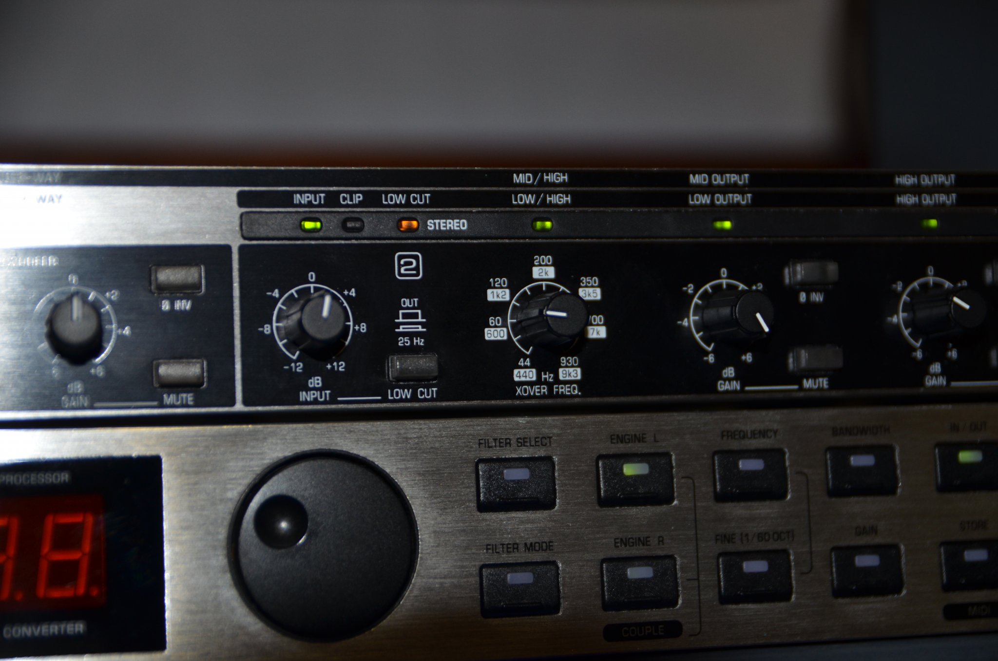

I also use professional tools in the audio path, this is an active crossover and a parametric equalizer, I preferred this equalizer to a graphic equalizer because it can remove parasitic resonance at virtually any frequency, but I needed just that.
The preamplifier and vinyl equalizer are tube custom-made.
Band separation was most effective at 600 Hz.
Let it be for now.
Let it be for now.
