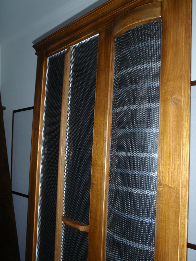

Hello friends. For a long time already, about 5 years I had unfinished acoustic systems, but recently I decided to finish them all the same. The speakers consist of a bass segment, which in turn is built of a double membrane stack, each with 4 stators and 3 membranes, a total of 6 membranes and 8 stators composed by isobaric. As well as a high-frequency emitter. Everything that I do I will gradually spread here.

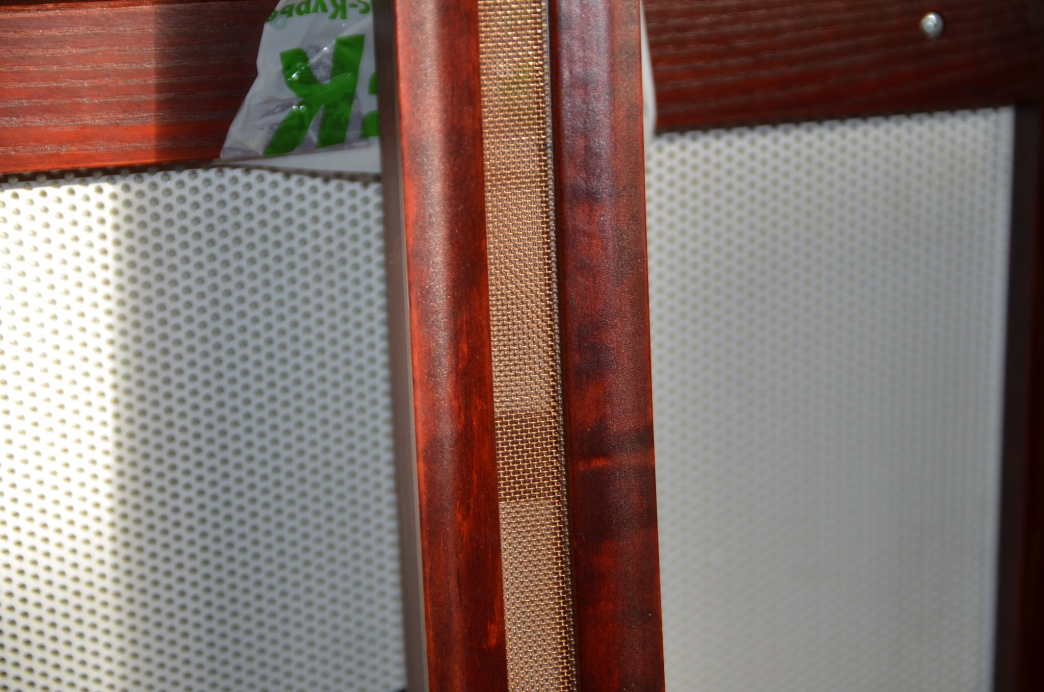

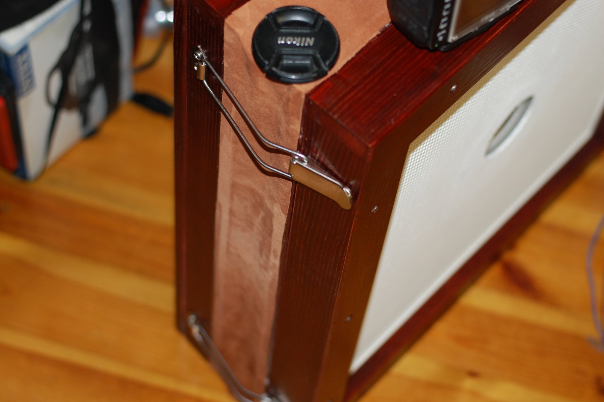

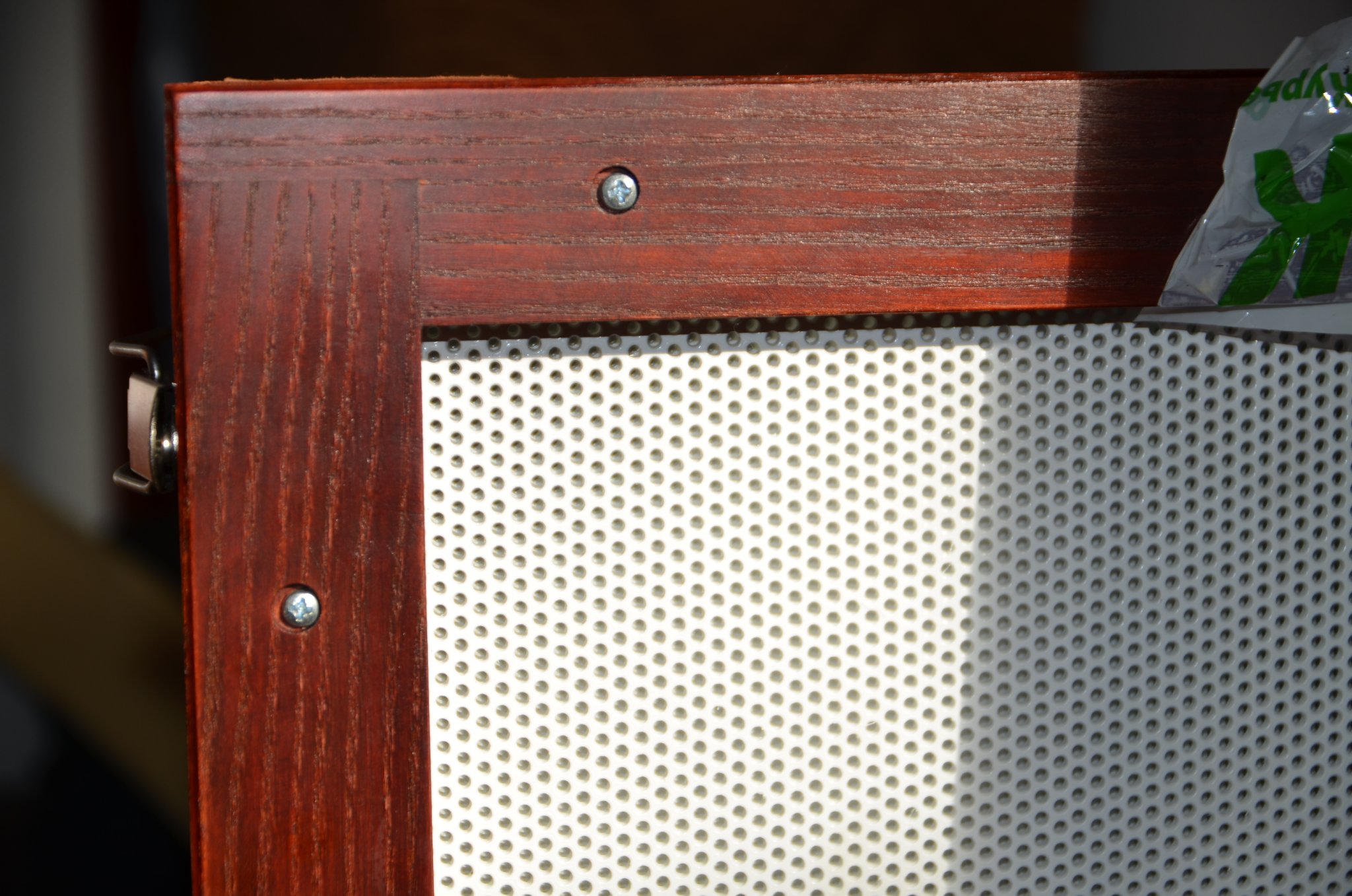

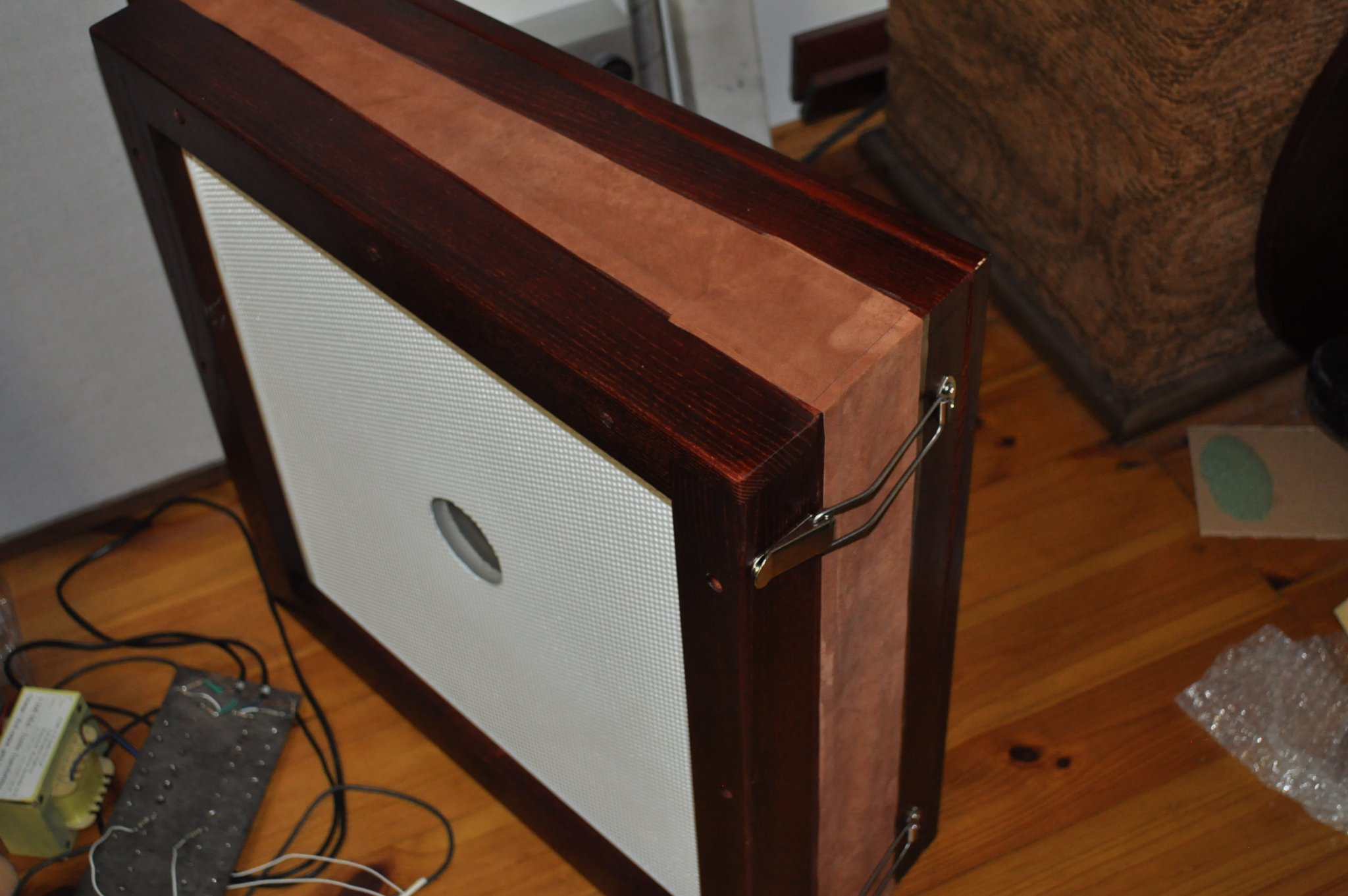

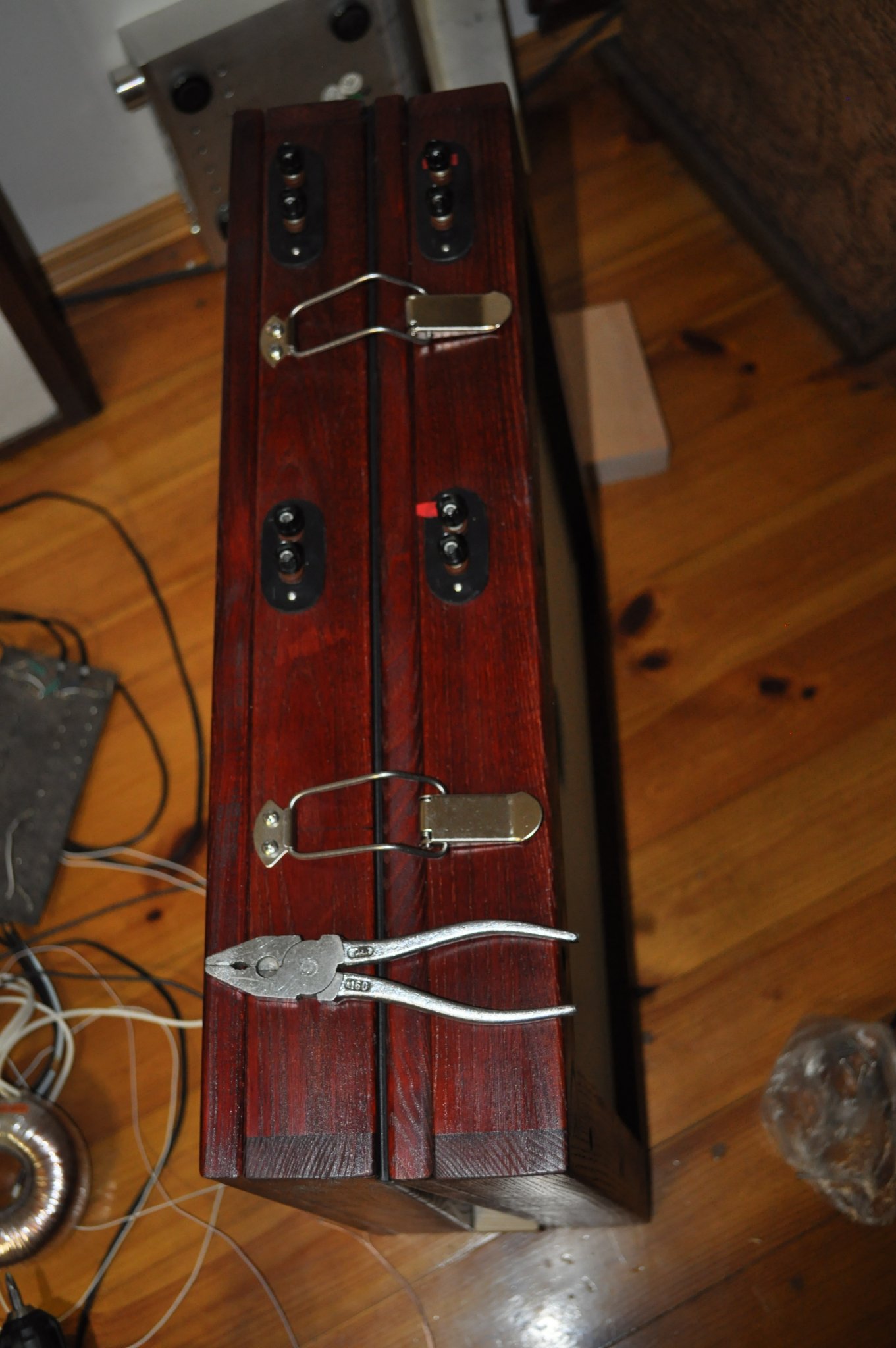

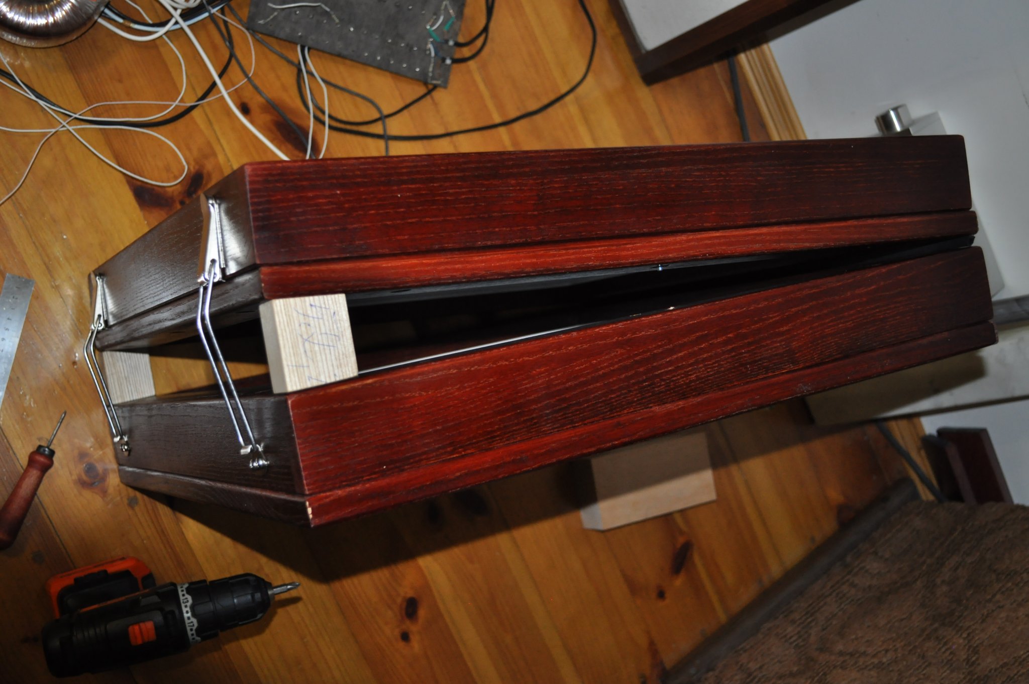

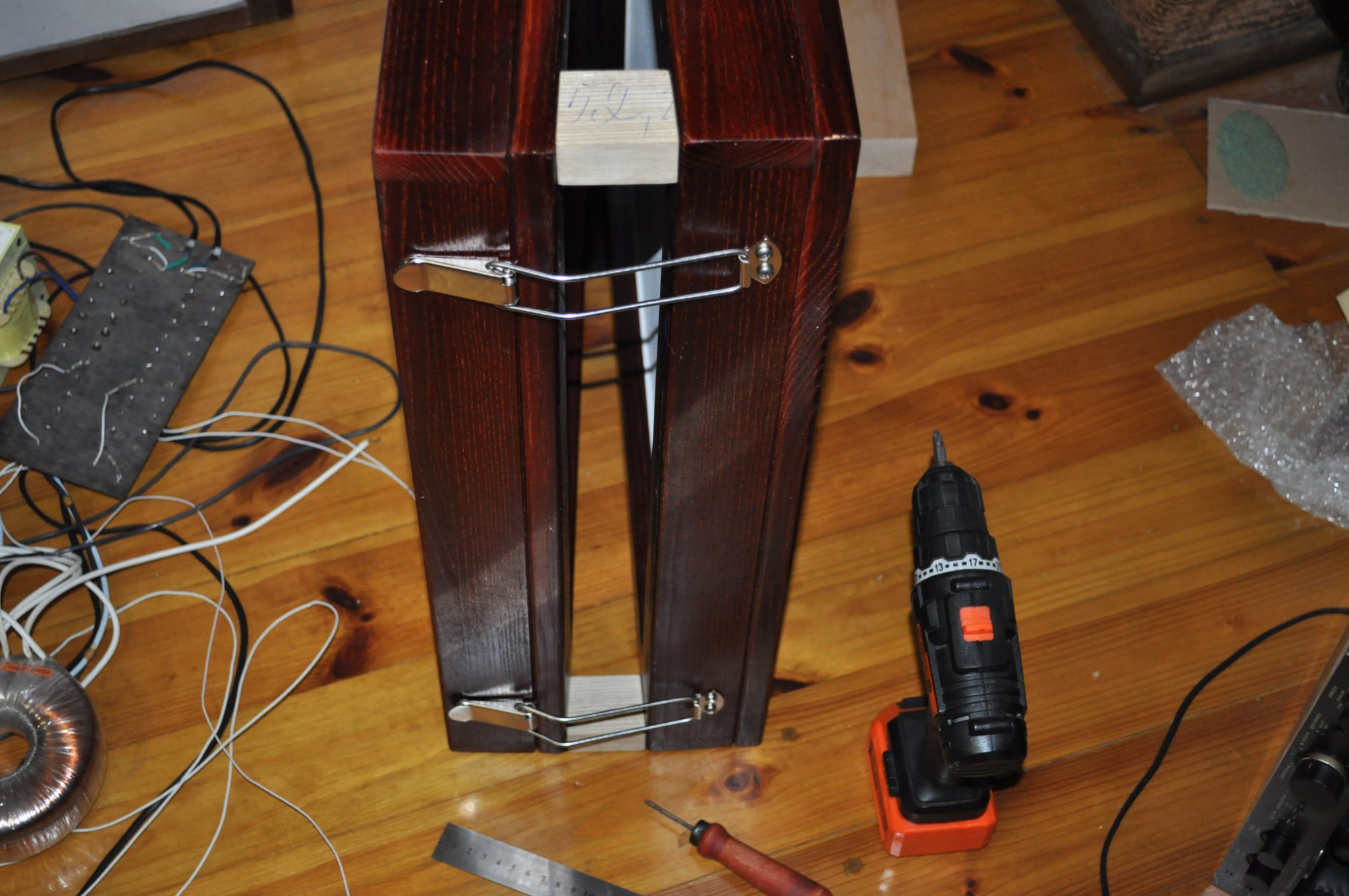

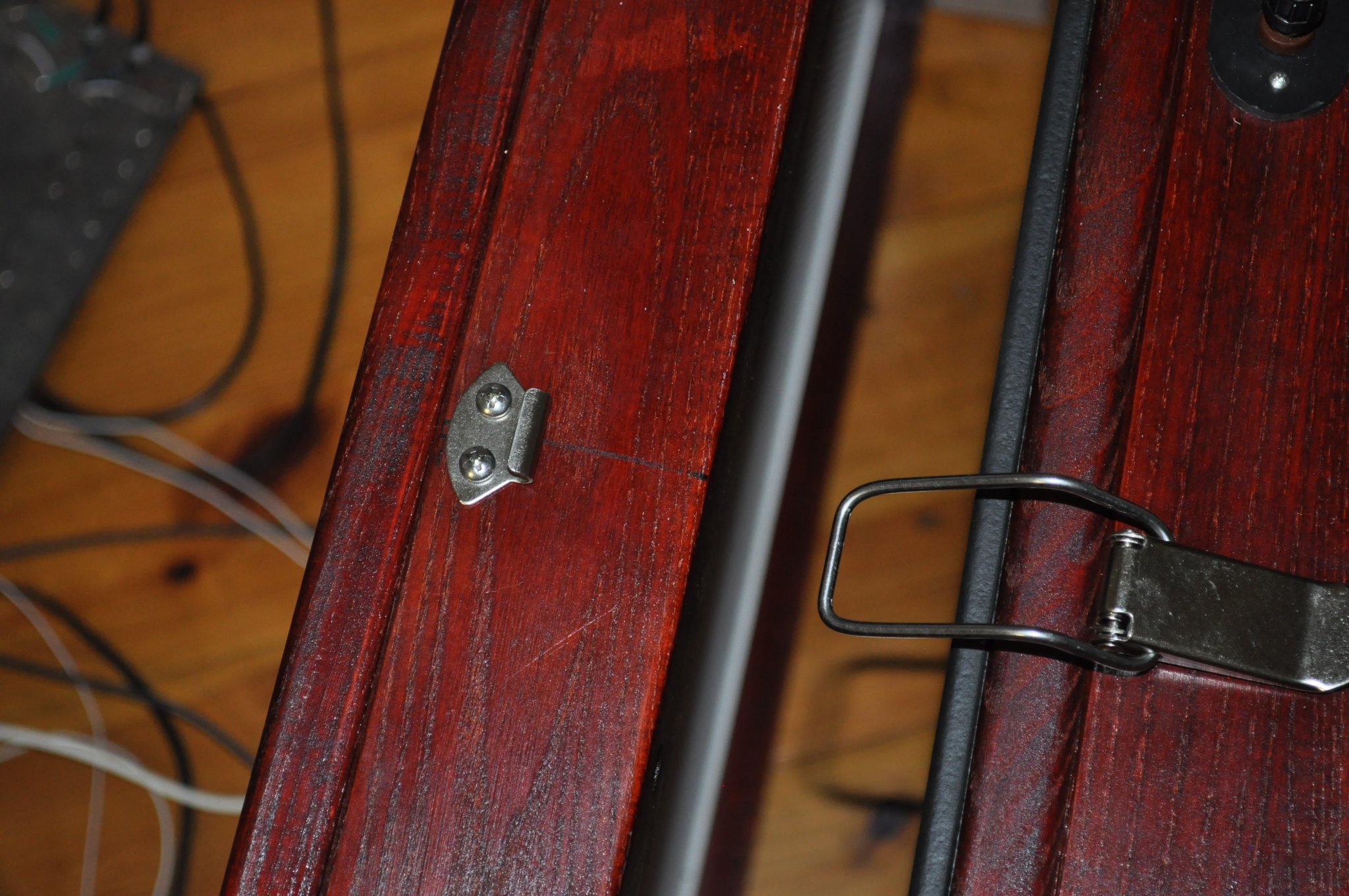

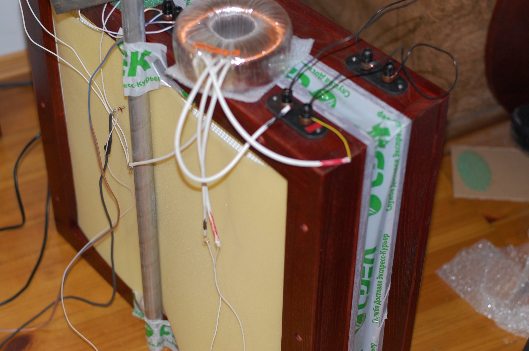

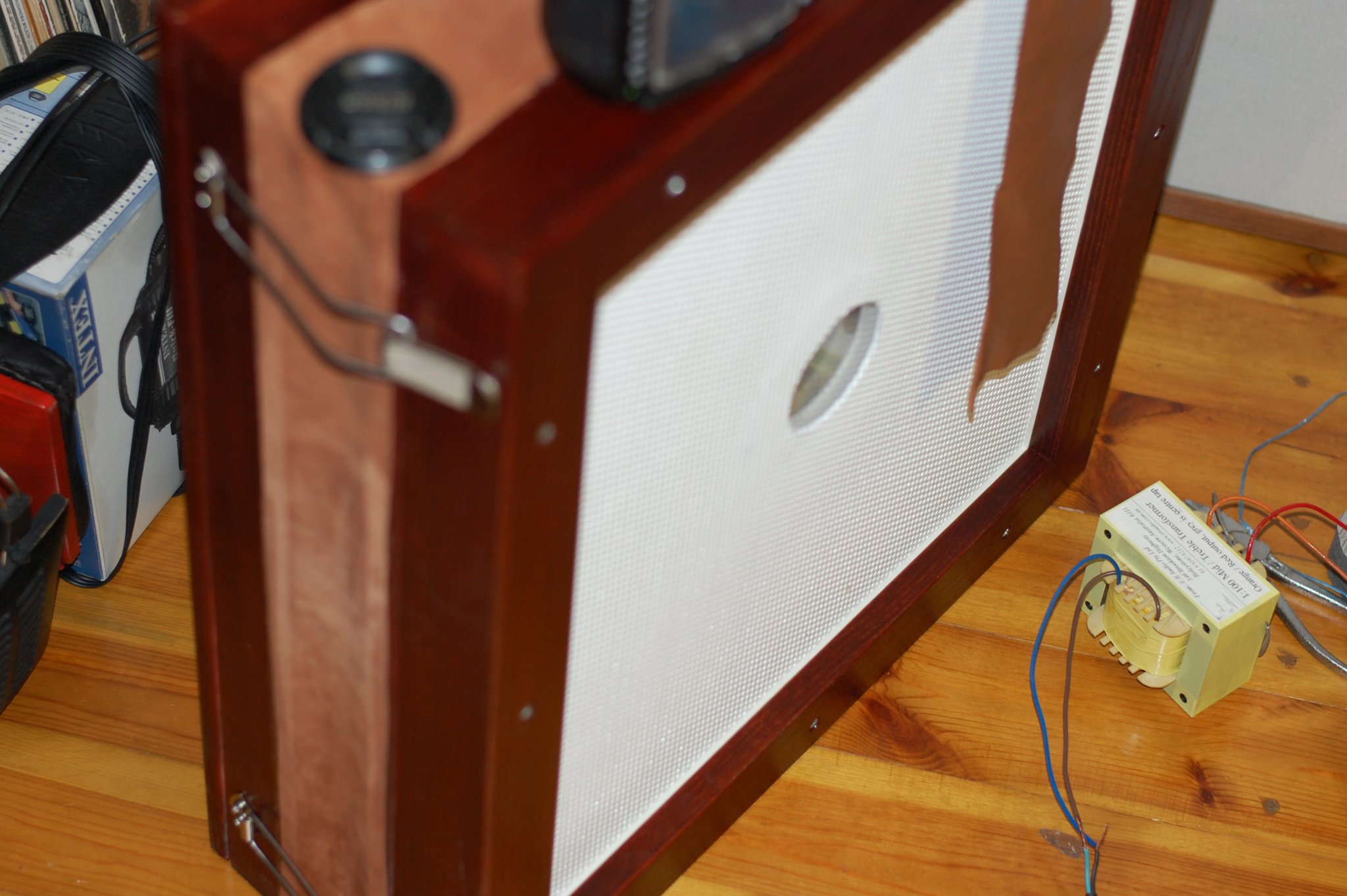

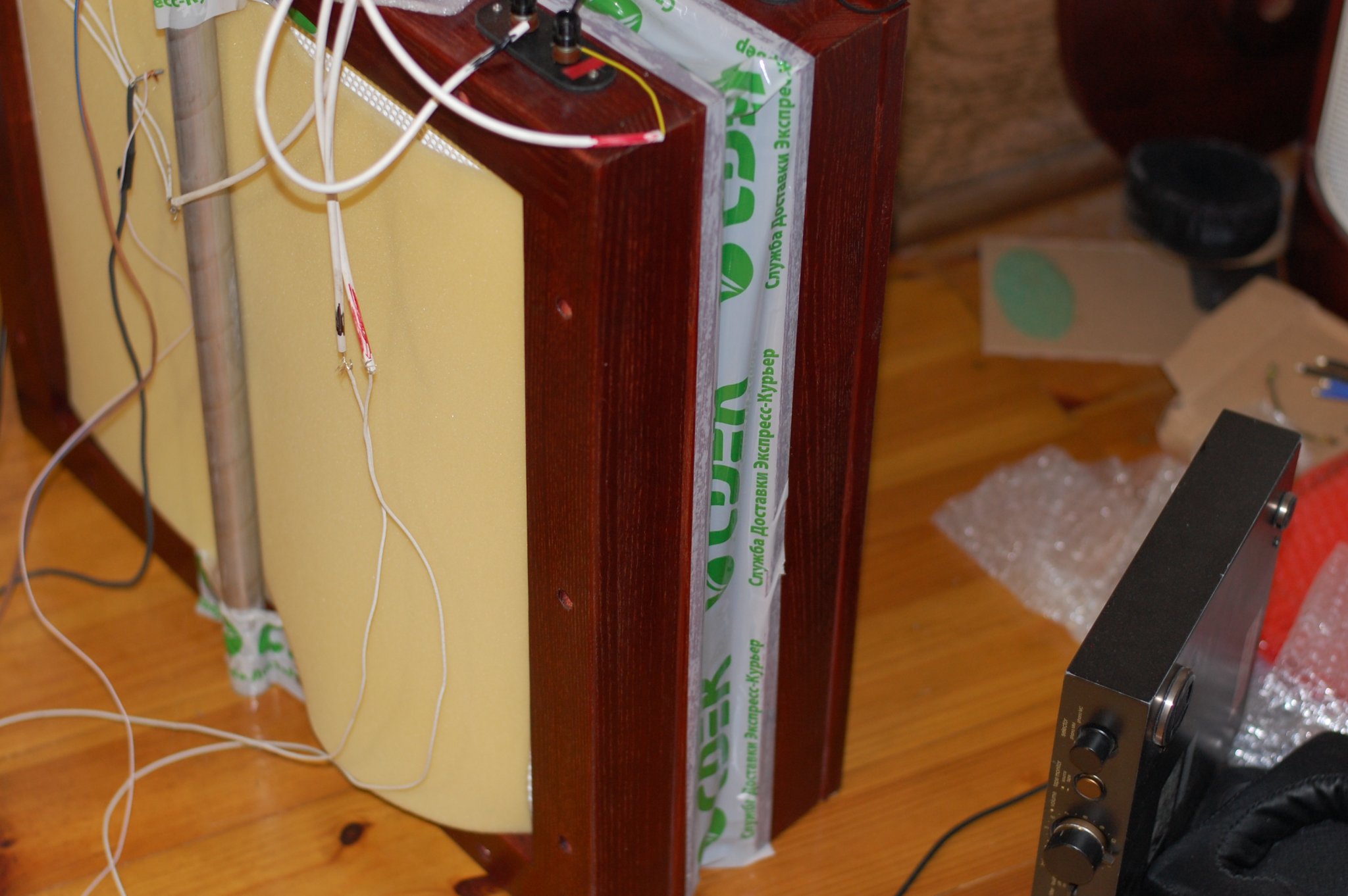

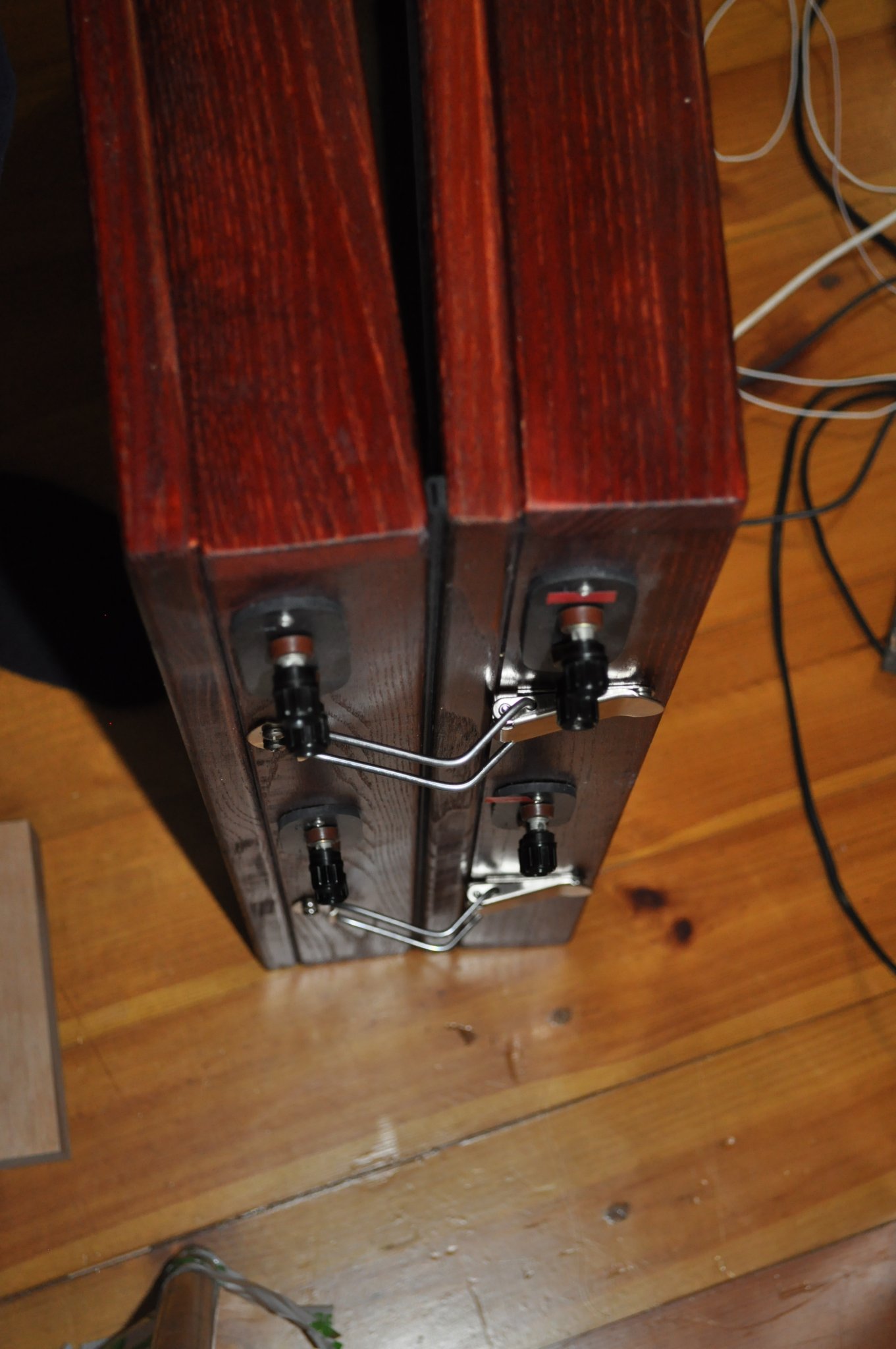

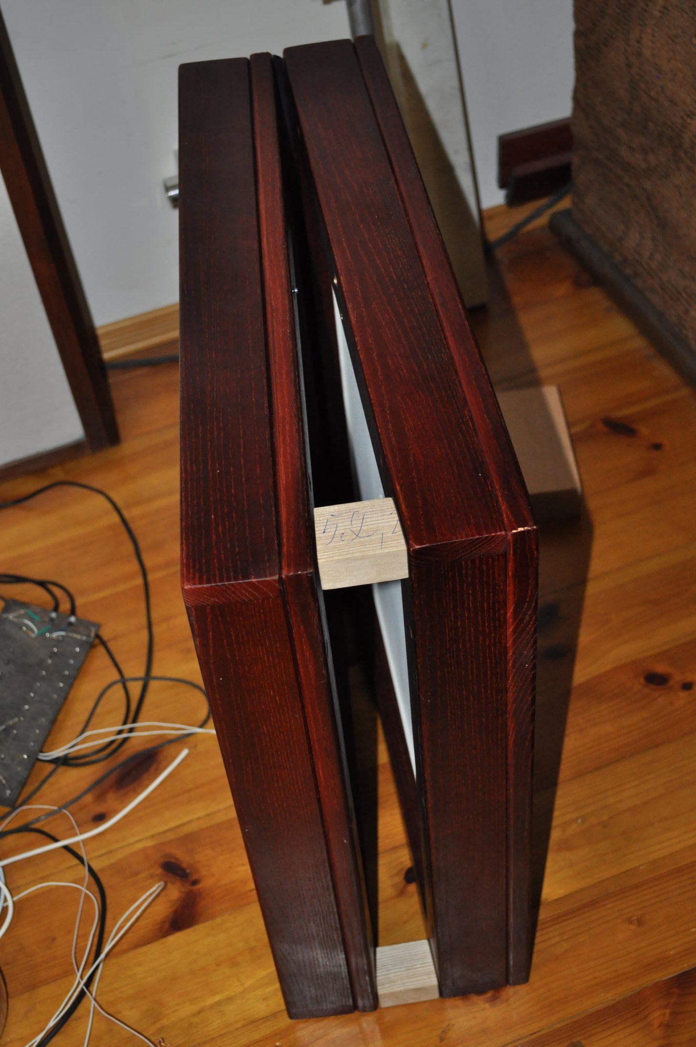

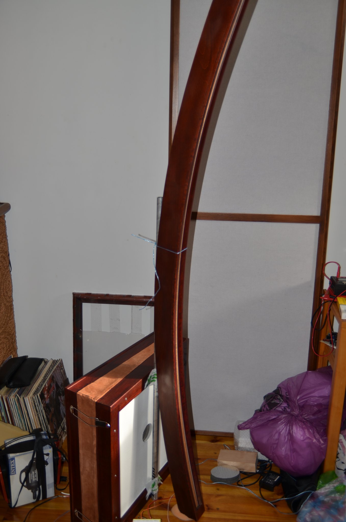

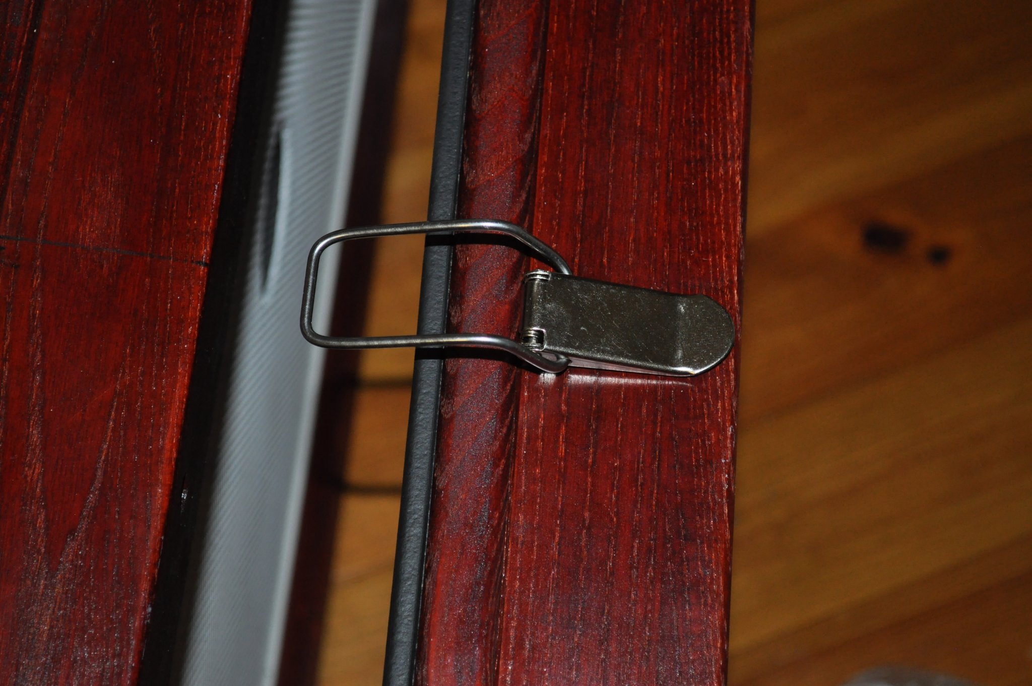

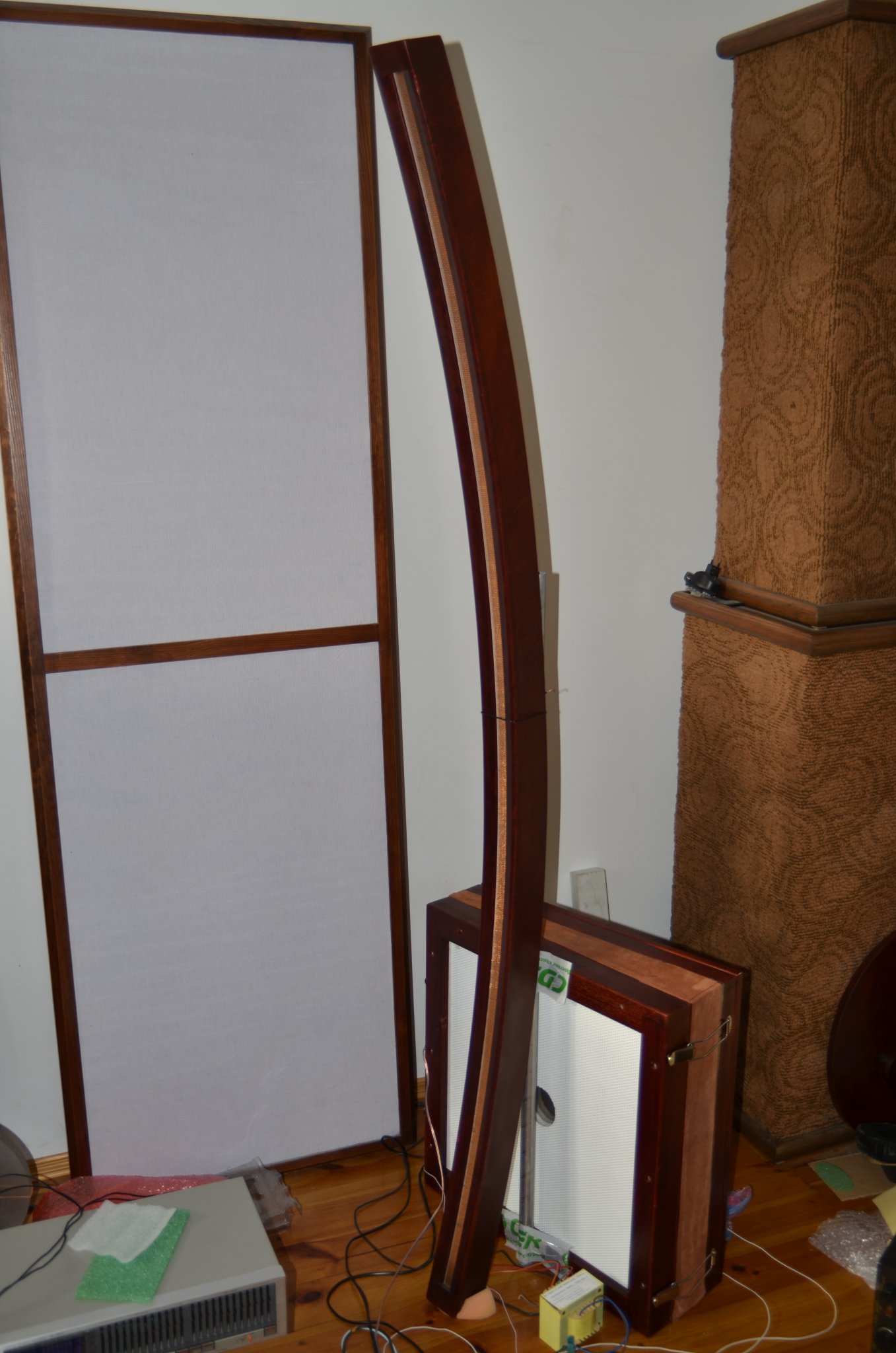

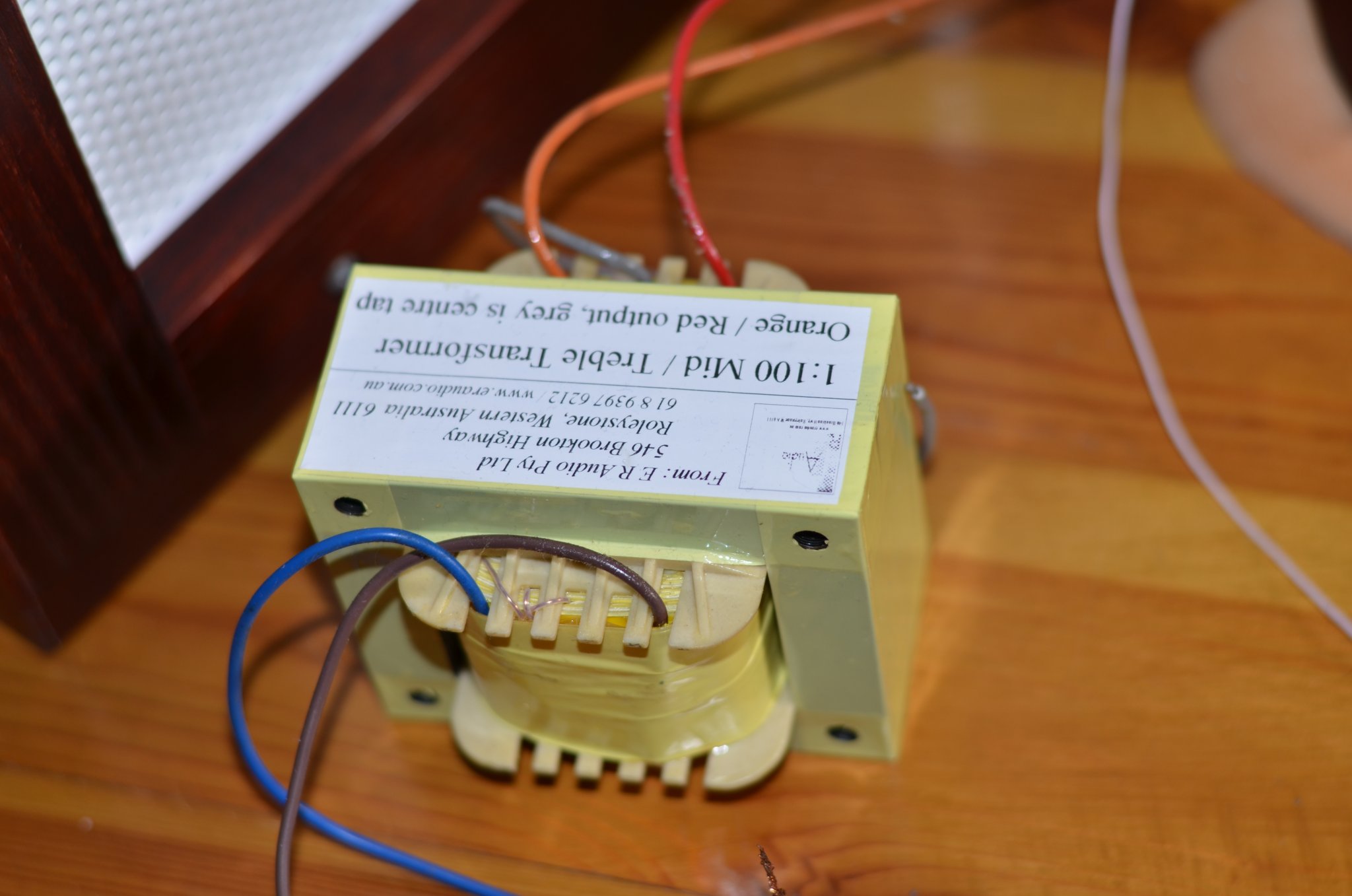

Collected the second subwoofer. The whole system was working, only it was necessary to assemble it cleanly, but I finished with the subwoers. A few words about them. As I wrote earlier, each subwoofer consists of two identical parts, if you just squeeze them together, you get several parasitic resonances, so I had to get away from parallel connection. The hole that turned out at the same time was sealed with natural leather, since the material should be pliable, and not tough and elastic. But one resonance remains, it is in the region of 500 Hz, I remove it with an equalizer, because it was not possible to remove it using the acoustic method. For subwoofers I use step-up toroidal transformers with a power of 350 watts, a transformation ratio of 1-200. The working range is 25Hz-1000Hz, then there is a smooth decline.

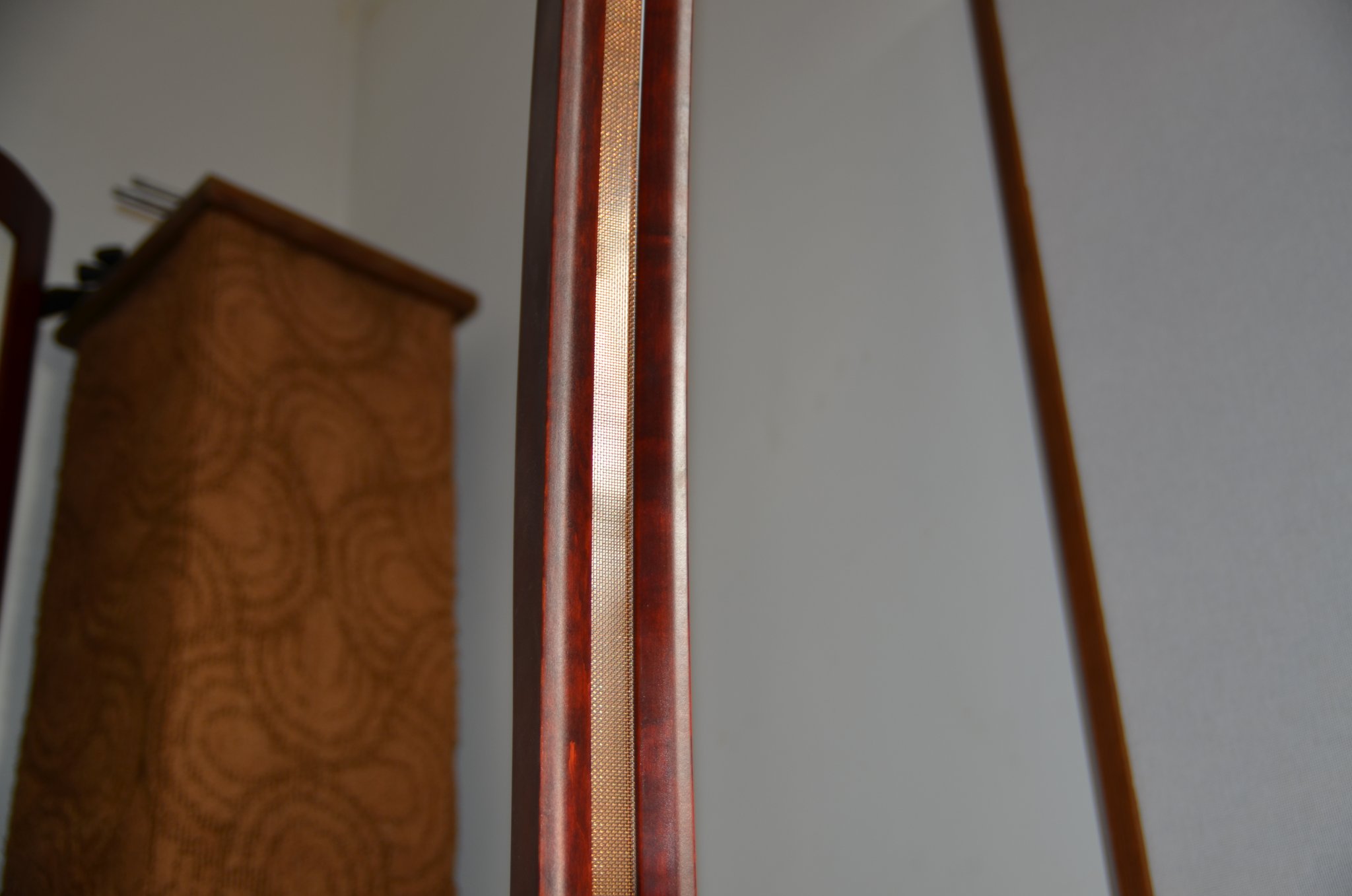

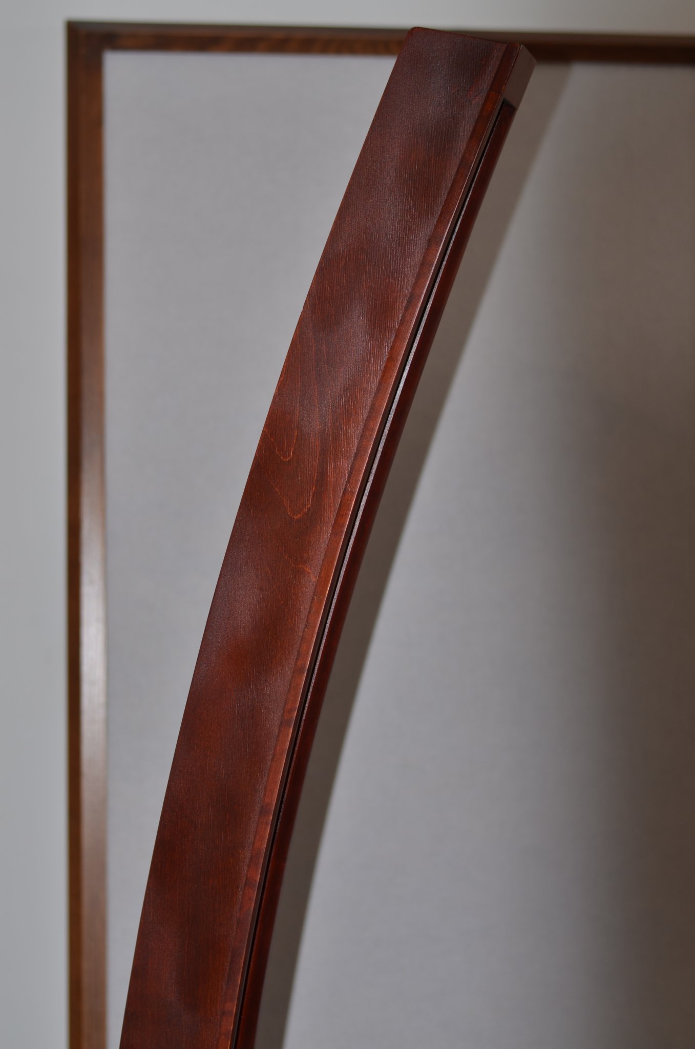

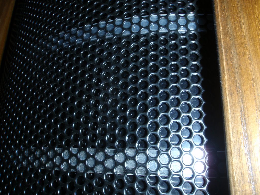

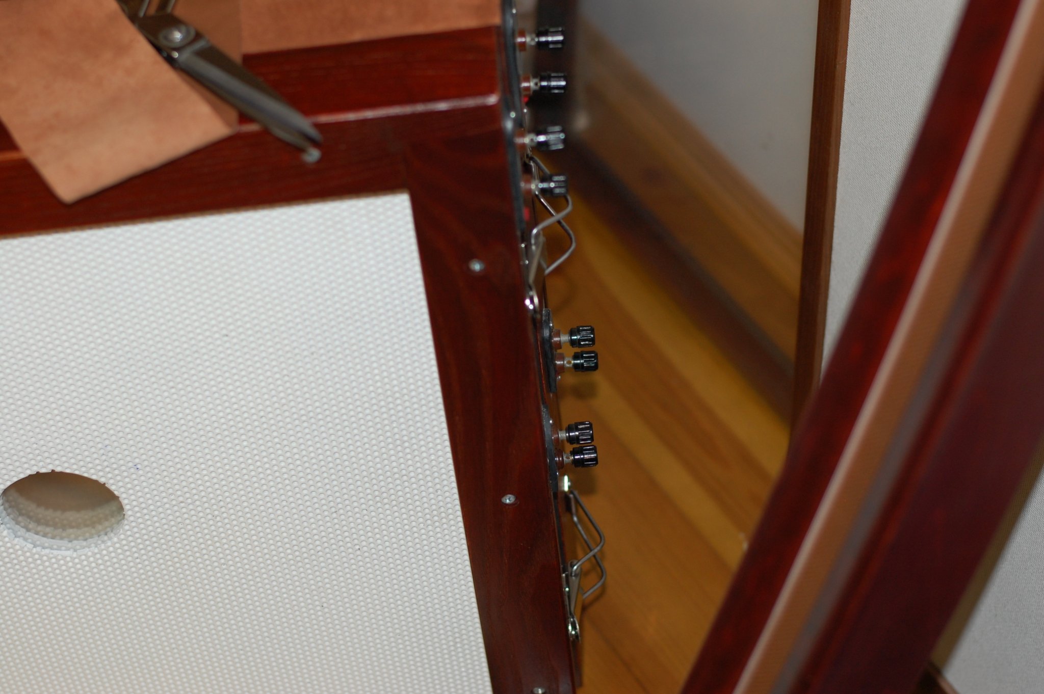

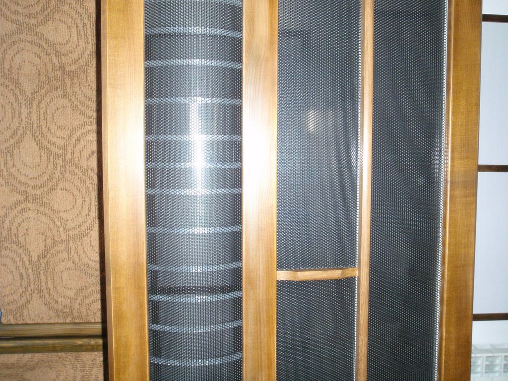

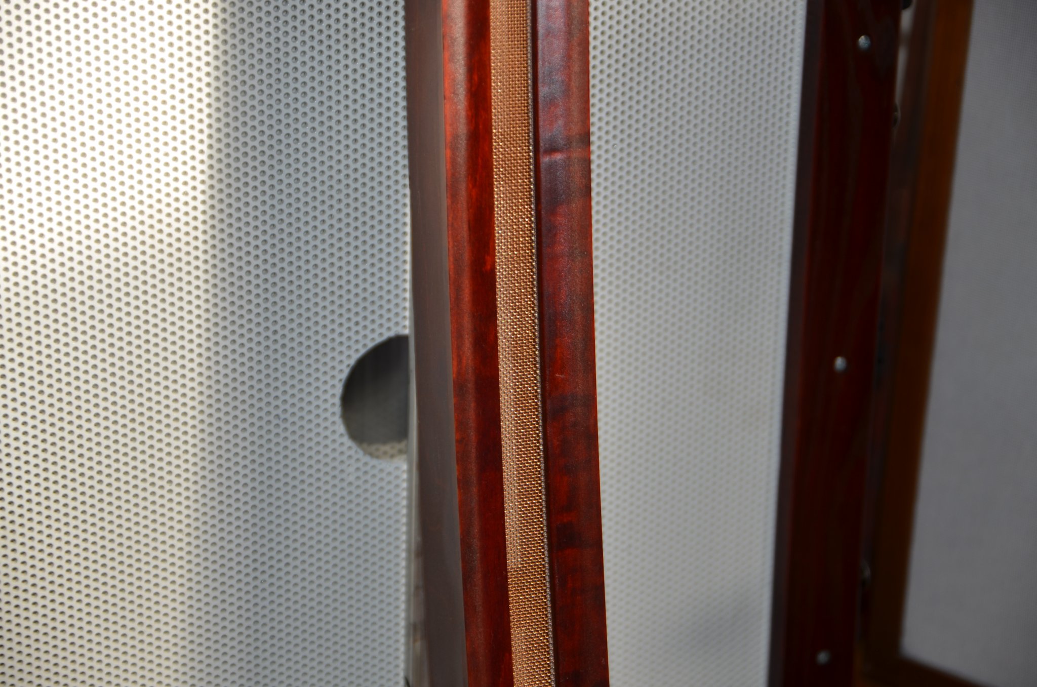

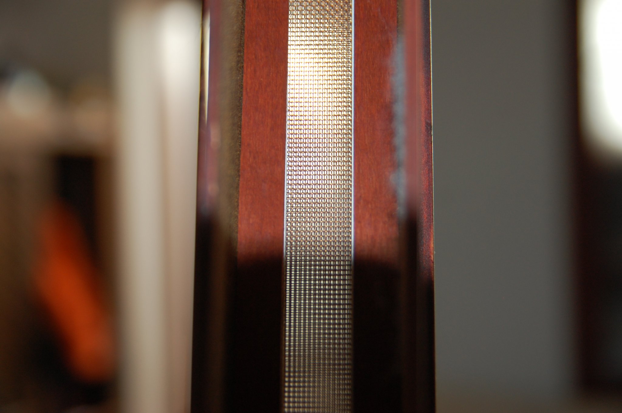

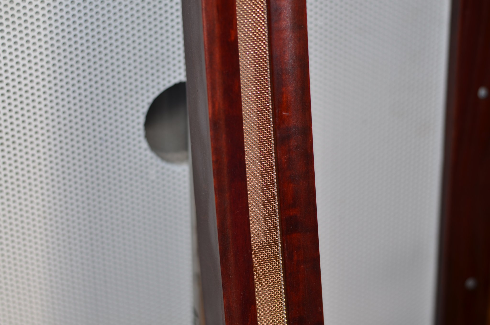

Further. The bass segment stators are made of 3mm metal. thick for increased rigidity. The working size of the bass panel is 500 / 500mm. The high-frequency strip is made with a height of 1900mm. and a width of 20mm. Here I must step back a little and tell you why I came to such a construction of a high-frequency emitter. Once visiting this forum, I posted a photo of my ESL where horizontally bent panels a la Martin Logan appeared and I was criticized by several people for this that allegedly these panels emit an incorrect high-frequency signal and at the same time the temporal characteristics are violated, that is, an interference porridge is obtained. I thought a lot))), asked about the size of the emitter and the long waveform, as well as the stereo format. As a result, I came to the conclusion that in the horizontal area the high-frequency emitter should not exceed 20mm in physical dimensions. In this case, we will have a wide-beam signal up to 16000 Hz, since the wavelength is 20mm. will correspond to 16000Hz. In the photo I am laying out a rough version of the articulation of two strips, then I will make a special mount with the ability to adjust the high-frequency emitter in the vertical plane, but for now everything is kept on scotch tape))). Further. The high-frequency radiator is bent in the vertical plane in order to collect the signal from the entire length of the radiator (1900 mm) into one point at the listener's ear. The bending radius in the vertical plane is 3000mm, this is the distance I have from the speakers to the sofa with my beloved))) As a result, the sound is very accurate and the sensitivity is approximately doubled. The high-frequency emitter stators are made of a woven mesh material of bronze and high acoustic transparency. The working range of these emitters is 600Hz-ultrasound.

Fine woodwork and craftsmanship there for sure - congratulations!
How does the sound come out for you? Do you happen to have some measurements - it would be interesting to see.
Thank you!Fine woodwork and craftsmanship there for sure - congratulations!
Measurements will come in time, or rather I did it five years ago, when I first started doing this ESL.
To date, I have only corrected a few things.
Subjectively the sound is completely satisfied with me.
It's not my first ESL, in time I got over the gigantism of construction))) and moved to a more compact, but more efficient options, as it seems to me.
The sound of these speakers doesn't remind standard ELFs with large radiating area, and moreover with conical speaker at the bottom of the range.
The bass, due to the fact that 6 membranes work in parallel, is very solid and dynamic.
And the fact that the planar transducers are very well matched in phase, you also know.

I'm sorry I didn't send a link, only the title of the book. Your ESL has an amazing voice. What grabbed me was the dynamics. So far, I’ve only heard flat anemic-sounding ESL. Unfortunately the people don’t understand that need other types of amplifiers to power these speakers.
But my amplifier doesn't really bring out these speakers, either.I'm sorry I didn't send a link, only the title of the book. Your ESL has an amazing voice. What grabbed me was the dynamics. So far, I’ve only heard flat anemic-sounding ESL. Unfortunately the people don’t understand that need other types of amplifiers to power these speakers.
Ideally I need a direct drive voltage amplifier (many volts)),without step-up transformers.
I know a guy who can do it, but it may take some time, because I need two amplifiers, one for the bass register and one for the treble.
He made an amplifier for electrostatic headphones for me, but still can not send it, finalizing it for about one year, all he does not like something in the sound))).

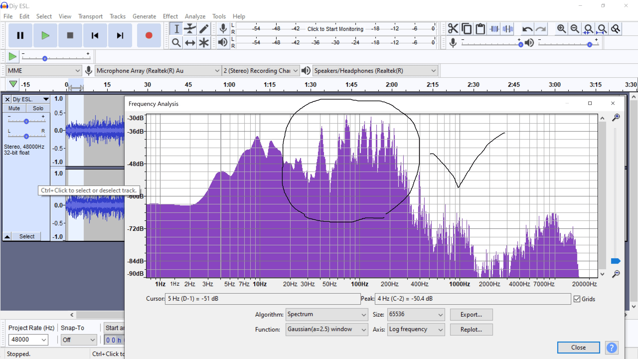

The spectrum of the plucked double bass intro in your youtube clip shows very clean peaks. Looks like your ESL bass panel design does great impulse. Gives that dynamic live sound:

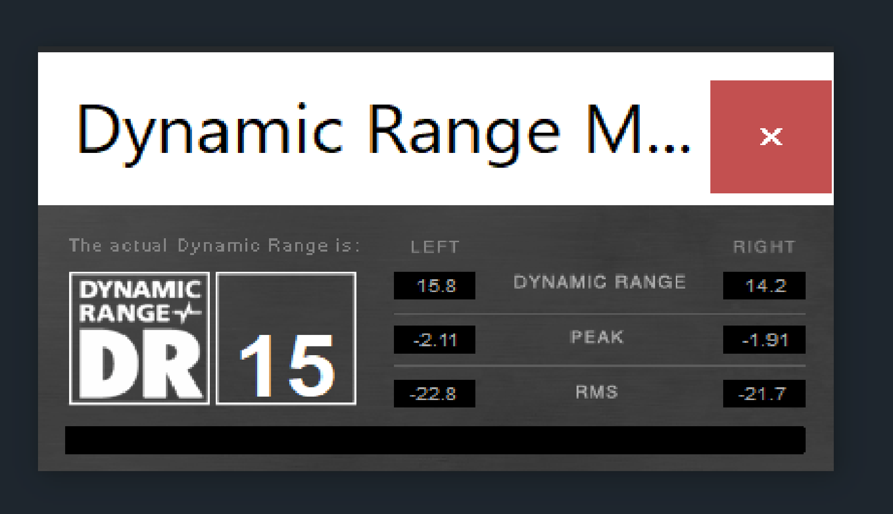

Dynamic range analysis = 15 !ESL has an amazing voice. What grabbed me was the dynamics.

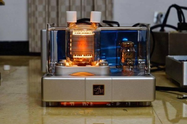

Now I am building a 300 b amplifier it would be interesting to test the ESL without step-up transformers. If I finished my system building, I will start to build this ESL. It's a fantastic project and congratulations to it.
It is unlikely that 300V will be enough voltage at the anode to swing the ESL.Now I am building a 300 b amplifier it would be interesting to test the ESL without step-up transformers. If I finished my system building, I will start to build this ESL. It's a fantastic project and congratulations to it.
But the Soviet tube GU-48 is able to do it, it has 3000 volts at the anode output.
Several amplifiers are made on this tube, only one power unit weighs 40kg))).
Here is this tube in all its beauty:
