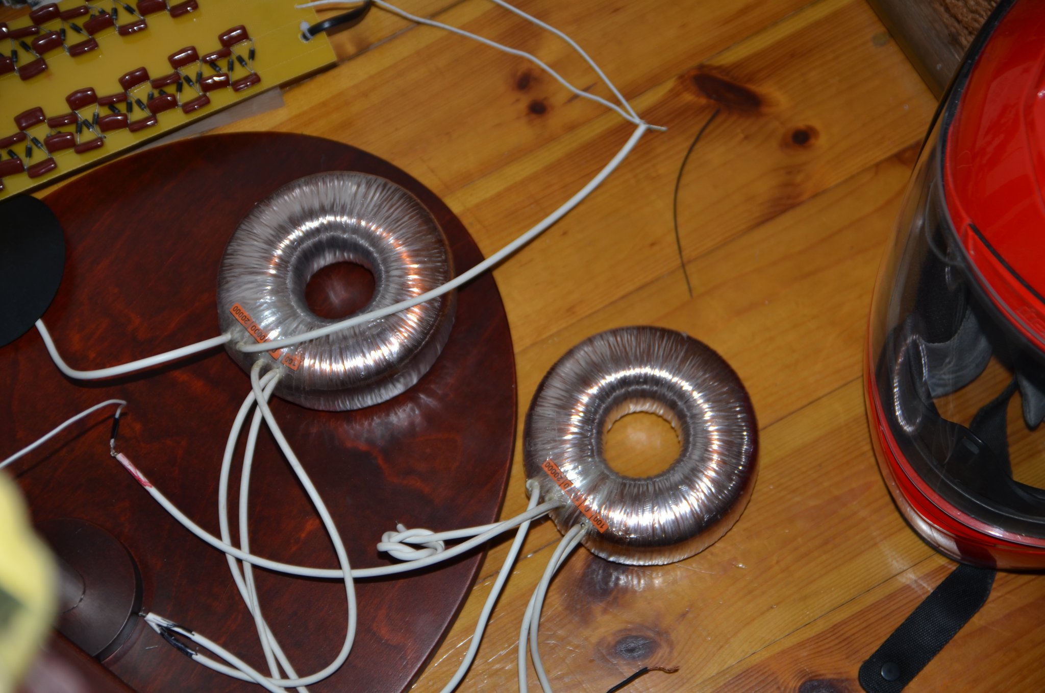

I mentioned here that earlier 7 years ago I had only one subwoofer ready and I connected two step-up transformers, making the connection in series-parallel, which means the transformation ratio was not 200, but 400 times.
Hence the energetic double bass.
A couple of days ago I did the same thing, but with two subwoofers and four bass transformers.
My conclusion is this - guys, do not spare the iron and copper transformers if you do bass step-up transformers 🙂 .

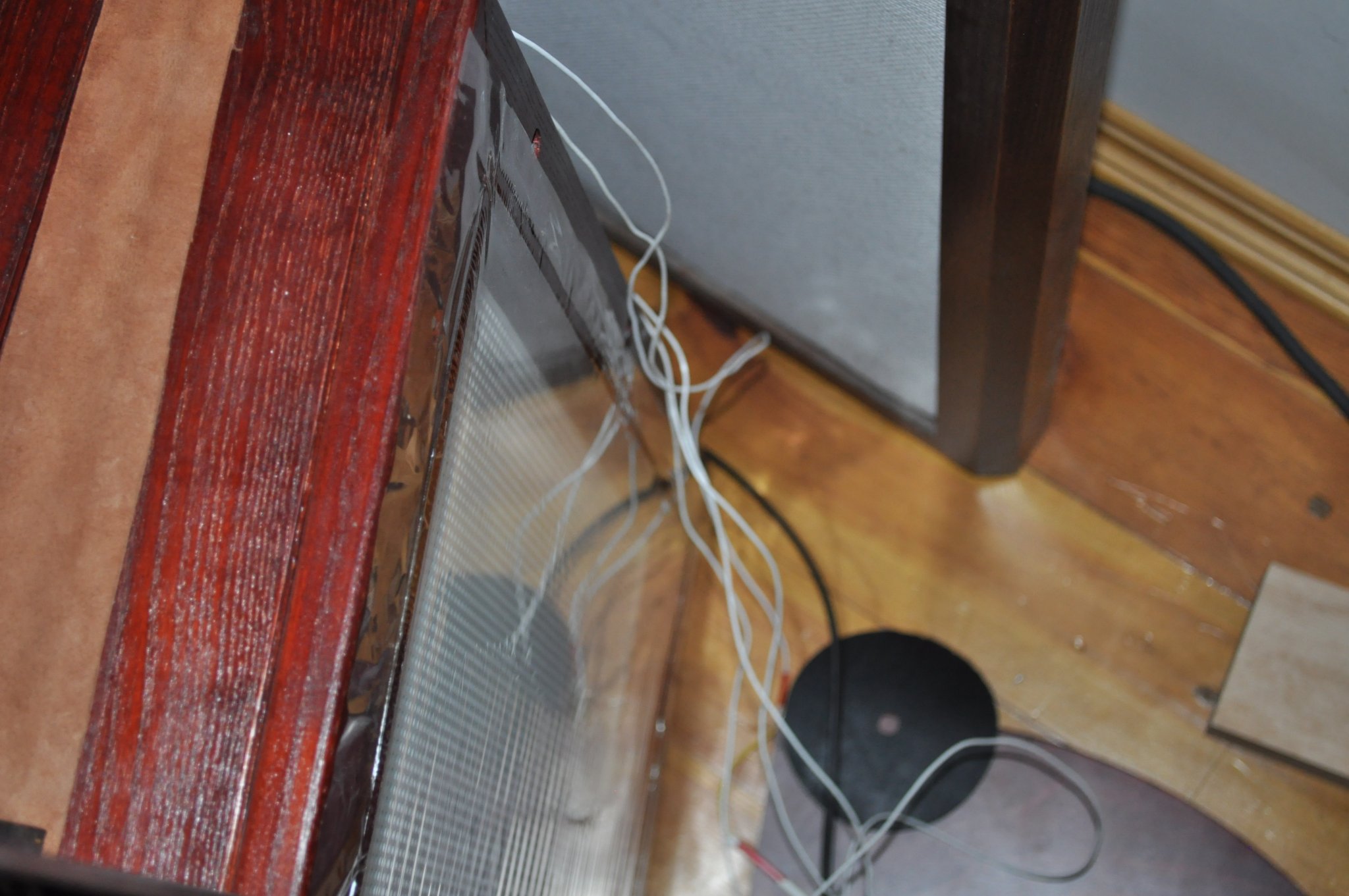

Hi friends.
Since the thirst for creativity haunts, I decided to temporarily do what I had been planning for a long time, and for now, on the one hand, glue the film directly onto the subwoofer case to listen to how it affects the sound.
What is it in essence ?, an additional passive membrane attached an additional mass of air that is in a mobile state and not in the closed space of the box, this membrane is also absolutely transparent to the sound of all frequencies from the back of the radiator.
But!, this membrane is important to me as a damper of the main resonance of the entire subwoofer and ... it works.
Основной резонанс размазан, НЕ торчит отдельным, ярко выраженным пиком настолько, что мне даже эквалайзер не нужен, но я все же оставил эквалайзер для отбивания самых низких частот (20Гц) выдаваемых парой трансформаторов с коэффициентом трансформации 1:400, чтобы не перегружать мембраны упаковки и не приводить к вспышкам высокого напряжения.
I remembered why Kvod makes such passive membranes on both sides and this is not at all to protect against dust, or rather not in the first place, but in order to smear the main resonance.
Dust protection is just a bonus because Martin Logan doesn't install any dust protection and their speakers have been running great for decades.

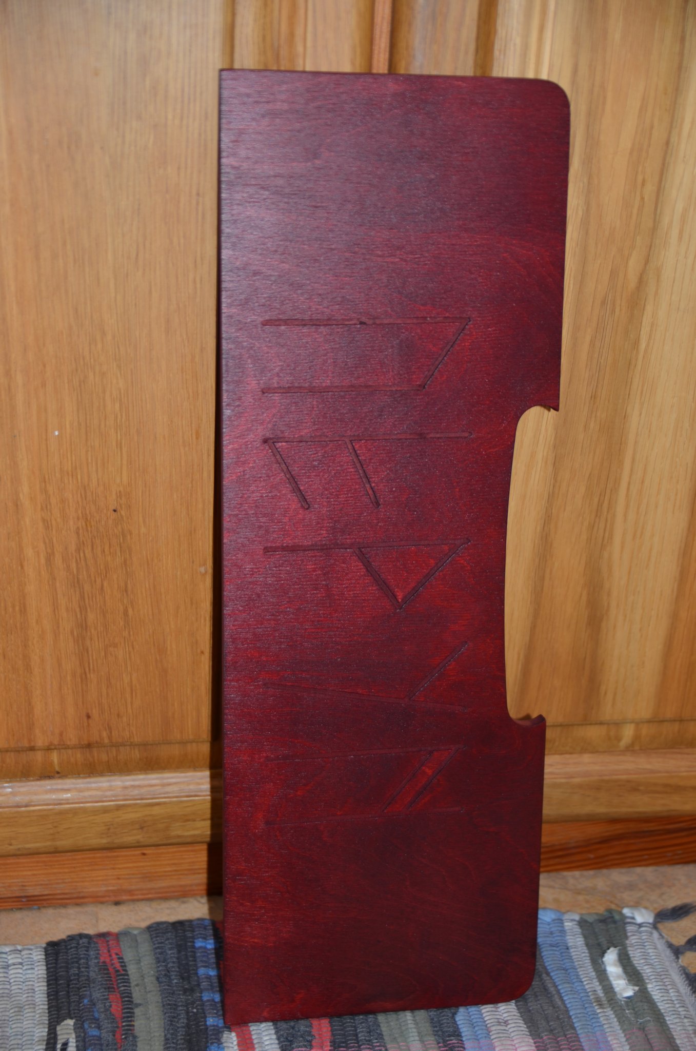

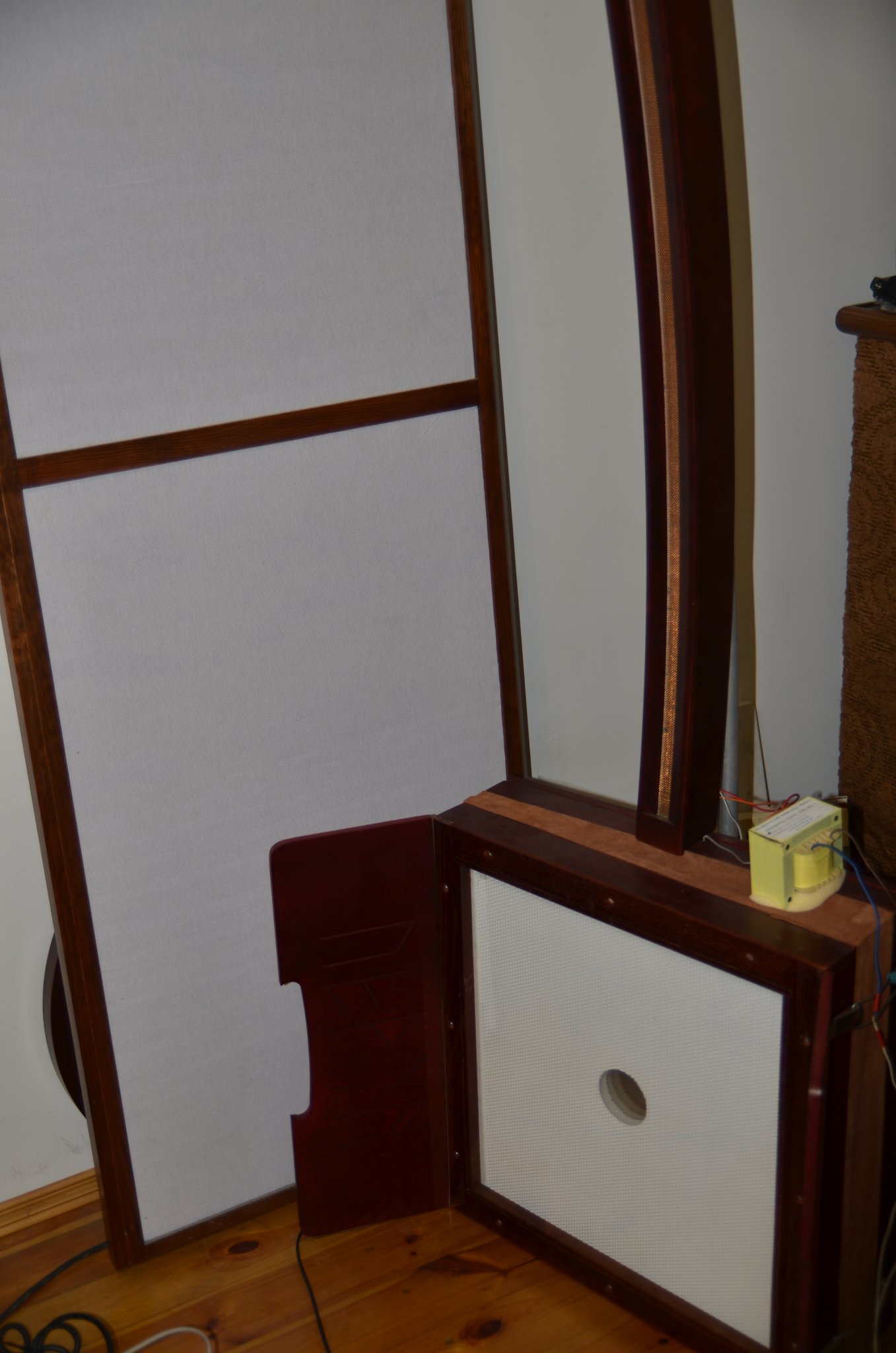

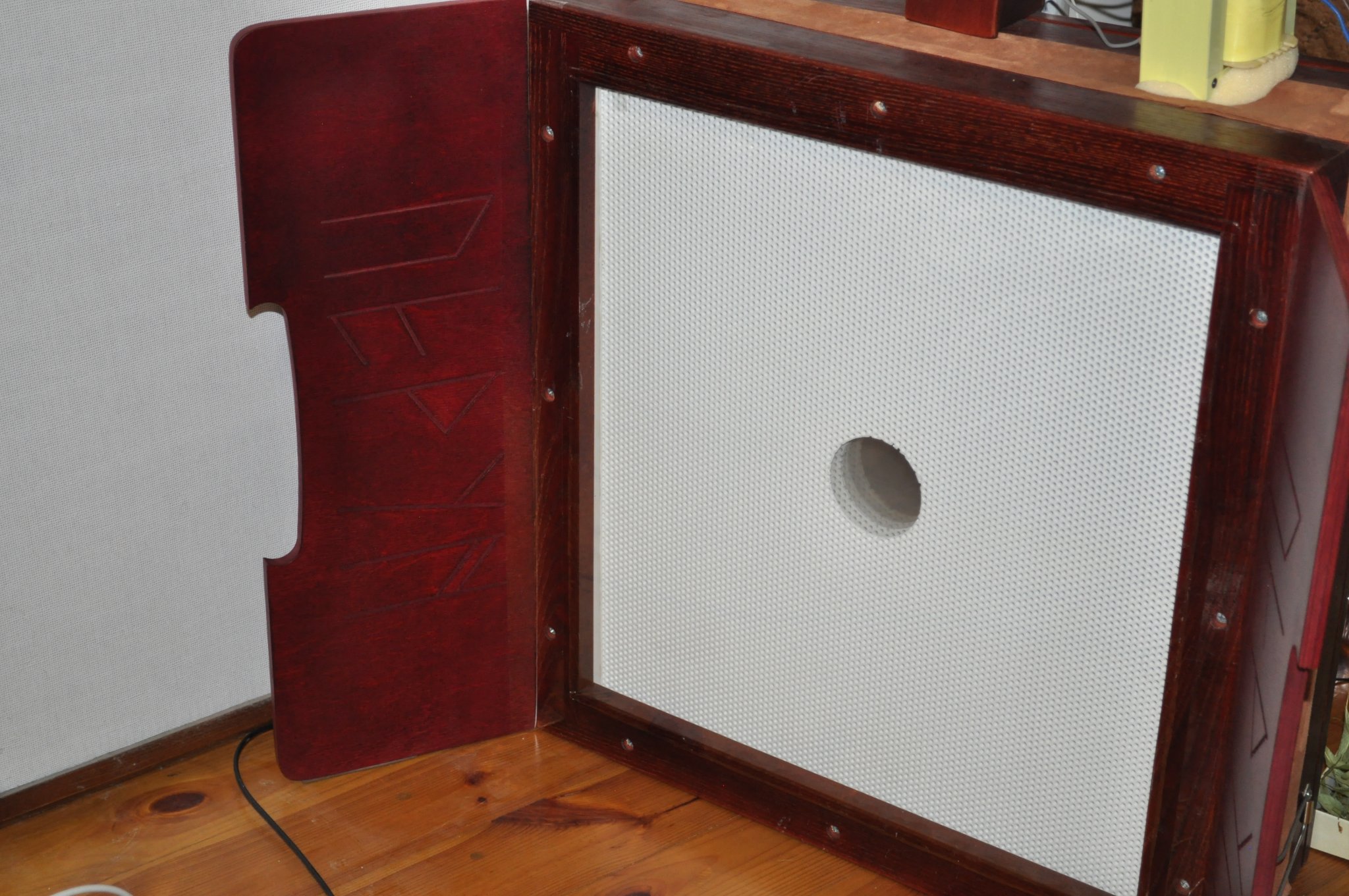

Hello friends!
What do you think, why did I cut out on a CNC machine yesterday, and today I painted four such parts from an airbrush?
A little hint - they are the same size as the height of my subwoofers😀.
In short, I made two cheeks for each subwoofer imitating a horn, they are adjustable in terms of the opening angle of the horn.
This gives some increase in the general, subjective energy at certain frequencies, namely in the mid-bass.
I also connected the subwoofers to a separate amplifier, this is definitely better, but the amplifier is rather weak.

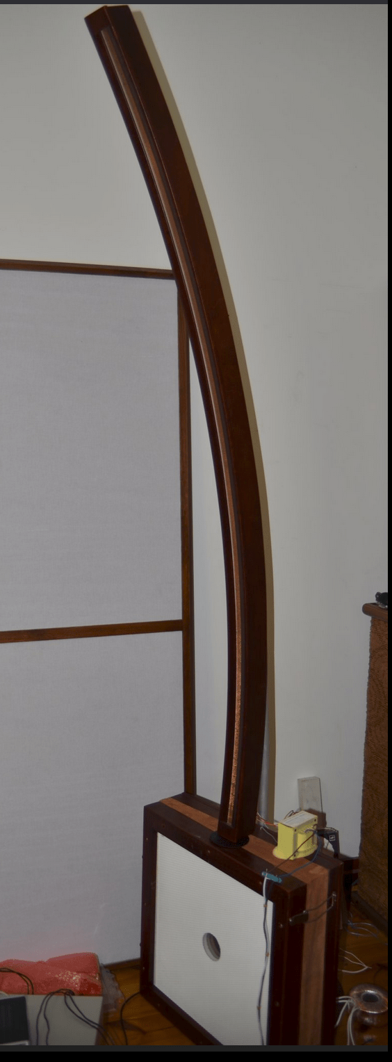

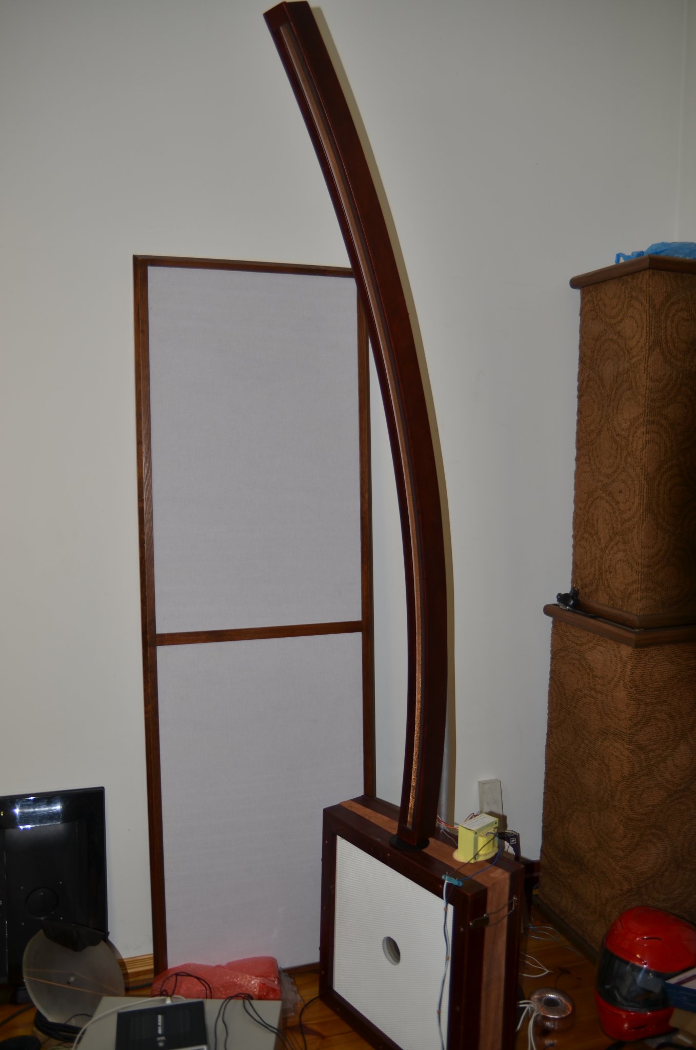

Hey Jesper.
Of course, we are here to share opinions.
I've tried many different forms of electrostatic drivers and this is exactly what I came up with.
First of all, its clear advantage is that in the horizontal plane it is only 20mm.
And we remember well that the sound wave length of 20 mm is 16 kHz. That is, in this case, the range up to 16 kHz will NOT have sound directionality, but is broadly directed up to 16 kHz. And this, in turn, means that the sound does not have a specific sound color with such a directivity of sound, but is tonally correct (smooth).
But!, we also remember well that an electrostatic is an insensitive emitter and it needs a large radiation area to compensate for this.
To do this, I bent a long tape of the emitter (1900 mm.) In a vertical plane and thus collected the sound from the entire length of the tape and fed it to the listener in the same time mode, that is, the sound comes at the same time from the middle of the emitter and its edges and thus, a point source of sound is realized here, although in practice it is elongated in vertical space.
In my subjective opinion, such a transducer is the most accurate and true of all that I have ever done in the field of medium and high frequencies, and I have tried straight and curved (a la Martin Logan) forms.
