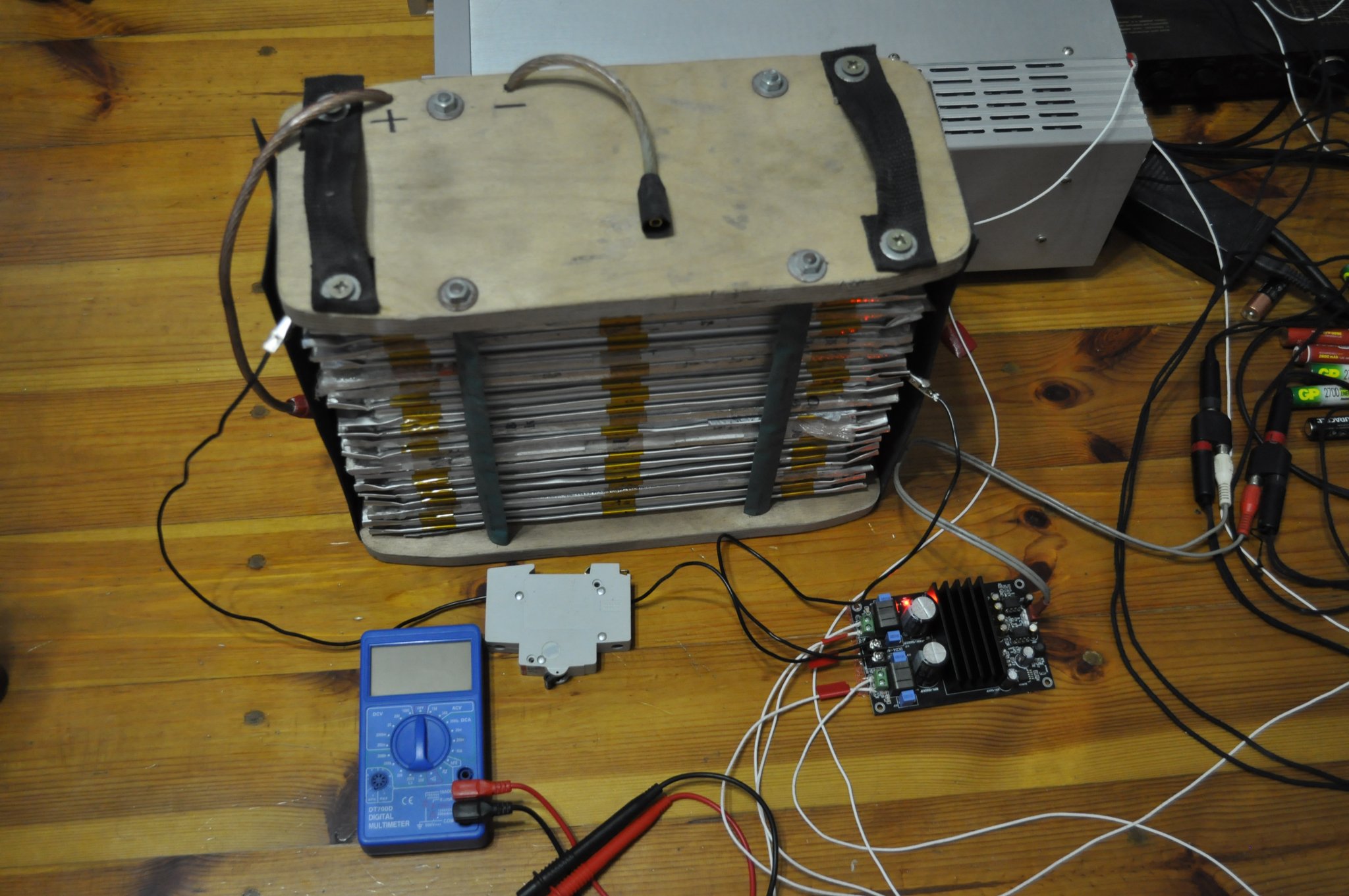

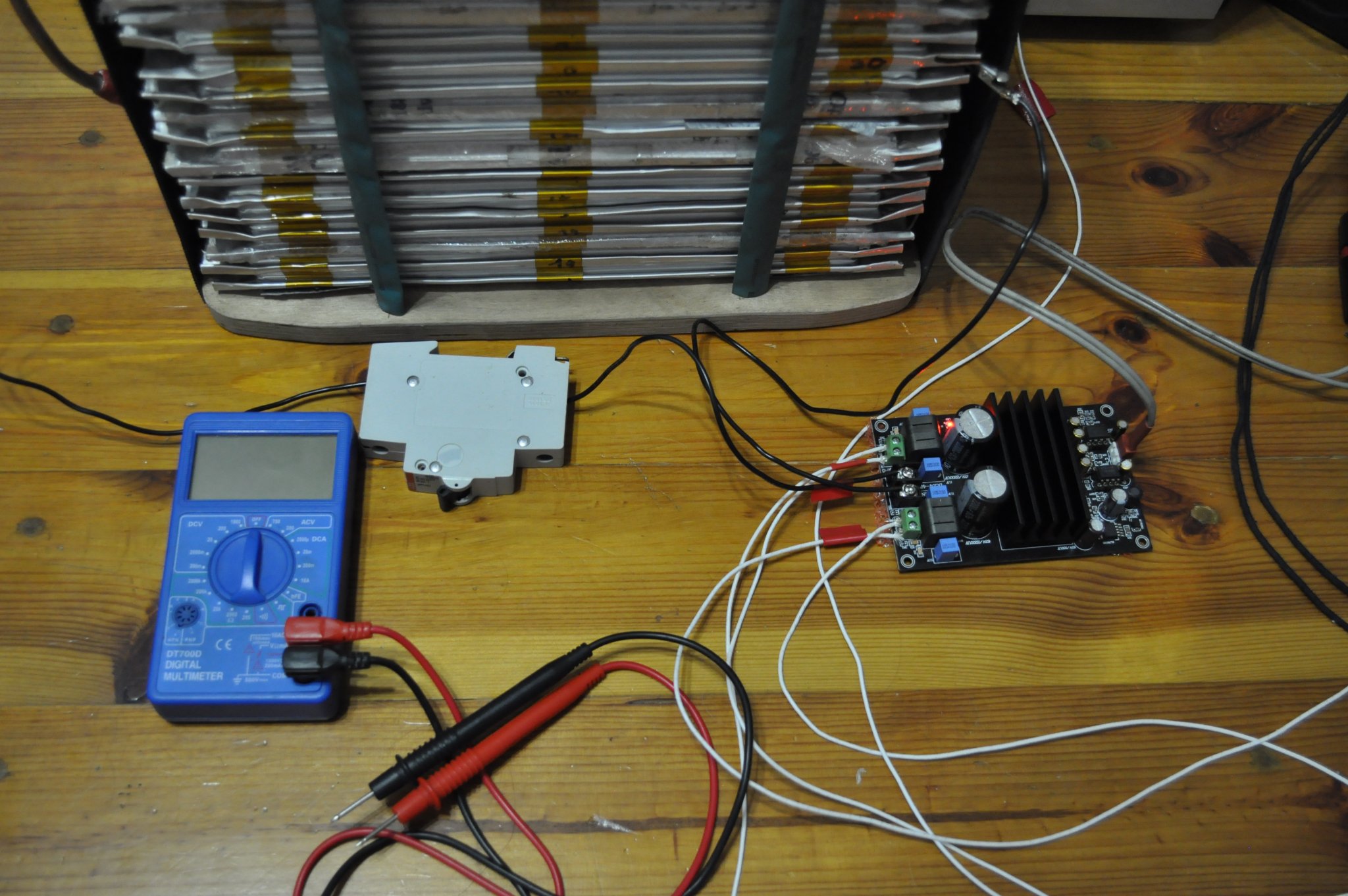

By the way, now I use two different amplifiers, that is, channel-by-channel amplification, in the low-frequency register I use an amplifier in class "D".
And I feed it from the battery (30 volts).
The battery is capacious 48Ah.
It will be enough for 1 month of everyday listening for at least 6 hours a day, and I greatly underestimated this.
To be honest, I'm delighted with this baby that fits on a child's palm 🙂.
He does not care at all for such a complex load as electrostatic subwoofers.
The temperature on the microcircuit heatsink does not exceed 50 degrees Celsius. The real power is 125 watts per channel, the advertising power is 350 watts per channel 🙂.

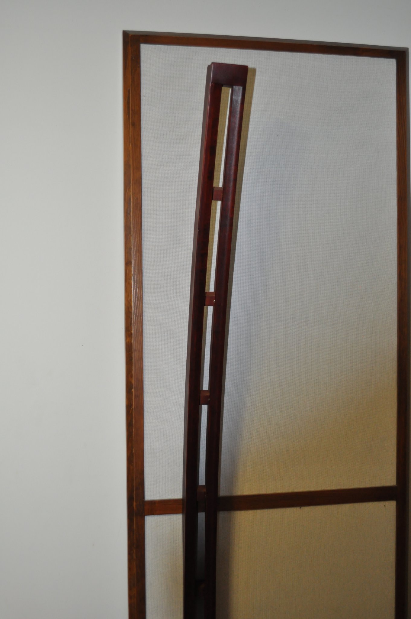

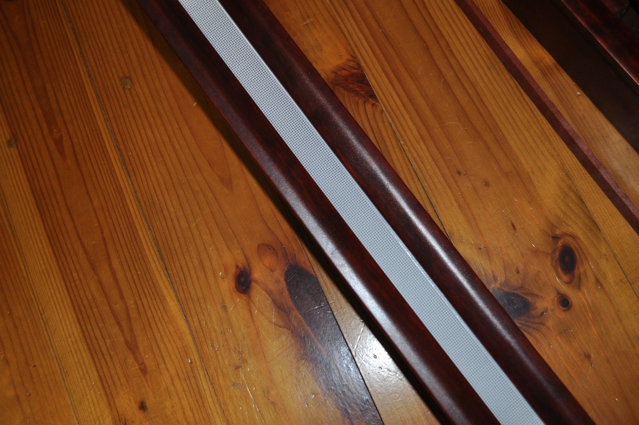

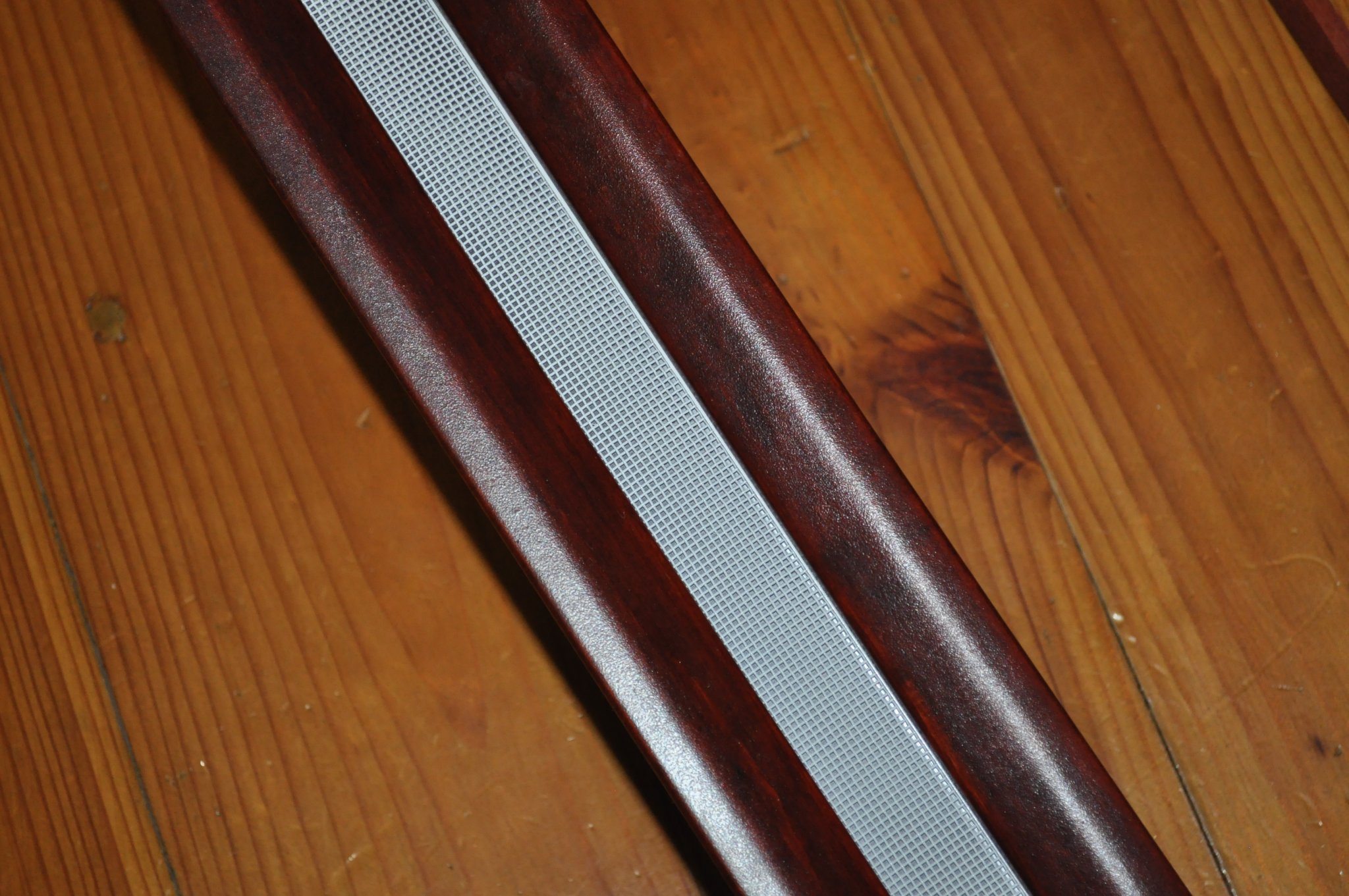

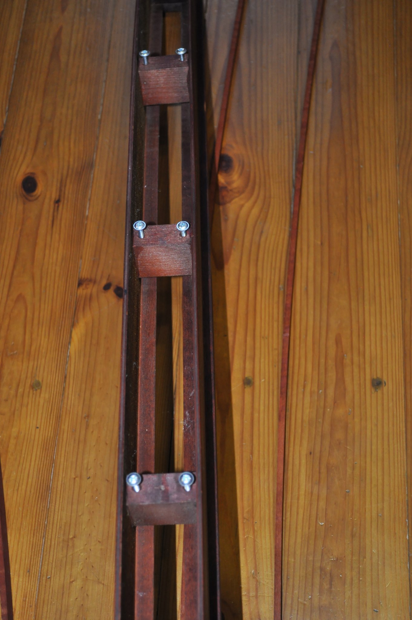

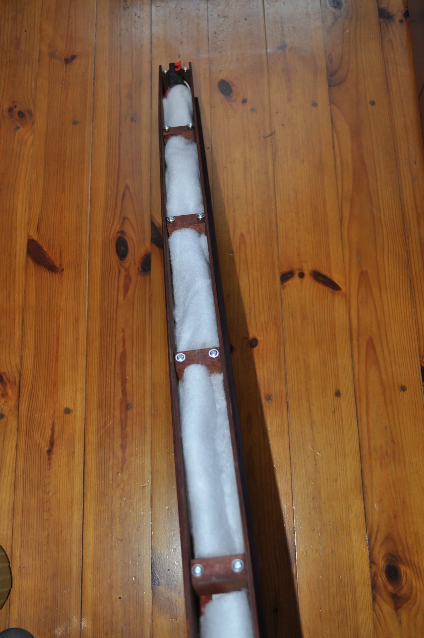

Hi guys.
Already here I wrote that from the very beginning I planned to supplement this strip (20mm-1900mm) with acoustic design and of course I tried its return without acoustic design and with it.
So, when the strip itself is suspended evenly stretched from top to bottom, it practically does not play at all, that is, it plays very, very quietly even at those frequencies that correspond to its physical size.
But!, when it is bent vertically, the return at these frequencies increases several times.

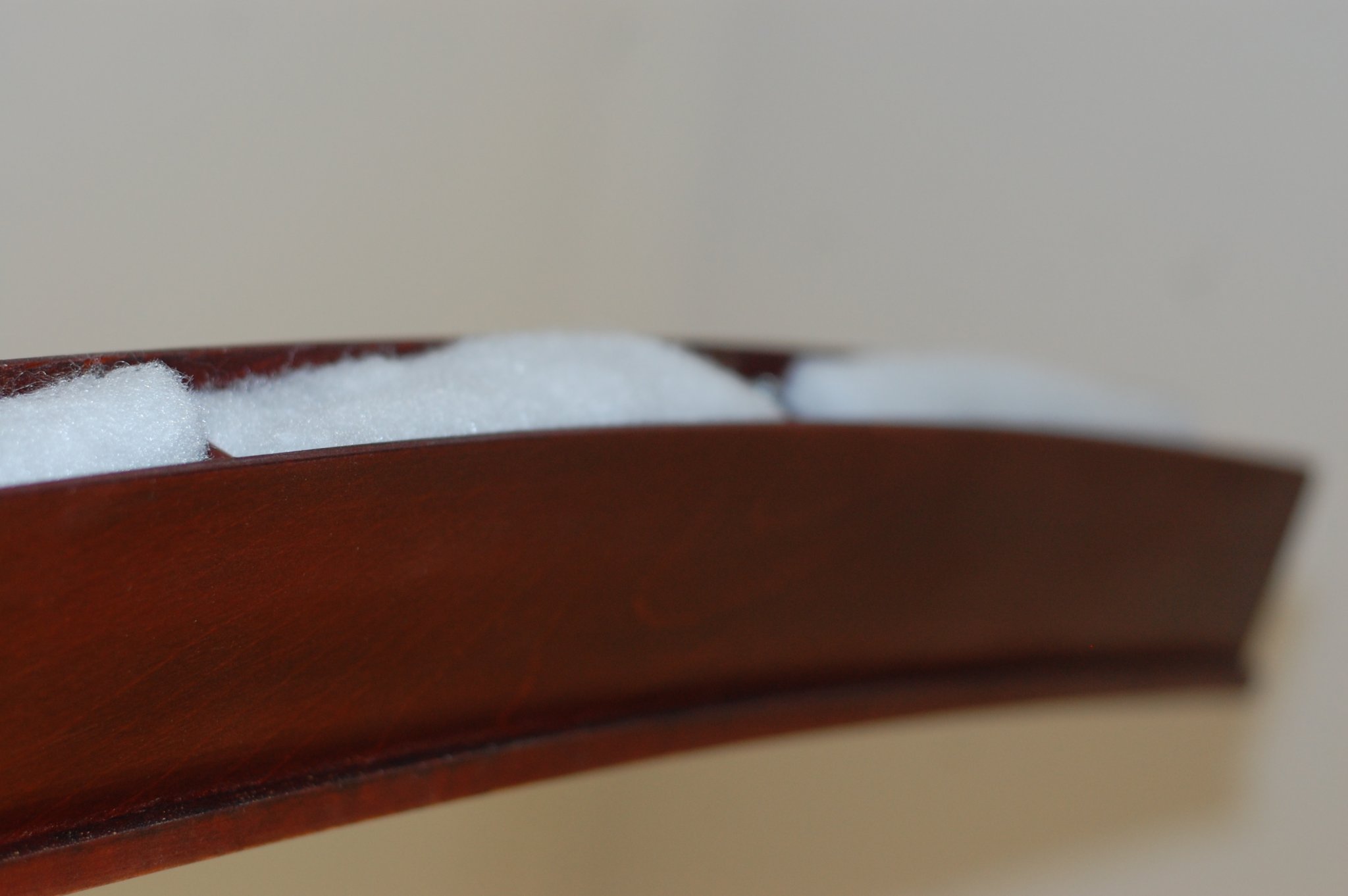

And if it is placed in a wooden case of the "open box" type and filled with padding polyester, then it is generally excellent, that is, it works down to 600 Hz.
Without filling with synthetic winterizer, a hump appears in the Amplitude Frequency Response at the lower frequency (it is perceived by ear as a high wolf howl).
Just as you will notice in the photo, there is a small horn in the wooden case.
All this in a complex, namely, the vertical curvature, the acoustic design of the "open box" type and the horn gives that increase in sensitivity and expansion of the range down, which I described here at the very beginning of the topic.
So there are no tricks in this, but there is a rational explanation 🙂.

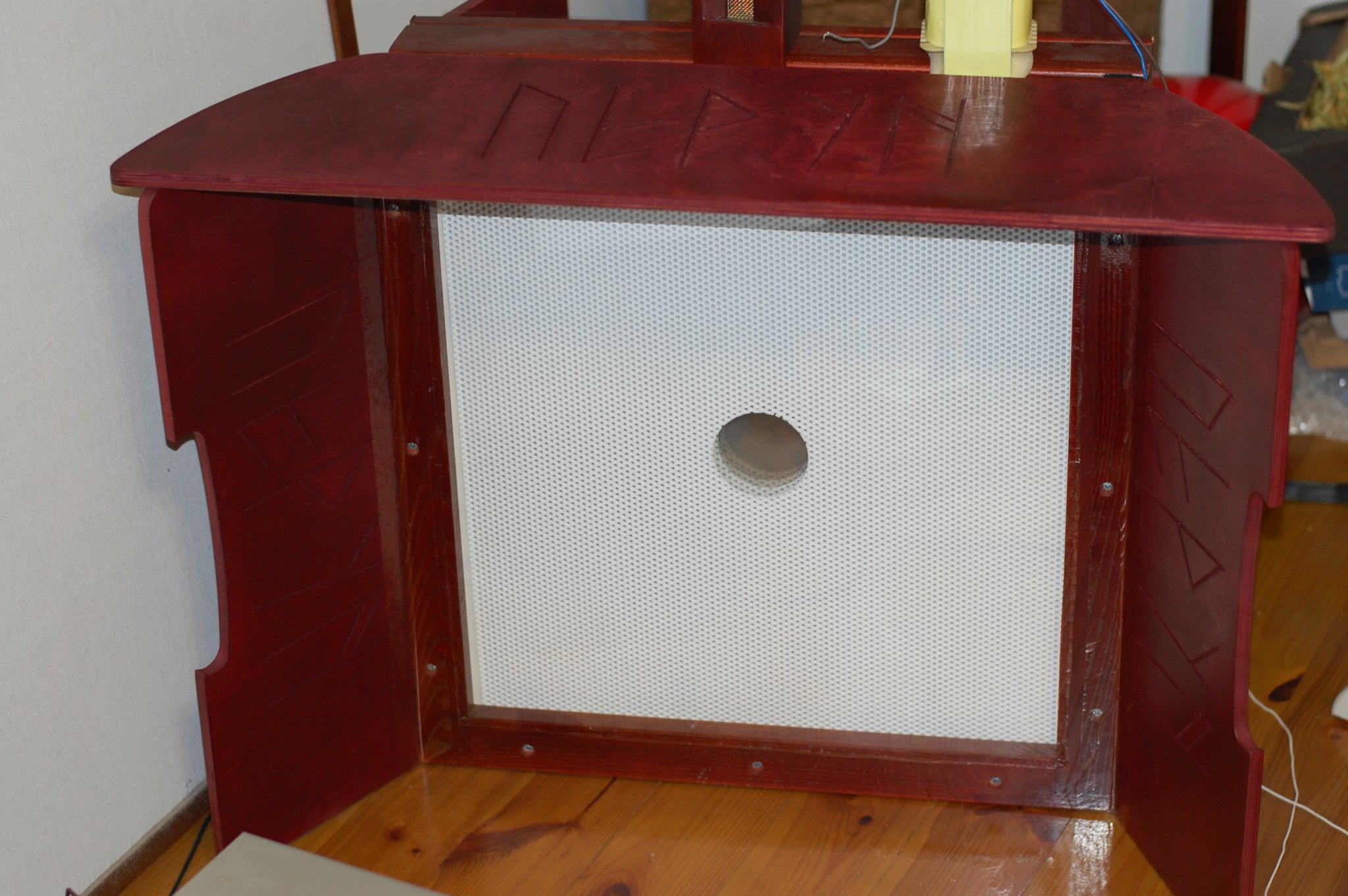

I also made a horn for the subwoofer, it is customizable, I will write about it later.

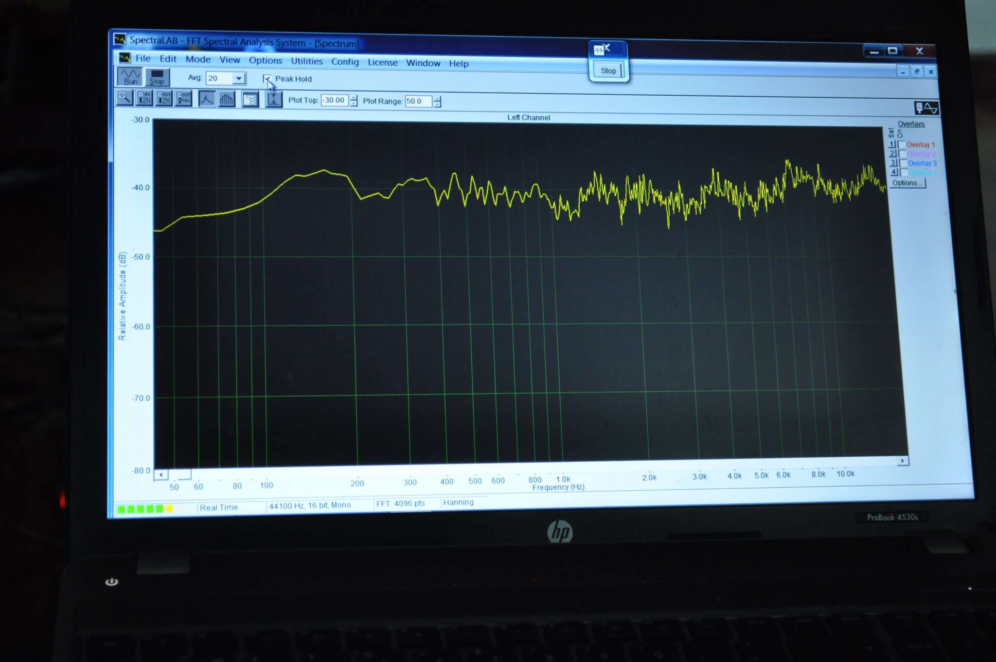

I made measurements of the amplitude frequency response from the LISTENING PLACE, and this is 3 meters from the speakers to the sofa 🙂
The microphone was at the level of my head.
That is, everything is like in life.
But the sound card of this laptop overwhelms the low-frequency region, a little later I will install the program on a computer where this will not happen and I will take measurements again.

@havun : ... Hi again ..

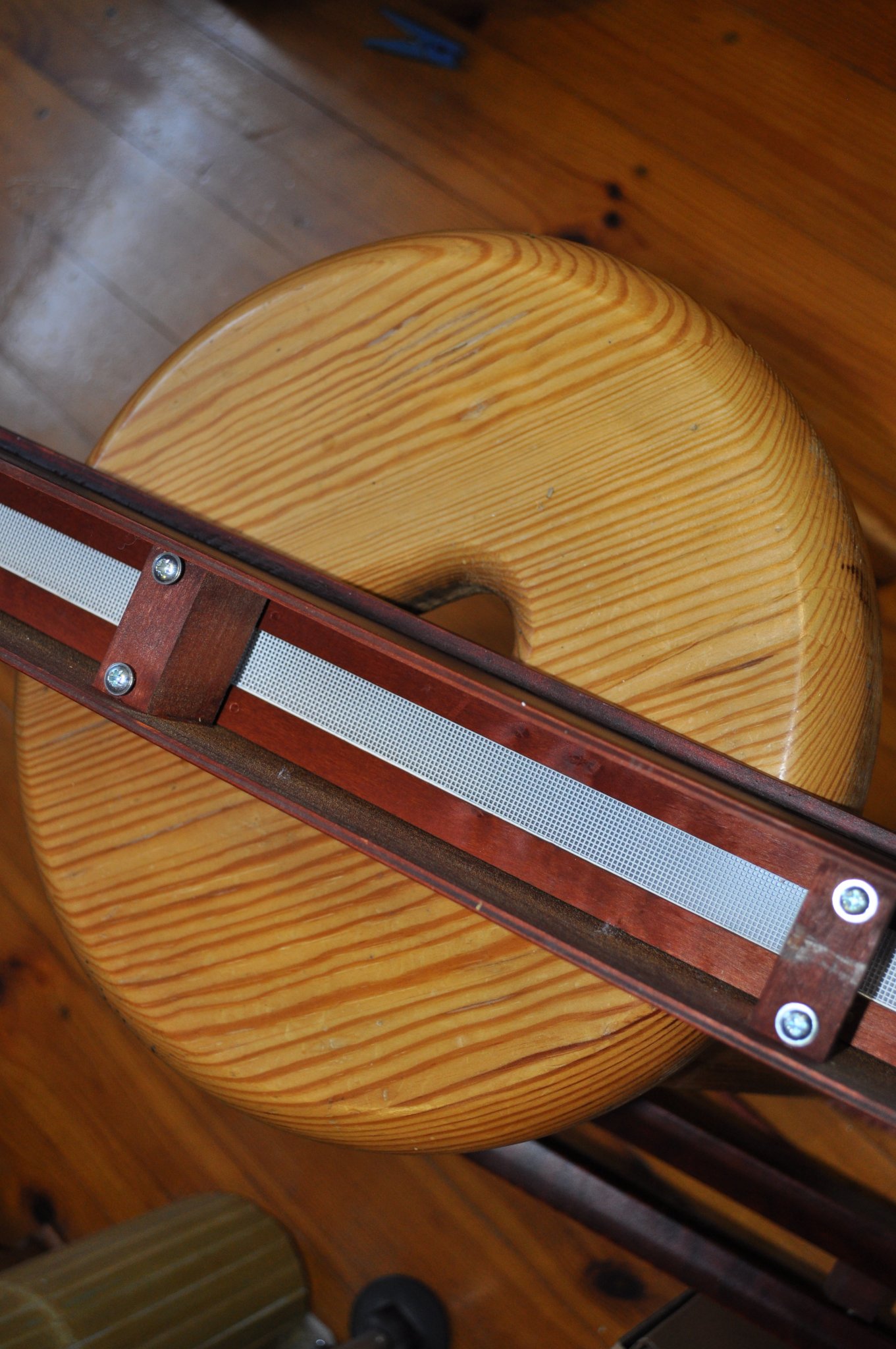

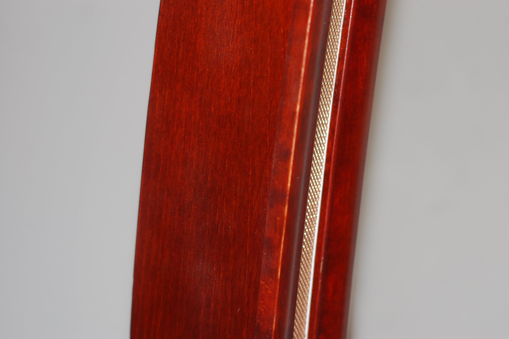

Might I ask you ... So, just to get a clearer understanding of how the HF unit is made: You have a strip of bronze mesh at the front surrounded by a slightly horn-shaped wooden structure. And, then, behind the bronze mesh you have some damping material - and then the wooden structure is closed at the back so that the transducer itself (bronze-membrane-bronze) is mounted in a closed enclosure. Do I understand this correctly - or did I miss something?
Jesper

This is such an acoustic design, there is a closed box, there is a phase inverter, a labyrinth, and there is an open box, and so I have an open box, it is not hermetically sealed. But the synthetic winterizer material (like cotton wool is only lighter) in order to "lubricate" the main resonance of the panel and load the membrane acoustically.

Today I worked a lot from the very morning, namely, I dismantled my high-frequency drivers and painted bronze stators with acrylic car paint in three layers. But for this I had to remove the old membranes and make new ones, since they are glued to the stator insulators, white plastic insulators and they are non-removable. I also isolated everything more carefully.Where the screws enter the wooden blocks, metal nuts are pressed on the back side and in this way the driver's sandwich is pressed through thin wooden planks along the entire length of the wooden case.
I did this (painted) to isolate the stators so that I could give more signal and not be afraid of a breakdown.
I took a few photos of how the driver works:

Has the stator insulator a bit of leaky character (for example PVC at Audiostatic or carbon black added powder coating at Final)?

Hi Havun .. thanks for posting the pictures - I think I am now able to visualize what they look like in detail
... One question, though, just to make sure: On the pictures it doesn't look as if there's any kind of plate attached to the backside of the wooden frame - is that correct? That is, you have a structure being ... stator-membrane-stator-damping material-open back .. which is surrounded by the u-shaped wooden frame with a slight horn-loading on the front?
Would that be correct?
Cheers, Jesper

I understood what you mean, in the very first columns (very large in area, they are here in the topic) I used black paint, the color pigment of which included an electrically conductive material (very high-density), in its action it was equated to some the proportion of soot in the paint on the stators.Very nice woodframe!
But, to be honest, I did not notice any striking difference between this paint and ordinary acrylic paint 🙂, but acrylic paint is good because it dries quickly. Therefore, I did not bother.
