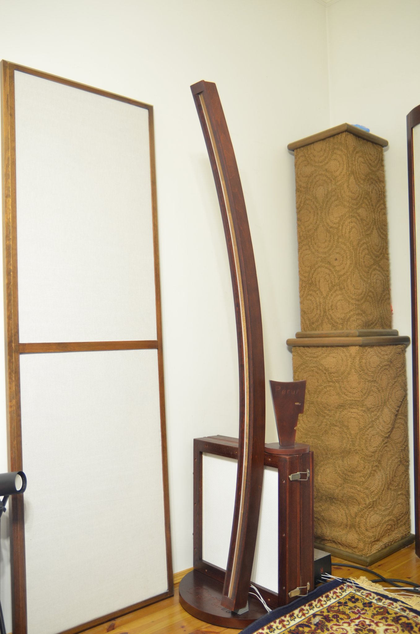

Full-range, two-way ESL

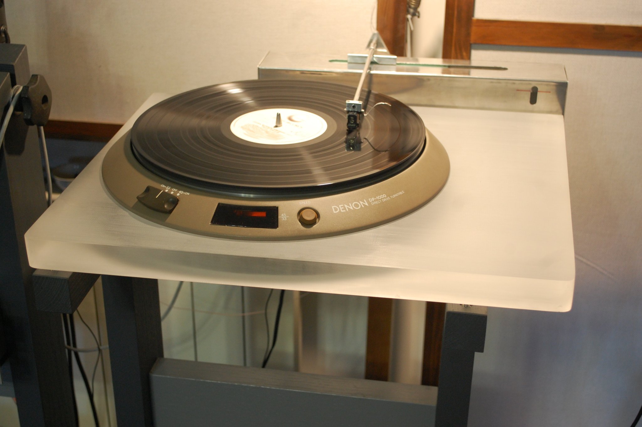

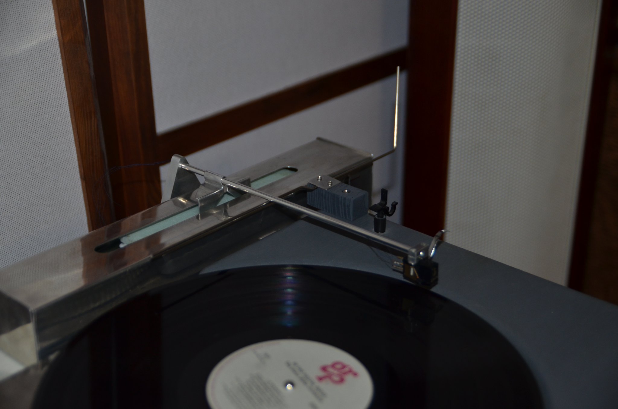

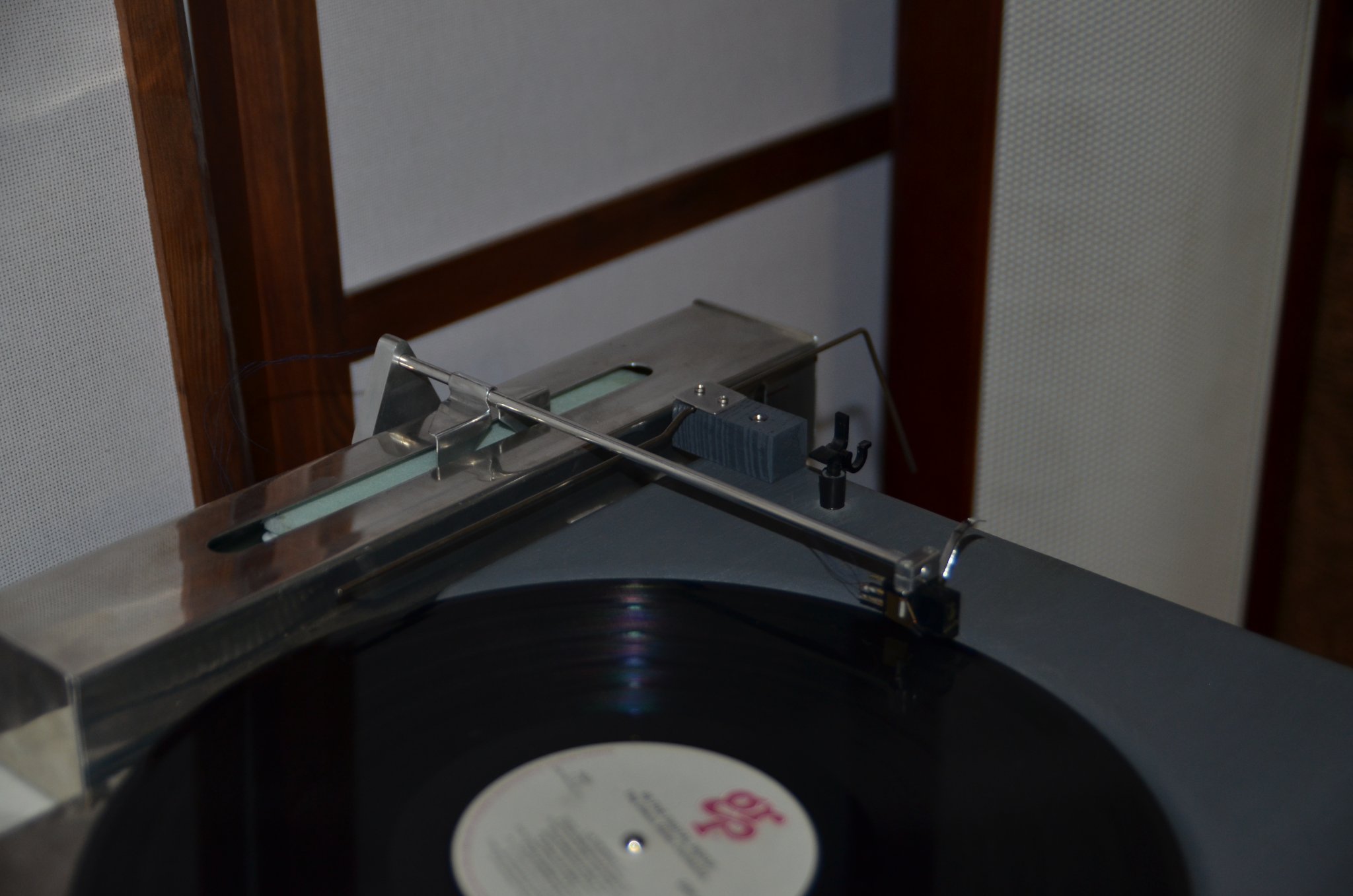

The microlift is ready, it works very correctly.
Its purpose is not only to lower or raise the tonearm, but also to attract the float with rollers to the glass wall of the aquarium. That is why it is of such a design.

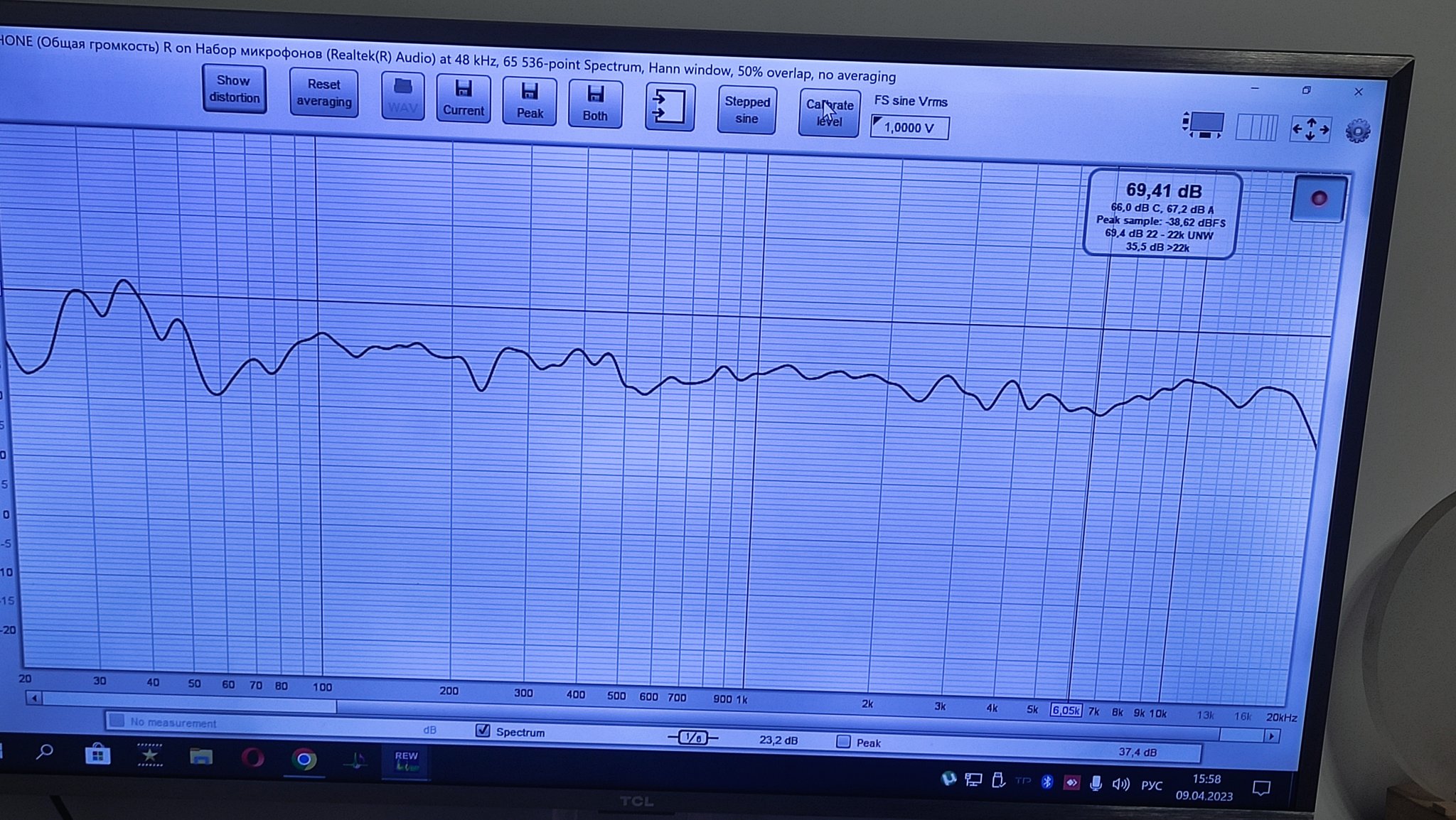

Hi.
Everything is working fine.
Amplitude Frequency Response graph from the couch, i.e. from the listening position.

aah its a reversed arc, never seen it like that, but looks nice, nice FR as well !

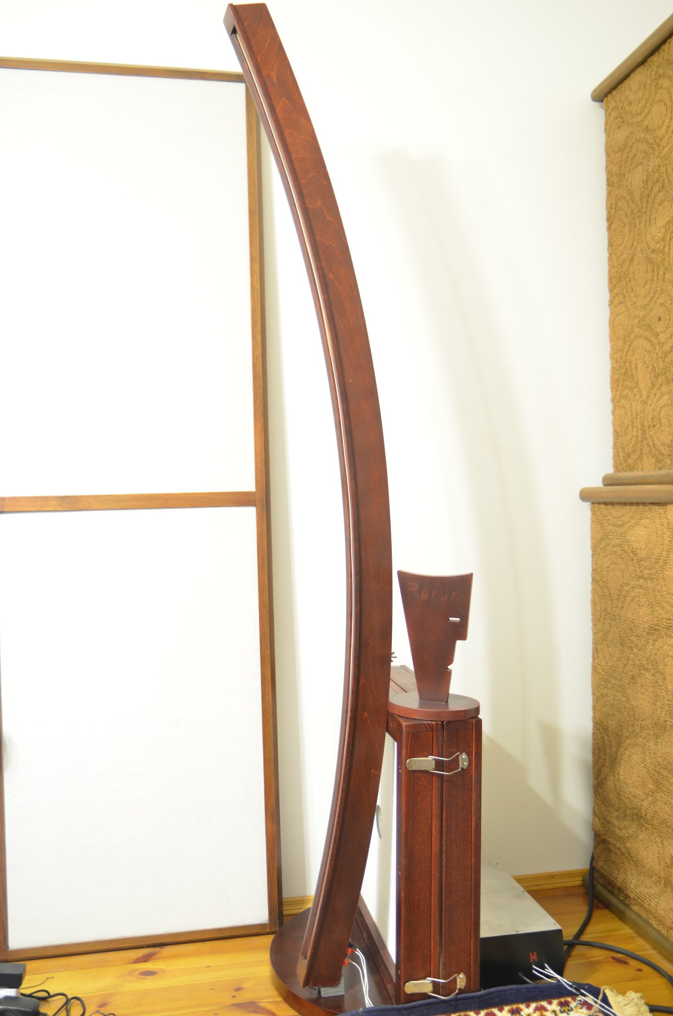

At the beginning of the topic I wrote why I made a vertical arc with a radius of 3 meters.
So that the signal from the entire arc, from the bottom to the top, came to the listener at the same time, because the listener is placed three meters from the radiator.
This greatly increases the sensitivity of the radiator, several times over.
And also the signal is very accurate, there is no interference "mush".

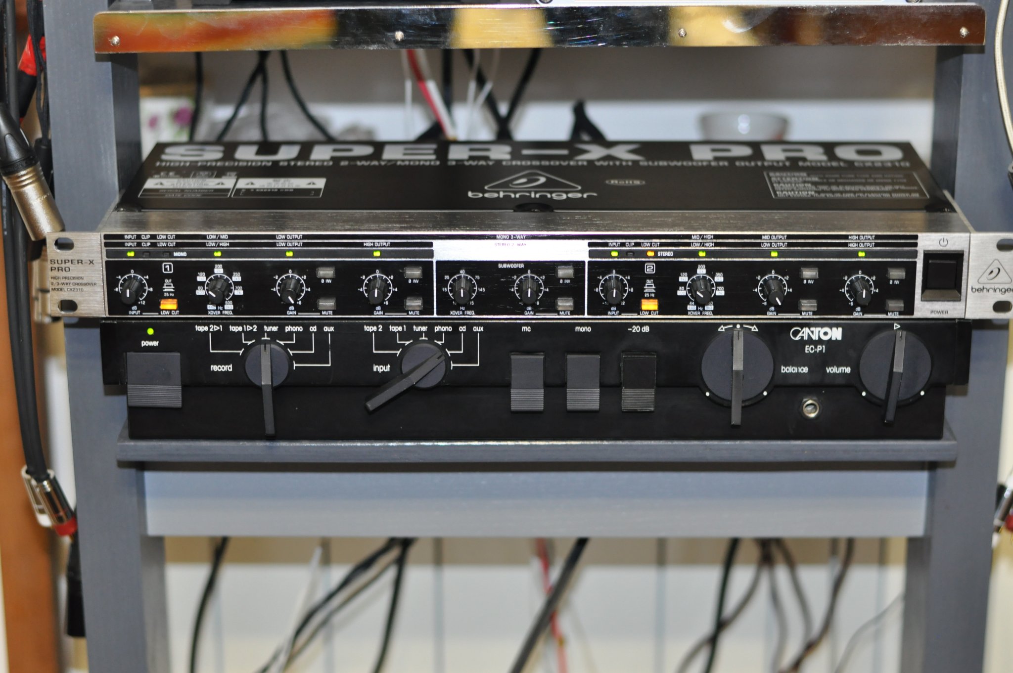

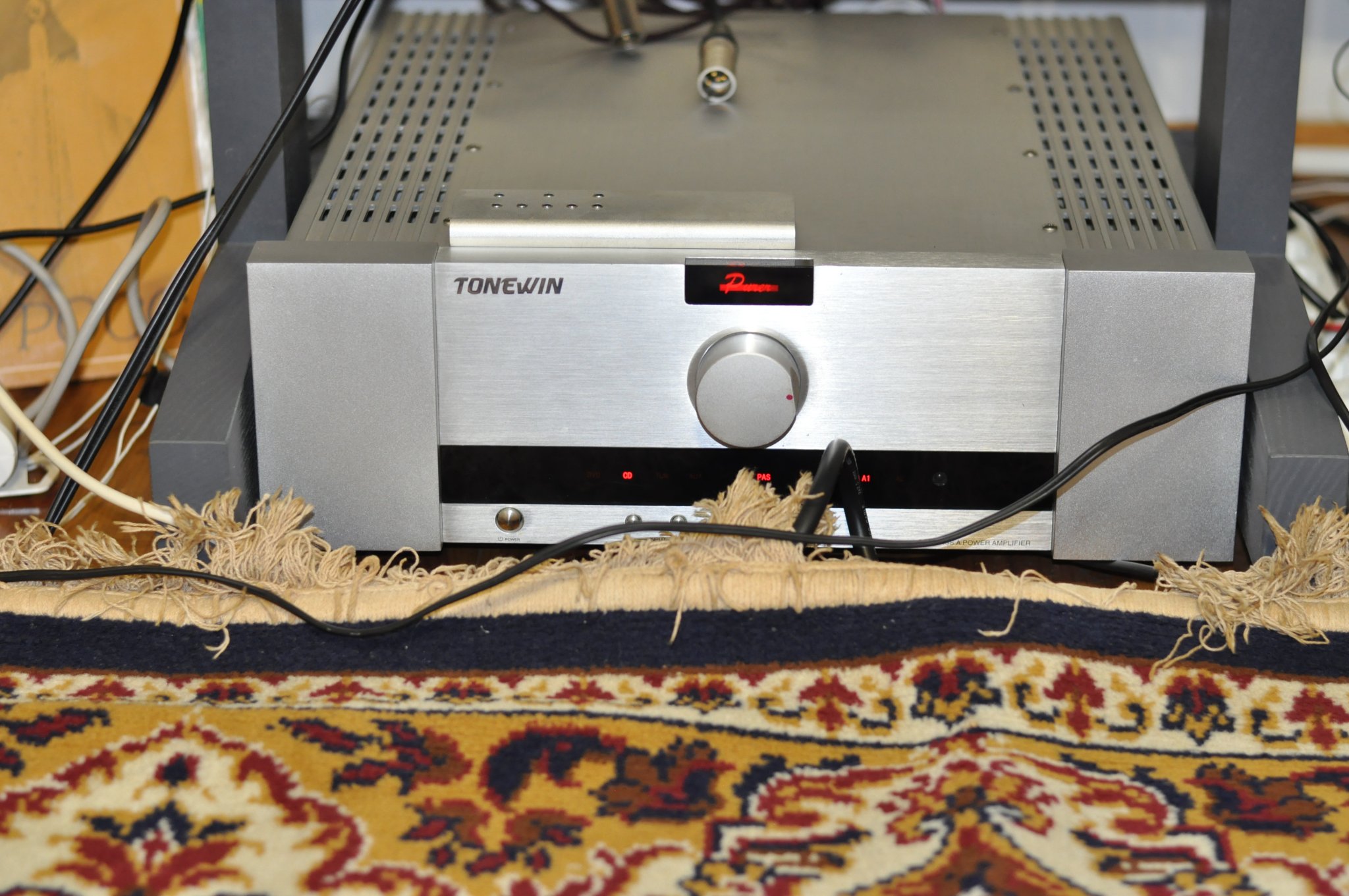

I can't stop yet, I recently bought a Kanton preamplifier, I like it very much.
So much so that I even removed the digital equalizer from my rack.
I also went back to my huge Tonevin amplifier, which is a Chinese hybrid high end amplifier.
It works in class "A" up to 30 watts, and then it automatically switches to class "A+B".
I was not satisfied with the sound of the high-frequency driver in class "D", a little unnatural sound and there is a very big peak at 12kHz.
With the Tonevin everything is smooth and even.

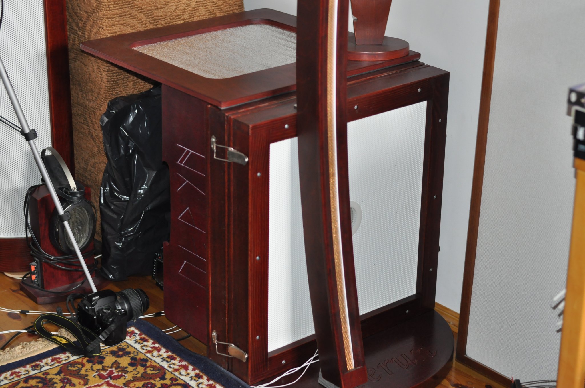

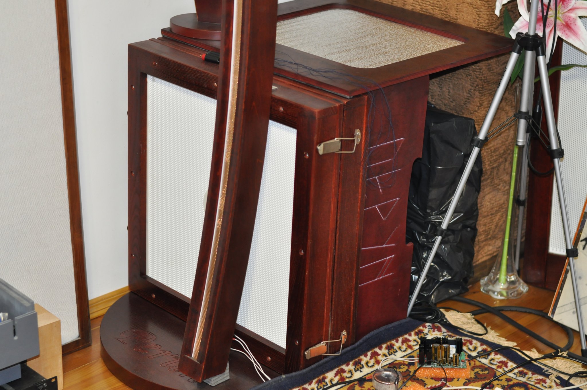

And I excluded the equalizer from the rack also because I acoustically shaped the low-frequency link, the main accent in it were two old synthetic blankets, and not even this is the most important, but the fact that I put them in plastic bags and closed tightly, as a result they turned out to be two bubbles filled with air and synthetic.
I strongly recommend that you do it and post the result here to make sure that works not only me🙂.
And yes, my crossover turned out to be analog, I was wrong to call it digital.

Hi Havun, nice project!
>Once visiting this forum, I posted a photo of my ESL where horizontally bent panels a la Martin Logan appeared and I was criticized by several people for this that allegedly these panels emit an incorrect high-frequency signal and at the same time the temporal characteristics are violated, that is, an interference porridge is obtained
As your bend units focus on 3 meter, do you also not get interference patterns when not in the sweet spot? Did you do measurements at other distances/to left or right?
Hi, I've written about it here before. The high-frequency transducers in the horizontal region are 20mm, which is the wavelength of a 17kHz sound wave, meaning that all frequencies up to 17kHz are NOT directional, but broadly directional.
In other words, in the horizontal plane, where we have a stereo effect, you can move to the right and left, and there will be no lack of high frequencies or interference.
But in the vertical plane there is sound directivity, because the tape (190cm) is bent in an arc with a radius of 3 meters.
Its defect is that it is adjusted only to the location of the head of the listener sitting on the couch, if you stand tall, then partially high frequencies fall out of focus.
But it also has the advantage that the high frequencies are NOT reflected from the floor and ceiling forming an interference, and are delivered to the listener accurate and even, without time delay.Actually the same happens with horn radiators.
The second advantage is increasing the sensitivity of high frequencies and here we must remember that electrostatic radiators make such large size to increase the sensitivity, and high-frequency radiator should NOT be large, otherwise there will be frequency interference, because the same huge area will emit high frequencies and they will come to our ear at different times, forming in the sound of interference mush.
For this reason in the standard version a high-frequency squeaker (for example a dome) has a size of 1 inch (2.5 cm), this is the wavelength of the sound at 16kHz.
But since the stereo format works only in the horizontal plane, this size (2 cm) interests us only in the horizontal plane, so all arrays in stereo build only in the vertical plane, but no one does it in the horizontal plane.
