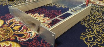

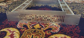

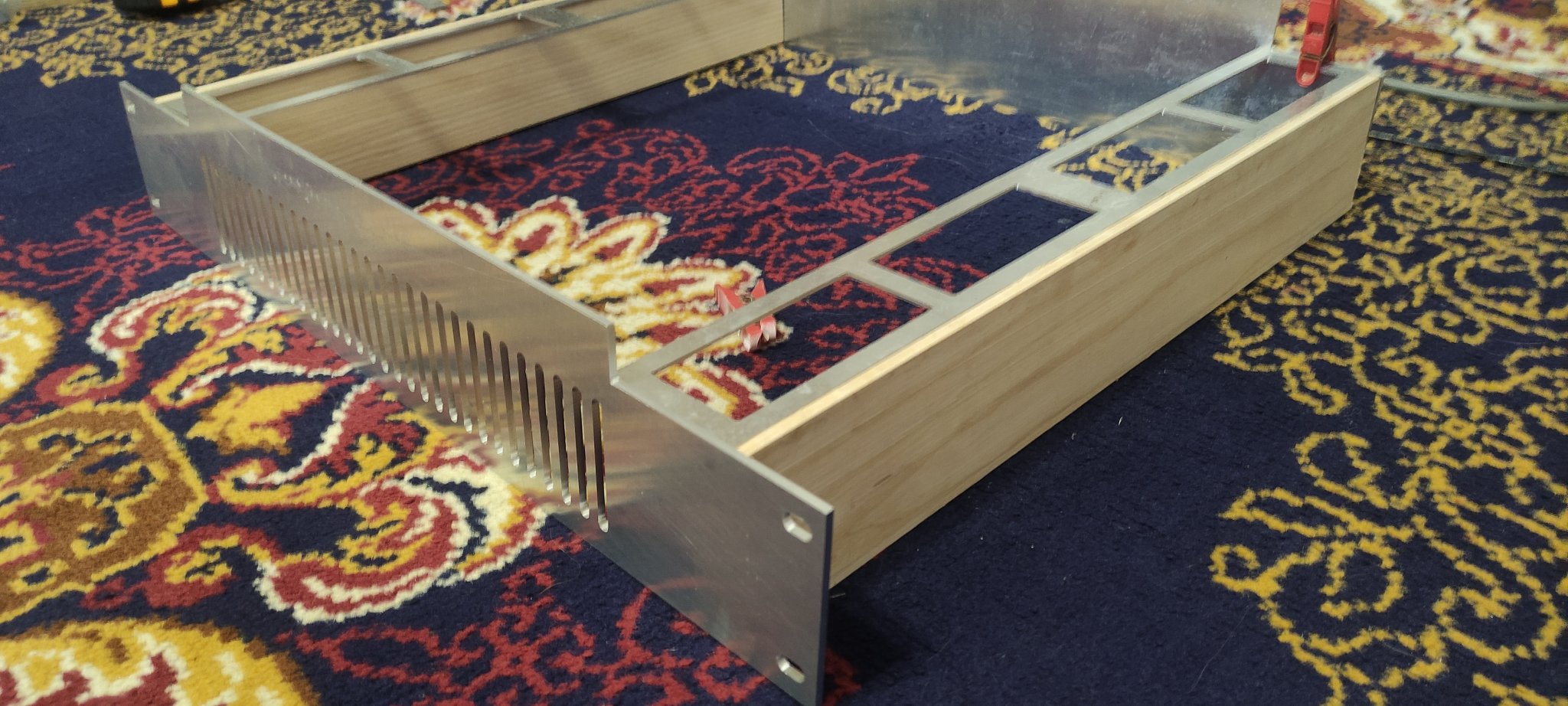

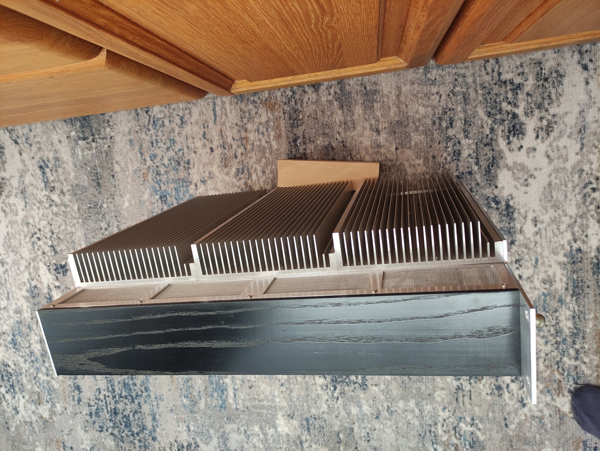

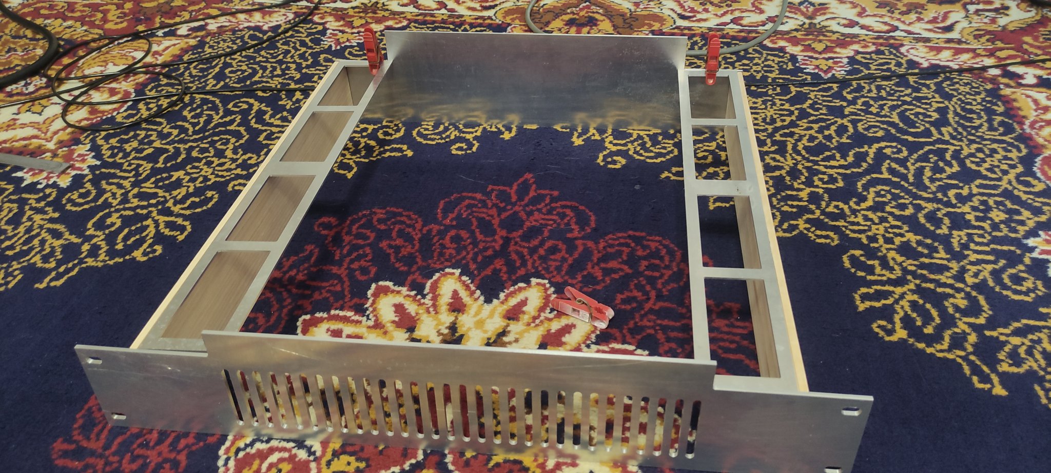

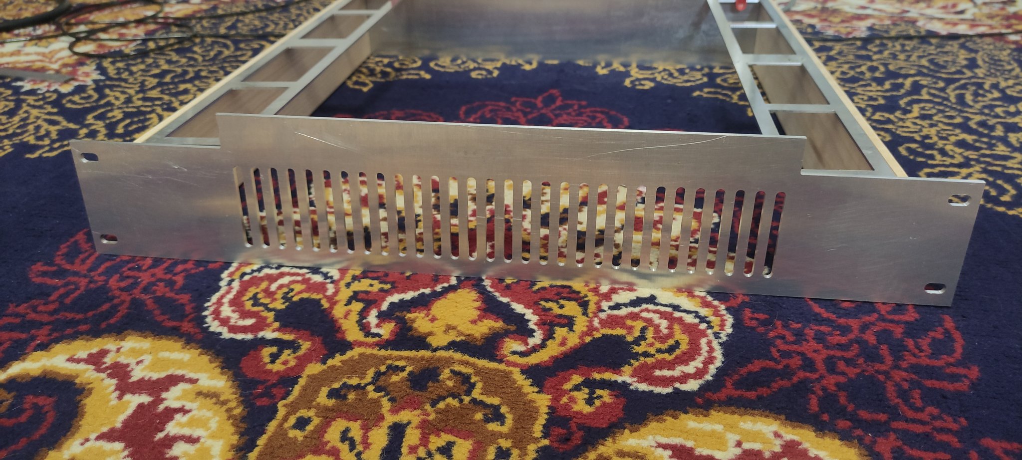

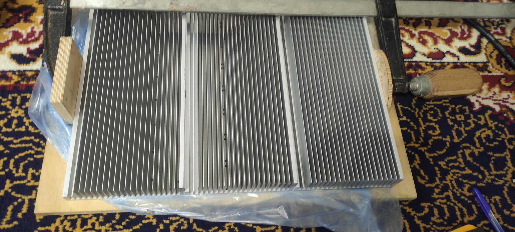

So, I decided to make a decent enclosure for my power amp (the one that is NOT purify).
It turned out that my garage homemade CNC machine can easily process aluminum, although I made it for wood.
Since the amplifier is dual, one for high frequencies and the other for low frequencies, and it consists of four modules and four power supplies, I decided to do the appropriate cooling.
I bought three heatsinks and glued them into one, to it all modules-amplifiers and power supplies will be attached, it will also serve as a cover for the amplifier, but the whole case will be ventilated.

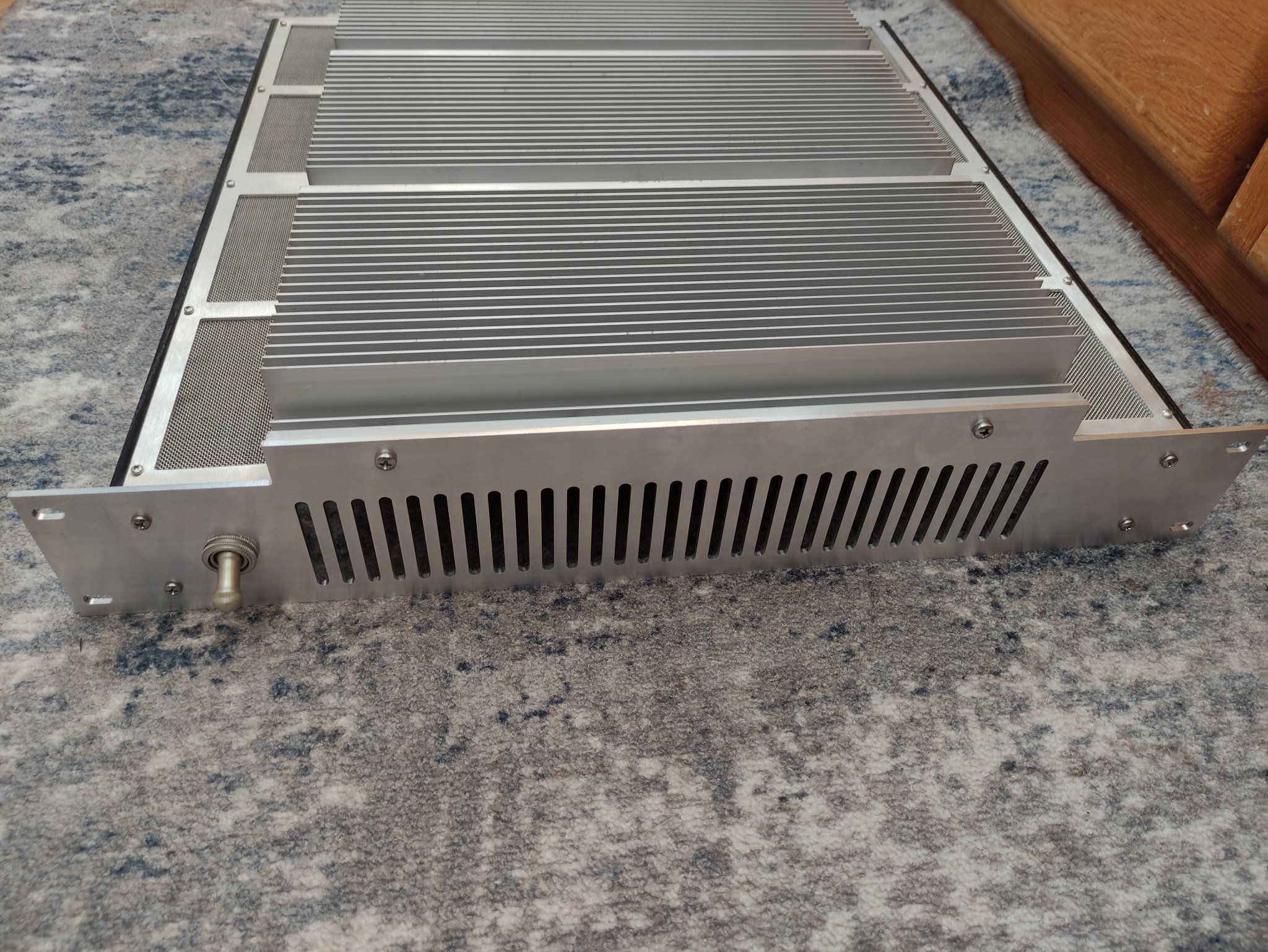

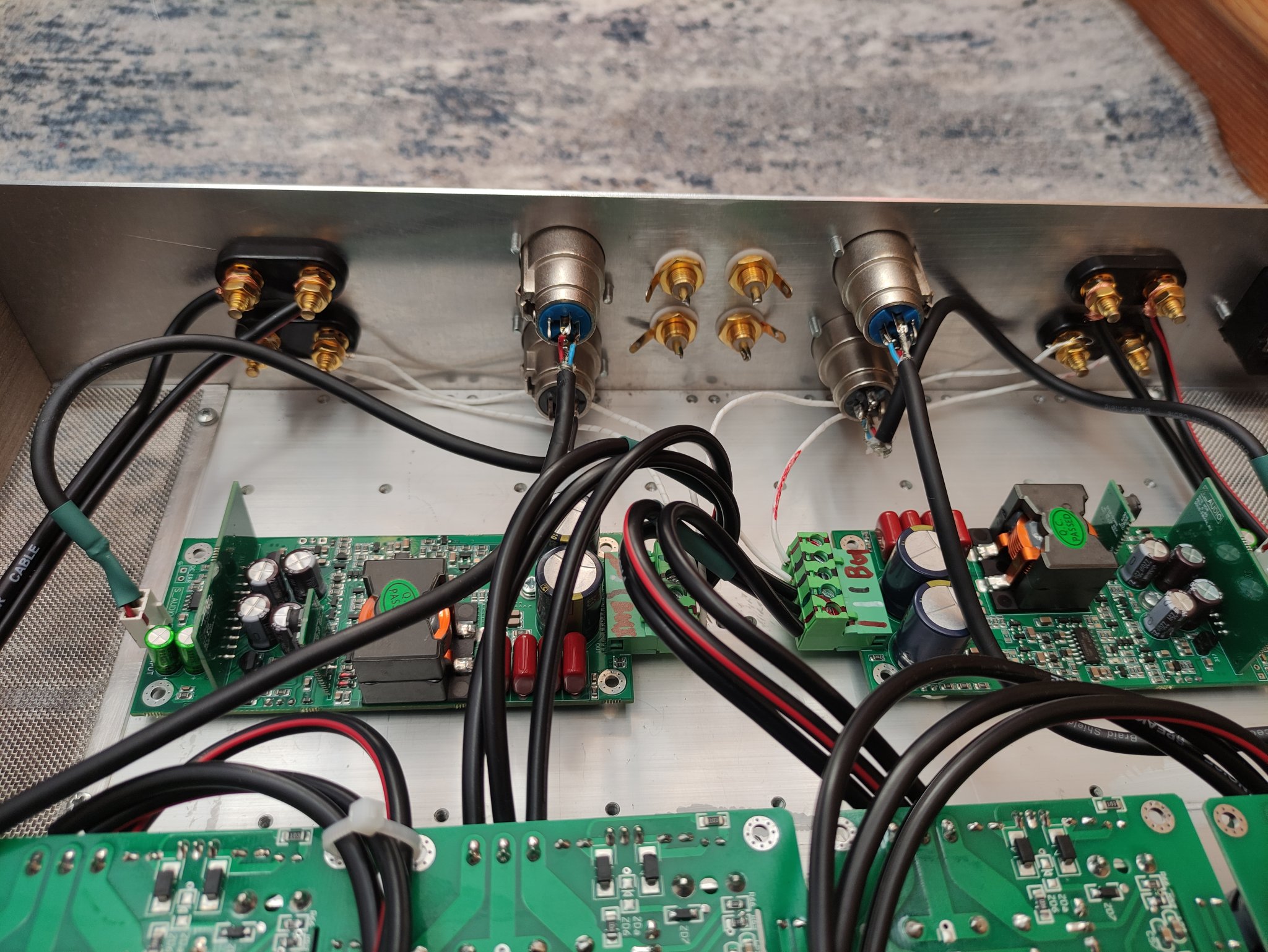

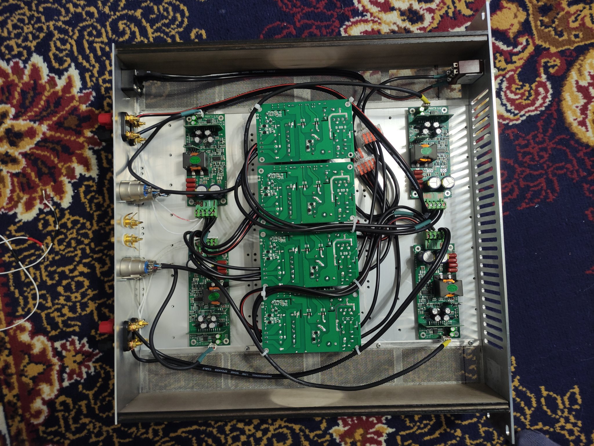

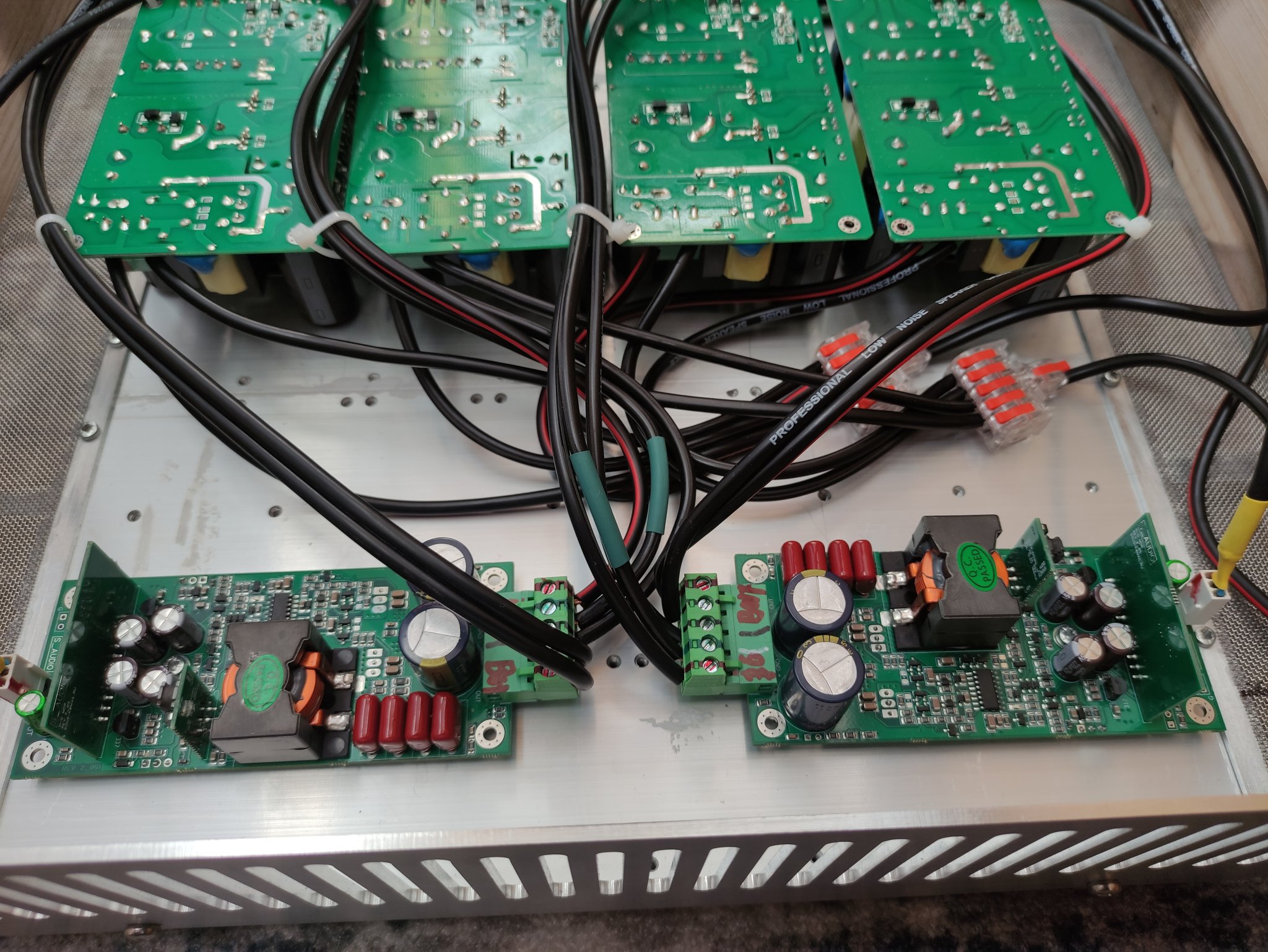

The amplifier is fully assembled, works perfectly.
That is, four amplification modules, each separately for the right and left treble channels and each for the right and left bass channels, as well as four power supplies.
I connected everything with professional Klotz speaker wires.
The input to the amplifier was made with a balanced connection because I use a professional crossover for high frequencies and an equalizer for low frequencies, and they also have a balanced connection (XLR).

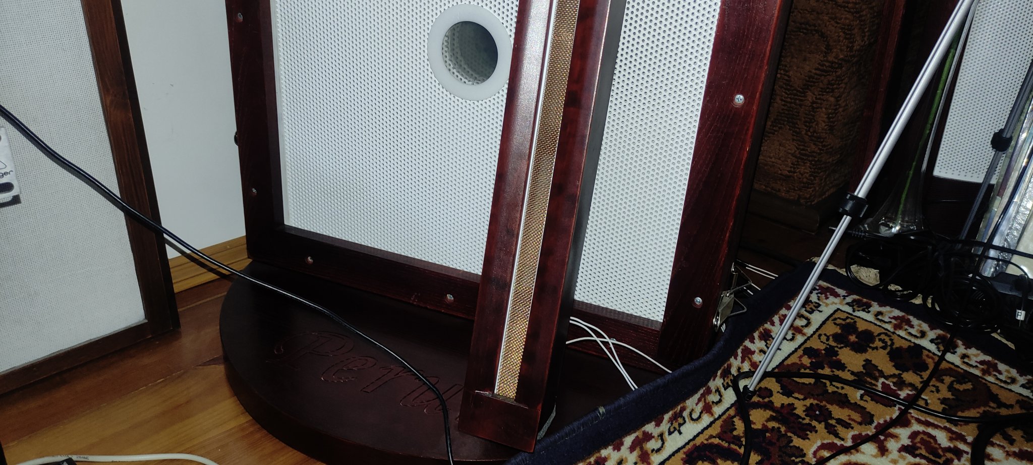

Once again I re-tuned the design of the low-frequency region of my electrostatic speakers.
As a result, the equalizer was not needed; the 400Hz peak was removed empirically.
