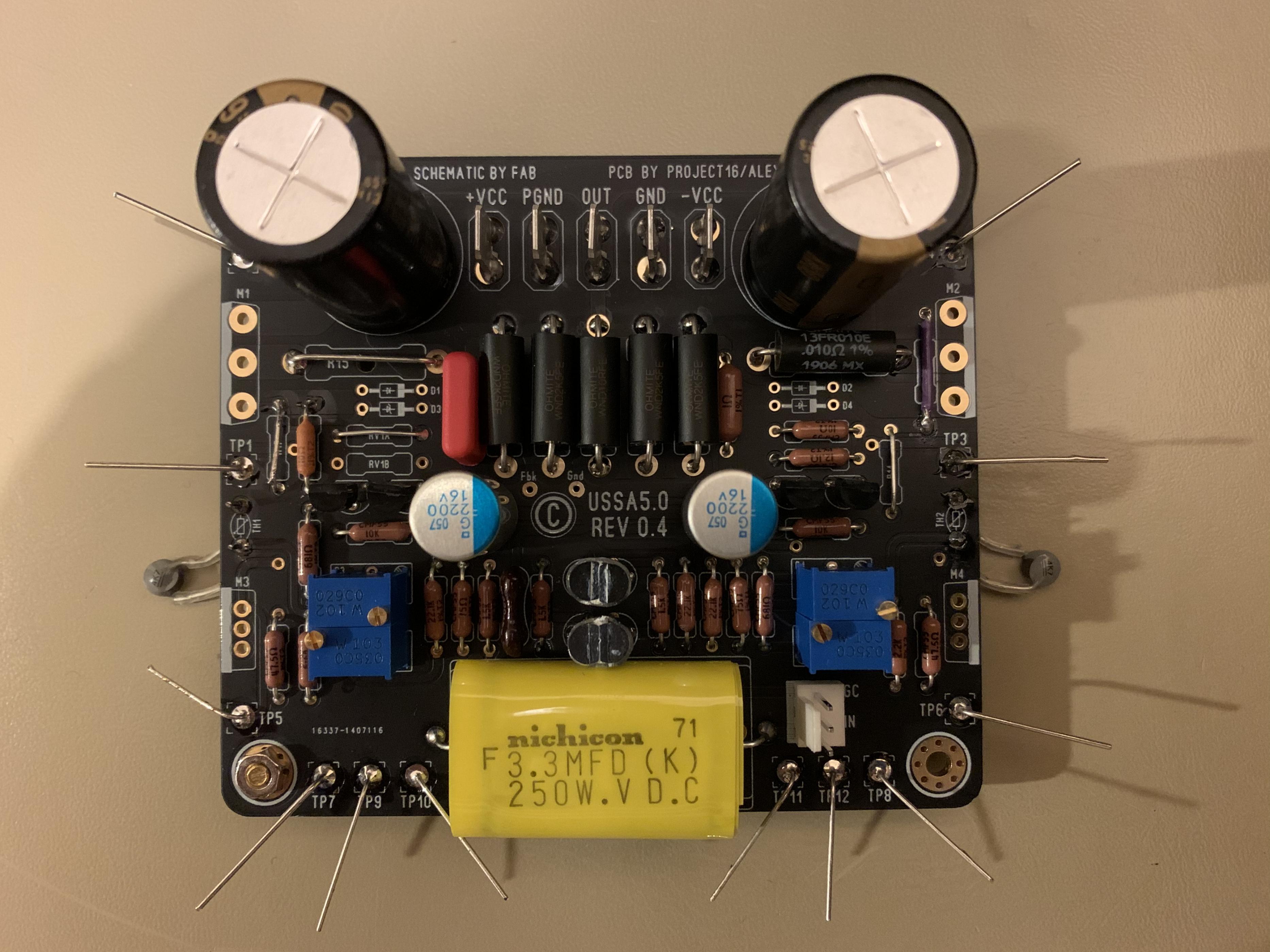

Hi Vunce
Be advised that this QAP takes a long time to break-in....however at the end it worths the while;) ...at least for me.
Fab

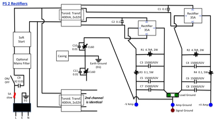

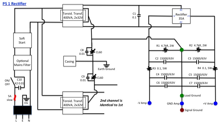

Thanks to all helpers here this is the final schematic I came up with.
It is called "PS 2 Rectifiers" and uses 2 rectifiers (also called diode bridges, depending on where you live :).
For those wanting to use only 1 rectifier I attached a second schematic, as alternative.
Although it all looks pretty straightforward and easy at the end, it isn't. There are quite a few subtilities and it took some time to decide what to keep and how to route. Consider these PS schematics do be definitive and I hope that posting these here will save others a lot of time and headache.
May that be of some use to anyone
Claude... defining part references, next headache will be dimensioning the heatsinks.
AnthonyA
2017-08-28 9:38 am
OK, that's what I come up with... lots of cleaning work.
No more bypasses around bridges etc., as that seems to be the practice nowadays, no more snubbers etc.
I have seen some fitting a 0.01uF cap in front of the primary of the transformer (or is it at mains between L & N for both transformers?): I wonder if you go for it... or not. Please let me know.
That's probably my last point re PS, so if you spot anything please shout, any help is greatly appreciated!
Many thanks
Claude
normally if u use one.. across on off switch on u did it
Also 0. 1 before diode. suggest use snubber instead
see quasimodo snubber. I find it helps alot. there is a list of known transformer and u can pluck the data from there.
