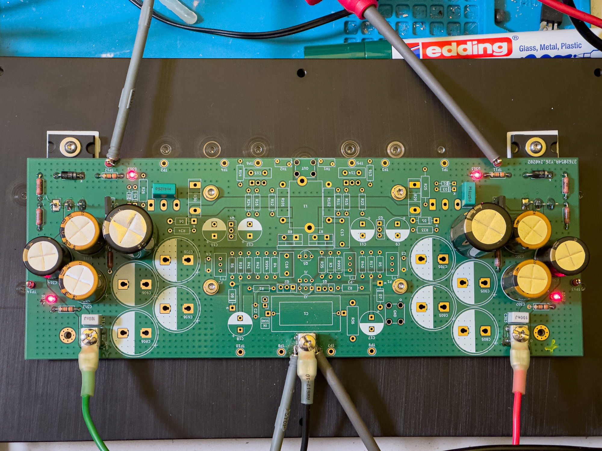

Vunce is right... Have fun with it.

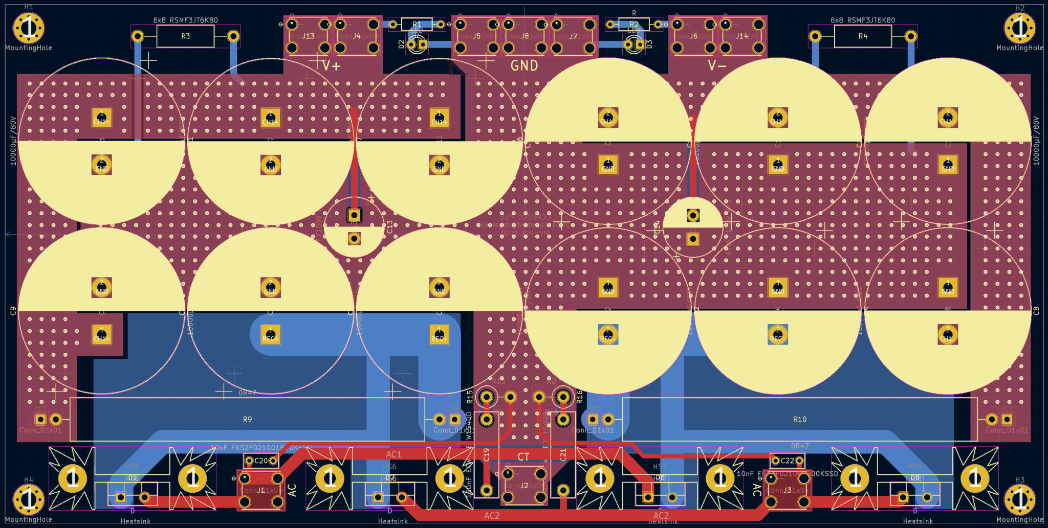

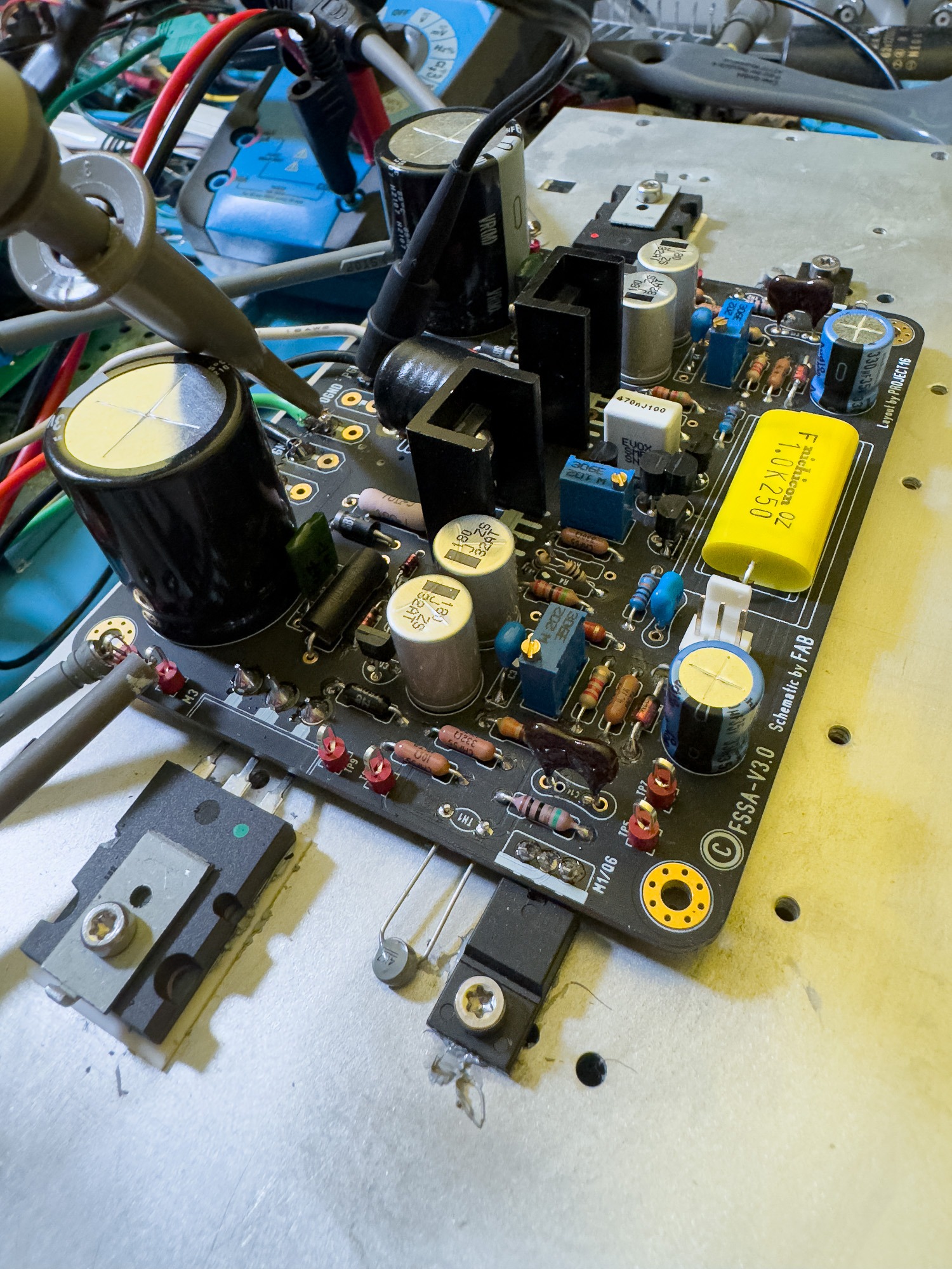

Terminals are 8191 (dual secondary inputs are WAGO 236-102), heatsinks 104-style or similar.
Use a good quality solder station. Maybe you want to preheat the big copper areas using hot-air.
Be careful, heatsinks of the dual secondary version are grounded - always use insulators!

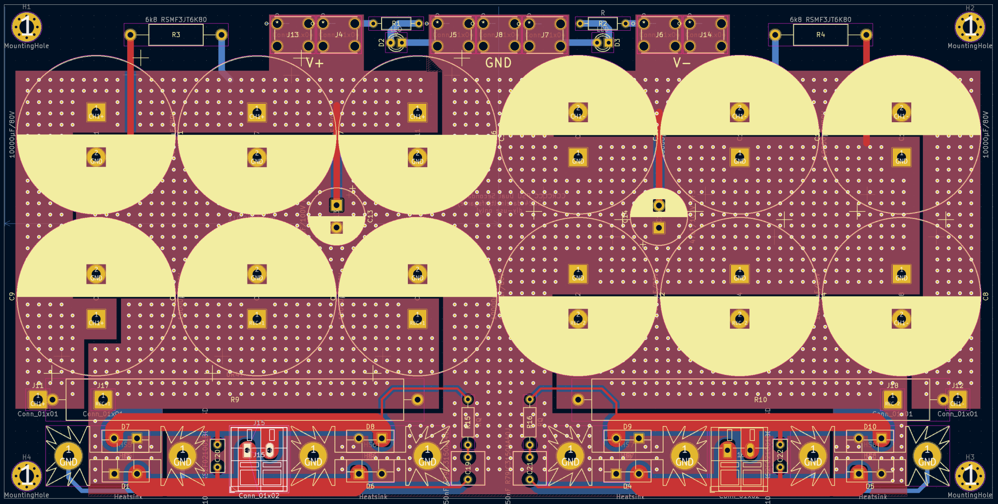

It's not that difficult. CC-R-CCCCc with bleeder and LEDs with resistor at the last node. But I'll upload it this afternoon.
Thanks for sharing these psu layouts nfsgame.
Could you also attach the schematics?

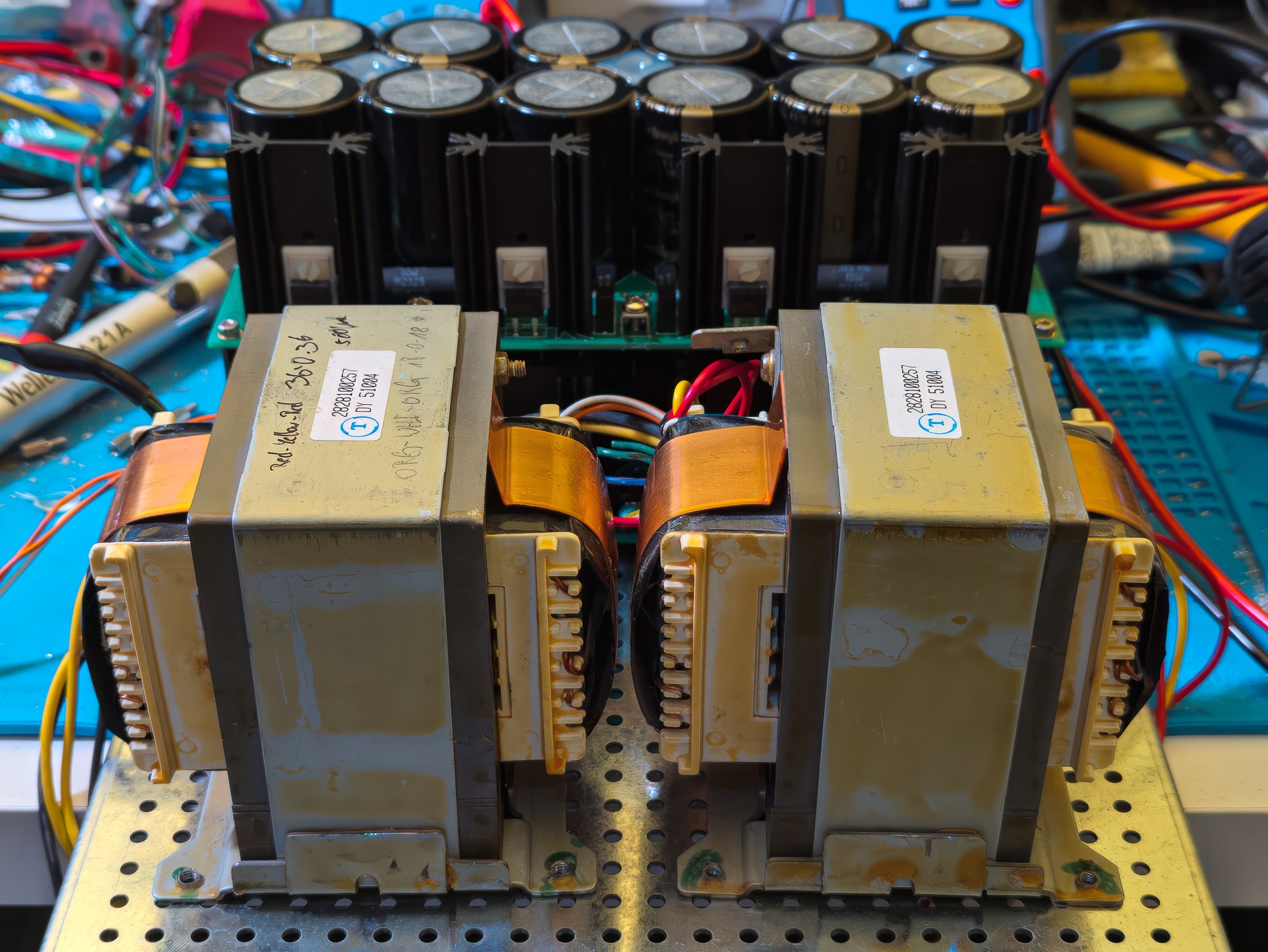

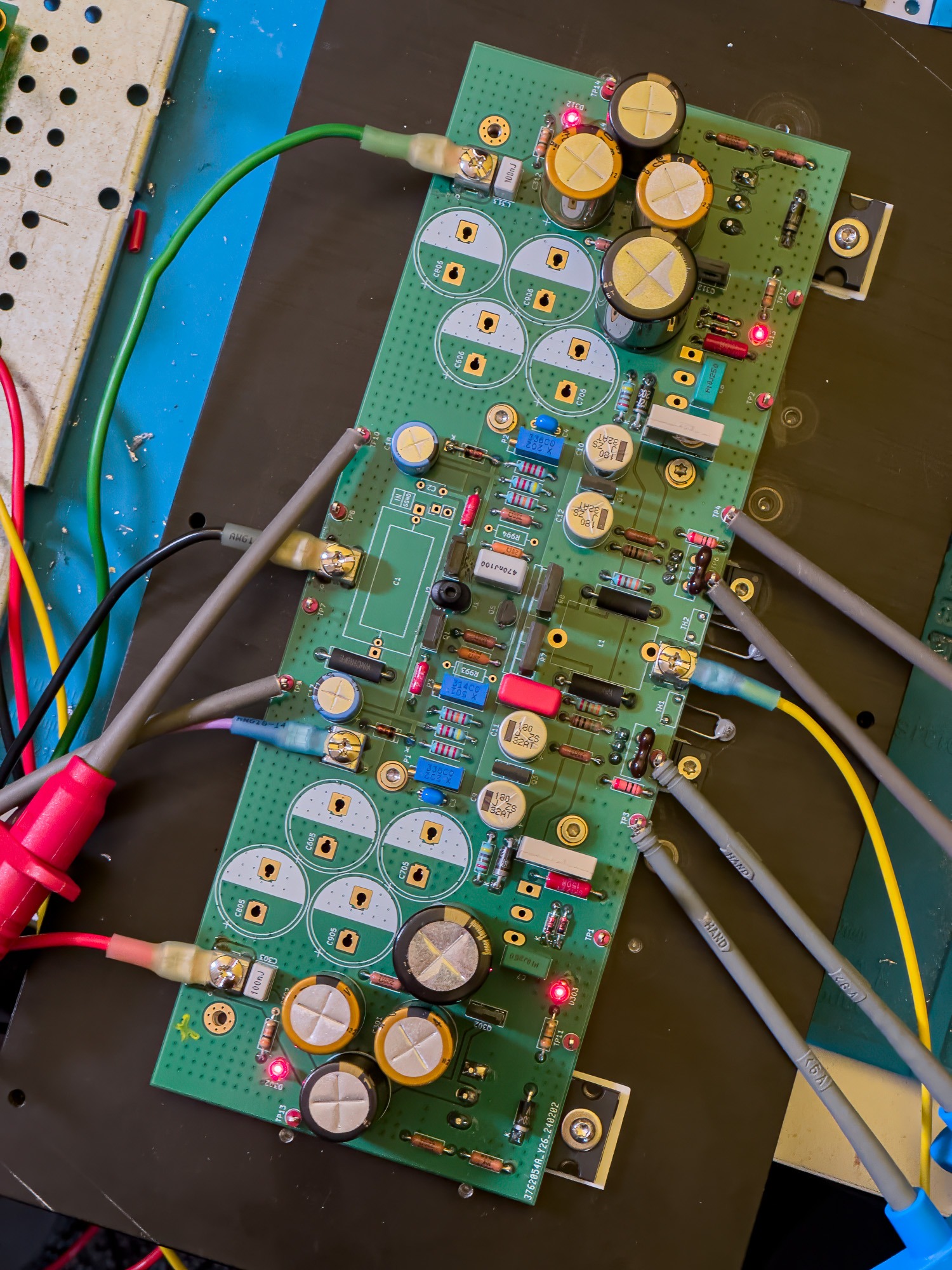

Are you sure that such a close location of power transformers will not affect each other? The Goss Band is made of copper and is very thin to protect the windings.Just some test-fitting...😎
You can check their influence on each other by connecting one transformer and measuring the voltage on the second, then turning the transformer to find the position at which the voltage at the output of the unconnected transformer will be minimal.
If it matches the position in the photo, then it will be cool.
Thank you, 1 transformer per 1 channel is good for a monoblock; for an integrated design it is better to take 1 transformer either with windings divided into channels or with one output voltage for 2 channels. Two transformers in an integral design are old vintage for compactness, not good for sound, but it looks beautiful.Thanks for the suggestion. I will try it out.
