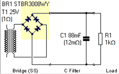

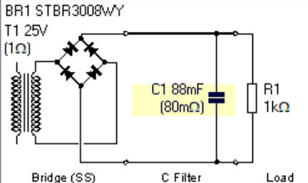

So, first time using psud2.
Around 60mV of ripple using cheap caps, ok.
Still caps only, but now with 2 pairs of Mundorf HC which have 6mOhm ESR each. Ripple down to 12mV due to the ultra low ESR.

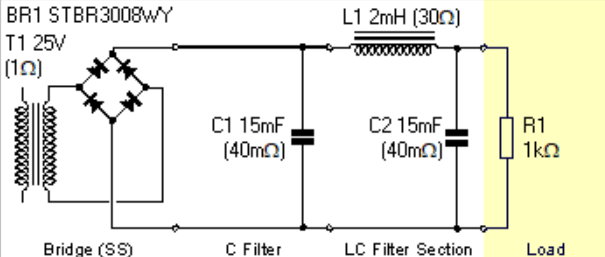

Finally a CLC arrangement:
Zero ripple predicted after C2 with just 2mH. So am I doing this right? Doesn't seem to make sense otherwise why would people go to more extreme lengths?
How audible is this?

Thanks Fab - silly error on my part. Perhaps I shouldn't do these things when tired!
Remodelled with a 2.5mH choke which has 44mOhms of resistance (Hammond 159ZL) and the simulation is much more representative. Ripple is 1mV and really smooth. Is R1 1kOhm load the most appropriate for representing FSSA?
CLCLC - is a further improvement, adding in two inductors doesn't show any predicted ripple (using this load anyway). But how audible is <1mV of ripple though? Is it really worth having two inductors?
What DC current should the Choke be capable of for FSSA? I'm assuming a 10A choke.
I've noticed that the caps only approach also gives nasty sawtooth, that's really now precludes the use of a cap only solution. The ripple peaks are smoothed slightly with better ESR caps, but still not comparable to introducing a Choke.
ClaudeG
2015-01-25 2:12 am
In this amp, as in many, the PS output is modulated by the music signal.
I am not sure you will hear the last mV ripple, but from experience ears can make the difference between so called hard and soft PS. In short, that's related to the output impedance of your PS vs frequency.
I am looking for as low as possible, WHILE retaining a similar value from DC to say 100kHz. It requires a bit of knowledge and time to model it, but the key factor for you is retaining caps that have a low ESR after whatever R or C that you may use to filter (CRC or CLC). bearing in mind Fab has made some provisions for a (additional) reasonable PS cap directly at the output transistors / on the boards
