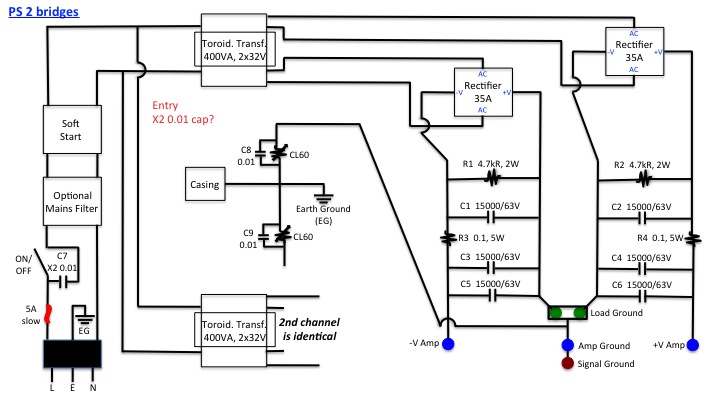

Amending the schematic to 63V caps and also cleaning other bits while at it…
Claude
ClaudeG
2015-01-25 2:12 am
Latest version... some cleaning around the plug / entry, probabaly will refine some values re bleeders but I guess we are getting close.
Need to think re quasimodo and small bypass caps... need to find a tranny, might go 400VA
Hope it is useful to others with the same existential questions re how to get started
Claude

Hi Claude
There are 3 caps in a CRCC arrangement, thus 3 times the ripple current capability of one cap. 12A ripple current per cap seems a lot. 200Wrms /3 ohms is surely very rarely to occur since it is probably where the amp would start to clip and you do not want to listen to that for an extended time ....otherwise you can go nuts :eek:
For transformer regulation, a 300-400VA will normally give a much better regulation than 10%. See below an extract of Antek 300VA 32VAC transformer:
Load Test (operation test):
TEST CONDITION: Input 120VAC 60Hz to the primary coils (in parallel), Output 1 and Output 2 in parallel to load, and measure voltage and current at different load levels.
Voltage output Current output
32.6V - 0.0A
32.0V - 4.1A
30.9V - 9.3A
As for main line voltage you should assume your required power based on the average target voltage value from your electricity provider. The maximum voltage should be used for the safe margin of your components (and heatsink temperature). For the minimum line voltage you would get a little smaller power amplifier value but so what.? :rolleyes:
have in mind that you need 4 times the power to get twice the sound pressure level...
Fab

Ah, that's all interesting... and possibly where the diference comes from regarding ripple!
What I did... I thought 150W into 4R as whatever comes on top is more short term reserve from caps on bursts into low impedance and then the transistors have a limit anyway. Say a tad over 6A needed, 2 rails to provide current, makes a tad more than 3A per rail. Not having any clue on audio I would have thought"take whatever value from 4A re ripple and you are done".
But then I thought the R from CRC was slowing the current for the next caps, so that the first C would suffer the most from ripple. OK, make that 4A for that one. And then I read that one should take 3 times that value to be safe! OK, understood that these rules where perhaps rather applying to Class A amps driving all the current all the time, but then nothing re Class AB being different was specified. Hence 12A and me very :-(
Now I understand reading you that even if the 12A ripple should be considered (?), the 0.1R of the CRC is probably still negligeable despite being 10 times more than ESR (but probably 10 times less than the cables to it), so that the 12A can be splitted between ALL the caps. I was considering 2 caps for the first C just because of that ripple, whereas as low pass I would rather like to see them after R should I fit them. All gone now, it is either 15000- 0.1R - 15000 or possibly 15000-0.1R-30000.
Last but not least, great values from Antek: that's less than 6% regulation. Have to see what tranny to use... Toroidy came as recommanded, but no specs, need to dig into that next. And 400VA tranny is not a lot more than a 300VA one.
Indeed, mains fluctuation and max power, as said I don't care if I have 150 or 130W as negligeable in terms of sound pressure. All I need (not even sure I need it really LOL) are probably 70W with the ability to drive very quickly low impedances effortlessly.
This, and the fact I want a Class A bias as high as possible while remaining safe re temp and longevity, means that I will stick to the 42V DC rails although 63V caps could allow more. In fact, the other bits to sort now are heatsinks and chassis (and possibly tranny while at it as big parts). That dimensionning will dictate how much bias I can take and what casing parts to use.
Next one the list... whenever time permits it
Many many thanks, I feel I have progressed a lot in defining the right values for the PS
Claude

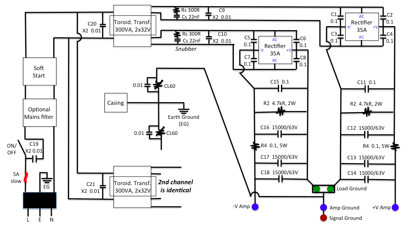

Claude

Hi Anthony,
Thanks for your kind mail.
You are correct, that's one point where I need to make a decision. In fact, if having the real quasimodo snubber, I possibly don't need (let's take one rail as you did) C5 to C8. In fact, I would not use C9 and C10 either. I would though have other caps instead of these to get the 3 components required by the proper process by Mark.
One might even wonder in that perfect case if C15 is really needed... any POV on this BTW?
NOW to the big issue I have: this would all be valid IF I had a quasimodo jig (cheapmodo easy to do, I could do that indeed)... AND a scope that goes into the 10MHz range. Unfortunatly my scope doesn't cope with that, it is say limited to 150kHz-200kHz. I am not sure I can find another to borrow, that's the BIG issue here. And yes, I did already looked into the thread and none of the transformers I am considering has been sadly tested, bad luck.
I found a post where someone used a "2 component only" overdamping snubber that suits it all, which I used for a small project. But I am not convinced this is the way forward for big VAs. Everyone would just go for these std values otherwise I guess? So I presule one needs really to measure properly to find out what Rs to go for and use the 3 component snubber Mark suggested. Right?
BUT IS ALL this worth the effort? Can one hear it... vs say no measurement/no quasimodo snubber and just the traditional "easy fix" bypass diodes as on the schematic?
Fab, Anthony: do you went quasimodo in your amps? Or just diode bypass caps? or whatever? What have you used as bypass in real life from C5 to C15?
That's where I need your practical experience. I am progressing slowly on this project (very busy with work and family, I had hoped to be a follower) and if I start smaller projects such as quasimodo I might never see the end of the initial target project. Having said that, if quasimodo is best pratice today and part of the learning process, I will just include it as small project and spend time on it, looking for a better oscilloscope... just don't want to do it for the sake of it.
While I don't have the answer to snubber OR traditional bypass caps, I have this provisory schematic "that includes it all", well noting that it will be either snubber OR bypasses. Was in colour as options in the first schematic I did, kept just admittely "snubber" in the last one, as reminder 'not done on that'...
Advices are welcome!
Thanks again
Claude
ClaudeG
2015-01-25 2:12 am
It appears I may answer my own questions LOL - of course I would still welcome any comment though!
The following is open to discussion, but after having spent a hell lot of a time on audio forums, technical forums, Neurochrome's website, Rod Elliot's website and done many many calculation to feel more confident rather then just relying on posters (as I couldn't really test in vivo), I am now thinking:
- Snubbers are not needed, they won't improve the sound, more EMI affair
- Given "reflexions on both sides of a tranny", I am pondering if it is not C20 "OR" C9+C10, instead of "AND"...
- Pretty academic, as I start to suspect that these caps will have 0 impact on sound and are just there for EMI... of so they might GO, same as the snubbers, and only be considered again IF there is a problem
- Wondering if the bypass caps around the diodes of the rectifier have an effect and if positive (taming and getting garbage down from few MHz to 10KHz might be great fro EMI but otherwise???)
With all this I might end up with the same PS... as the one I built 3 decades ago for my amp and nothing has really moved on!
OK, I learned a lot of things in the process, that might be useful one day, and there are in fact a couple of changes in 30y:
1- The use of 2 bridges/rectifiers instead of 1 with a much better grounding scheme understanding (at least public and for audio), and that CAN matter quite a lot in my experience... so I will go for 2 bridges unless adviced against
2- The fact electrolytic cap's specs have improved massively (but on longevity, that's a manufacturing process issue), meaning that (for THIS poweramp, not mentioning HF DACs etc.) intermediate bypass caps to the big cans might not be needed or even be detrimental. That's new and against my experience, admittely not with the latest high quality big caps. I can postpone that matter anyway as A) the real bypasses and possible impact will be on Fab's board at the end of the line (well downstream the CRC board) and the question will be wether adding an intermediate bypass or not between 2200uF (or so) and 0.1uF, B) I can still make a provision for potential additional bypasses on the CRC board under the caps - should I really fancy trying that aswell one day
3- Given the progress made in 30y with caps, I shall dig into the rectifier's specsheet to see if the small diode bypasses still make sense today. I don't want for a power amp individual diodes, I want a bridge, so that rules out the soft recovery options (sadly, I use them since 20y in all my small power audio projects) => ADVICE WELCOME
On it... hopefully a lot of the overengineering will be gone, not mentioning that today there are even female mains plugs that include a holder for the fuse and a line filter (wonder if any good and working both ways without penalty to the sound though, advice?)
Claude

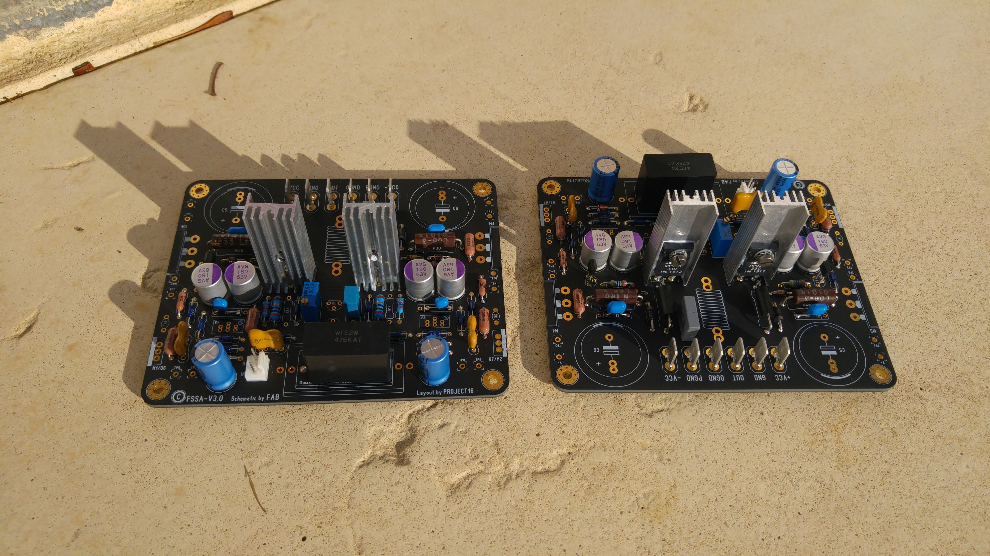

Time consuming indeed...:D
I started a while ago this promising amp, but way too many projects at the same time: Loudspeakers (3 pairs)+ amps (Class D+ FSSA)+ preamp (B.Putzey's)+ headphone amp (The Crocodile)+RPI /Moode player+house arrangements+outdoors+...work(!) All at a time keep me progressing at "snail" pace on each of them.:spin:
Here's where I am at it (no progress during last 2 months I confess)

Hi Claude
I put 100nf across each AC connections of both diode bridges.
For the “Quasimodo” circuit, I had installed it in my FSSA1 but could not notice differences with or without it....however I must confess that I have only installed the typical default parts value and not the optimized ones -I have not mounted the test circuit.
Nice start Kalamin
I also use a better sounding input cap nowadays: Nichicon 2.2uF QAP2E225KRP or 1uF is ok too. They are also the perfect size for this pcb.
Do not forget to follow the manual and test in sequence : input stage, driver stage and then output stage. This is the way to have it working without issue once fully assembled.
