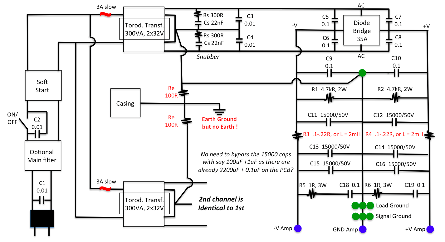

Ok, so here is a draft of the PS schematic to feed Fab’s boards. I did it best I could : this is my first try at it and I hope it is understandable. I tried to gather tons of material I read here and in books.
There are quite a few points to be discussed… at that stage all can be modified, so thanks for your help !
1- None of my low power devices have an Earth connection, they are just 2 wires to the mains. None of my current power amps have an Earth connection, they are all of the 90s and run fine (same power levels as here). I used to have power amps with Earth connection when in Germany but there they have Schukos / plugs that enable you to plug one way or the other (switching L and N), whatever sounds best (lowest leaking voltage). The country I live in now doesn’t enable that : the plugs are just to be plugged one way. For that reason, plus the hassle of Grounding issues, plus the complication to go into something I never experienced, I stuck to 2 wires (L and N) plug. NOW FIRST QUESTION : is that OK ? I am willing to do whatever the designer recommends re PS, so Fab & Co just let me know… you will anyway get some questions re wires
2- I though left a provision for Earth (that doesn’t exist at this stage) as I copied something I found re casing connection. I left it there until point 1 is solved. We shall see if or how to correct this section if no Earth.
3- Rs and Cs is a snubber at the outputs of the transformer. Well, I fitted some on my low power RIAA amp’s PS. Can’t say if it does make a difference, assume it could perhaps with big toroids ? Anyway, I don’t want to go the hassle of measuring the perfect snubber so I just went for std values that are supposed to be « fit it all » as in the snubber thread. POV ? Do you use some ?
4- C3 & C4… are these really needed ? Found them in the litterature, I assume they can’t harm, but well. Should they still be fitted? Even if we keep the snubber ?
5- Diode bridge. Nightmare. I have found people advocating 1 bridge, as I did here, but others advocating 2 bridges. I must be a very tired and not clever engineer as I can’t really see why this should make ANY difference at all in terms of rectification provided of course 1 bridge can cope with the full load. I could perhaps see a difference with the tranny shield and grounding, kind of floating thing I had once… but I have no clue if that affects the sound. What are you guys going for ? I will just follow your advice! Tell me if I need to change that, I don’t mind an extra bridge as long as it is better…
6- C9 & C10… are these needed ? Don’t care bout the price, just the sonic…
7- Bleeders, R1& R2… I went for 4.7kR and 2W. Is that OK ?
8- I don’t know if I should go for a CRC or CLC filter. On the paper CLC with 2mH vs CRC with say 0.2R (found in the litterature, but way higher than what Fab recommends), wins clearly to filter the mains. On the other hand, I also read some negative oscillation comments with CLC, complications and mitigated results. At the end, to quote Papa (was for 100W amps and my guess would be more for Class A with permanent loads), CLC or CRC doesn’t matter as long as you have at least 25000uF as last C, as that determines the sound. Whats your POV ? I can see that Fab recommends both… Fab, did you notice any sound difference for this Class AB amp? CRC seems easier to build and affordable, but then what value to chose between 0.1 and 0.22R and what are the trade offs apart from losses and possible fluctuation with I ? No clue on CLC but willing to learn if required. If so, what part to go for? I found only that 2mH one https://www.mouser.fr/ProductDetail/Schurter/DENO-23-0001/?qs=A5k8bsa1loCgxv5nVtXMcg%3D%3D
9-
Main caps. To make things easier I draw here as a starter « 15000uF – R or L – 2x 15000uF ». Low ESR high ripple caps. I might go for much more than that, thinking 2x15000 – R or L – 2or3x 15000, the former to cope with high ripple, but let’s see the principle first. That is already quite a lot in terms of caps as there are 4 modules like this in the entire power amp, the slow start will have work. Comments ? Does it make sense to add more caps than on the drawing ?
10-
R5 & C18, and R6 & C19 are again snubbers I found in the TI spec sheet with these values. Wonder if really needed, never went for these at this odd location.
11-
I stopped there re PS bypass caps. I can see that most people (including me) will further add 1uF and / or .1uF bypass caps at the end of the line, but I thought this wouldn’t be required as on Fab’s board there are already a 2200uF and a 0.1uF bypass caps. And this is « the real end of the line ». The small values are anyway best located closest to the board. Is my reasoning correct or should I add small caps here aswell ? I will later come back on the caps on the board anyway.
12-
In a similar way, I like to bypass locally big caps with smaller ones, to help them, directly at their legs. I was thinking of bypassing the 15000uF caps with 100uF caps localy. What do you think ? I am unclear whereas I should do that or not given the final bypasses on the board. Further, if doing it, I am unclear if I should do it for the first C of the CRC as perhaps one doesn’t want low ESR at this first cap – but then I found schematics advocating for even a 1uF bypass for this very first CRC cap. Confused !
And I stop here for the questions as there are enough of them. Sorry ! On, Grounding… can of worms ! I did just a basic layout there. Once the basics fine tuned we will tackle grounding. That is unless you see something completely odd that would need immediate revision of course !
I really hope that many people, including Anthony, Fab and Do, can all give their light on these as it would be of great help (and interesting) to me to have lot of information. Of course you can also have an eye on the schematic, on the 3A slow fuse value and locations, or locations of switches etc. as I just did that with my best logic… and no experience at all. Feel free to correct me, I only posted a pdf because sadly I can’t post the ppt here !
If all this looks long, at least 2 positives : I hopefully should’t have that many questions for the rest of the build and… I started 2 weeks ago with 100 questions and many schematics until proposing that simplified one LOL !
Great thanks whatever your input or help, the more posters the better as I lack experience

Same PS Schematic but as a pix, easier perhaps to open?

Hi ClaudeG,
I've no history in building amplifiers, but I'm a (seasoned...) electronics engineer and a whole lot from Power Convertion and EMC theory is useful when building an amp; so here would be my comments on some of your points, from my personnal considerations only.
1/From a safety standpoint, no earth connection is only acceptable if your build follows Class 2 instrument requirements about insulation, which may be the case but you'd need to check the transformer for it (especially if in future, the amp ends up being sold to smbdy else). If you plan using a SMPS without wiring PE, just forget it as such PSU needs PE to be connected unless it is specially designed for Class 2.
2/OK
3/4/6/10/These are to me design-specific components and I would place them in case of need, i.e. I specifically chasing some unwanted glitch or resonnance (you'd need an oscilloscope at least..that said, you could keep them as they 'd do no harm at all.
5/ I see no point for 2 bridges: SMPS manufacturers sometime play that trick on some of their products, but that has only to do with productivity & cost gains within a range of products (BOM management, number of different P/Ns etc...).
7/ as long as power into these is < ~70% of their rated power, and you are OK with the permanent losses, all is fine.
8/Without prior calculation, I would go for CRC, but CLC could be better according the parts you have at hand and power losses into the resistor, which would think to be acceptable unless your amp is a real beast.
I'm also building a FSSA2, but plan to follow a completely different route for the supplies.
9/I would say you're in the right ballpark. Larger caps and lower ESR is what you want for the downstream cap bank, as this influences the response of your amp. Upstream cap bank filters out the rectified voltage.
I'd better choose 6x4700µF than 2x15000µF though, for lower ESR and ESL.
One thing here: the wiring between these and the amp board should be as short as possible and twisted for lower ESL. If this was to be a 2-layer board, that would be the best.
11/12/ The actual reason why several caps of decreasing values would be used in parallel (i.e. 10000µF//10µF//1µF etc...) is when as a designer, you need to extend the decoupling role of the initial cap to higher frequencies than the sole initial cap would reach before its resonance point.
Starting with the 15000µF, one would need to assess if the frequency range they cover is large enough for an audio amp, but I think they could beneficiate from some help for best results, or you could split them into several smaller caps and keep the same "reservoir" capability of the bank.
Maybe this was a too long answer, but many questions to be covered without going too much into the details.🙂
Hope it helps.
Kal.

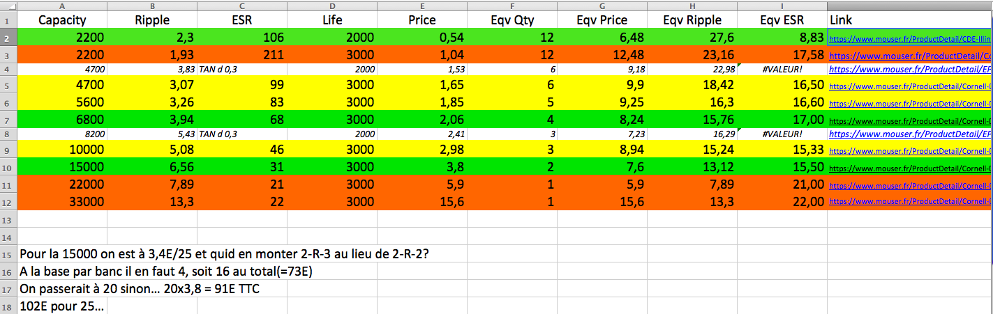

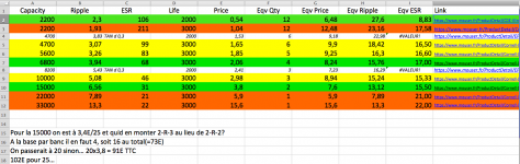

PS: sadly not allowed to attach excel files here so did a screenshot. Should you be interested in the full excel file, just PM me.

Hi ClaudeG,
You've apparently been thinking down to the detail over a number of aspects of the design already. Well done. 🙂
Thanks for your alcap comparison table, indeed useful comparison.
2x15000µF show lower ESR than 6x4700µF (!) It looks like these parts are audio-grade or general purpose caps; low-ESR series could provide better performances, but would be more costly 😡.
I just checked that I went for 10000µF caps for my FSSA2😀 but you'll read below that they're not expected to do the full job alone.
=> Thanks. I thought you would like it and as you can see by the colour codes you came to exactly the same conclusion as me. 30y ago things looked completely different!
The 15000uF caps are already low ESR caps, from a serial production though. Indeed no fancy hyper audio caps to $$, but when you compare ESR etc. you find out that the difference is thin and that you end up with a very low ESR that is enough in comparison with cables, connections etc. Plus if paralleling many of them, which I intend to do, you are better off with many of these VG caps, than with a few audio grade ones. At least on the paper and so far my findings... Experience welcome of course.

Hi Claude
It is true that line voltage fluctuates. I notice at night at about 23:00 the maximum obtained. With the transfo ratio it provides proportionally less variation than on the main.
If you really want the amount of power you have stated I recommend 63VDC caps.
4x 63VDC 15000 uF for each channel is what I have in my FSSA1 prototype. They are reasonably priced.
You may over thinking it for the power supply. This is only for a sound power amplifier and not for precision instrumentation purpose. Length of wires to amplifier may kill the filtering you are trying to get at the PSU source. Layout is important though.
R4 should be on the V+ and not ground.
Fab

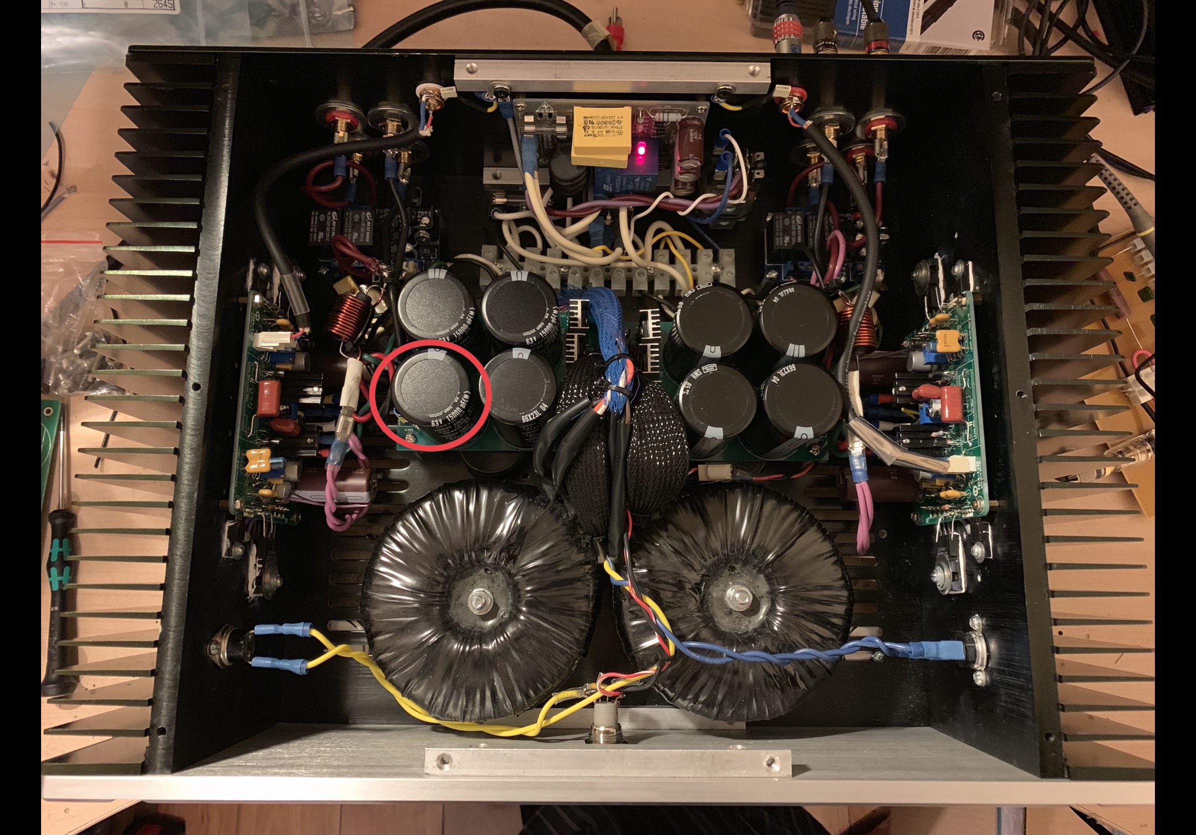

Claude you might be interested in this article that describes earthing the chassis and ground lifts. That is what I do for my amps and have no issues.
If you use the CL60 instead of a 10R resistor (which I did for the USSA) I would still put a small cap (0.01uF) across the CL60.
Earthing (Grounding) Your Hi-Fi - Tricks and Techniques
Also it is my understanding that you no longer need caps across the bridge diodes if you use Quasimoto circuit at the transformer.

Apart from looking for low ESR quality caps, I had quite a problem finding caps that can handle the ripple after the rectifier... but perhaps I overengineered again as I looked for 12A ripple? The CD I mentioned come at 4$ which is dead cheap, and a pair of 15000uF ones before the R is specced at 13A ripple. So yes, there would need to be 2 before the R in the CRC... Looking forward to your caps.
Many many thanks again

Harry3, many many thanks to you: real life experience!
Now, I am not sure I get it right? Did you replace 10R with CL60 while keeping the rectifier and the 0.01uF cap? So that's RECTIFIER + CL60 + R10
Or did you use just CL60 + 100nF cap and NO RECTIFIER?
SO many variations on the same theme...
Quasimodo... well, I used one for my RIAA build (where handling power and mains fluctuations were less a problem). I went for standard values someone posted it would be fine for EVERY tranny. Now, I don't know if that is right at these power levels, but I know for sure I don't want to measure myself and lose time on this. So either std values, or no Quasimodo for me. Unless you guys tell me quasimodo is really a big plus?
I guess if quasimodo, then 2 bypass caps at the rectifier are probably not needed (those at AC)... but I would say the ones at +V and -V to tame the diodes at the output still are per definition?
More headache LOL
