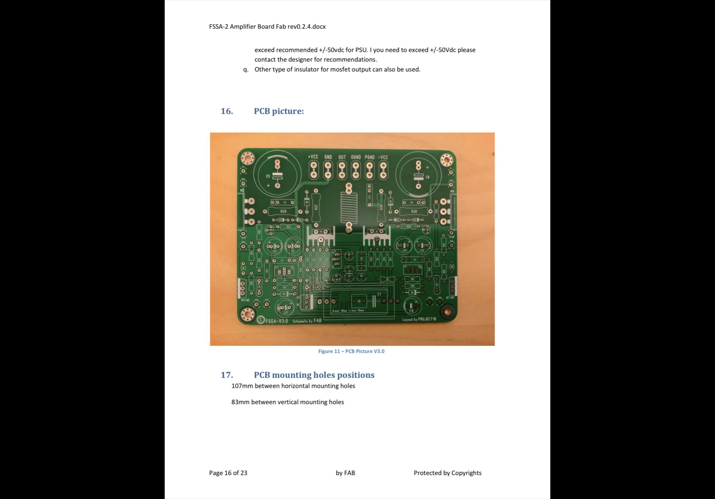

I would like to ask the size of PCB, positions of holes (if the semiconductors also have I would be grateful) because I want to drill heatsink.
On the first channel the drilling was succesfully, but the second I cocked up and I don't want again 😀.

For pcb holes position, check section 17 of manual. See below extract.
