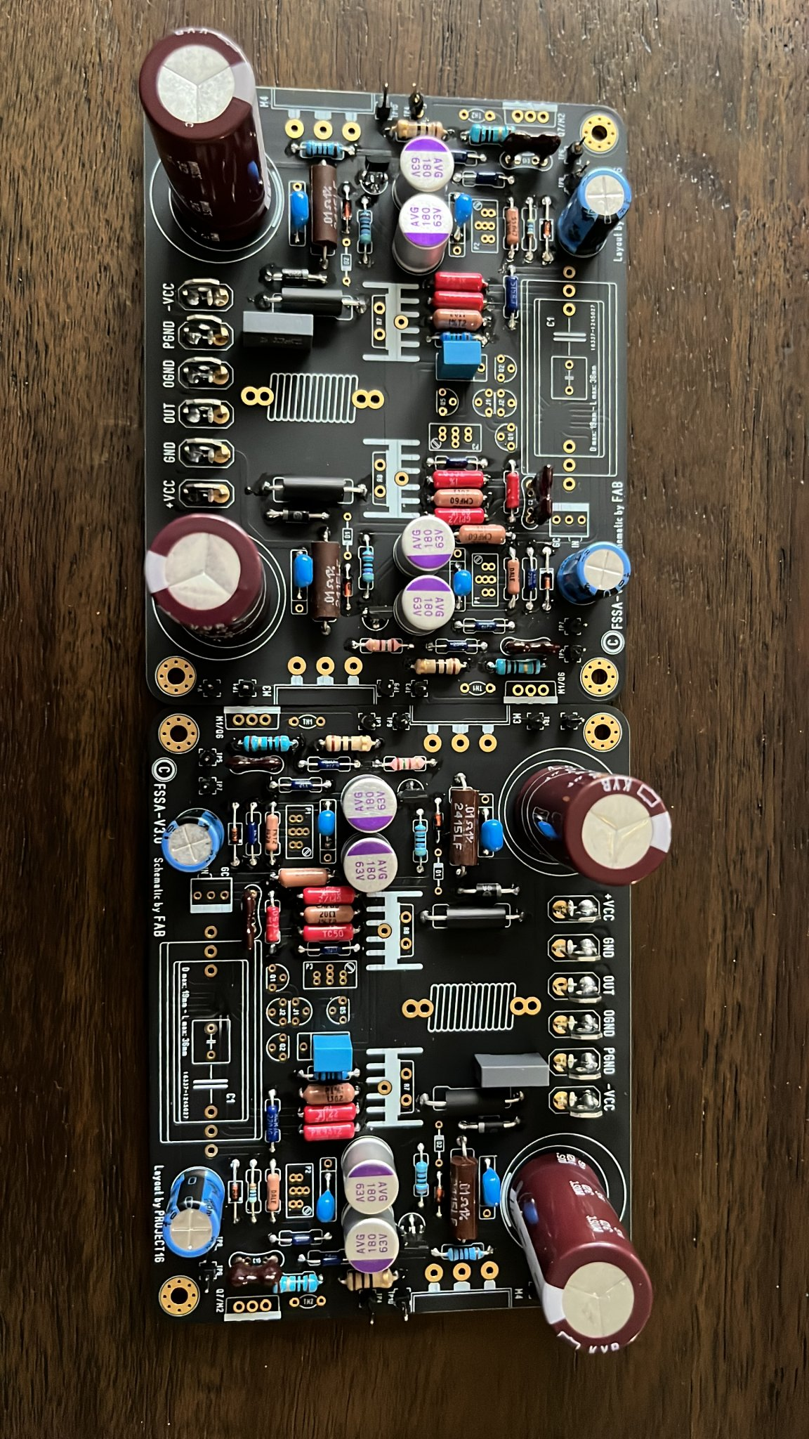

After some hours on it I would like to share my first impressions about Fabs FSSA-2 with you. Please note that English isn’t my first language, but I try my best not to bother you with too bad grammar.
As some may have observed I have done my own PCB for them with integrated capacitance multiplier, space for lot of capacity after the multiplier and some other footprints for bigger components. Ah – and it’s compatible to the diyaudiostore- and modushop UMS heatsink drilling pattern.
The circuit is mostly following the original schematic. Some components are touched by me:
Small resistors are mostly non-magnetic CMF55, PRP and AMRT. C1 is the Nichicon MKP-type Fab recommended some time ago. The amplifier is running from +/-48V rails - about +/-45V after the CMX.
I’ve used my personal mid-high-reference speakers consisting of the limmerhorns.de 630BC1 waveguide equipped with the stock speakers B&C 6NDL38 and the compression ring-radiator DE360. They are crossed to one Wavecor SW270BD01 per side at 300Hz. That means: Every amp that is talked about here only had to drive the upper part of the musical spectrum. The lower octaves are driven by a EV CPS2 (+/-90V EF2 with good old metal-cans, 2SC3281/2SA1302 as drivers and VFA frontend – rock solid and I really like it powering the lows). MiniDSP Flex Digi and two Topping E70 Velvet are finishing the lineup in the signal chain.
The complete setup is getting filtered power through Furman PL-conditioners because I’m living near some big steel-factorys and have to live with some nasty DC on the line and fluctuating AC during their ovens are powering.
I’ve also build the USSA-5 and that’s what I’d like to compare the FSSA-2 with most of the time. I also have two channels of VZ’s non switching output stage with “Ampliwire”-frontend (VFA) and a “Wolverine”-style OPS with “Spooky”-frontend (VFA).
The first 30 minutes are the hardest – or: let it burn for a while…
Really… I was shocked listening to the amp the first time after finishing. At that time it had only seen some sinusoidal- and squarewaves at different levels into my dummy loads and some “searching for hum” while doing the cabling through some old speakers.
So I let it play some music from local radio stations thinking about all the time that have gone during the build and what else could I have done during it… But it didn’t took that long. After about 30-45 minutes it began to change. “Was that the chunky snare I have learned to love through the USSA-5? Yeah it is!” You could call it the “Fab-snare” if you like. CFA type of feedback combined with lateral FETs in the output done by a talented designer seems to do something magic.
At this point I switched back to some higher quality sources again (FLAC or HiRes through Tidal – Electronic, Rock, Rap, Pop – Everything I’ve seen and wanted to hear in this moment). And from this point two hours gone by like a blink. The FSSA-2 is much more to my liking compared to the USSA-5. Both are great amplifiers. Don’t get me wrong. But The USSA-5 is more the gentleman: Press play and you will be served with details and smooth, flattering voices – if you want! And that’s the main point where both brothers are different. The FSSA-2 is more the Sherlock Holmes directly jumped out of the BBC-remake. Powerful, rough but letting you know every single detail - without asking if you want it that way. Straightforward upper mids and highs without getting nasty. Clear and articulated voices. I like! And it’s very talented to differentiate between single tones, instruments and sounds like synthesizer-made effects. Not the best talent of the USSA-5. I never heart my mid-high-modules that way. Very 3D-like – but that may be because the way the power supply was made, too. This time I’ve used a strictly divided dual-mono-design I haven’t done it in the amps made before.
Conclusion: A very musical amp with very good separation and an overall very musical presentation without any habit making listening stressful. Thank you Fab for this masterpiece.

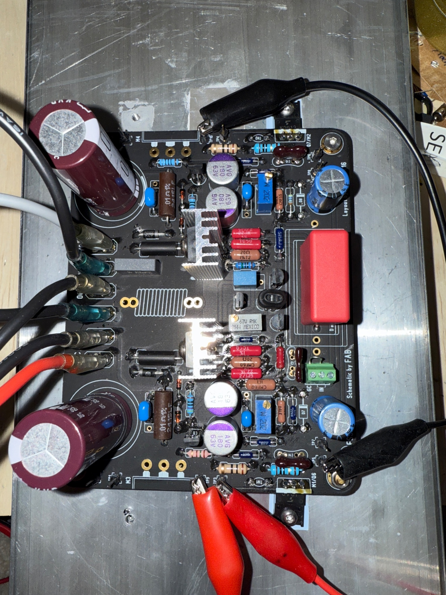

- Q1/Q2 are TTC011/TTA006 for their bigger body and therefor better heat transfer to the environment
- Q3/Q4 (small CMX) are BD139/BD140 TO-126 devices for the same reason as seen before
- C9/C10/C11/C12 were replaced by Panasonic ZS 180uF/63V Hybride-Polymer because I had them here in my stash
- R29/R30 are Mundorf mResist Ultra TO247

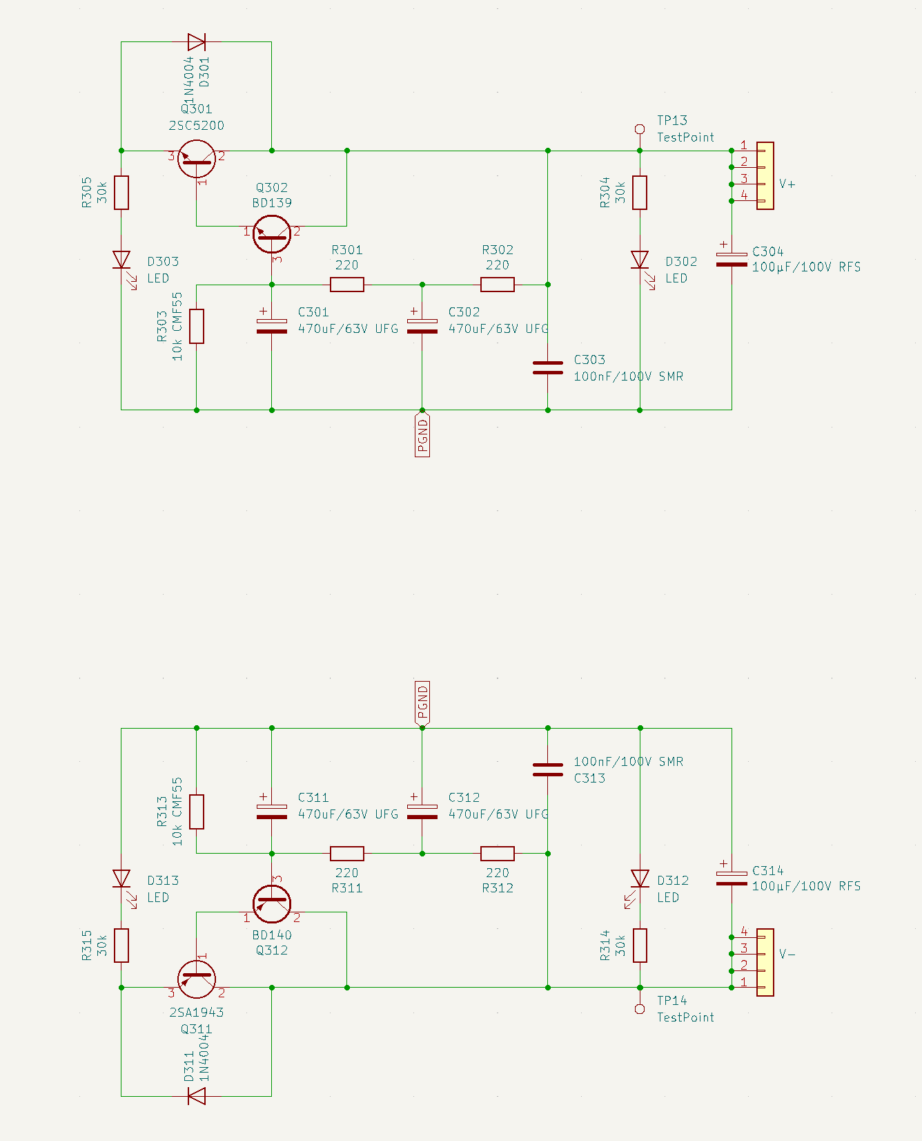

- Highpower capacitance multiplier followed by 5000uF per rail is added to each board and rail – see schematic in the attachments

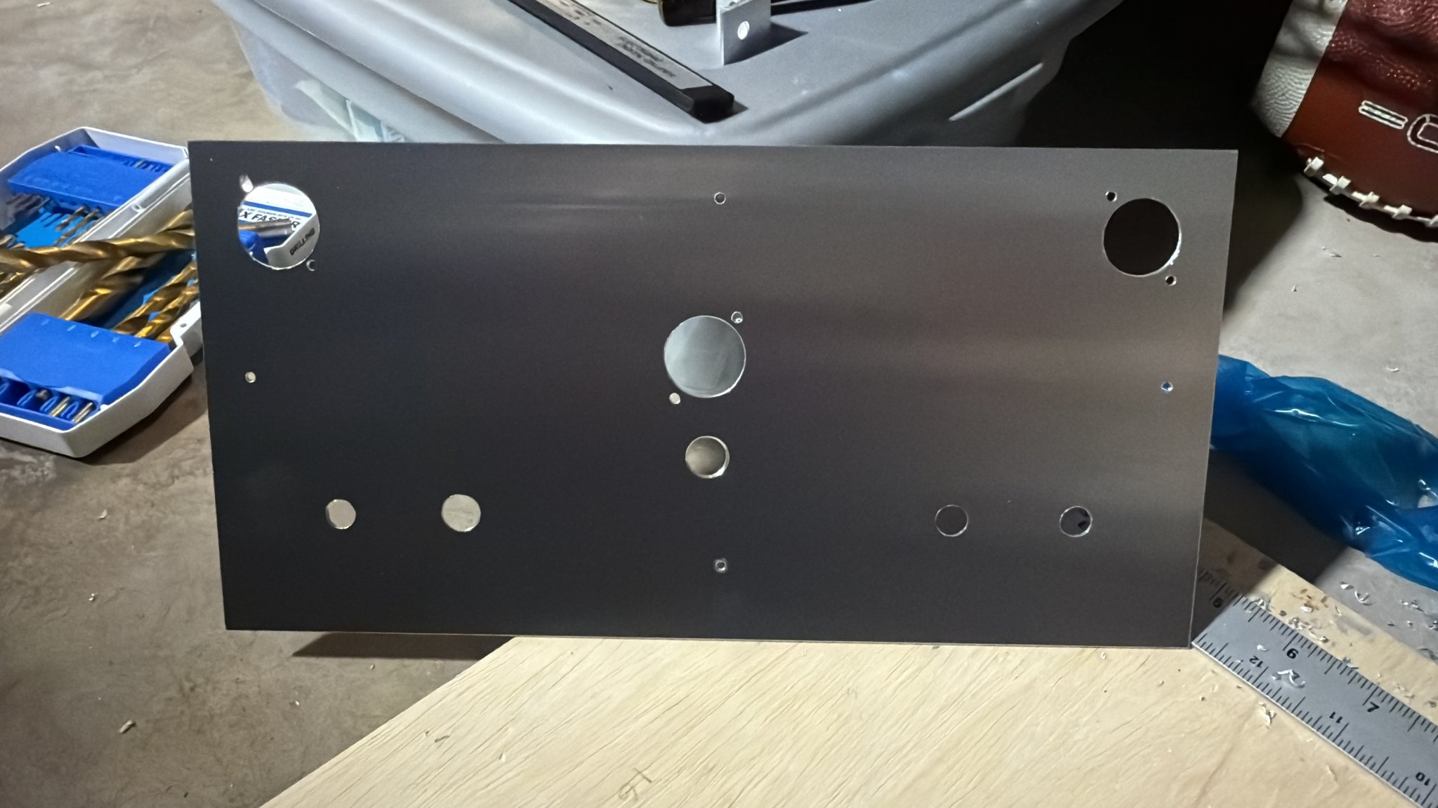

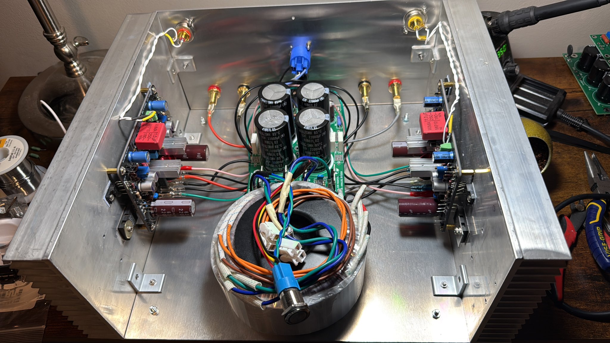

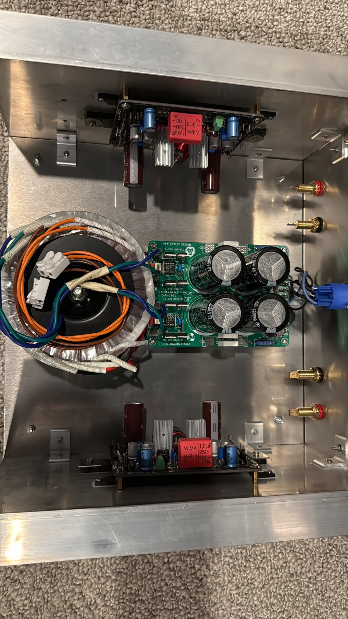

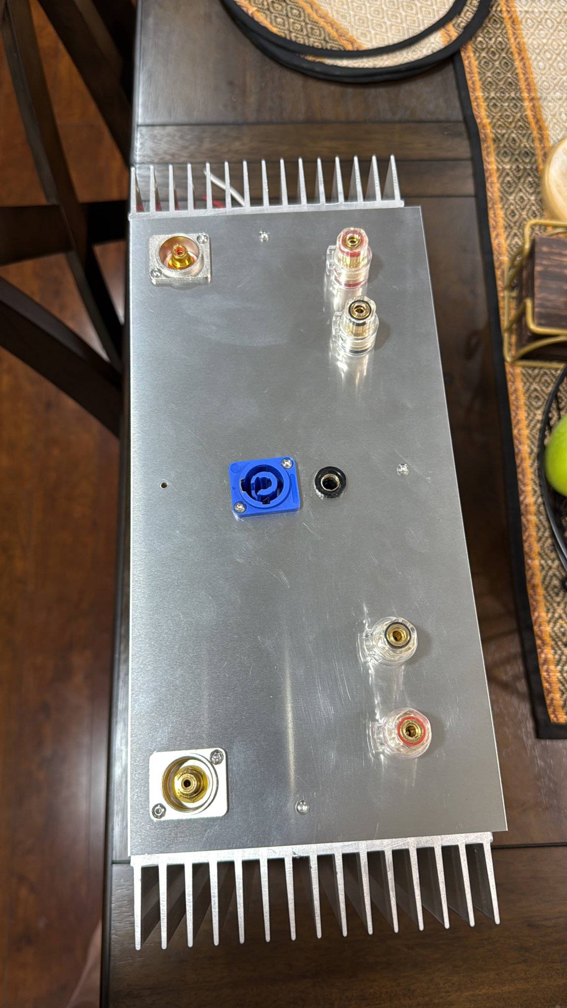

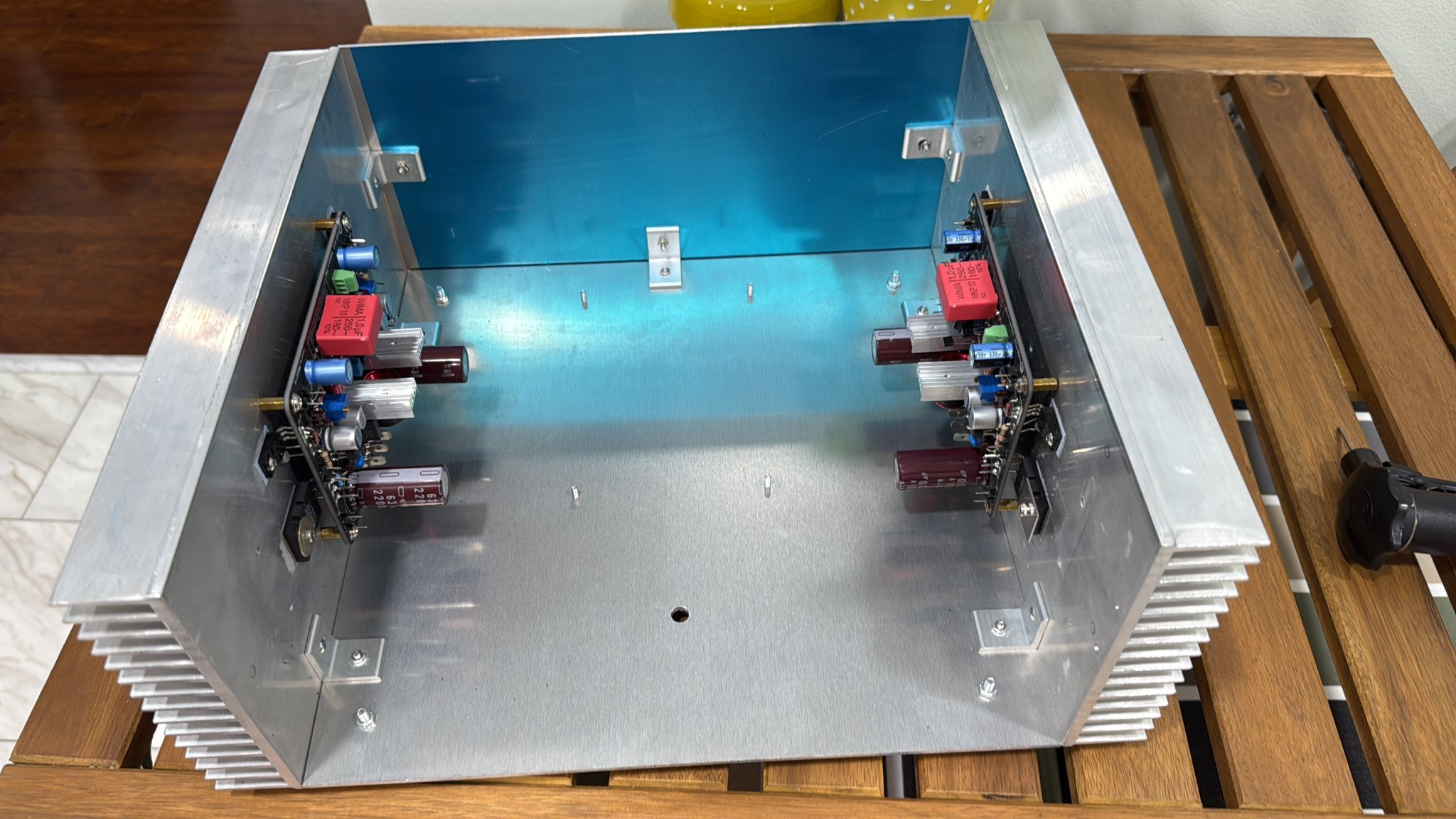

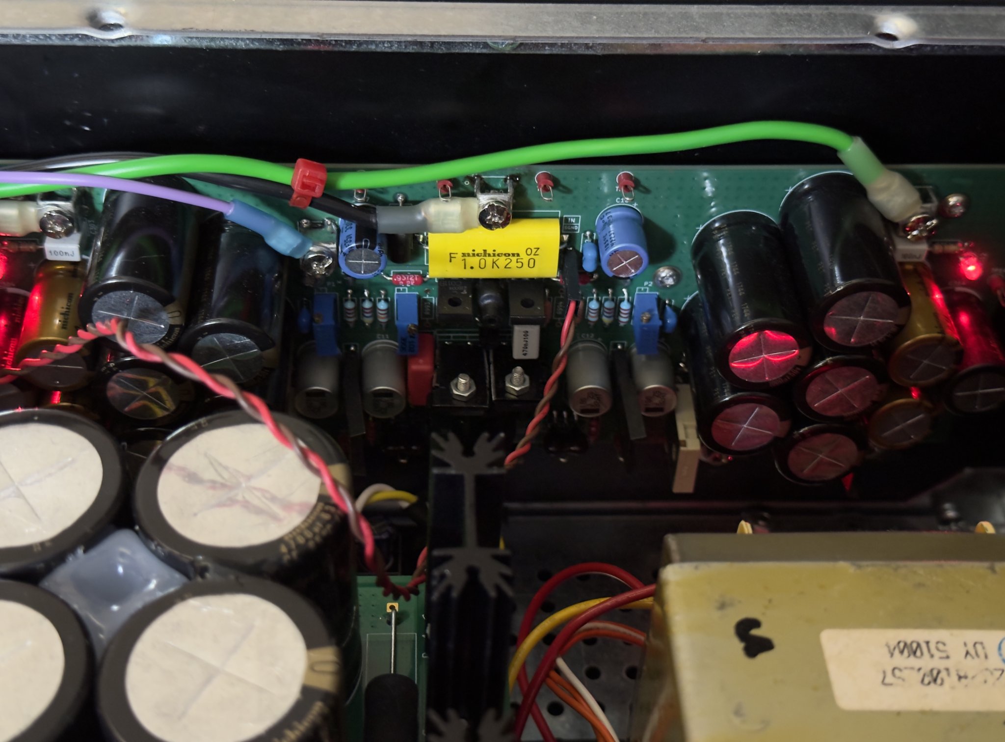

Here is my FSSA amp using Alfet with 35vac toroidal paired with Prasi LT4230 CRC psu board. Made a chassis with available sinks that I had but runs a bit hot after an hour of playing.
Manniraj,
Congratulations on completing the build.
However, the heat sink fins are horizontally oriented - probably that is why you are experiencing the heat; the hot air cannot move upwards as efficiently as with a heat sink with vertically oriented fins.
That is true but I had these spare and thought of using them considering the expensive chassis that we need to spare now a days with shipping and other things. I will try to add a small fan to see if it helps in cooling it down.However, the heat sink fins are horizontally oriented - probably that is why you are experiencing the heat; the hot air cannot move upwards as efficiently as with a heat sink with vertically oriented fins.
