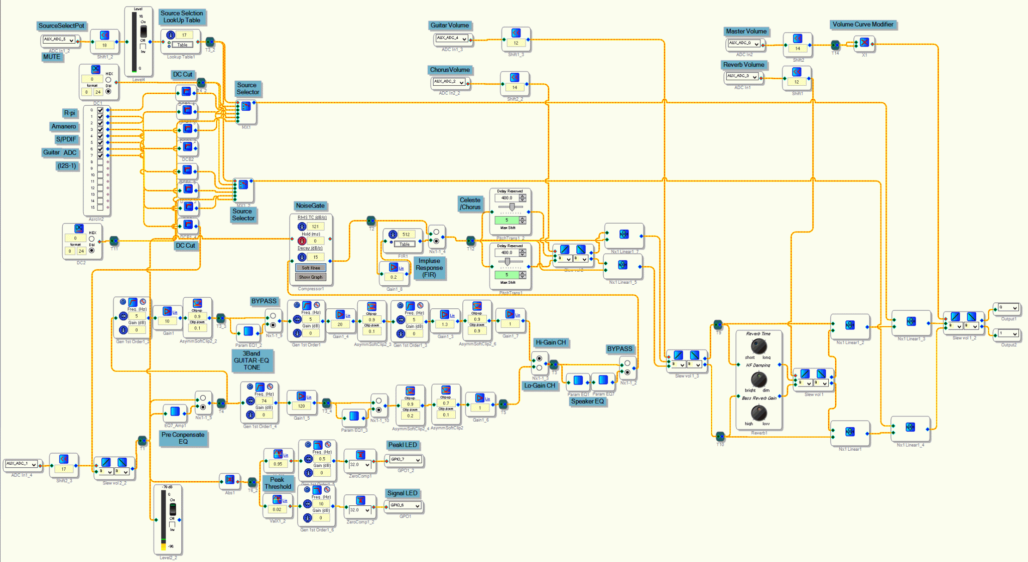

Today I tried implementing the Electric Guitar Amp Simulator for play-along with FreeDSP OCTAVIA.
This was inherited from Stephan Moeller's VLOG project.
Some additional features are added. (Drive Gain Control, NoiseGate, Chorus Effect, Reverb, Cabinet Impulse Response, Additional EQ)
I used 2SK30A J-FET Source-Follower buffer for RCA-Analog Input. Adding a dedicated optional ADC board to I2S Input header will be better for permanent use.
Other Digital Sources can mixed with your Guitar Sound.
AUX1: Gain Control
AUX2: Chorus Effect
AUX3: Reverb Volume
AUX4: Guitar Sound Level
Play Guitar KARAOKE, Just Have Fun!

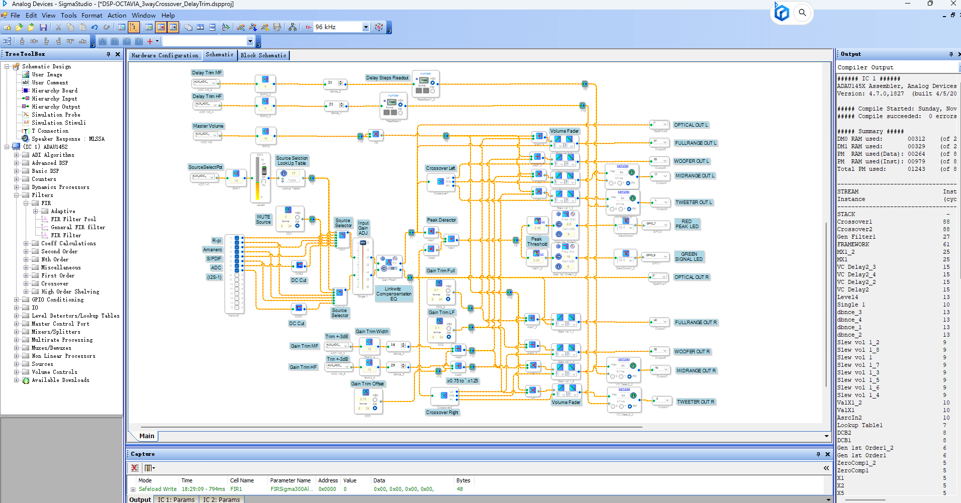

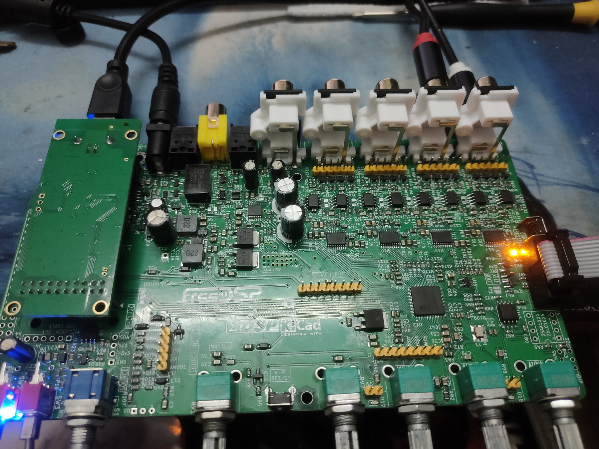

The circuit board has been soldered, but it does not work properly. After importing the sample project, some channels do not have sound, only 0/1 treble output and one bass channel output. I think it's not a hardware problem. I'm not very good at using the SigmaStudio software.

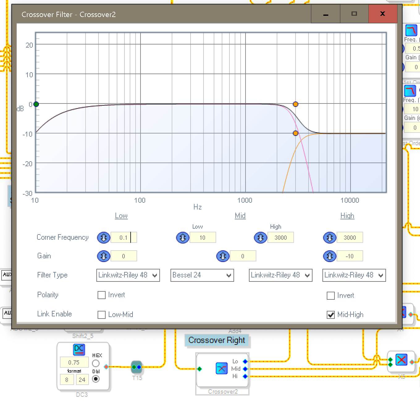

After importing the new sample project, it still does not work properly, and the same problem still exists.
I guess you mean an output 32/33. Please check out the crossover frequency of the low output part. It must be below 0.1Hz. So please set it higher than 20Hz.
CyberPit
CyberPit Thank you for your reply. I replaced the 0/1 channel DAC-PCM5102A with a 32/33 channel and it worked. It seems that my DAC chip is broken. I will test it again after purchasing a new DAC chip. There is also a problem with the new demonstration project. Only the Amanero input source is valid, and other input sources are invalid.

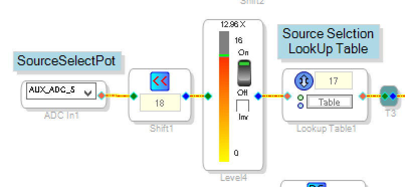

This issue depends on a look-up-table as follows...
My version 0.33j OVTAVIA board indicates values on top of the Level4 indicator.
SOURCE POSITION
Level4 VALUE
1.RPI (CCW)3.2
2.USB6.4
3.S/PDIF9.6
4.ANALOG (CW)12.96
So, In my case, LUT.txt will be like this...
0
1
1
1
2
2
2
3
3
3
4
4
4
4
4
4
4
0=Mute, 1=RPI, 2=USB, 3=SPDIF, 4=ANALOG
