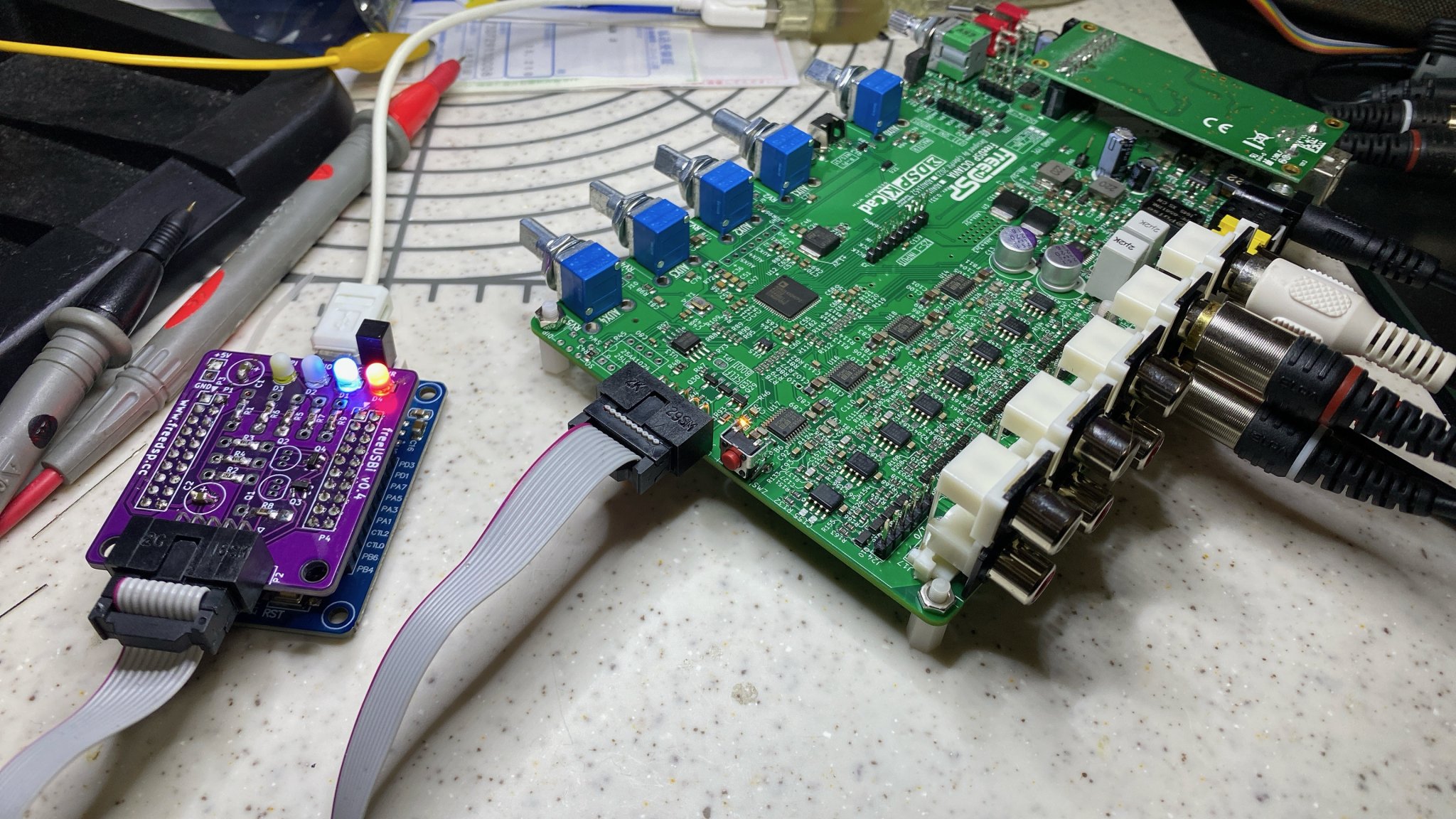

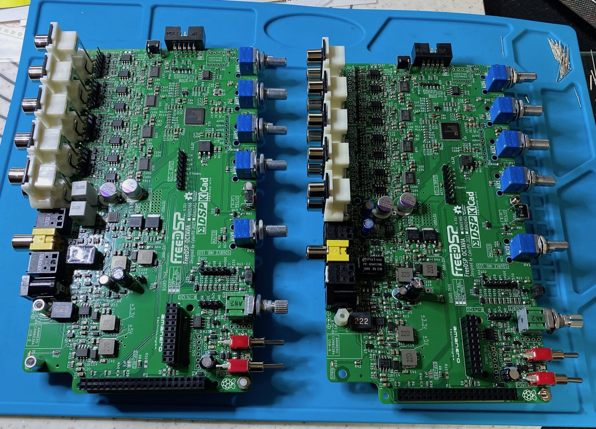

The PCBA board has arrived!
It will be built this weekend...
CyberPit
CyberPit
Joined 2018
Now the evaluation has begun!
Functionality check is going. Measurement will be later today...

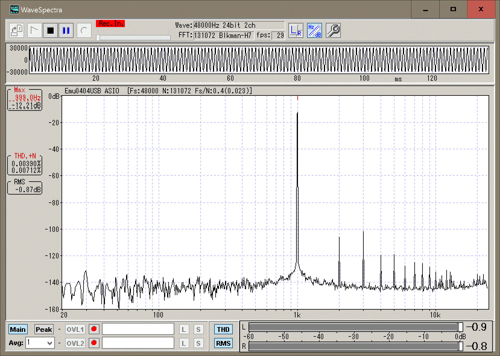

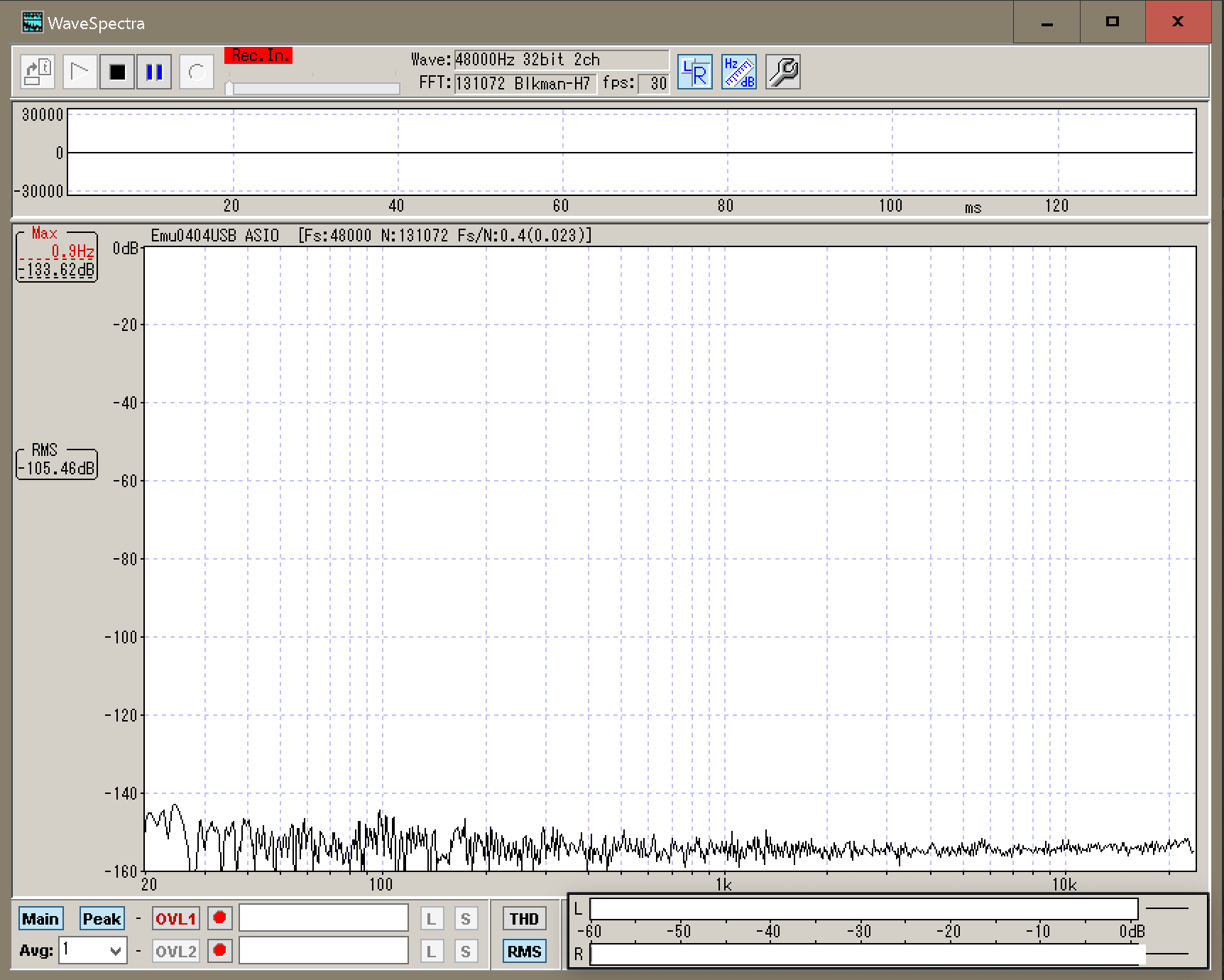

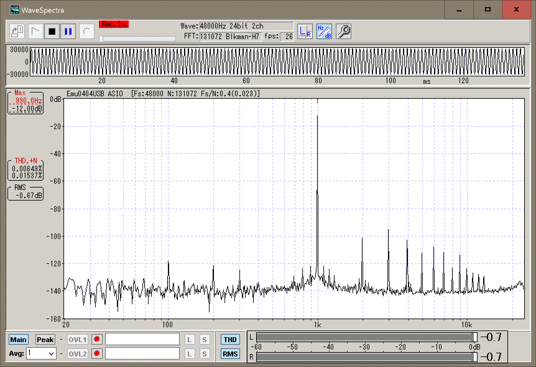

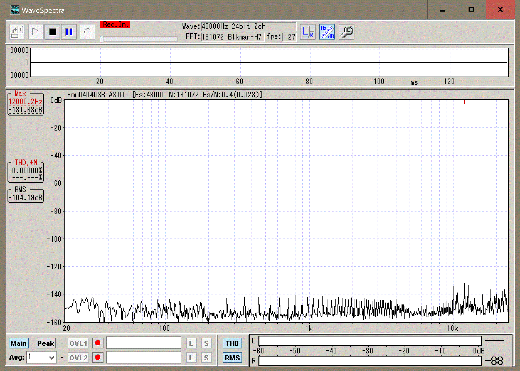

Joined 2018

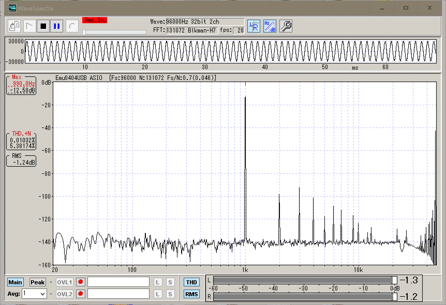

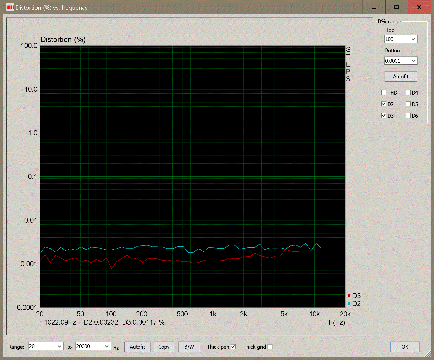

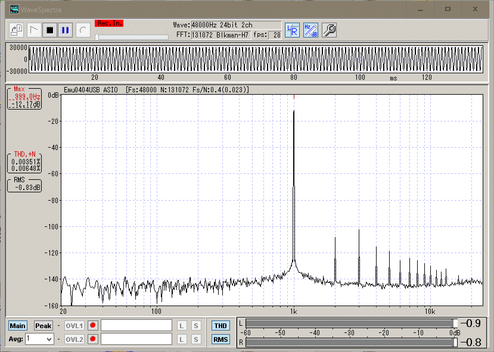

FreeDSP OVTAVIA(Version 0.33j ) Measurement Result Part-1

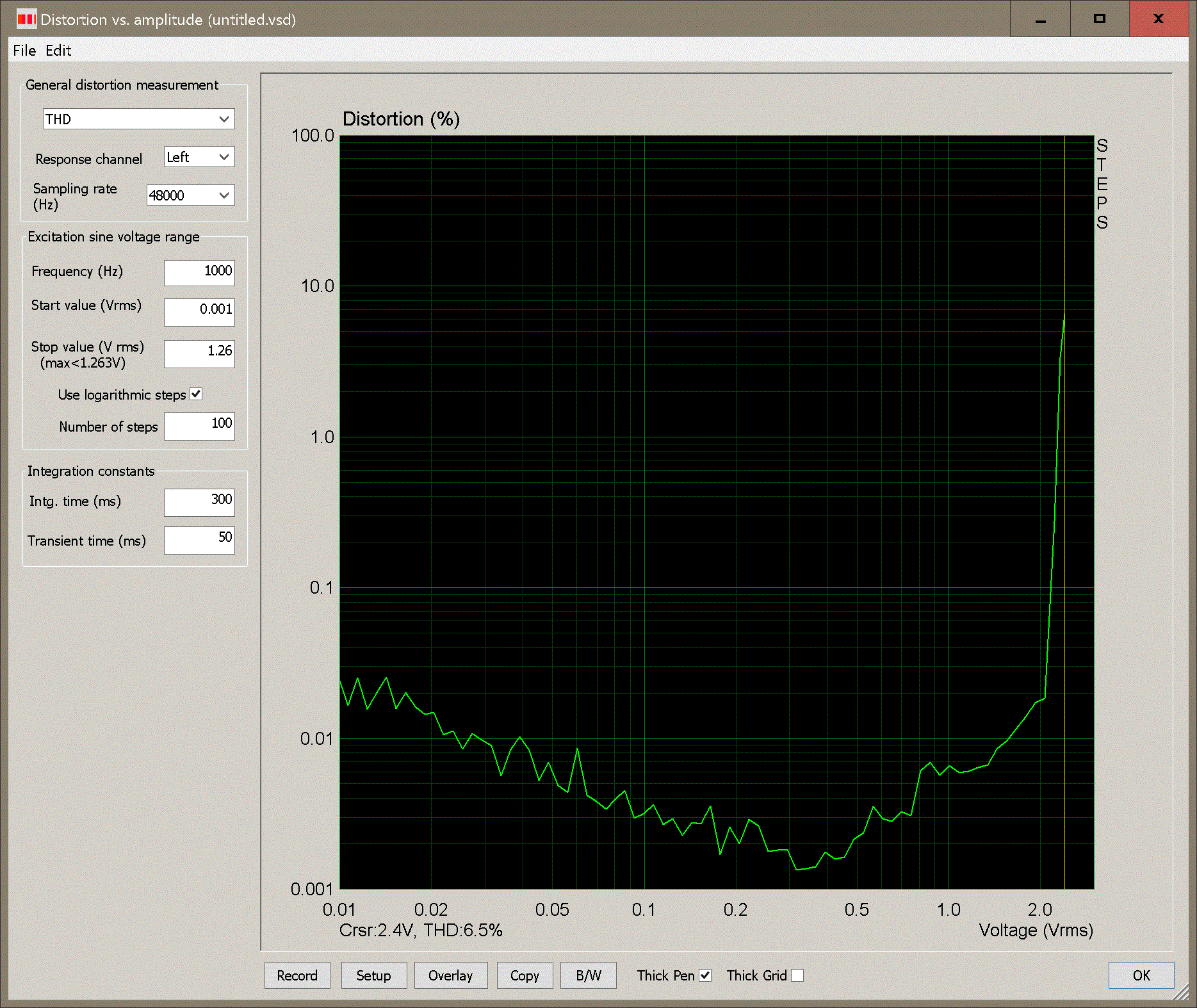

PCM1808 is used for Analog Source Input.ADC to SPDIF OUTPUT Distortion Performance Test (-1dB FS)

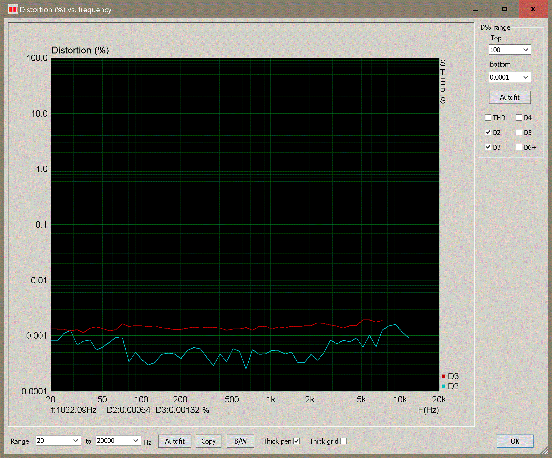

ADC to SPDIF OUTPUT DIstortion Performance Test (-3dB FS)

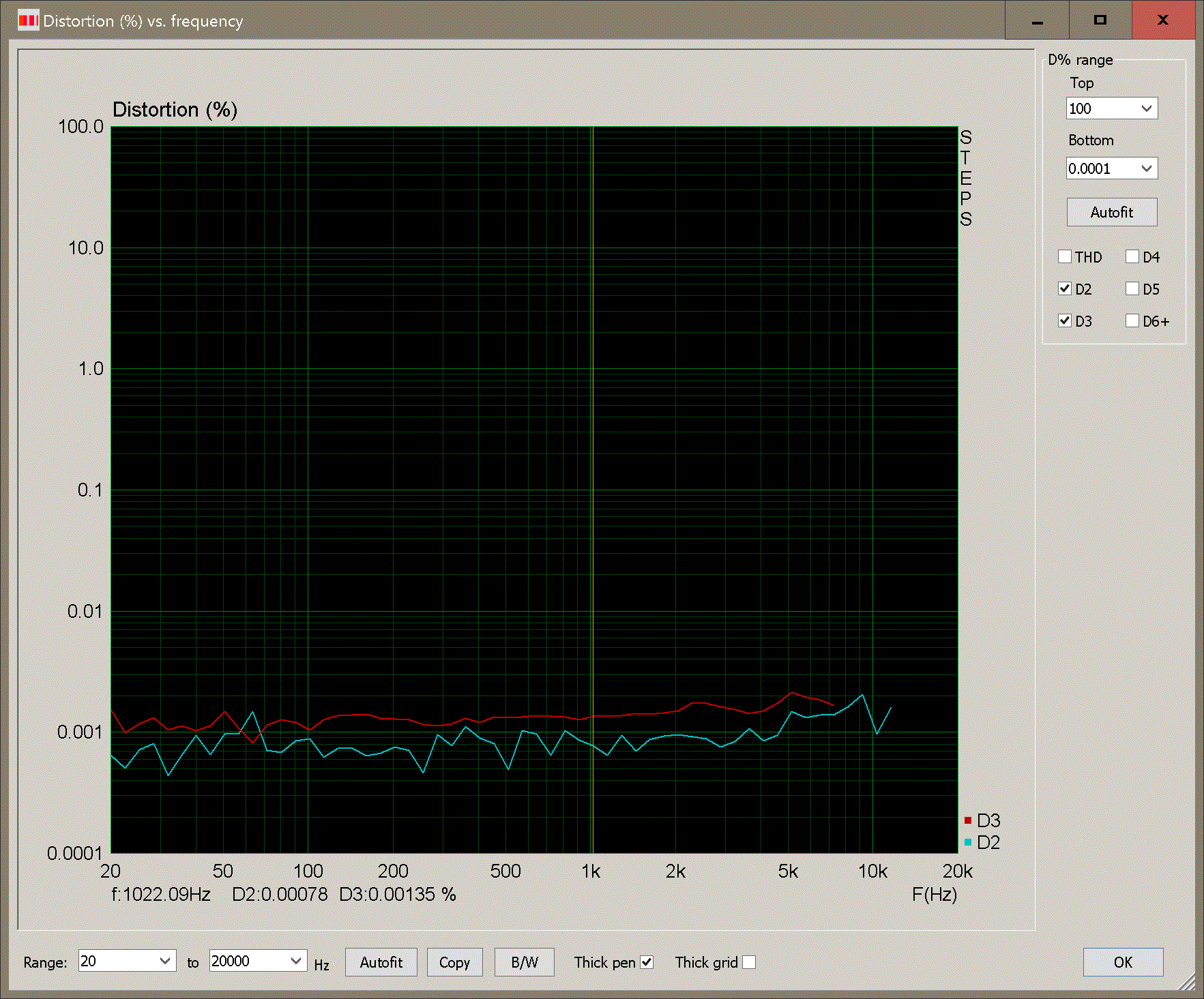

ADC to SPDIF OUTPUT Best Distortion Performance was @-13dB FS

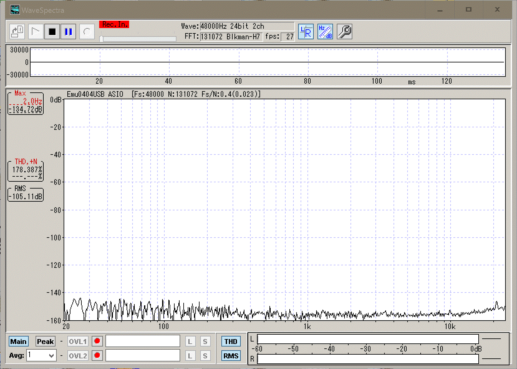

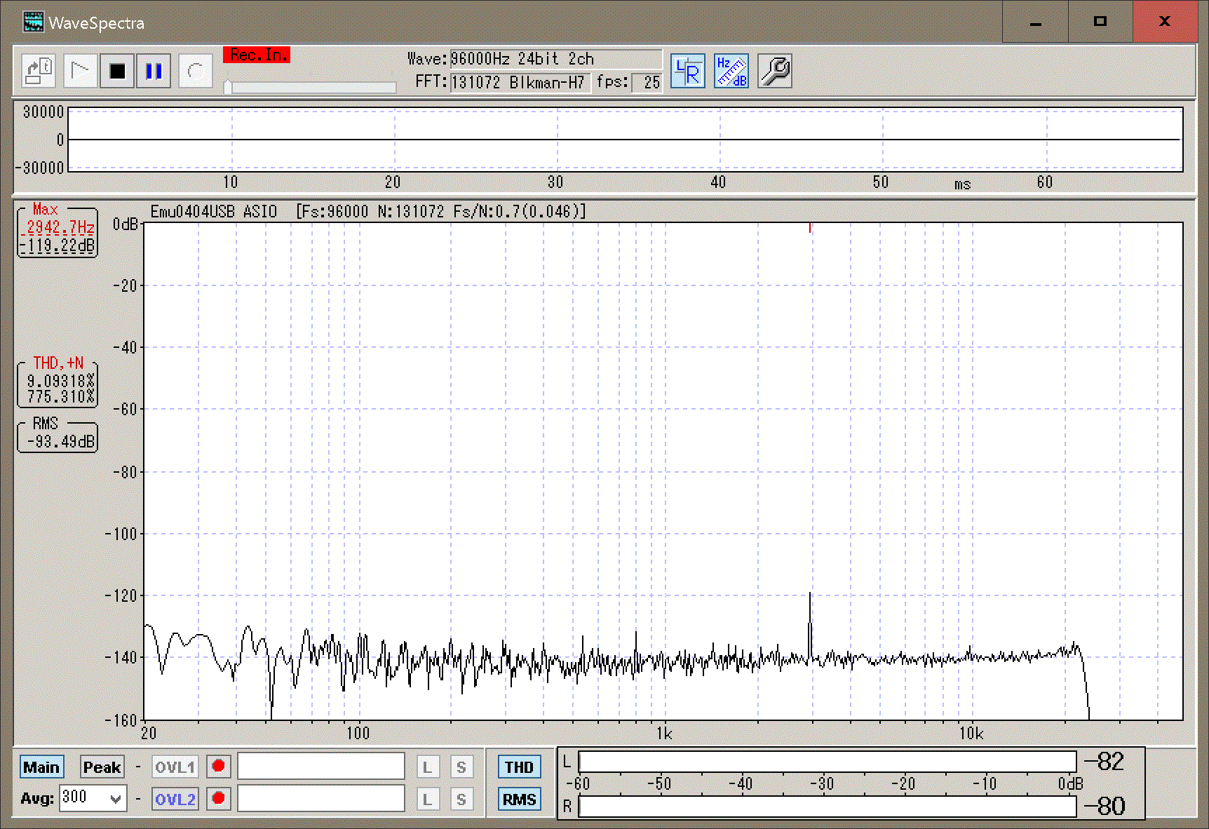

ADC to SPDIF OUTPUT Remain Noise (96kHz BW)

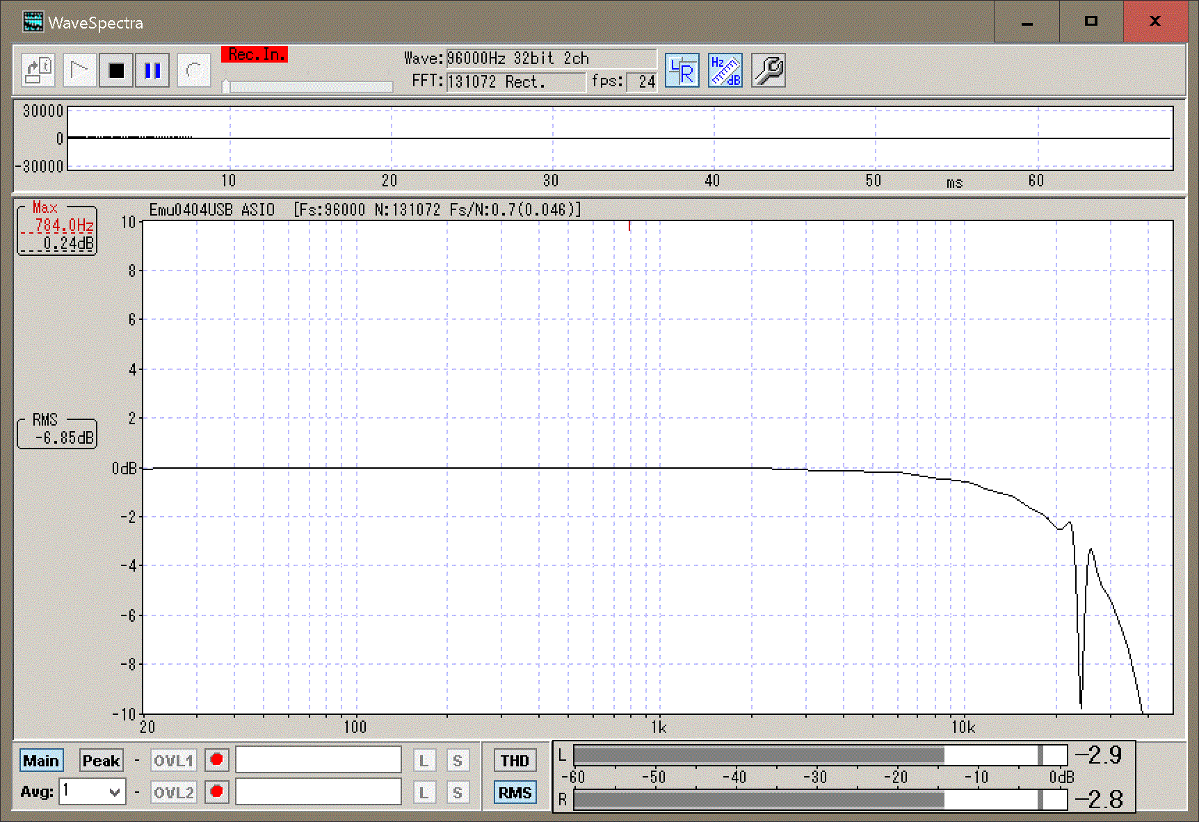

ADC to SPDIF Frequency Response (Sweep, 96kHz BW)
ADC runs at 48kHz, but ASRC upsamples to 96kHz.

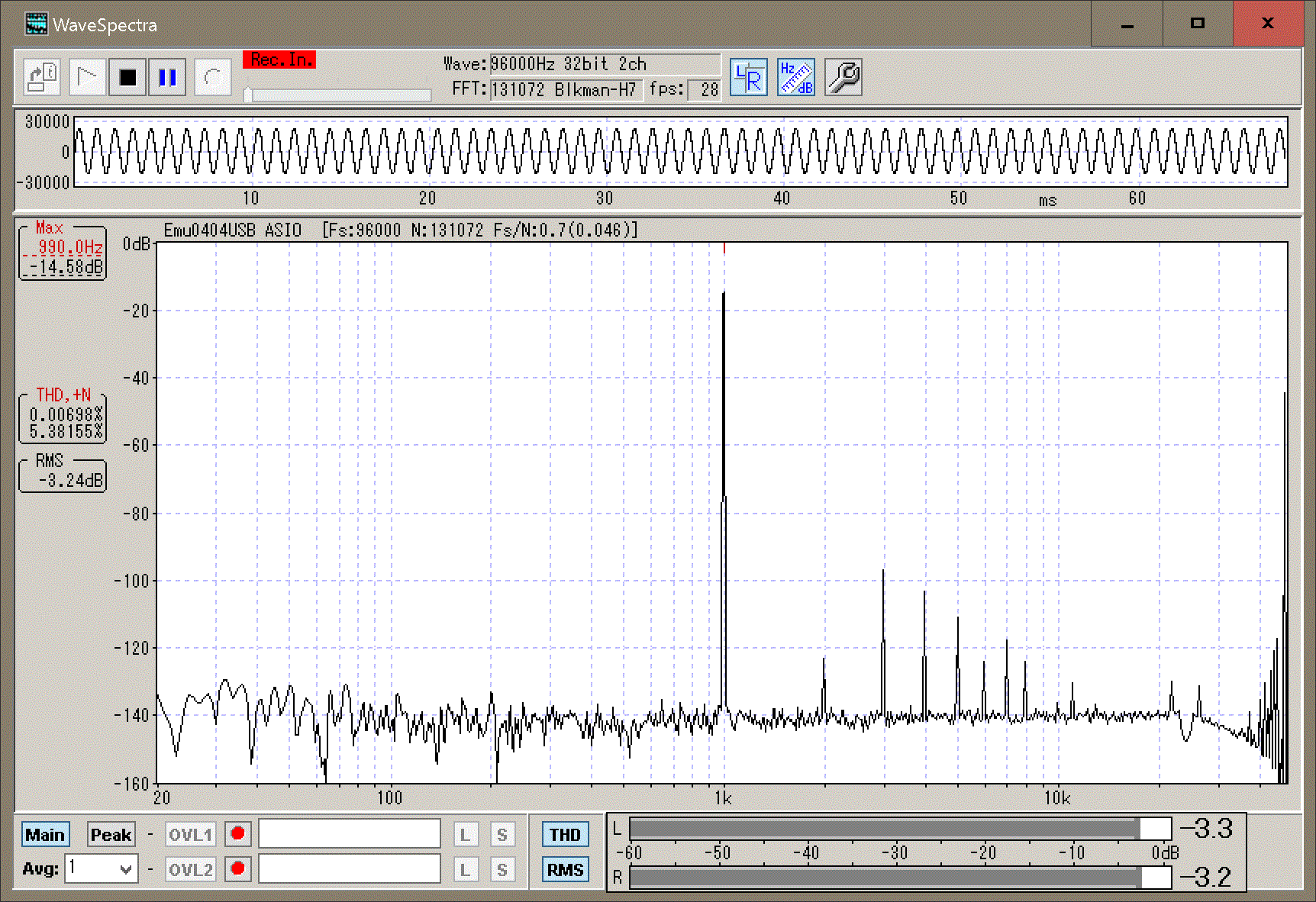

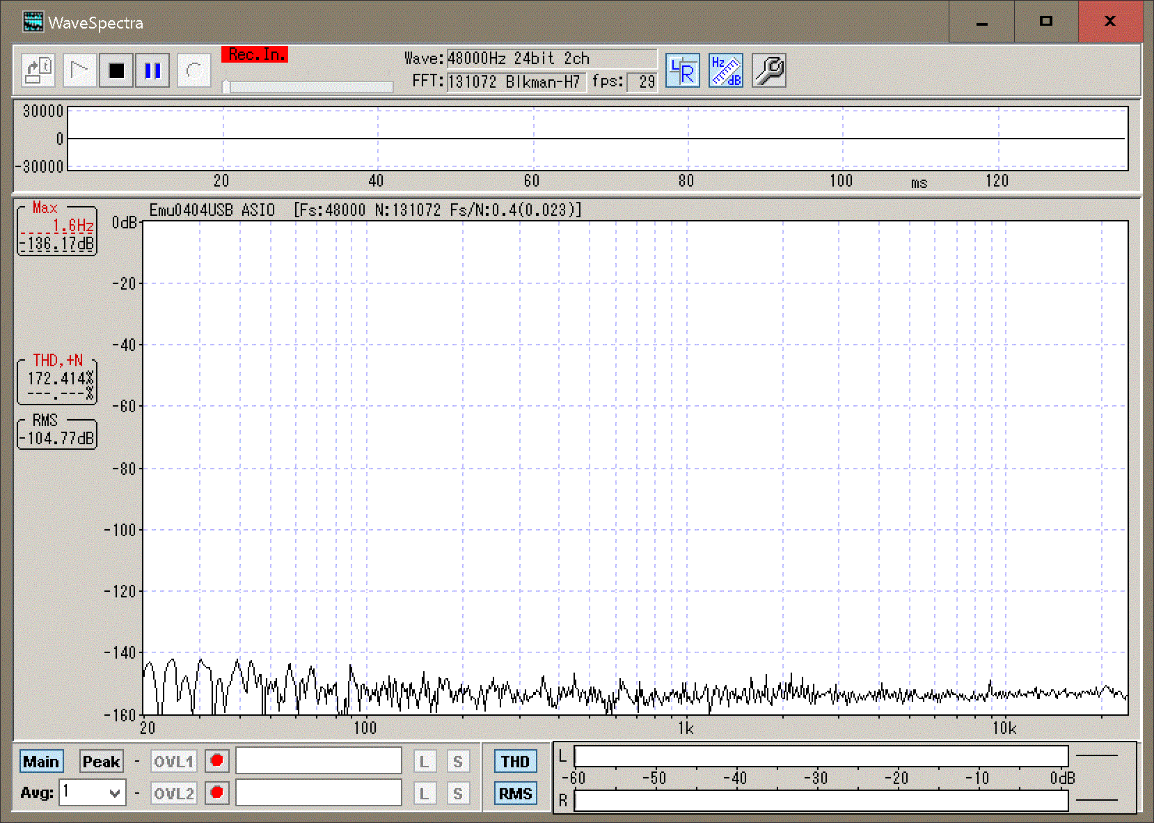

Joined 2018
FreeDSP OVTAVIA(Version 0.33j ) Measurement Result Part-2

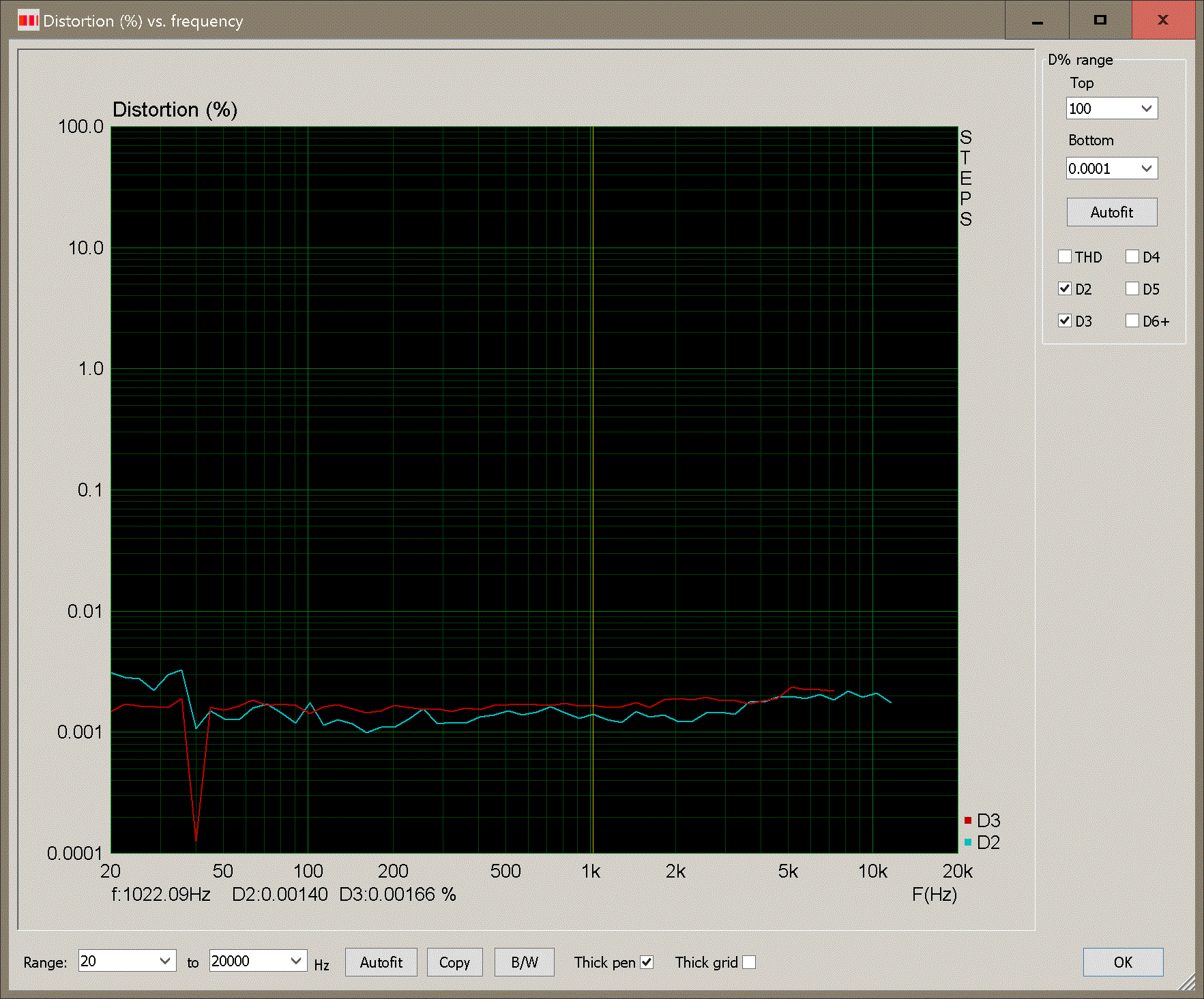

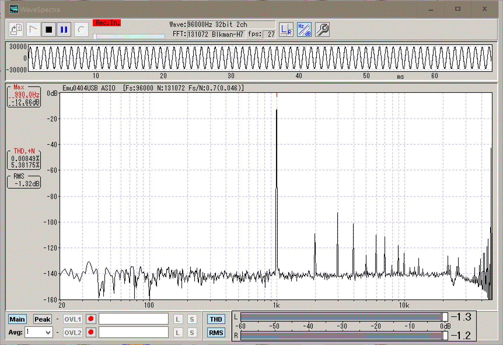

PCM5102A is used for Analog Output and OPA1632 Differential Line Driver is attached to each output. The feeding signal from USB input shows the actual DAC part sound performances.USB to Analog Output Distortion Performance (96k BW)
CH7/8 Lower Frequency Noise Spectrum Comes from Surround Mains Power Cable (50Hz/100V) Effect, Please Ignore it. (The following spectrum does not exist..)
Best Disrotion Performance @-10db FS (Ch8)

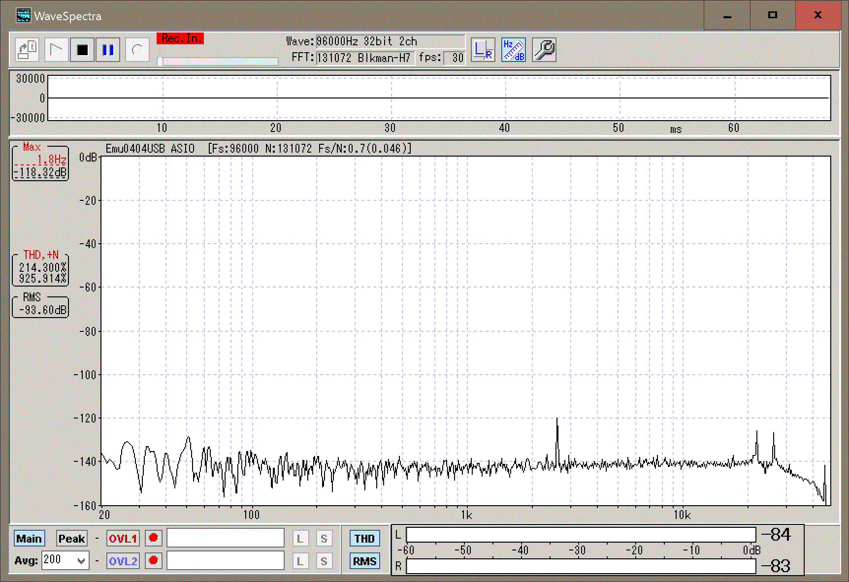

Analog Output Remain Noise Performance (96kBW)

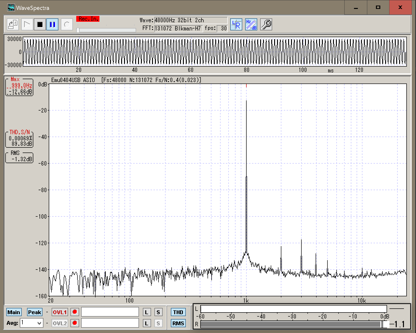

FreeDSP OVTAVIA(Version 0.33j ) Measurement Result Part-3

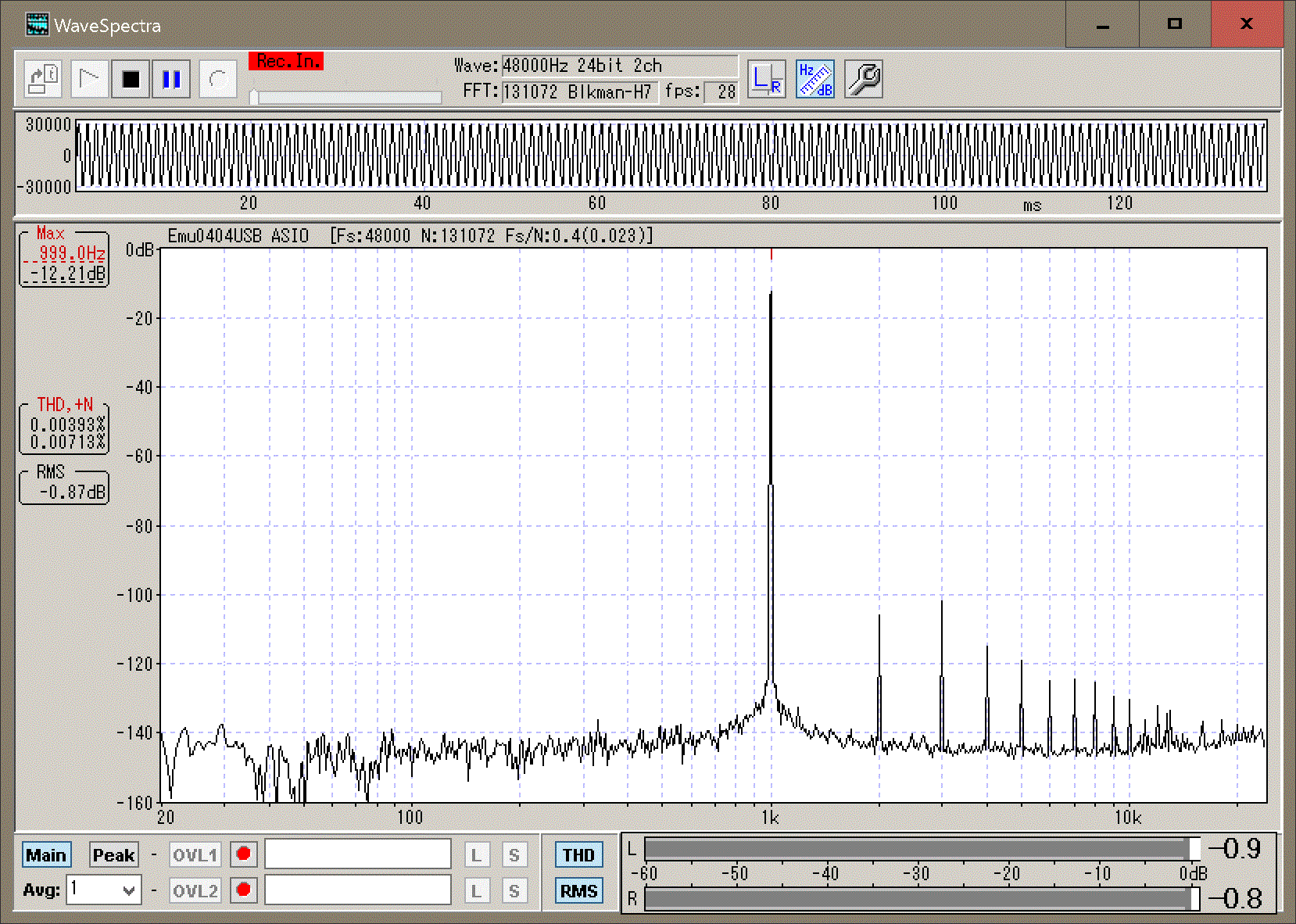

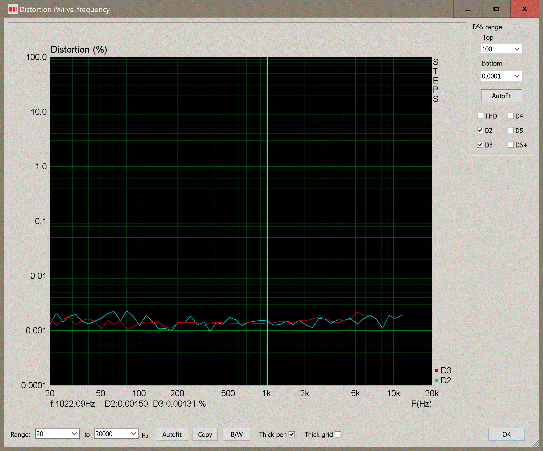

Analog Input to Output Overall Analog-Audio Performance TestAnalog Input to Differential-Analog Output Overall DIstortion Performance (48k BW)
Analog Input to Differential-Analog Output Frequency Response Performance (96k BW)
Analog Input to Differential Analog-Output through the DSP Remain Noise (96k BW)

FreeDSP OVTAVIA(Version 0.33j ) Measurement Result Part-4
I would like to add some measurement results...Analog Input to Differential-Analog Output(48k BW)
Typical known PCM1808 ADC characteristics.

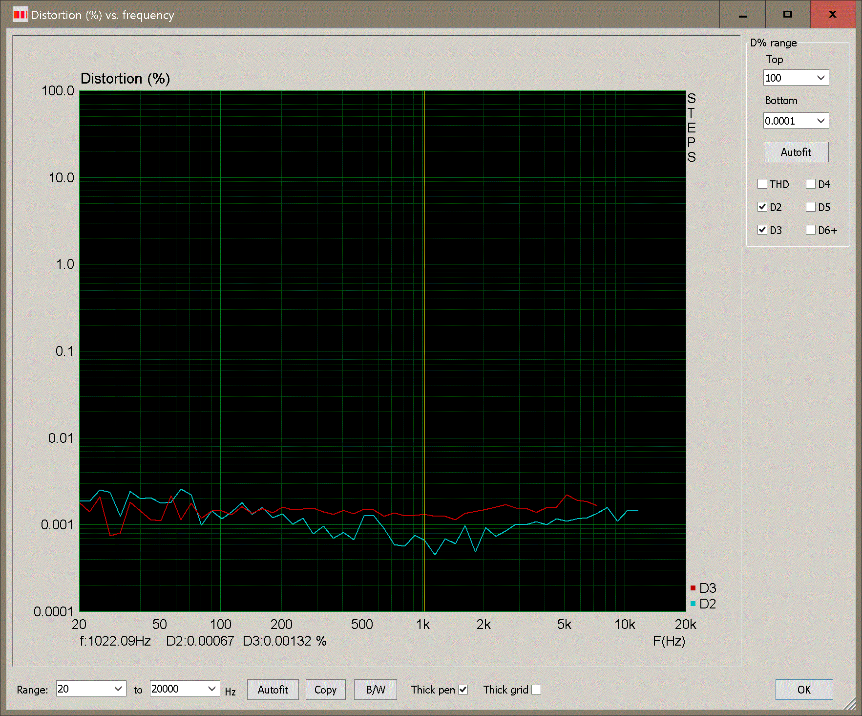

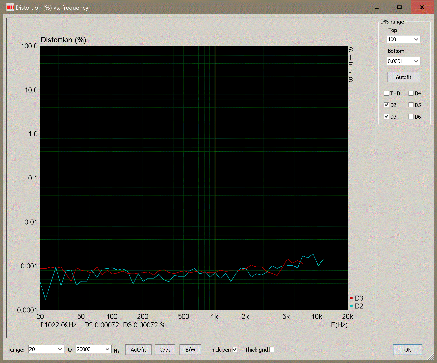

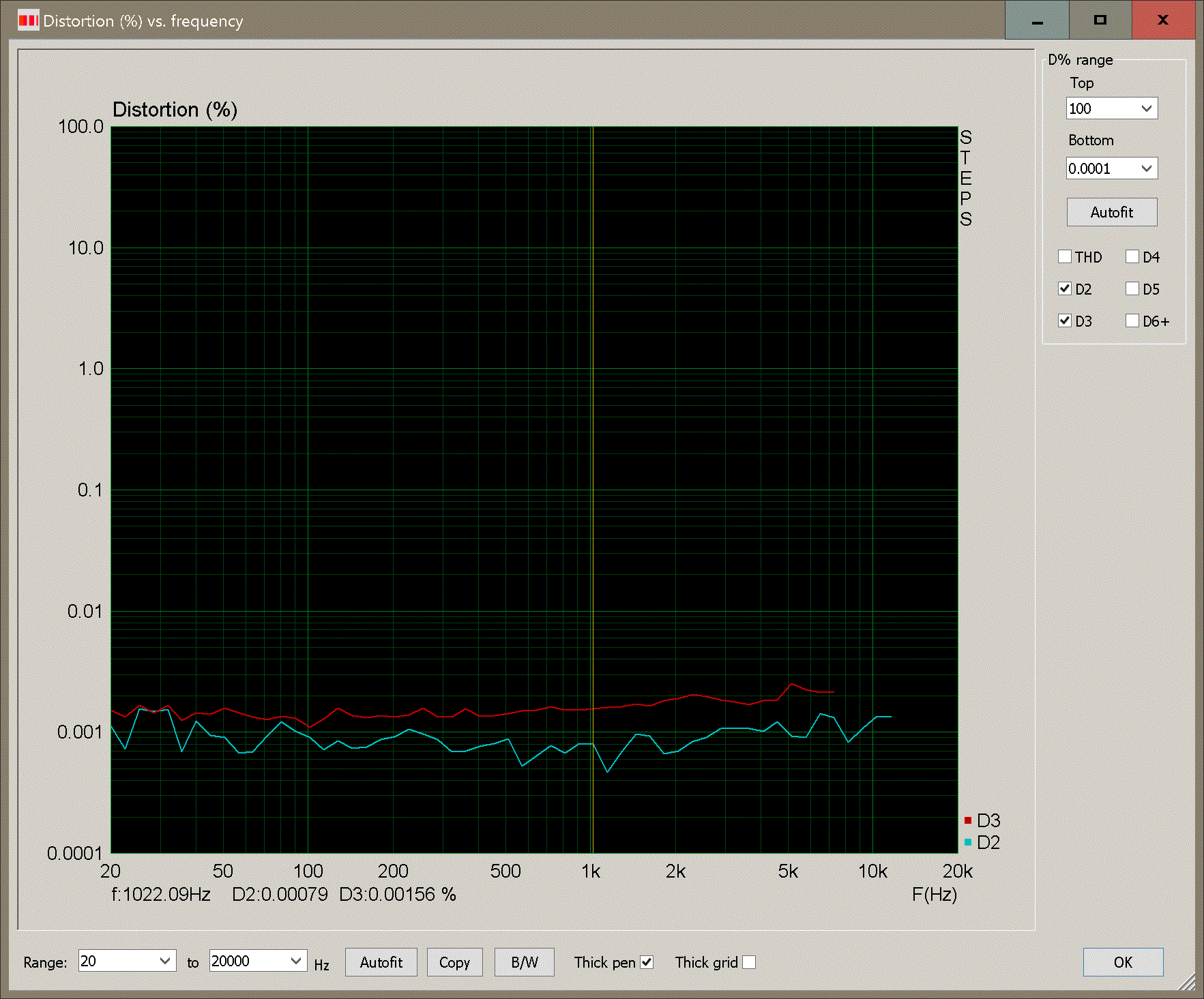

S/PDIF Optical-Input to DAC Frequency vs. Harmonic Distortion
Some of the channels indicate good performance, but the differences between channels are not so much.

Joined 2018

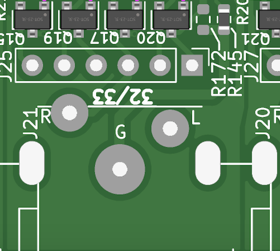

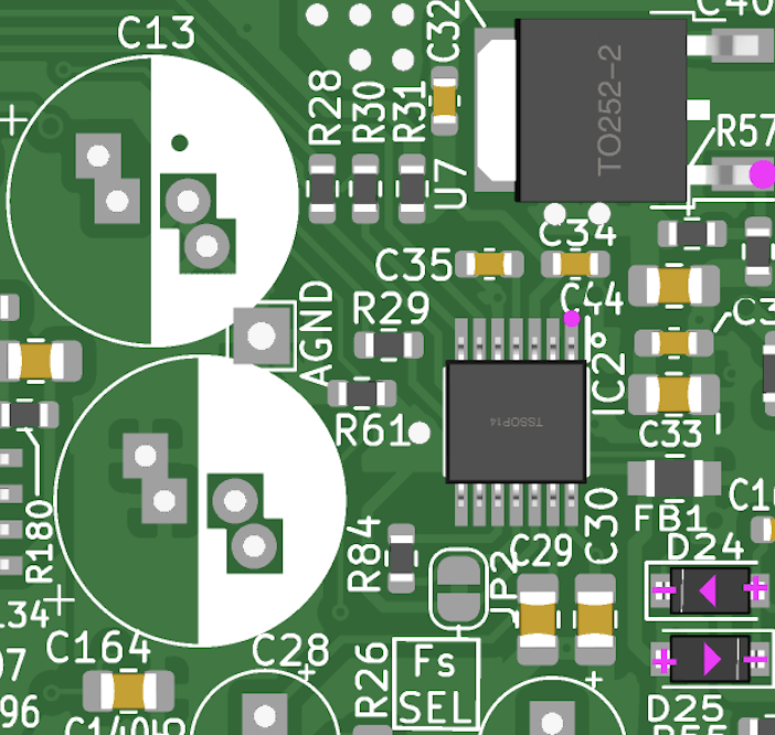

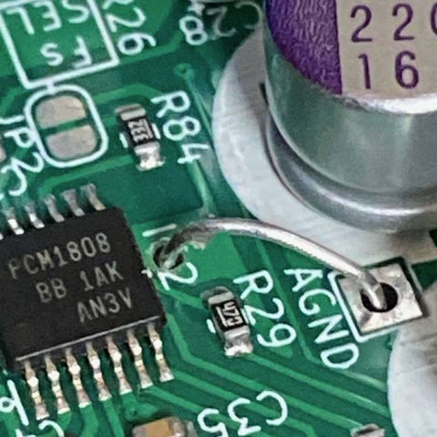

New findings, connecting AGND and DGND at this point, increase the signal-to-noise ratio.
So I added a jumper resistor on the latest version PCB design.
And RCA-pin jacks are changed to RCJ-2232

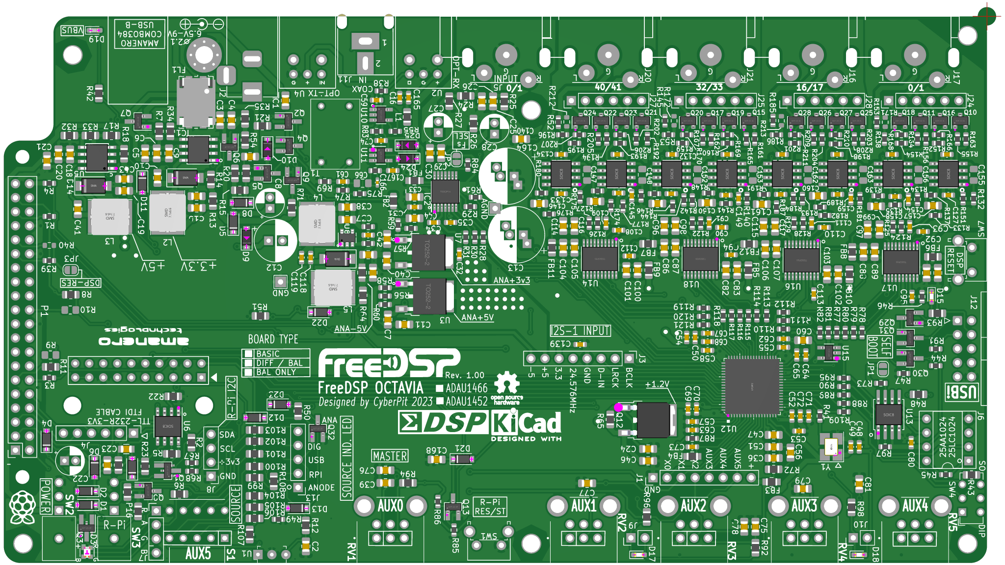

Finally, I released FreeDSP OCTAVIA version 1.00
Now FreeDSP OCTAVIA version 1.00 Design is possible to download from the FreeDSP GitHub Page.

Hi CyberPit-San,
thanks for your great work bringing out version 1.0 and all the measurements you have done. With your latest finding of connecting AGND and DGND the measurements look really good.
If I have seen it correctly on previous version they were connected just by the ferrite bead FB1. I was wondering if the same result can be achieved by just swapping FB1 with a 0 ohm resistor. Have you tried that as well?
BR Ludwig

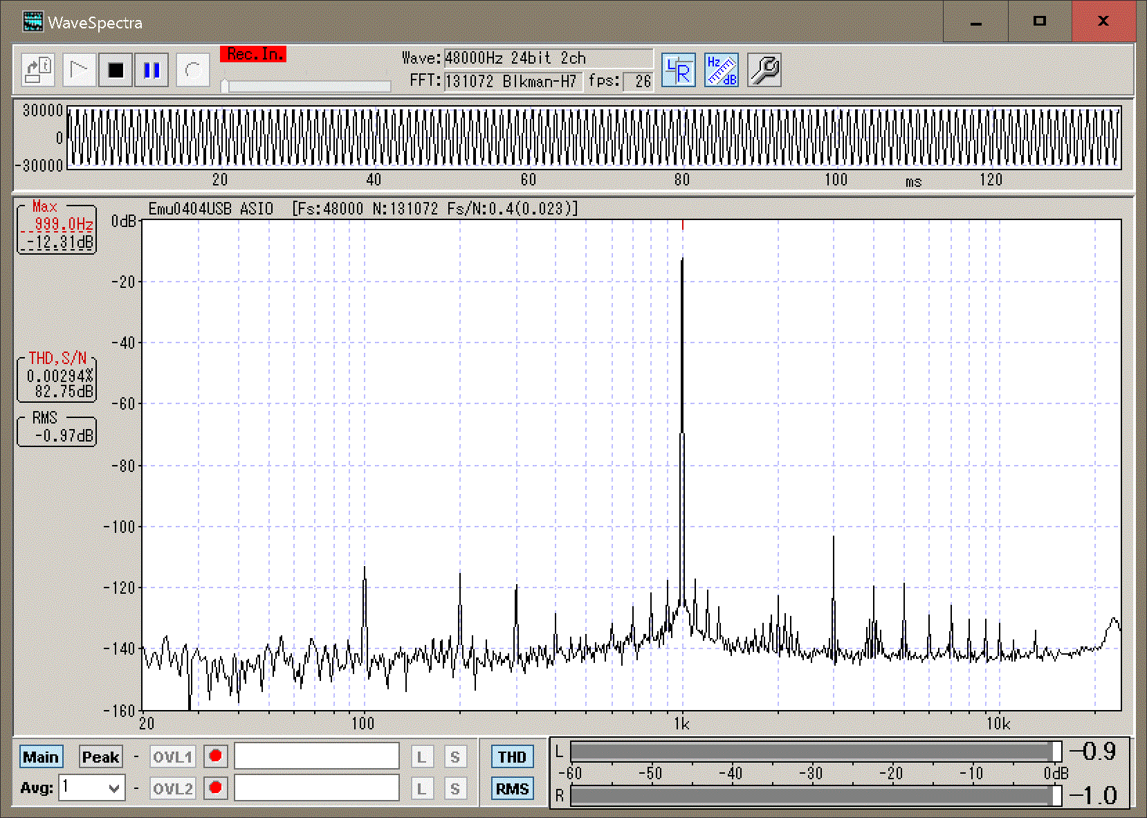

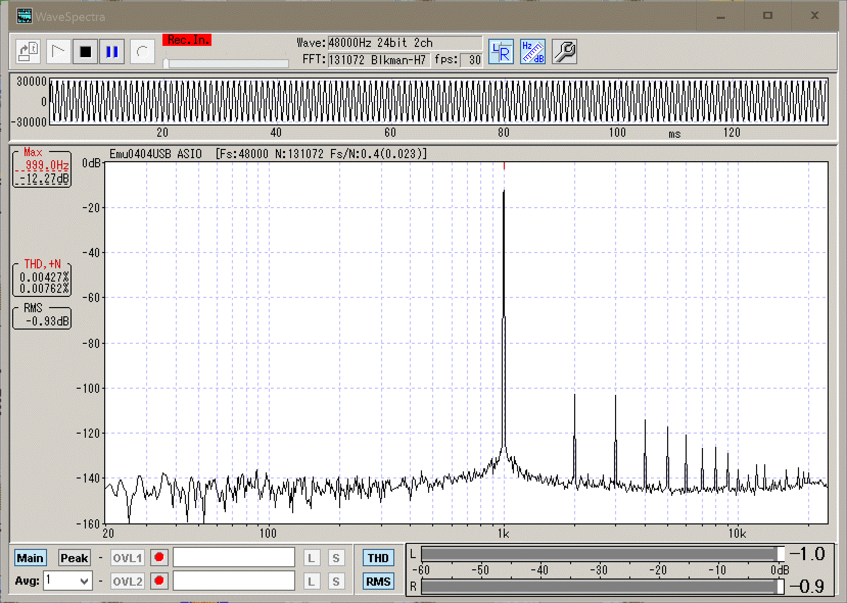

You can try to connect the J1-pin1 and J27-pin1.
The attached spectrums are tested on the ver0.1 board.
Bead Only
J1-pin1 and J27-pin1 connected with Wire

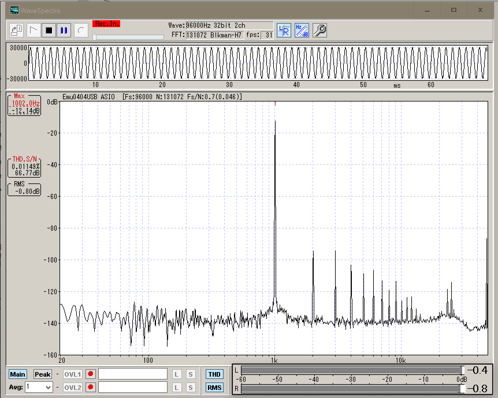

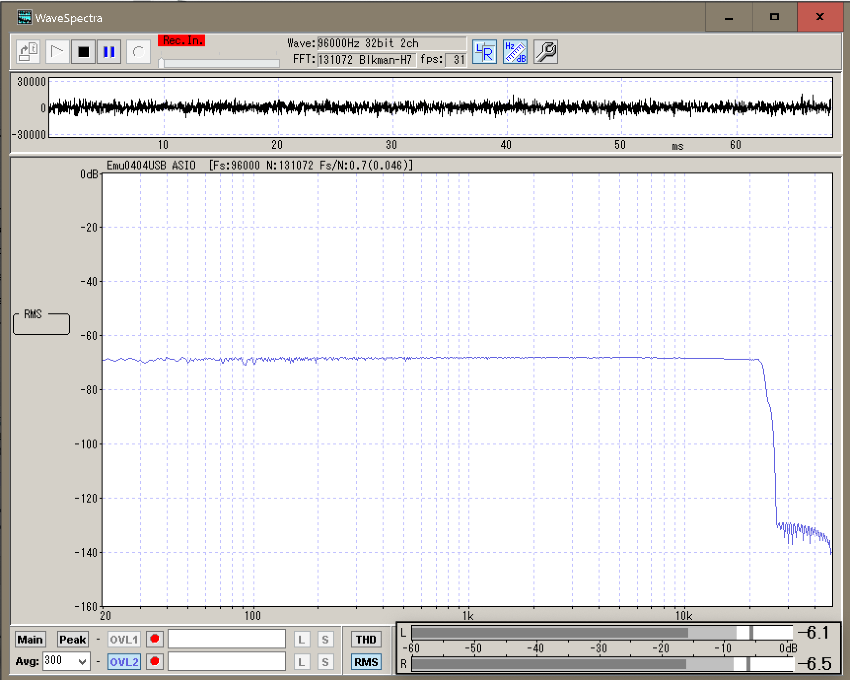

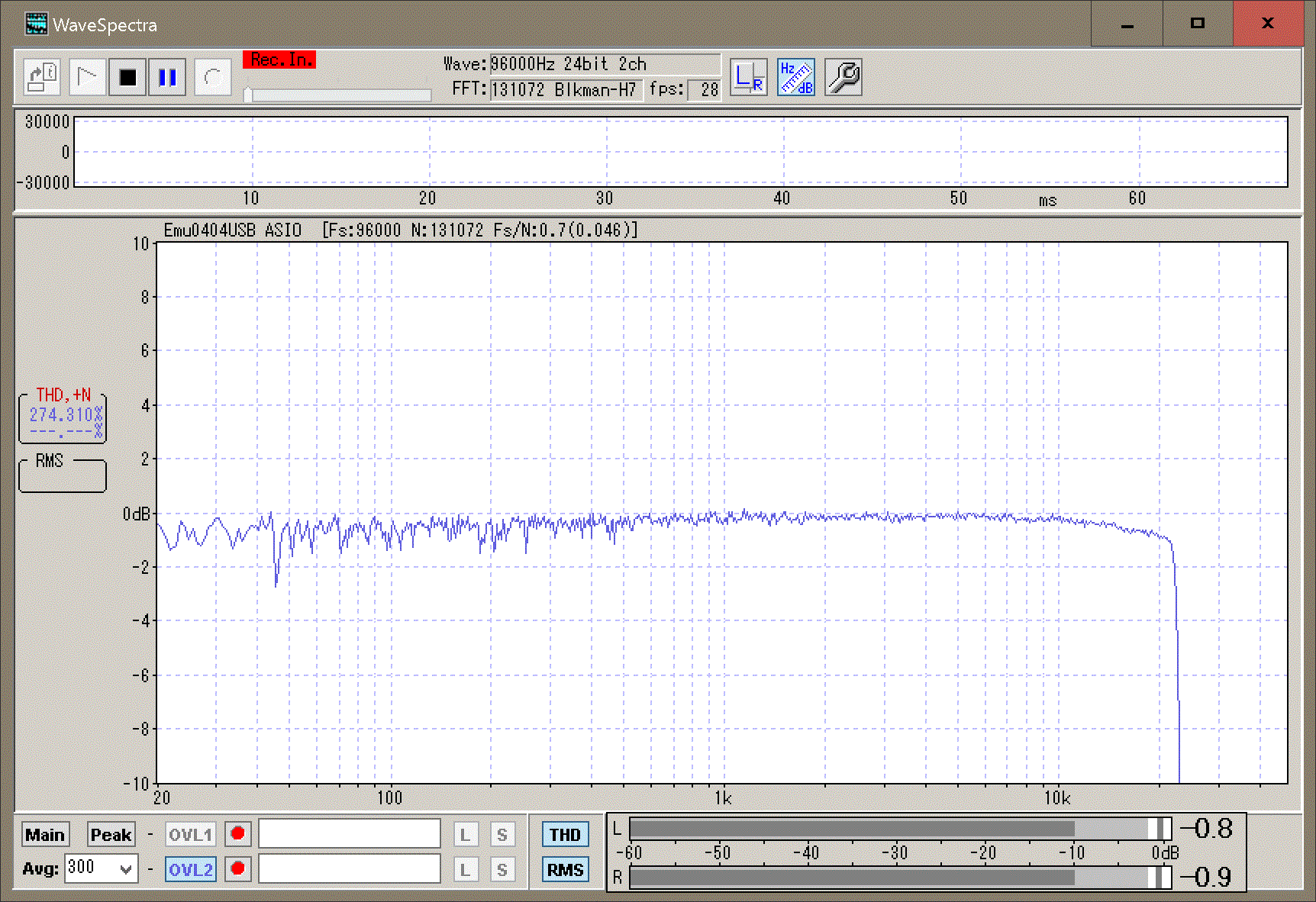

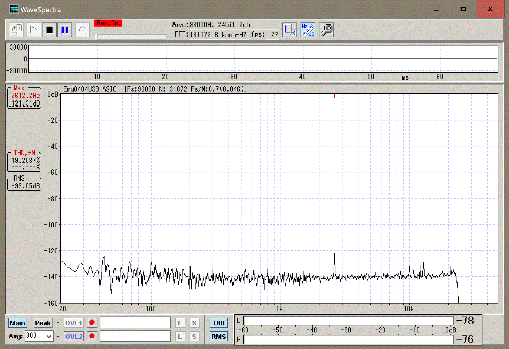

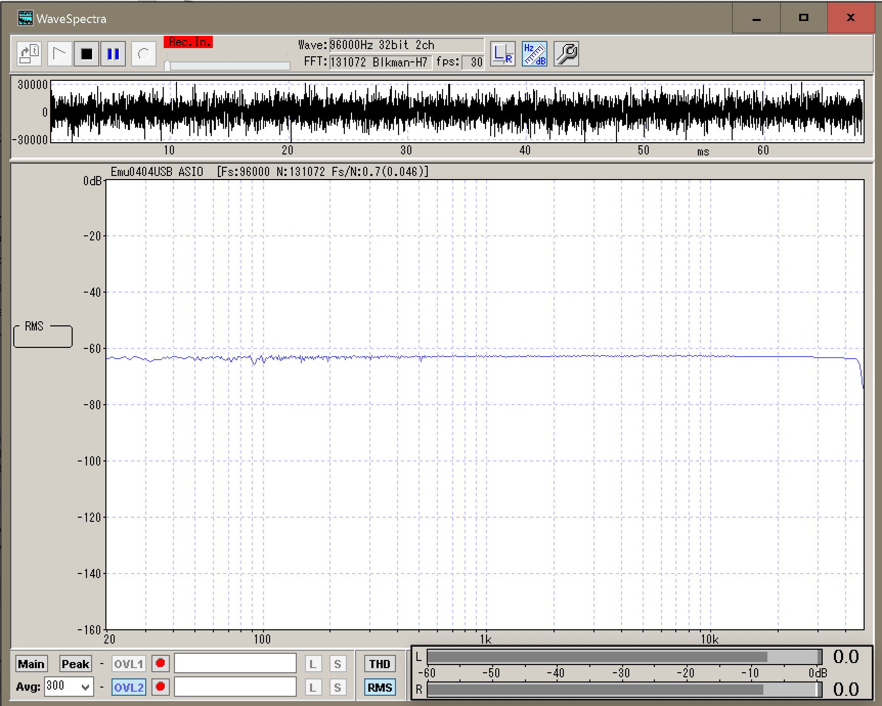

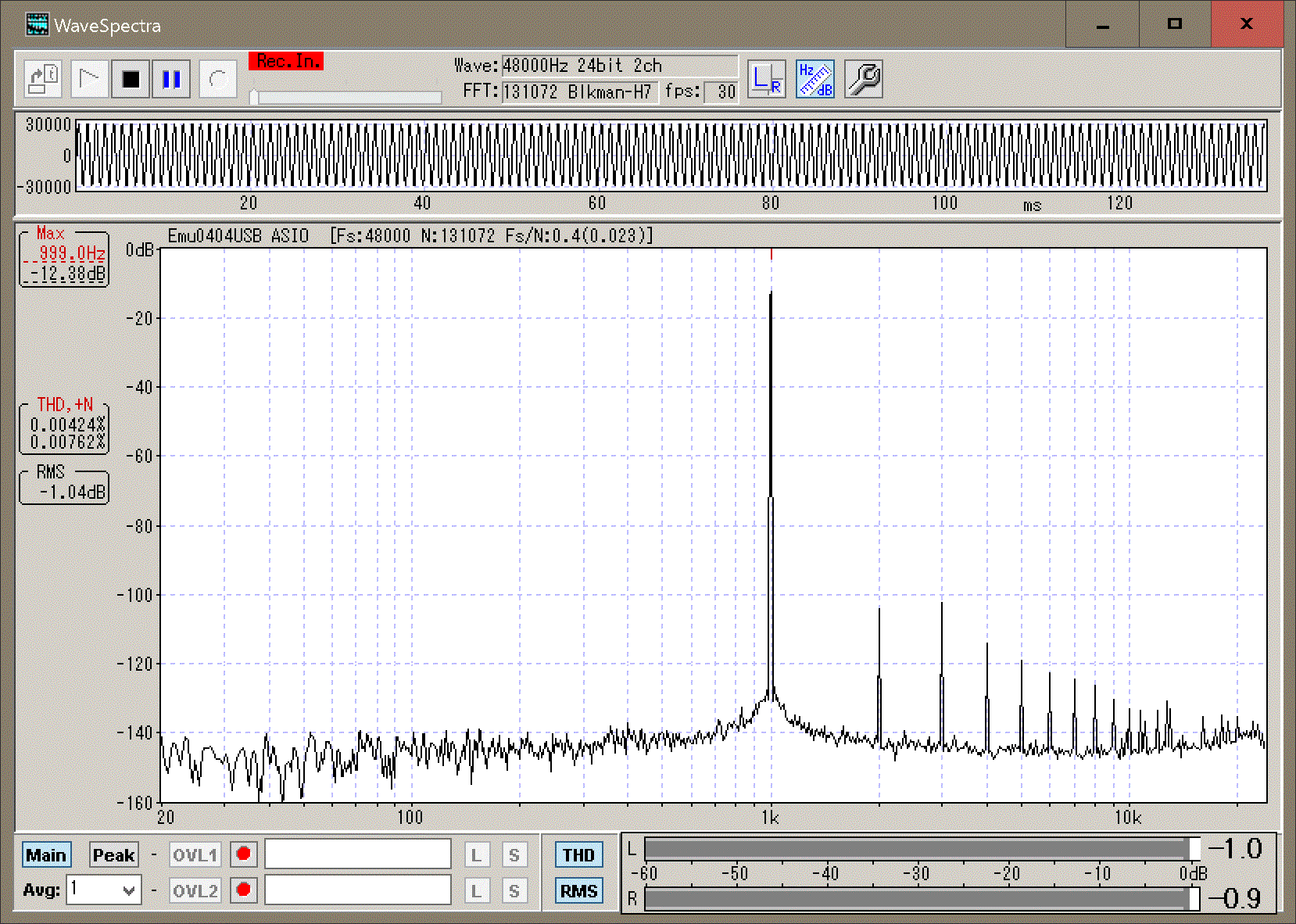

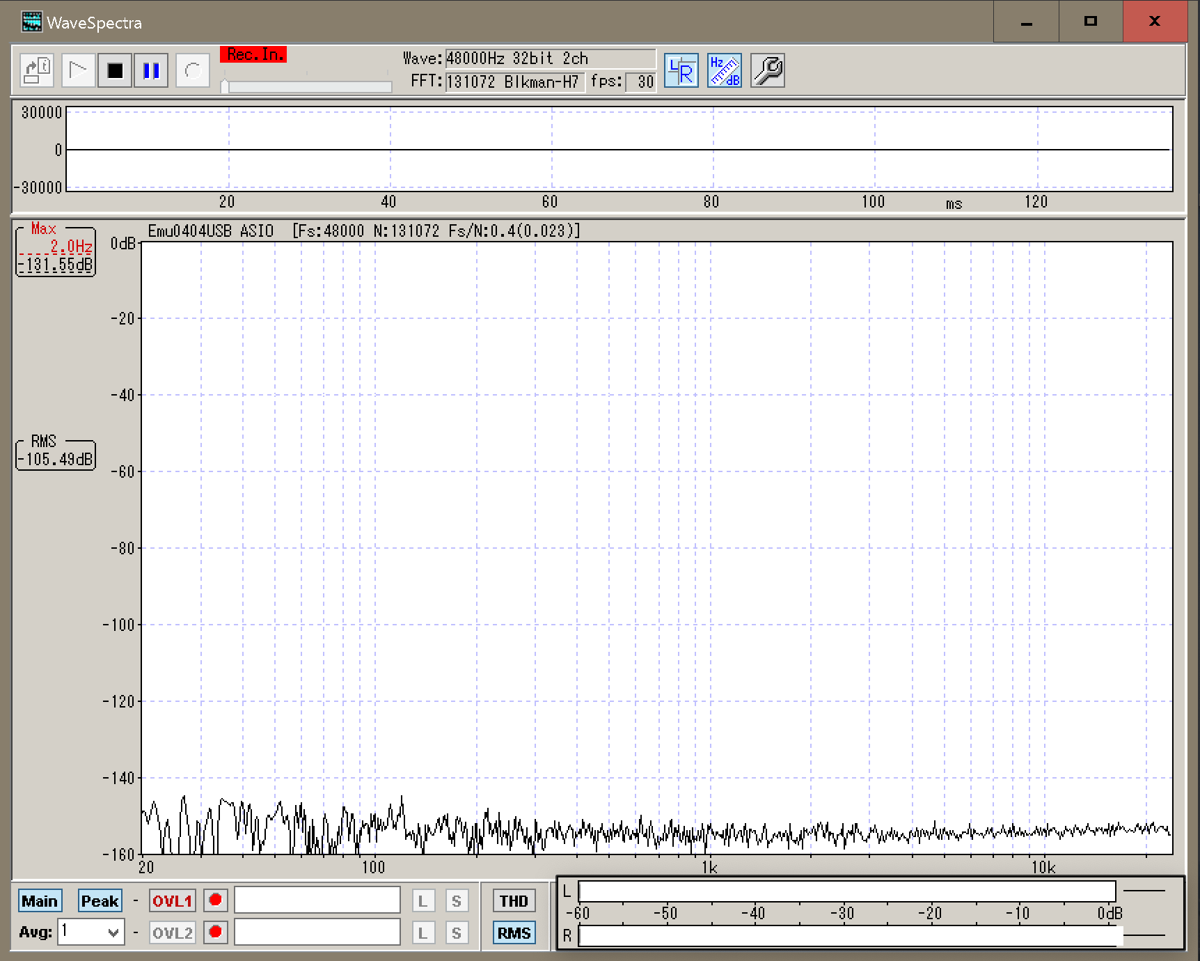

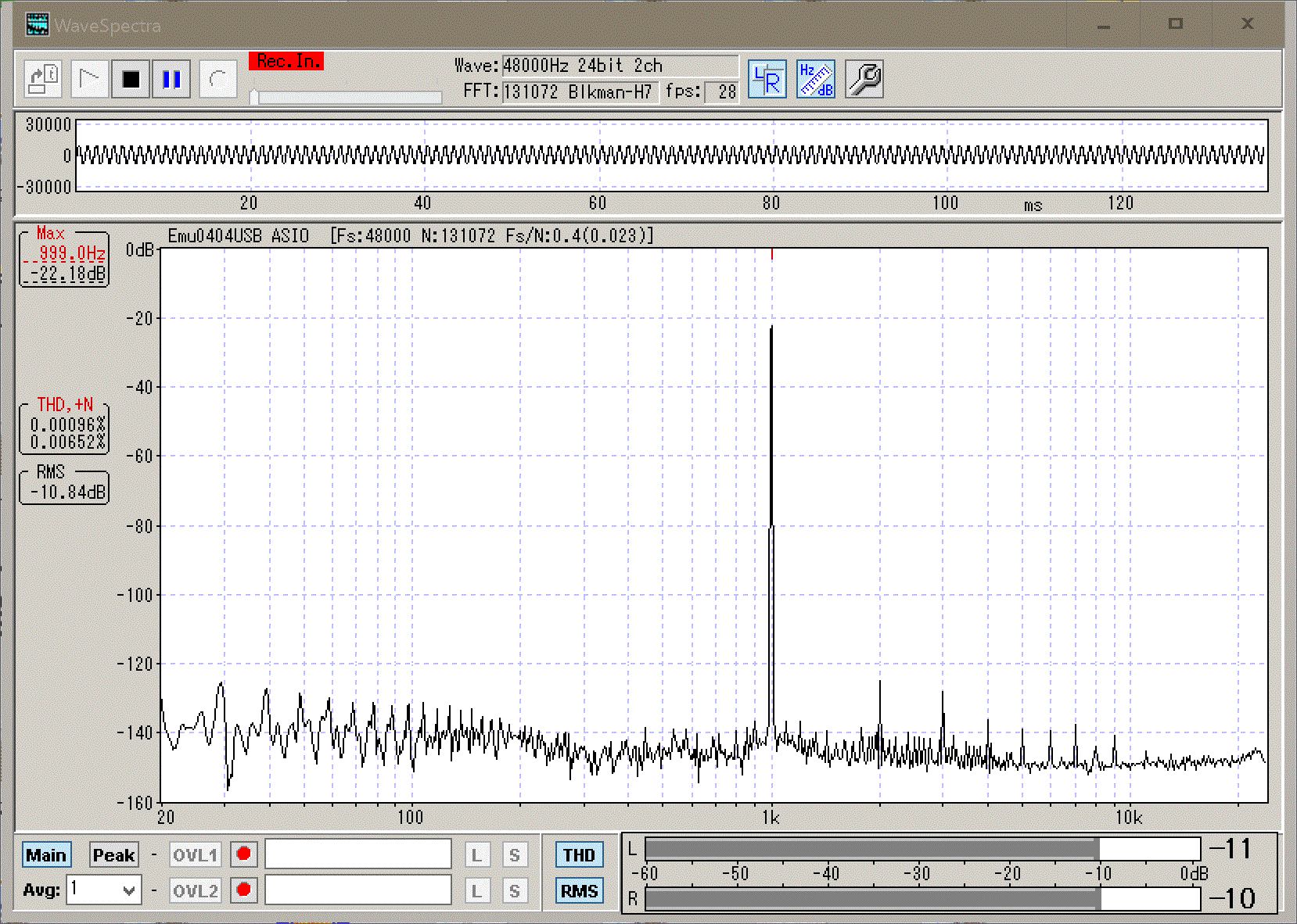

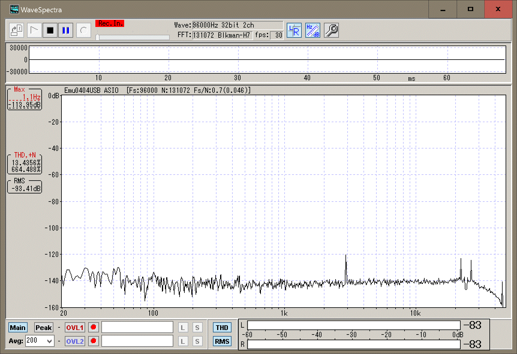

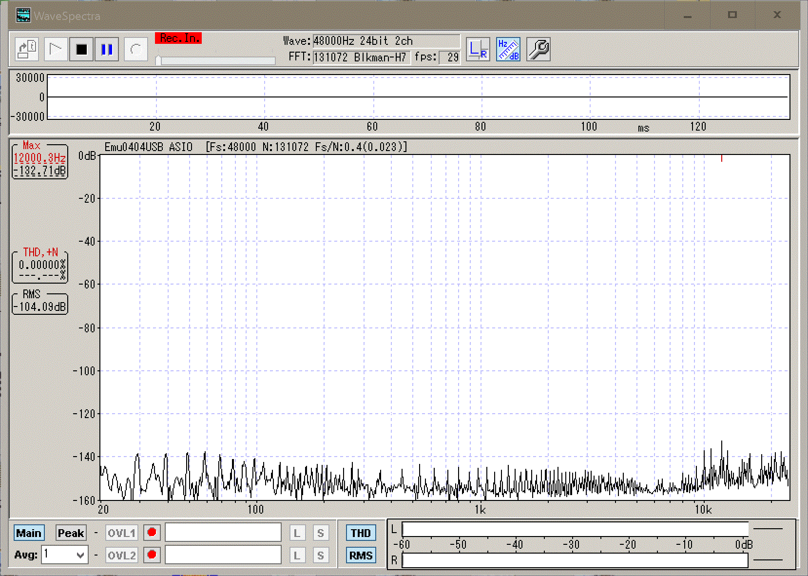

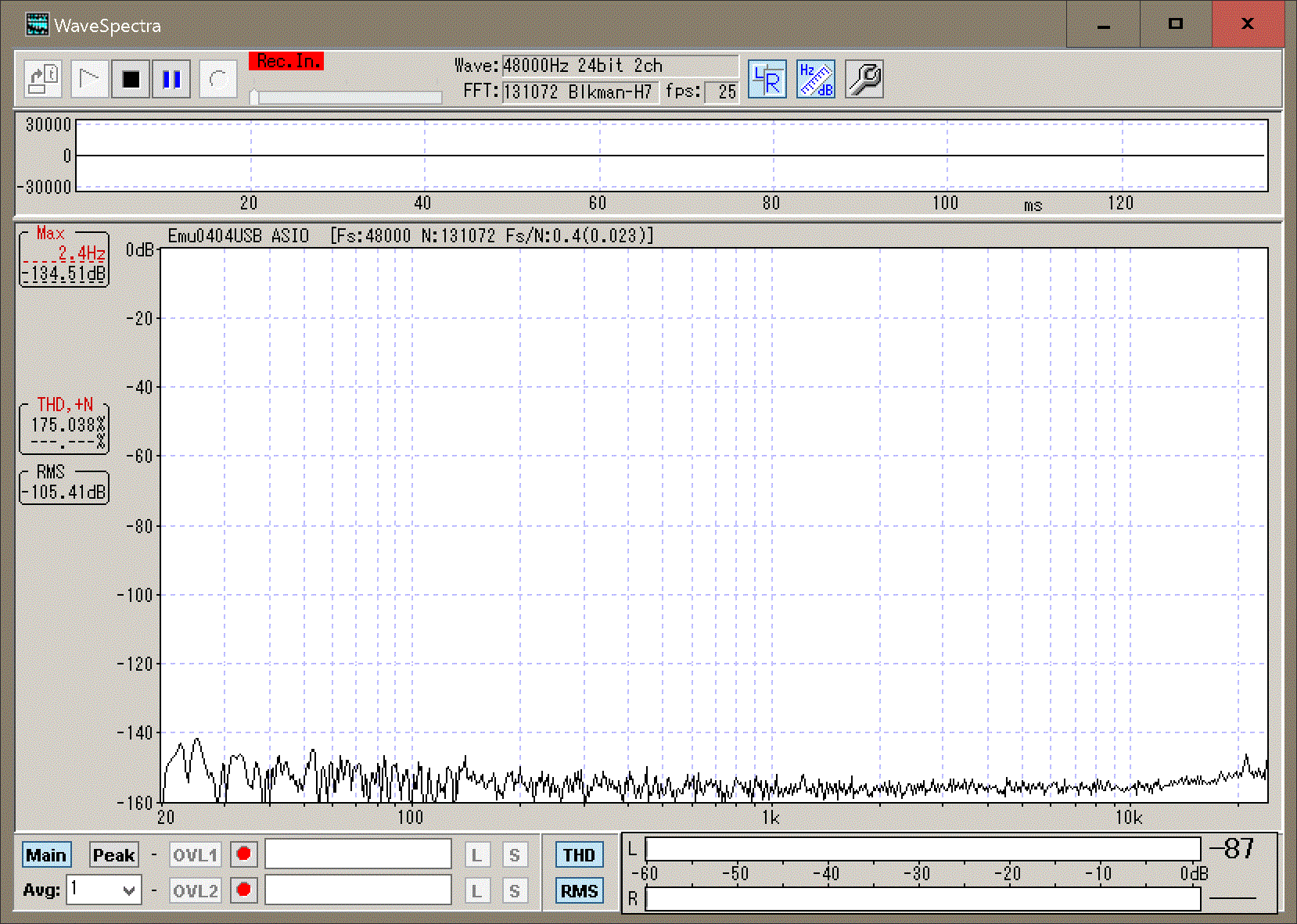

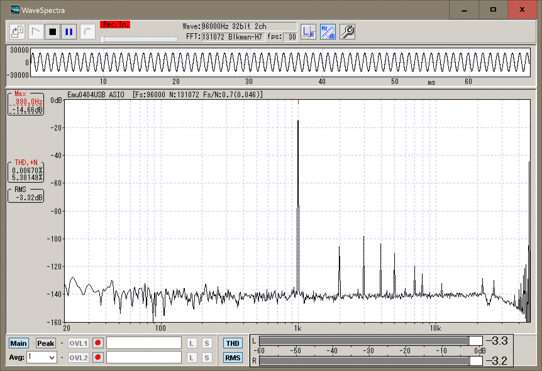

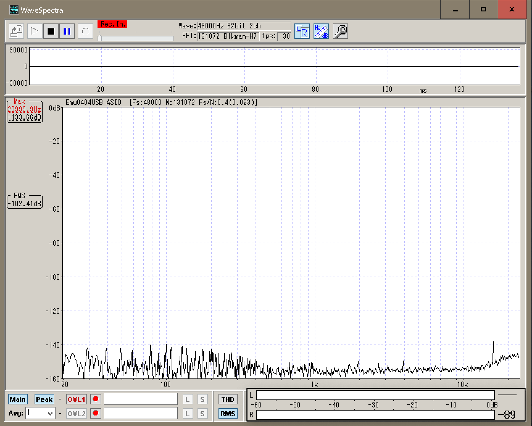

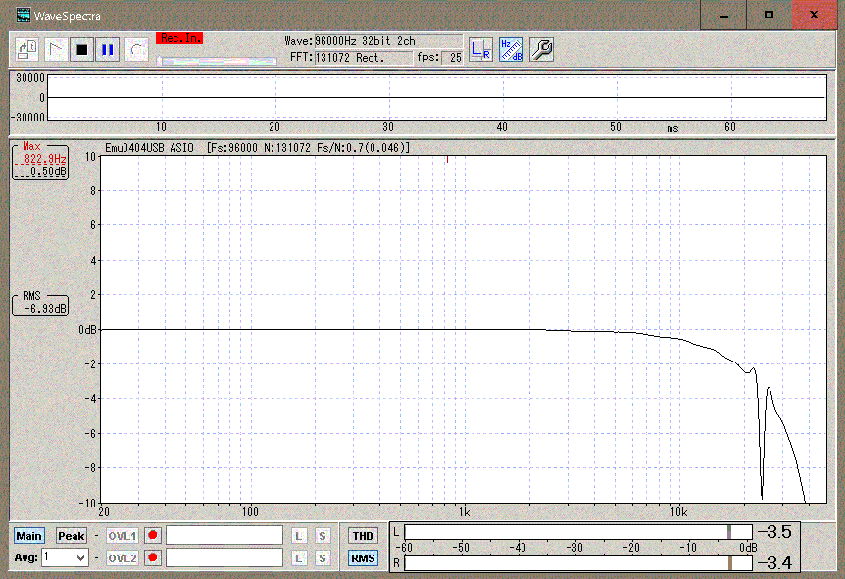

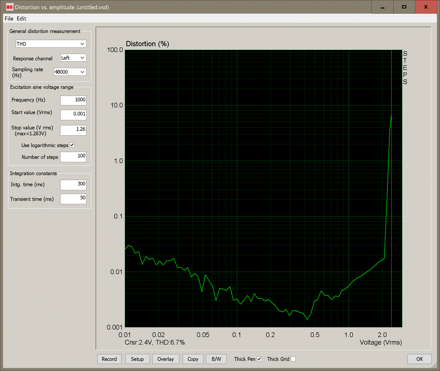

CyberPit, do you have Analog Input to Analog Output Overall Distortion Performance 96k, instead of 48k?
I'm need to replace my aging PCI sound card which I use for a second purpose as measurement interface, so your creation is quite logical replacement.

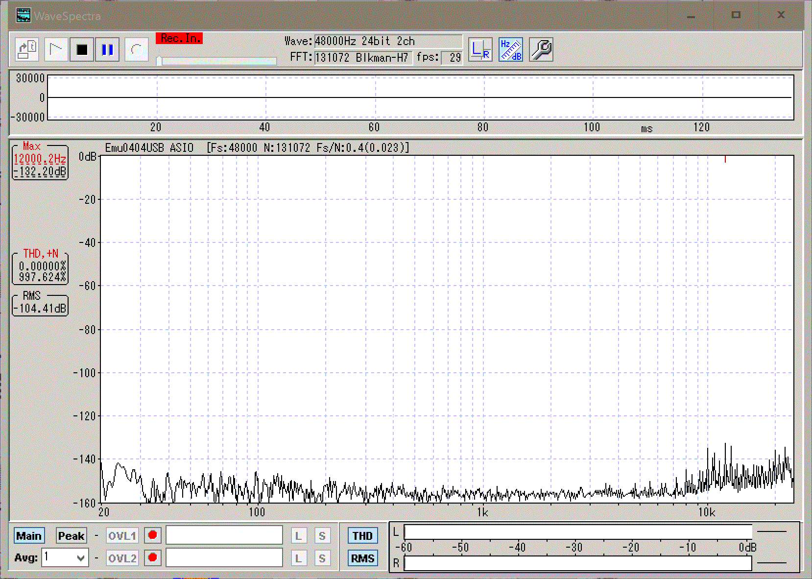

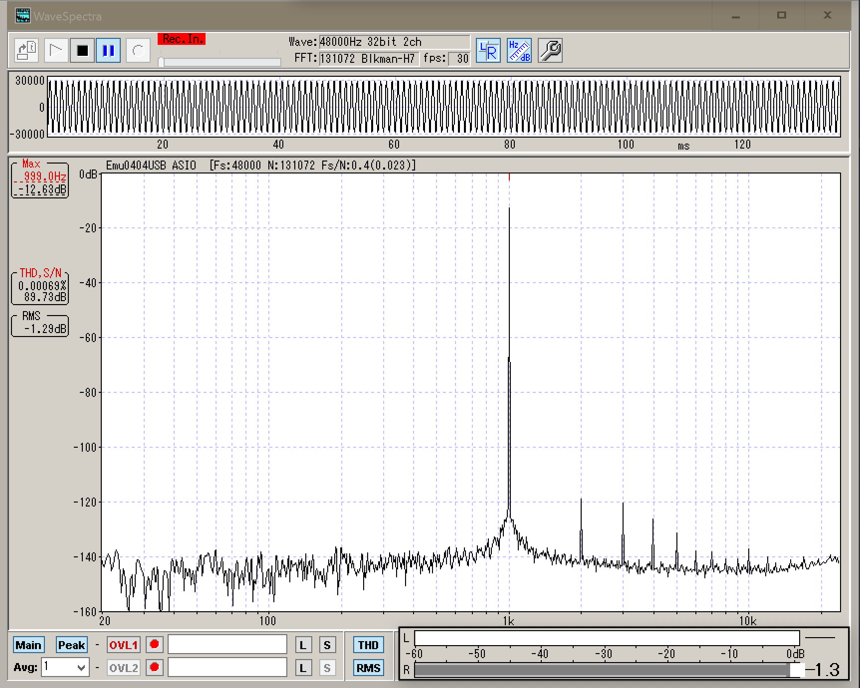

Joined 2018
Hi LinuksGuru-San,

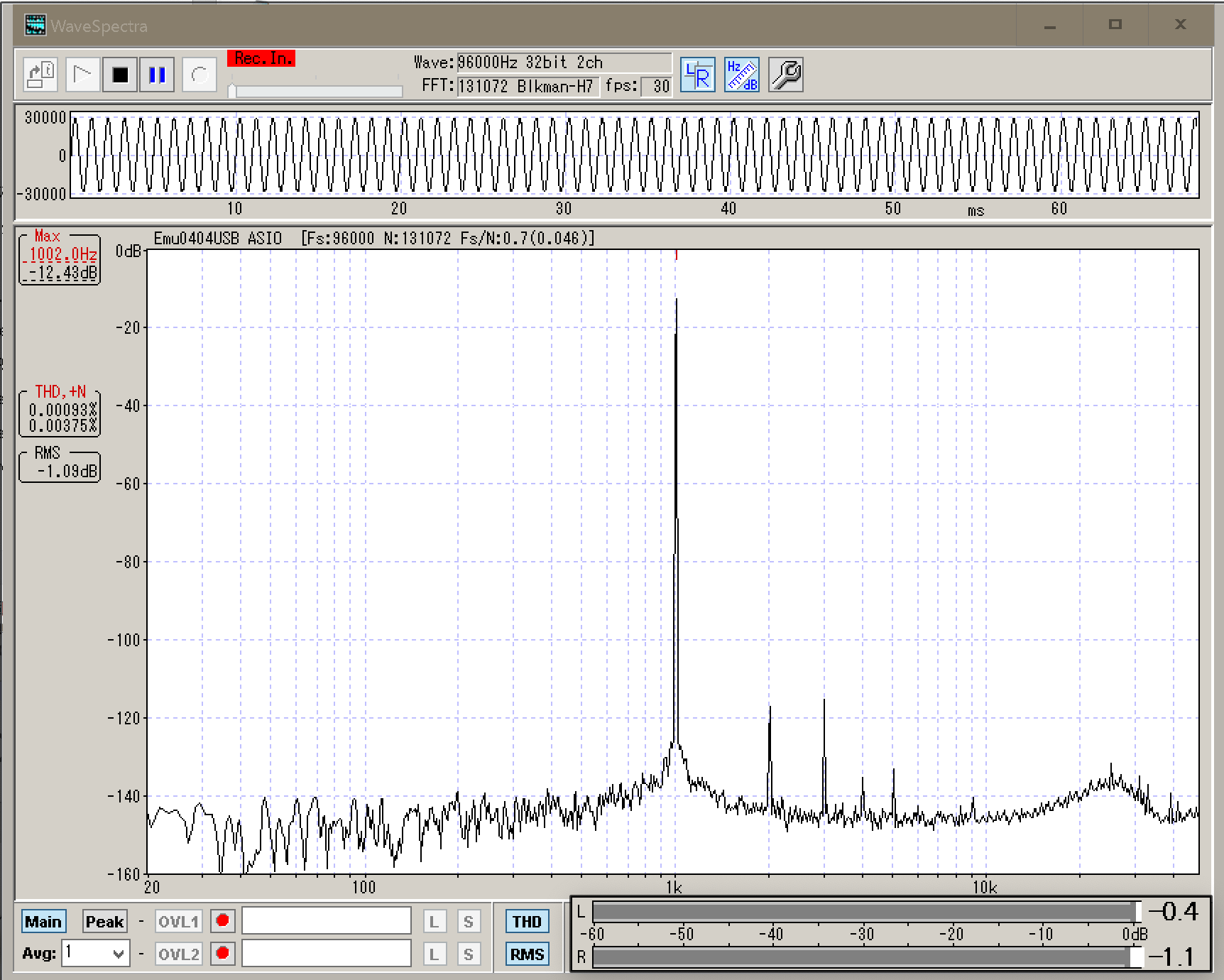

The FreeDSP OCTAVIA PCM1808 ADC runs at 48kHz, because it's a Deta-Sigma ADC behavior performance reason. But the DAC runs at 96kHz.

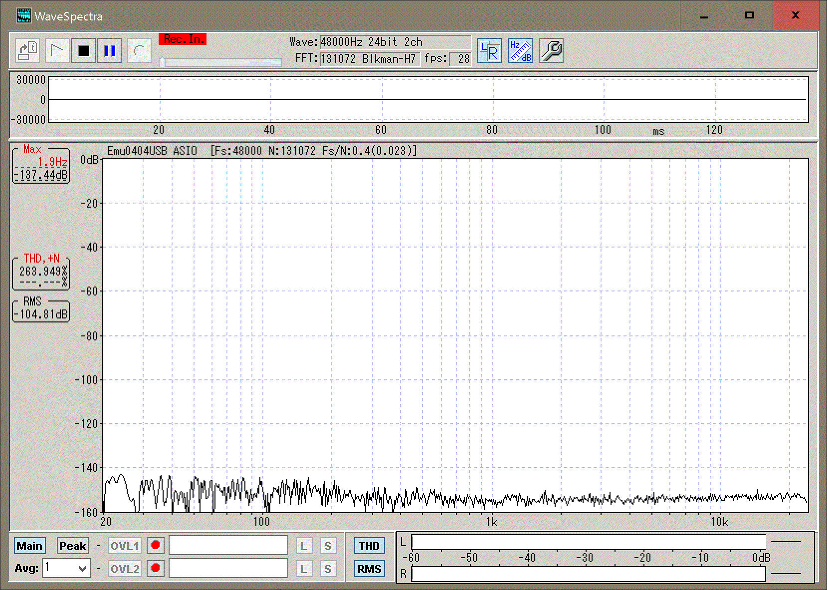

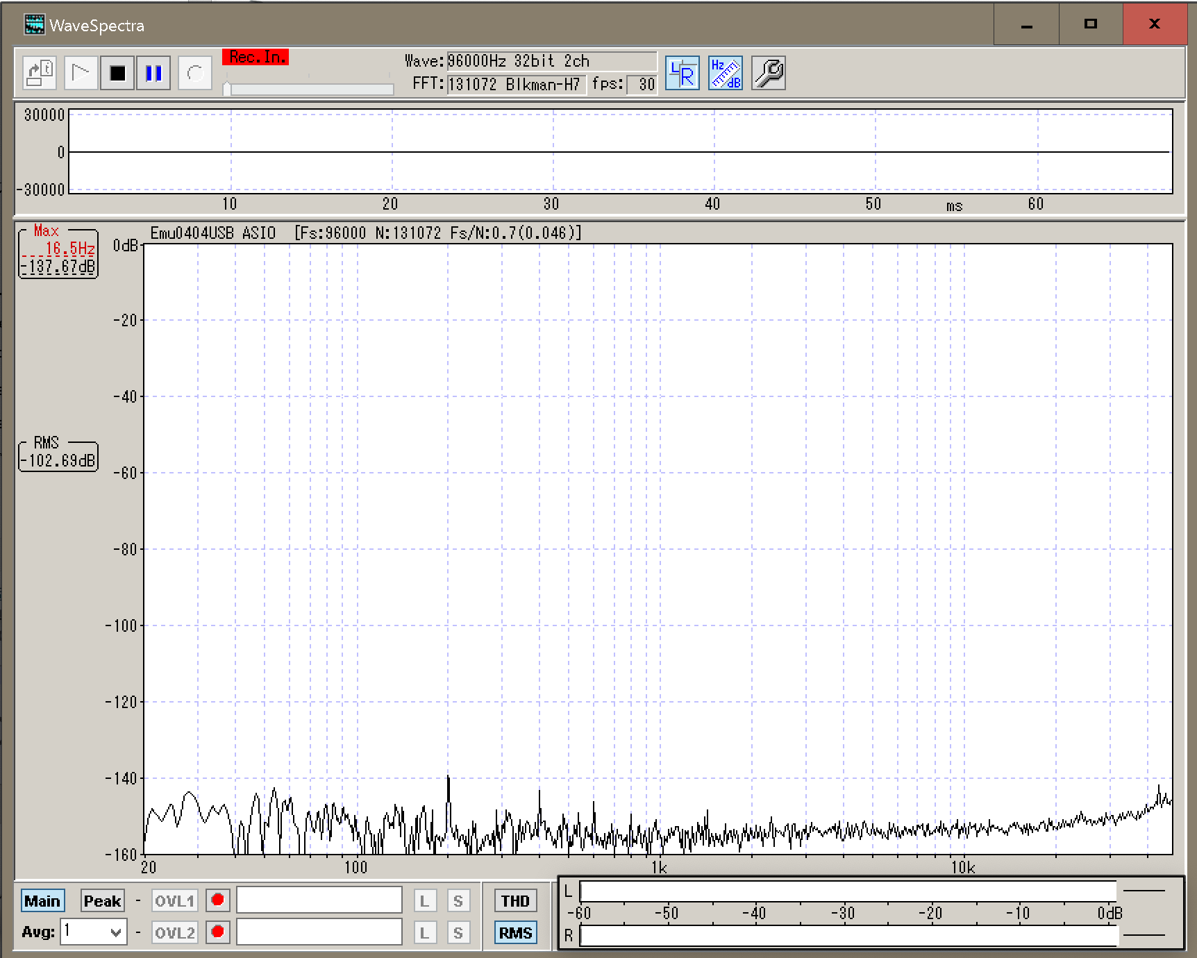

Before starting the measurement of ADC-DAC through performance, I checked the equipment's performance.
The signal source is Toppoing D10(96kHz). FFT Analyzer ADC is modified E-mu 0404USB(96kHz).
Measurement System
FREQUENCY RESPONSE
DISTORTION (0dB FS)

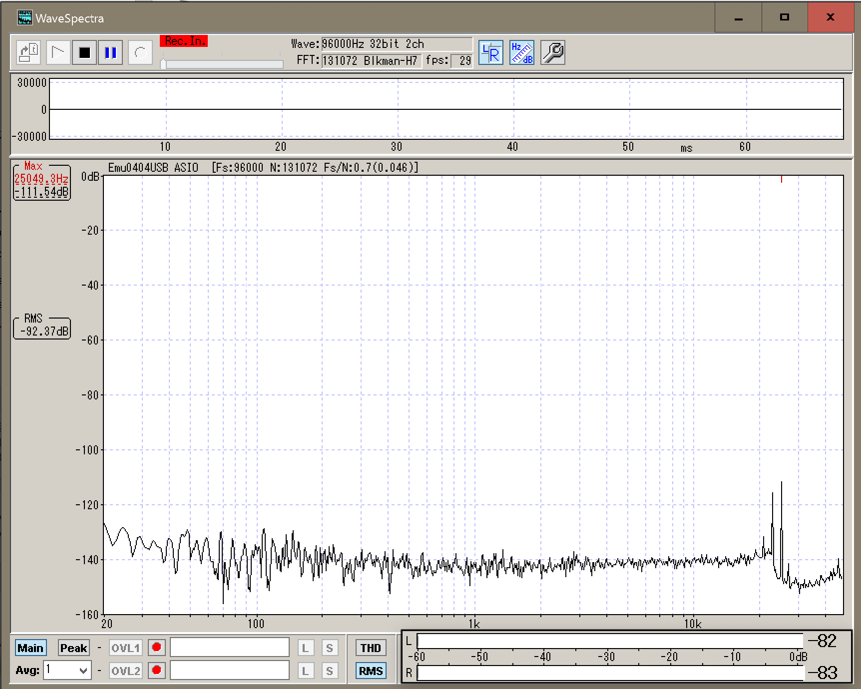

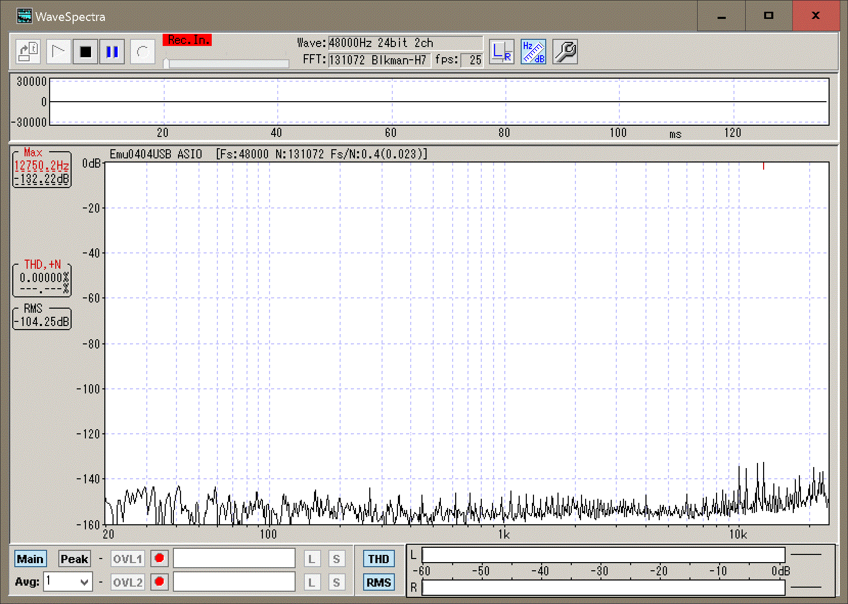

REMAIN NOISE

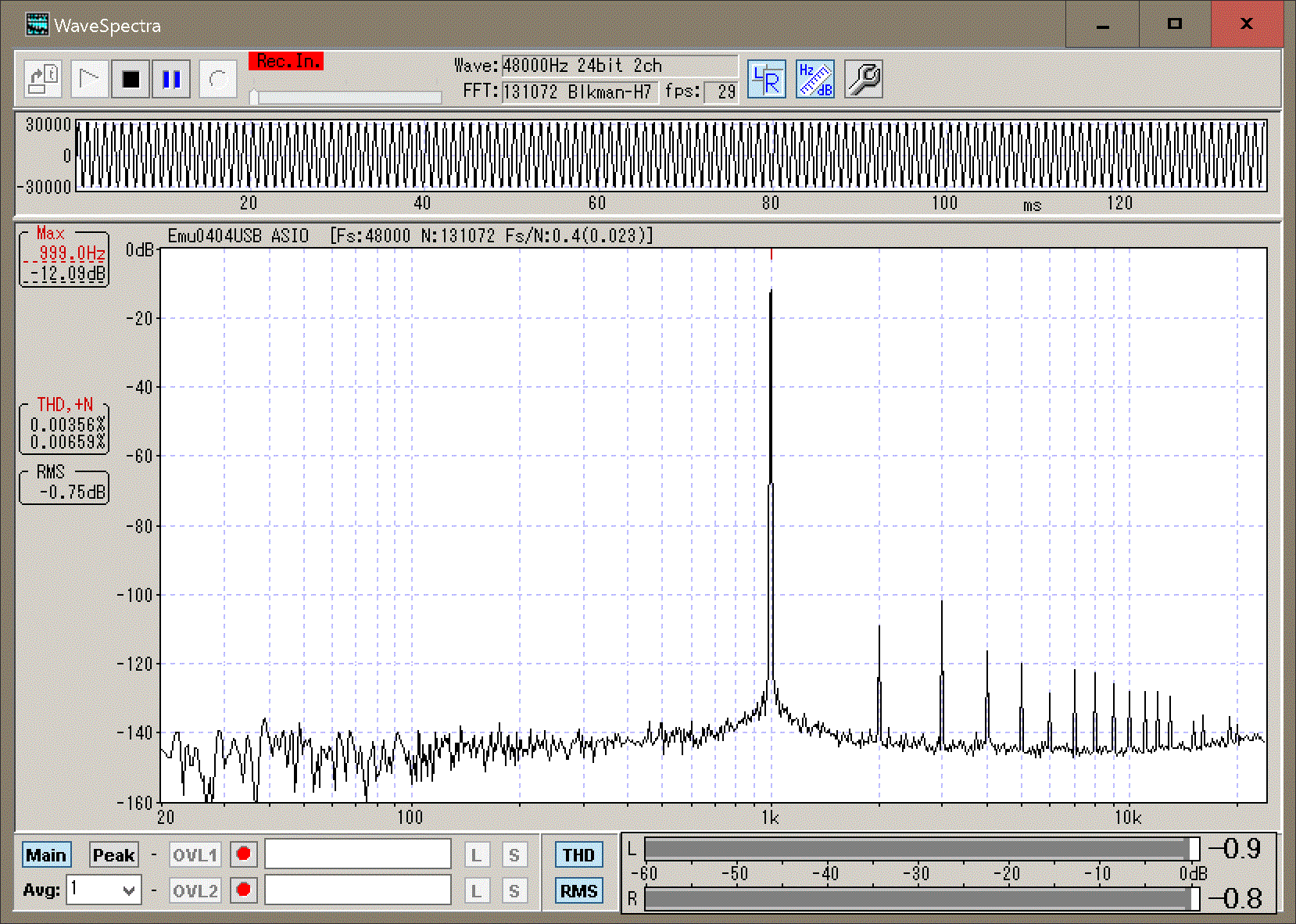

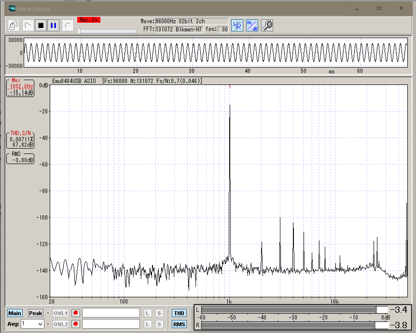

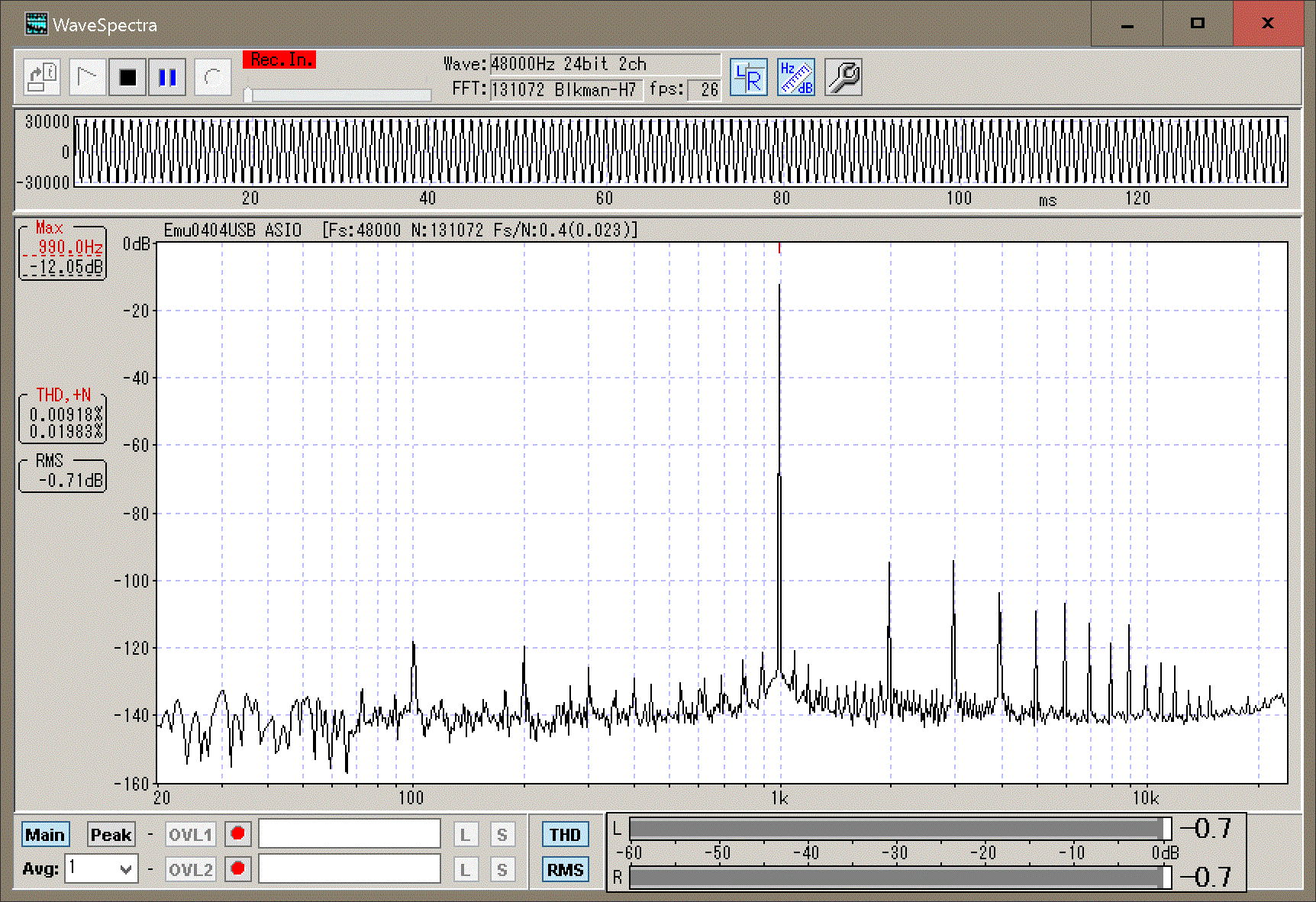

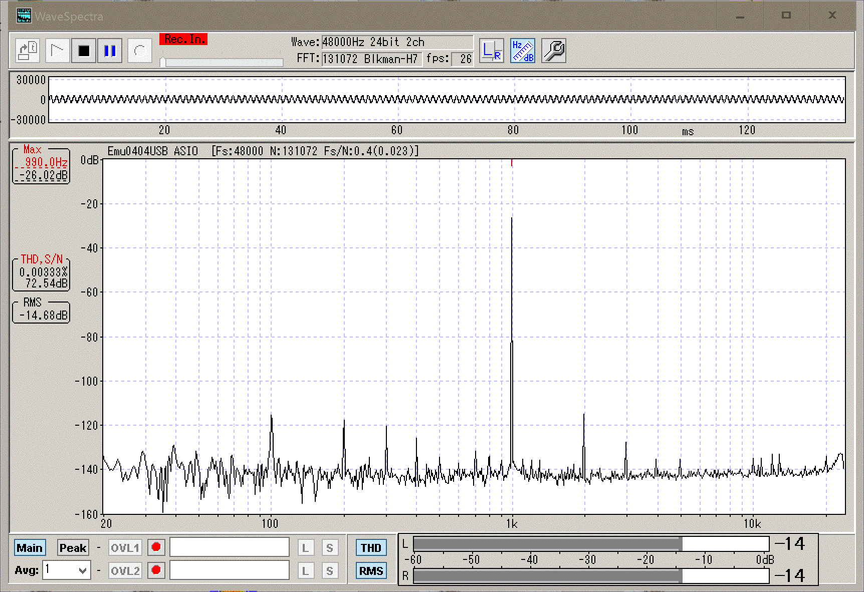

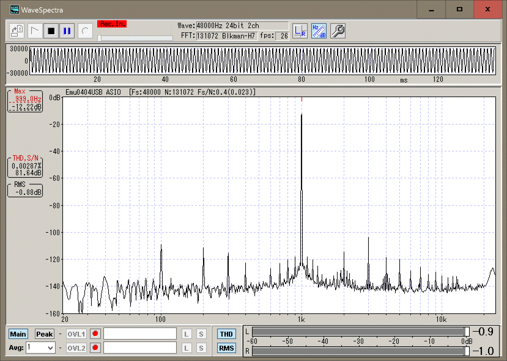

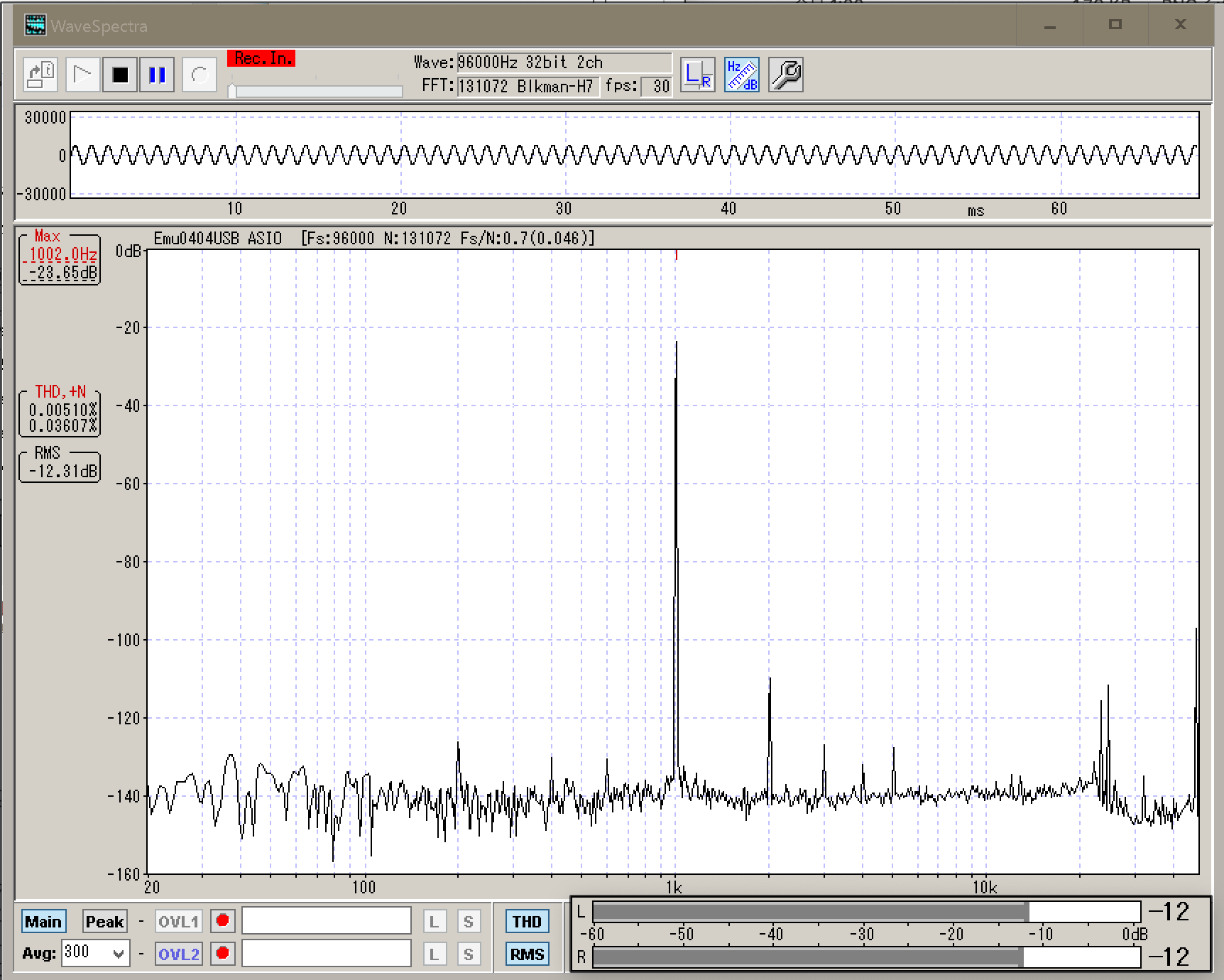

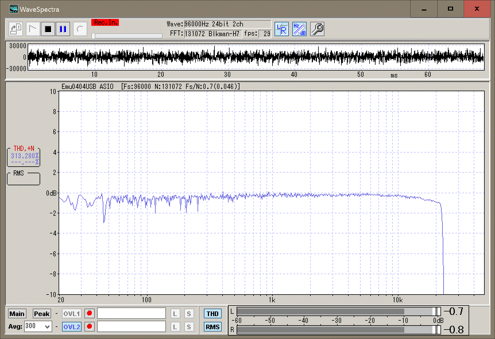

FreeDSP OCTAVIA ADC through DAC Overall
FREQUENCY RESPONSE
DISTORTION (-0.8dB FS, -3.8dB FS, -12dB FS)

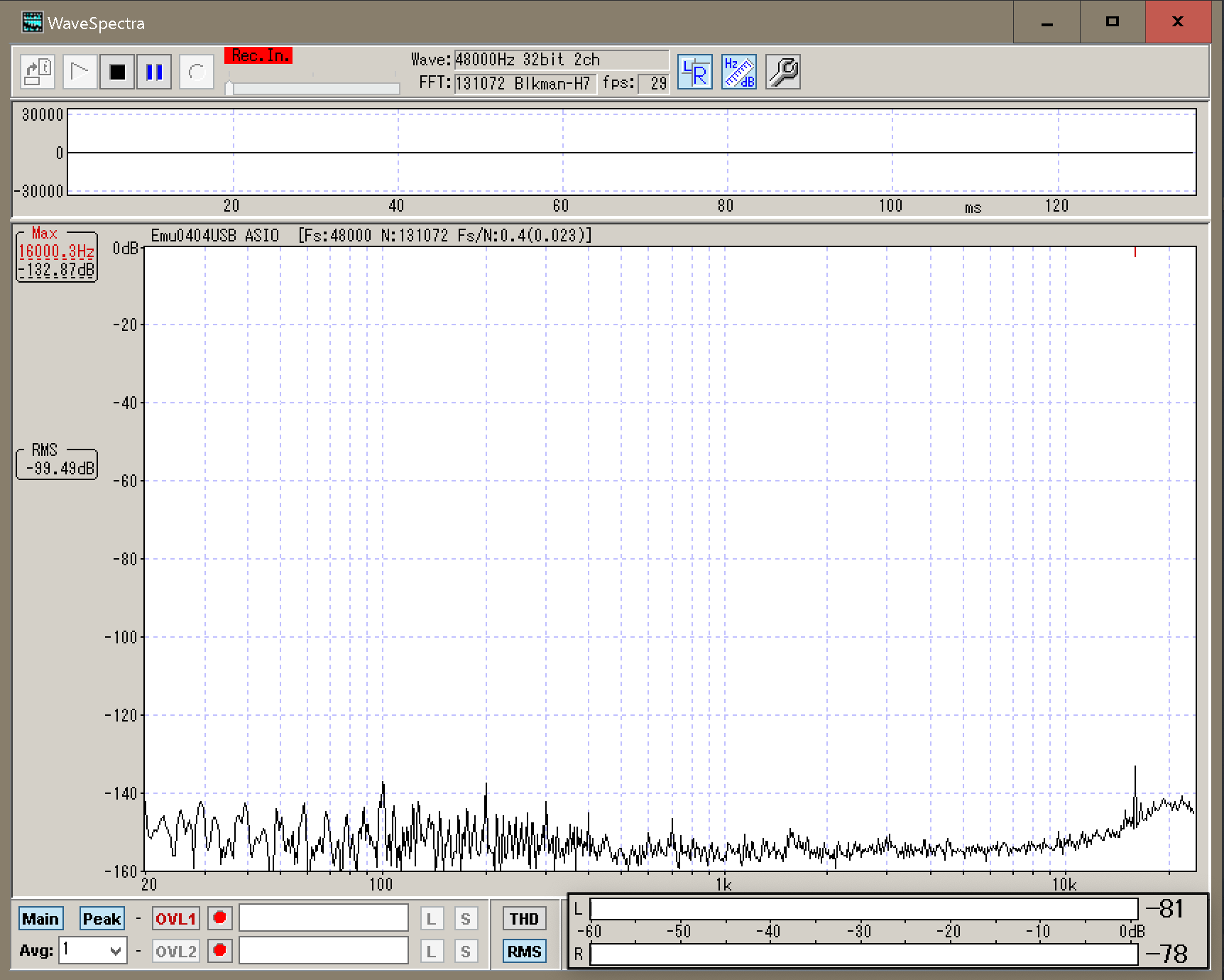

REMAIN NOISE
CyberPit
