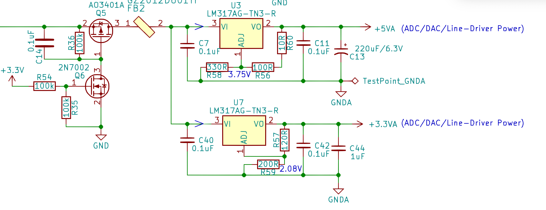

The difference between ver0.32 and 0.33 will Analog Series Regulator AMS1117 will change to LM317AG-TN3-R.
It will need to change the schematic design and parts layout, so I would like to update it after the evaluation.
The timeframe will be in September or later...
The change will be like this ...
PCB re-design will take some while. This change will just add a margin of heat dispassion.

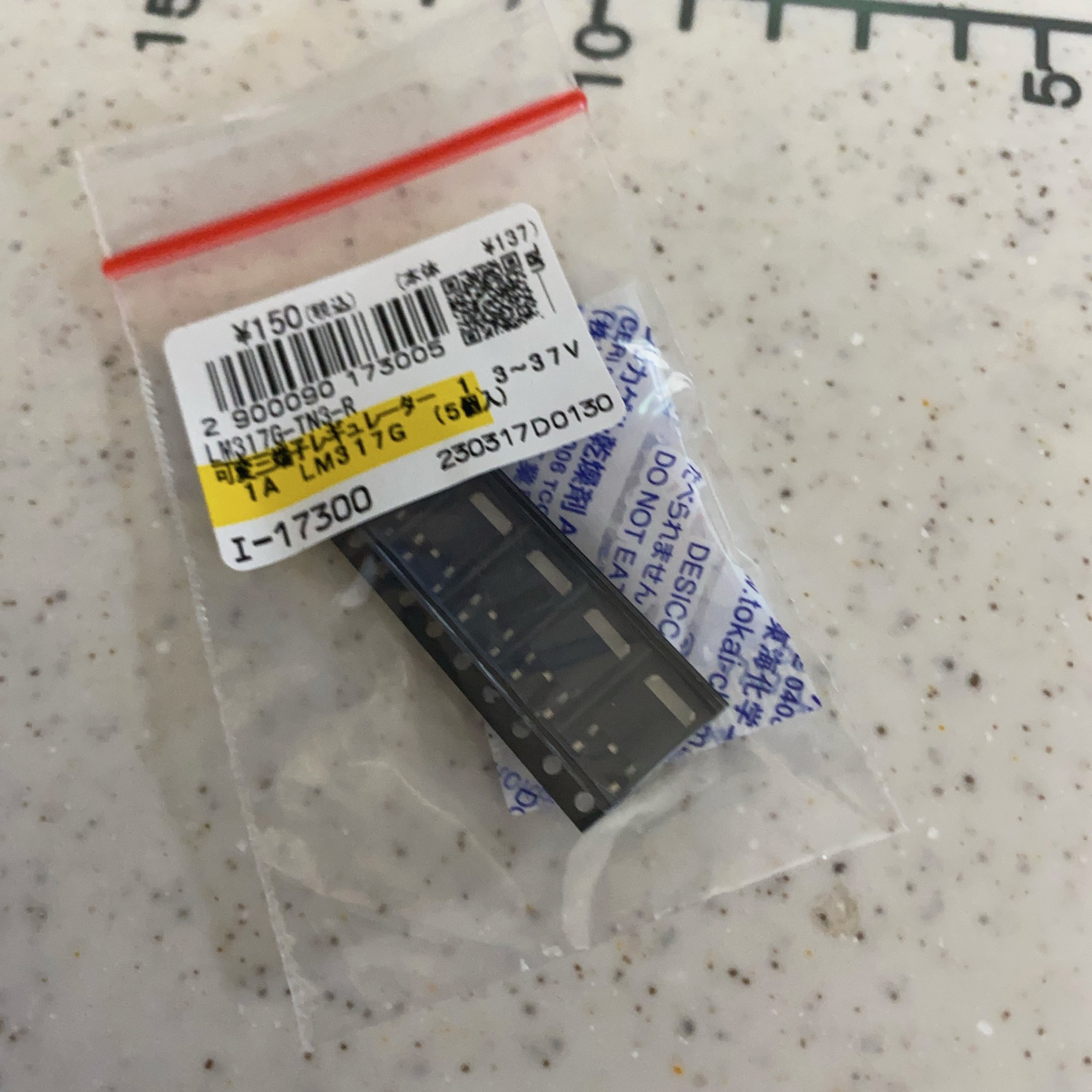

Today I went to Akihabara, where I could buy LM317G.

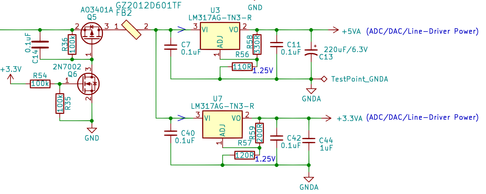

BTW, I evaluated LM317G circuit and I found a mistake in the upside-down value of the resistor divider. 😵
The attached circuit is a fixed PSU for version 0.33.
The resistor 110R was extended parts so I divided it into 100R and 10R.

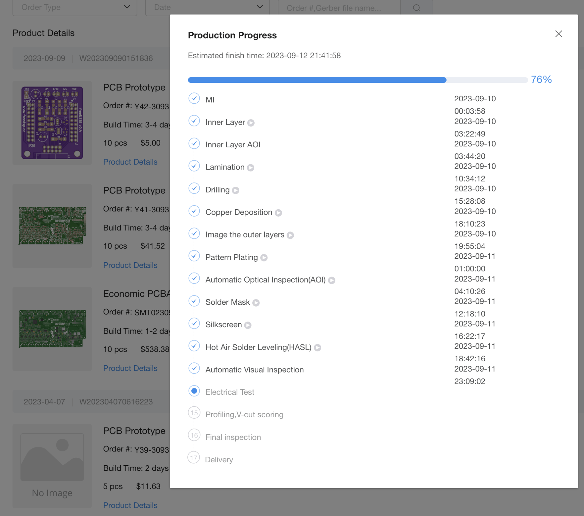

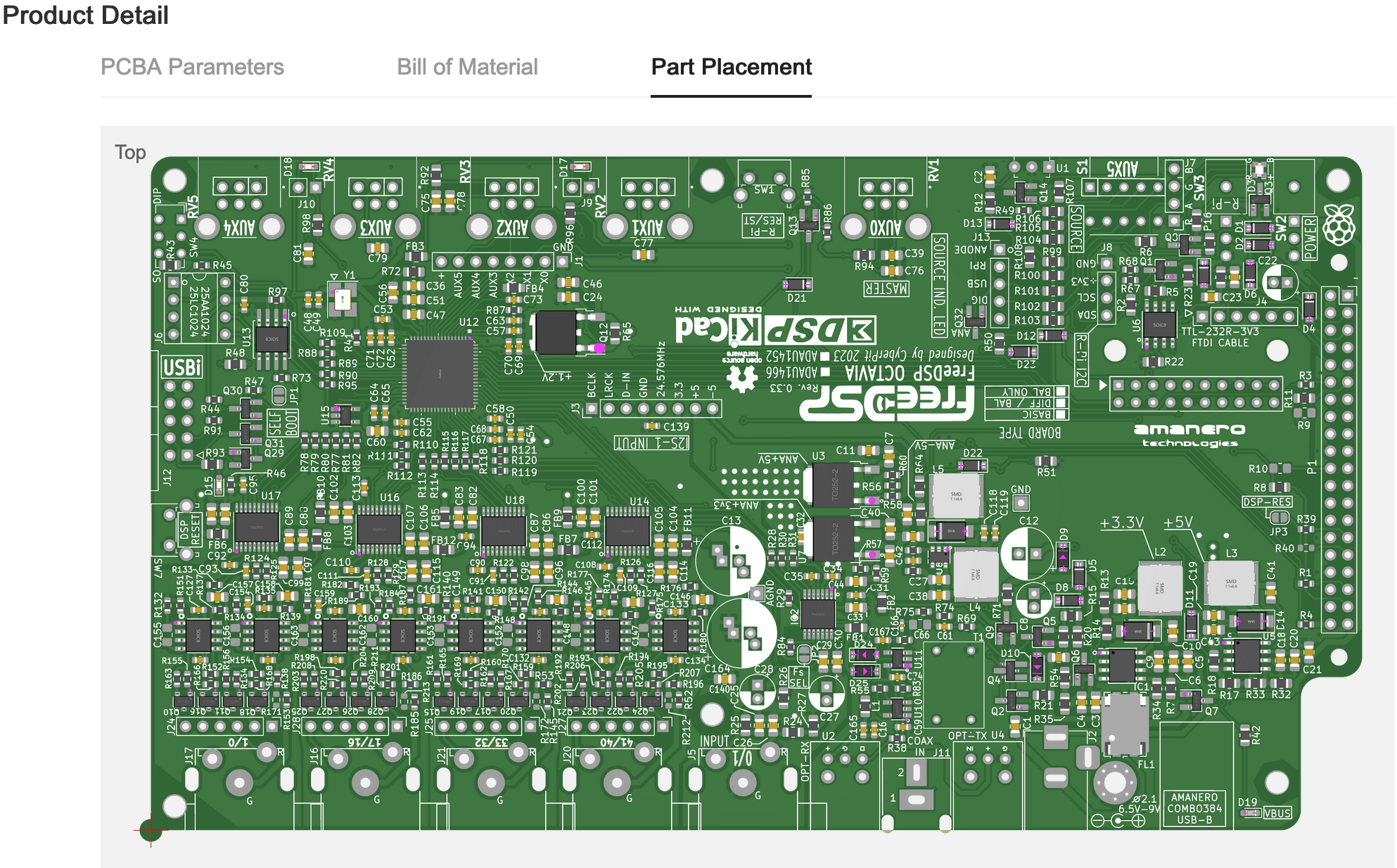

Perhaps I can post the ver0.33 design and order PCBA soon...
CyberPit
I uploaded the version 0.33 design files to GitHub.
The main change point is the series voltage regulator. (LM317)
Some trace patterns had changed.
I will look for volunteers to join the evaluation. Among the local committee members.
So this design will be built and evaluated soon.

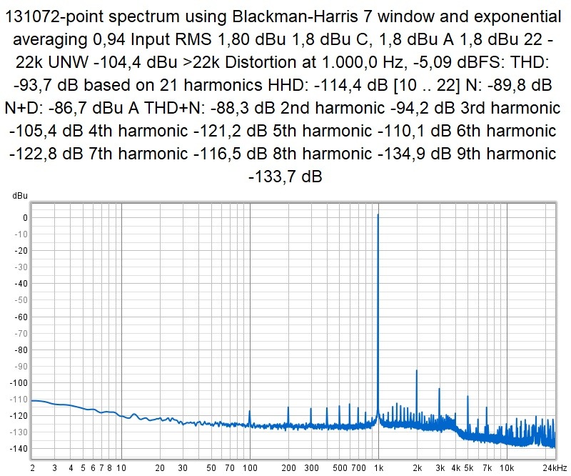

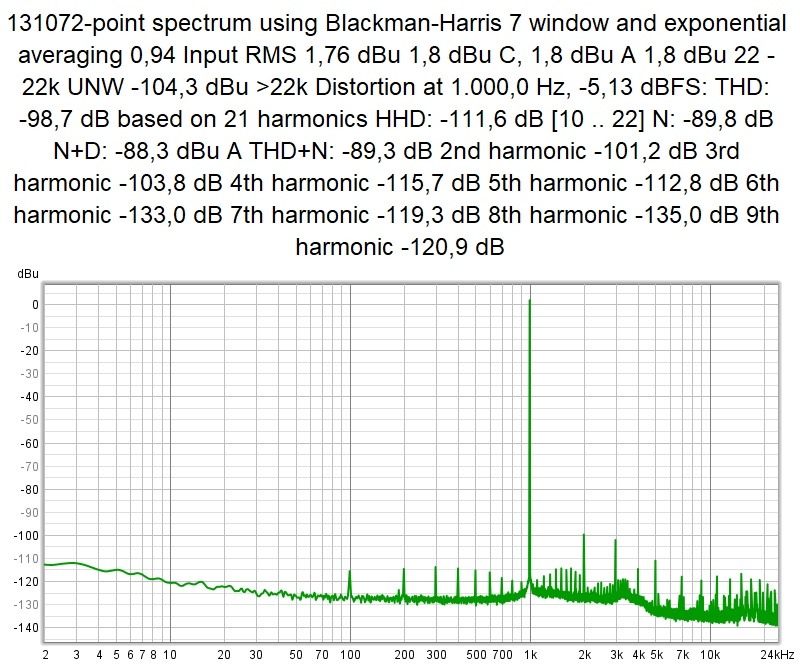

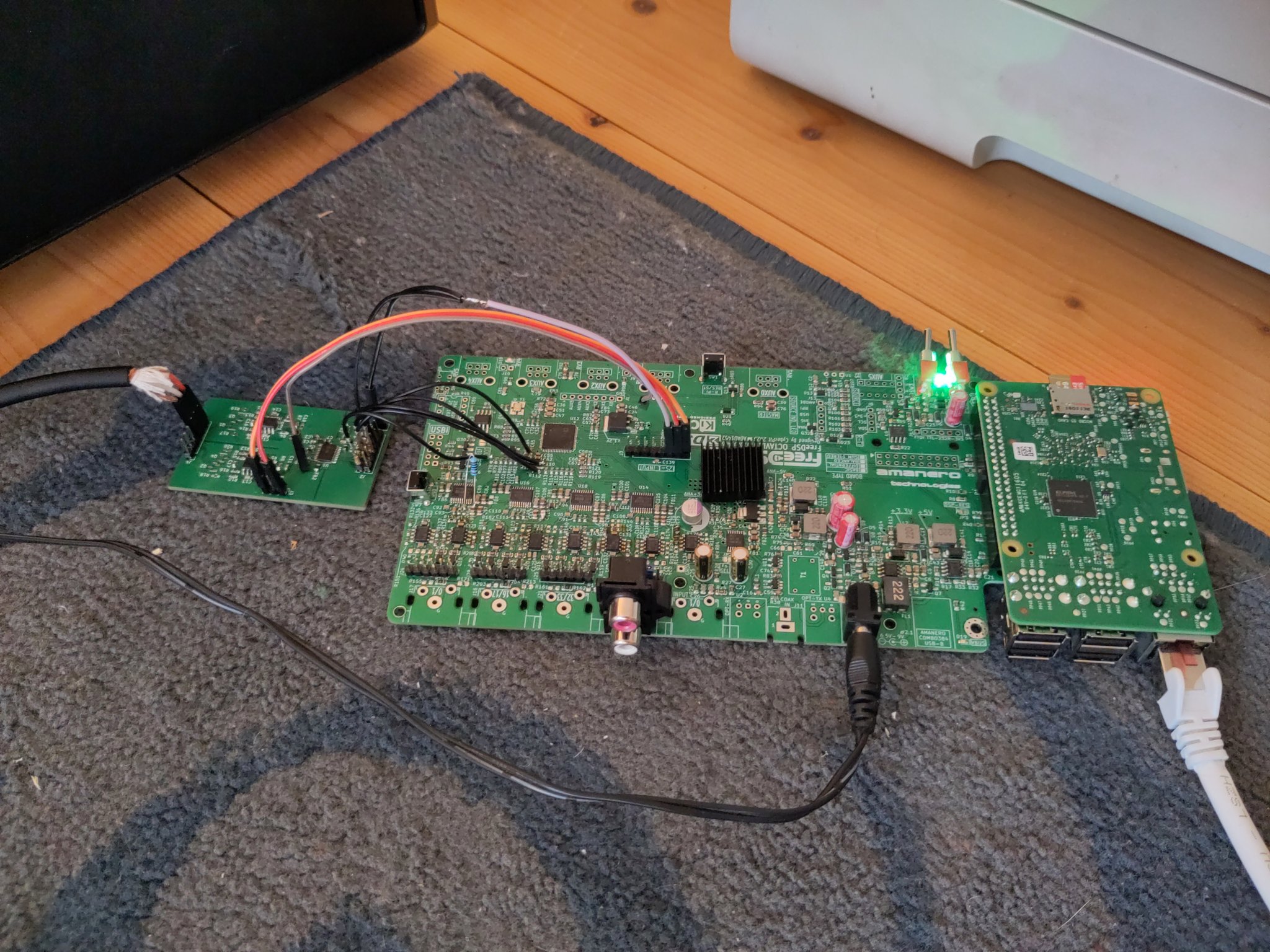

Hi everyone,
the first measurement with the test-board is in.
THD is definitly better, but my noise floor is a bit worse. This, however, is very likely due to the setup with flying cables...
So THD-N is similiar to before and THD is better. Maybe I can improve my setup a bit to get a better noise floor.
With THD of -98.7 we are probably at the spec of the DAC. I guess this will not get much better.
I'll keep you udpated if manage to get some more results.
BR Ludwig
