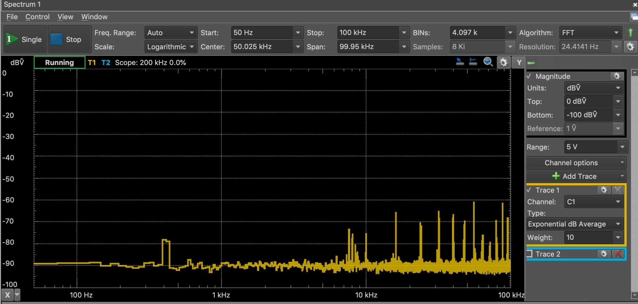

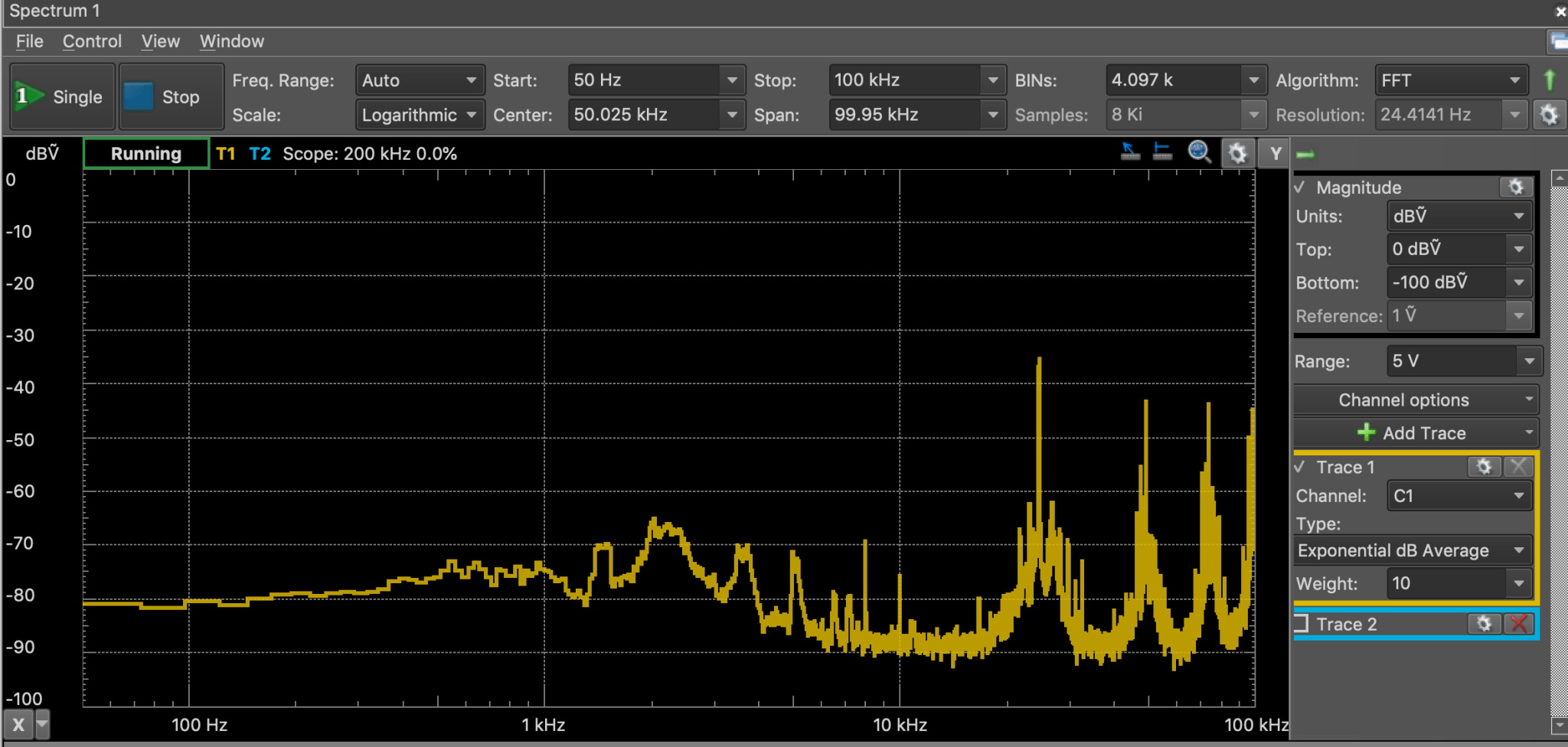

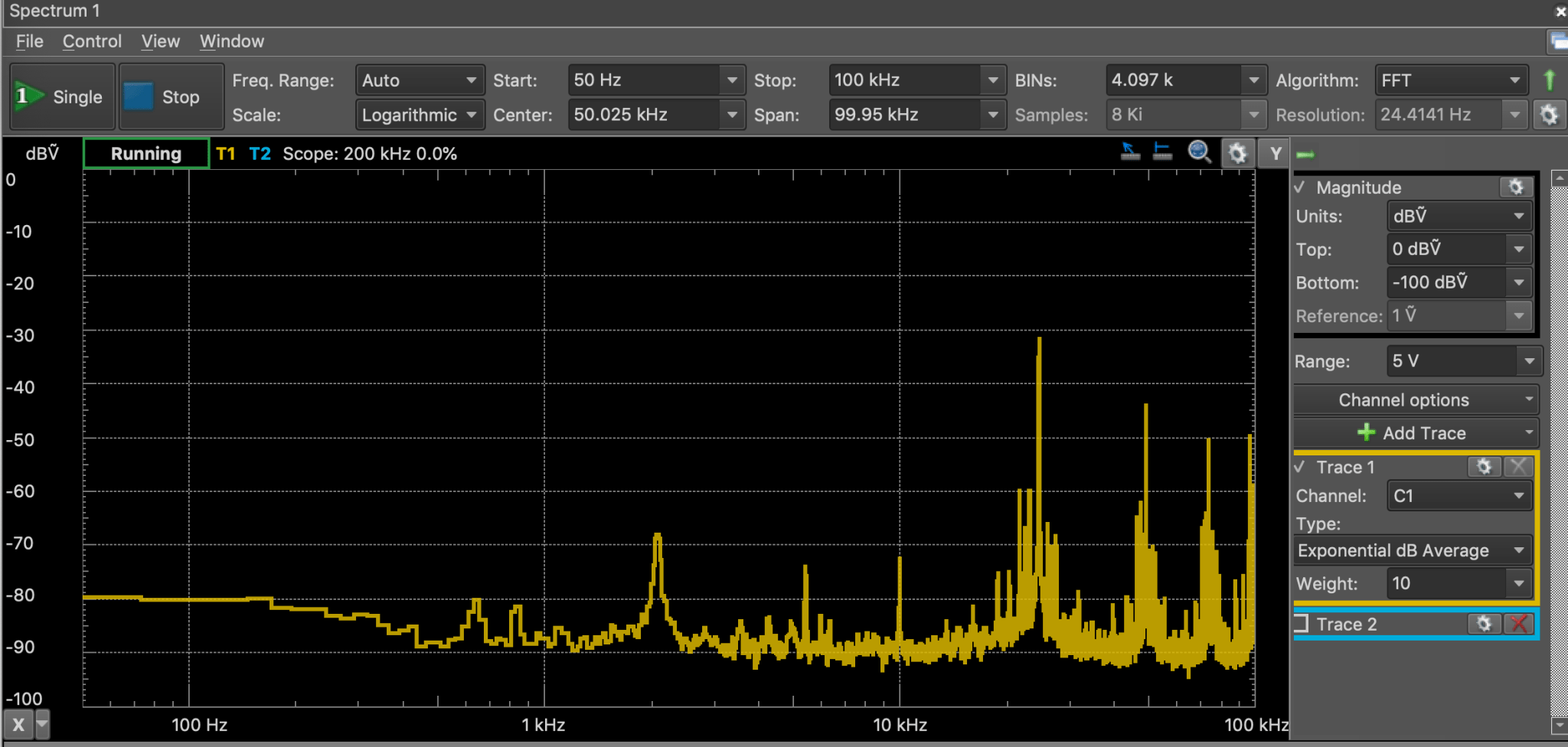

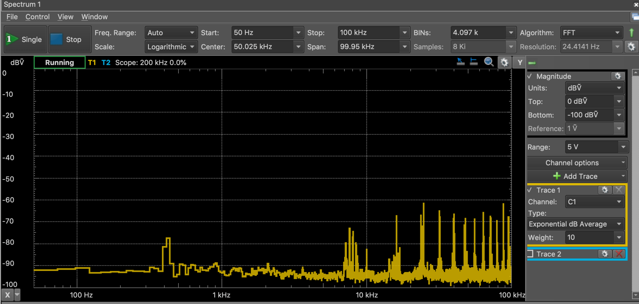

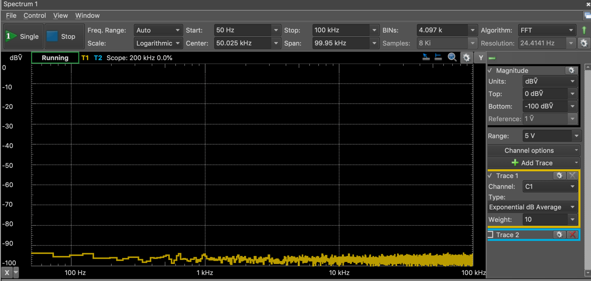

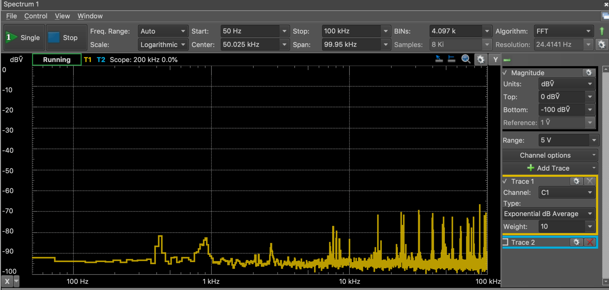

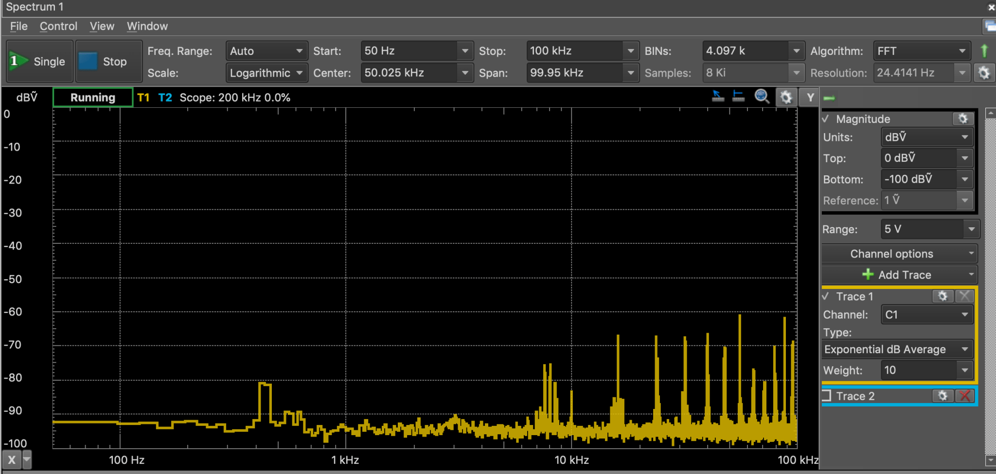

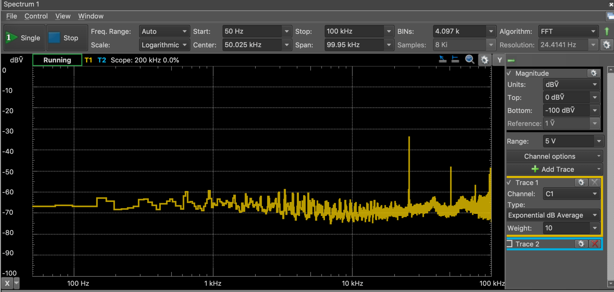

Before deciding on modification, we needed to know how it noisy.
Then we can consider it necessary or not...
I used AC-coupled Analog DIscovery2 which has this level of noise floor.
The 7.5V wall supply was noisy like this...
So I changed Power Supply to TTi EL303R
But I could not see the difference between them on board power rail outputs
For starters on the Digital +3.3V Power Rail.
Following all measured reference points were GNDA besides C13.
+5V Rail for RPI
Analog +3.3V Power Rail
Analog -5V Power Rail
Analog +5V (LM317) Power Rail
I attached 10uF on R58 but I could not see the differences.

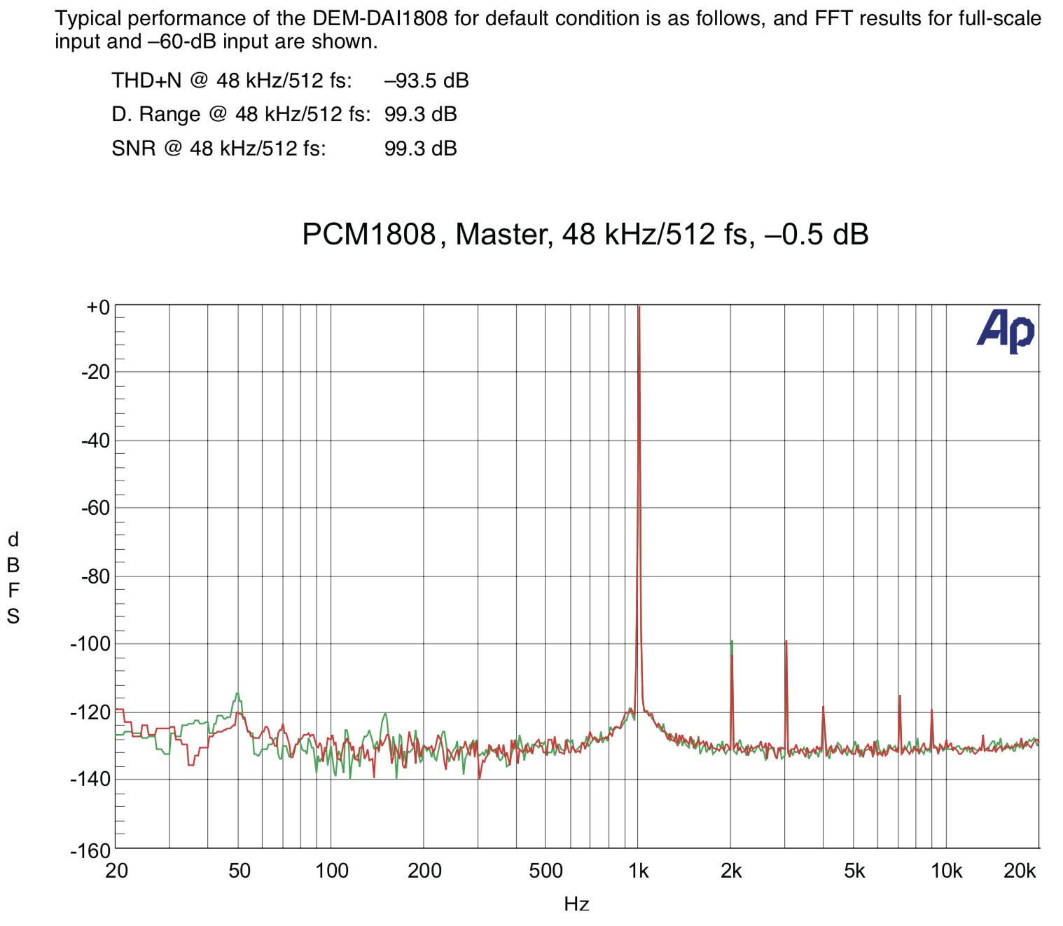

Hello again DSP_Geek-San,
Well, I checked TI's Evaluation Board Manual. I found a PCM1808's performance information.
(Sorry, my previous post was mistyped PCM1808 as PCM1801)
TI GENUINE EVALUATION BOARD (Measurement: Audio Precision)
And here is
FreeDSP OCTAVIA PCM1808 to S/PDIF (Measurement: D10 and 0404USB)
Especially, the low-end side spectrum will be increased if the current noise exists. But I can not see them.
I know CMF55 has good quality and performance. It will fit for Hi-End product design.
This board uses a 100ppm thin-film (=metal) type 0805 resistor of 27k ohms. As a result of this, you can see no issues at this point.
BTW TI's data shows some jitter and current noise possibility...

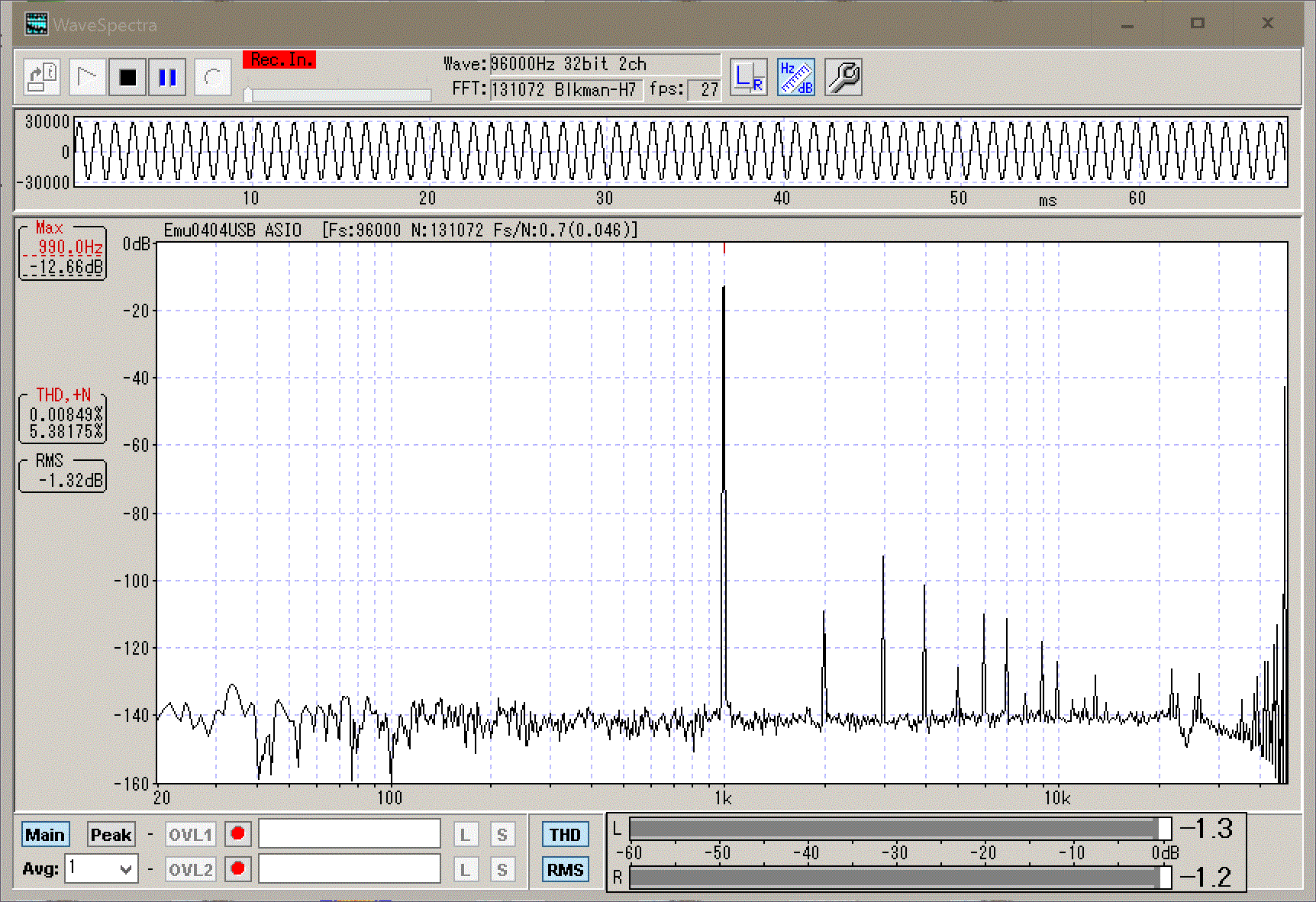

And here is

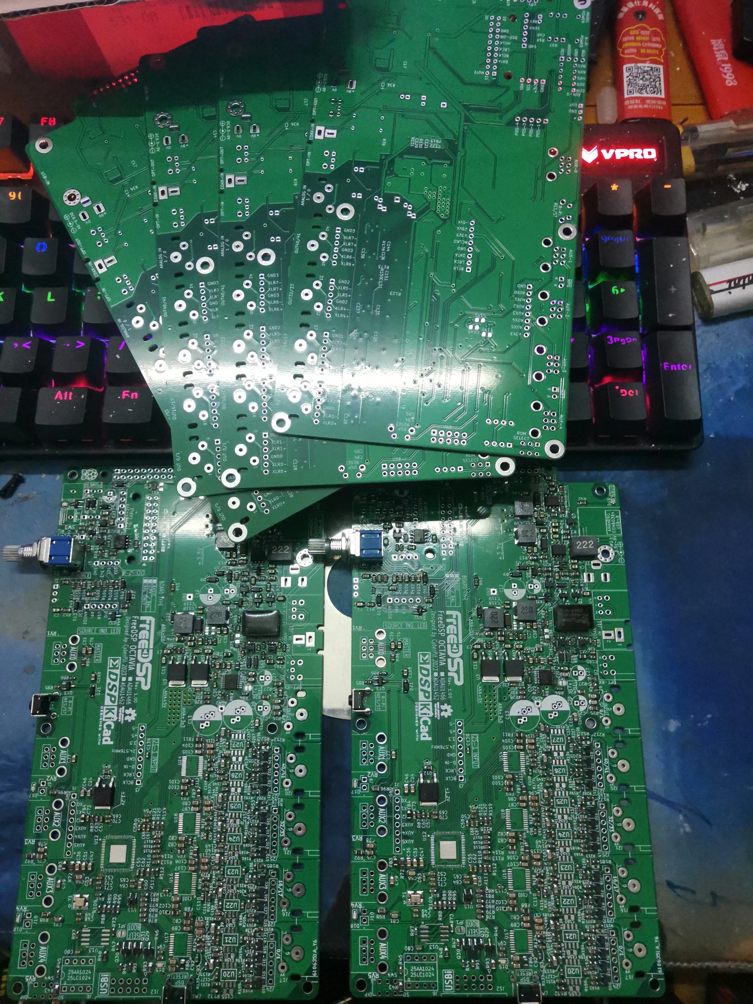

Joined 2018
TRANSLATION: Mine is almost ready, but to save money, I hand-soldered it myself.我的也快做好了,为了省钱,我自己手工焊接了。
English please

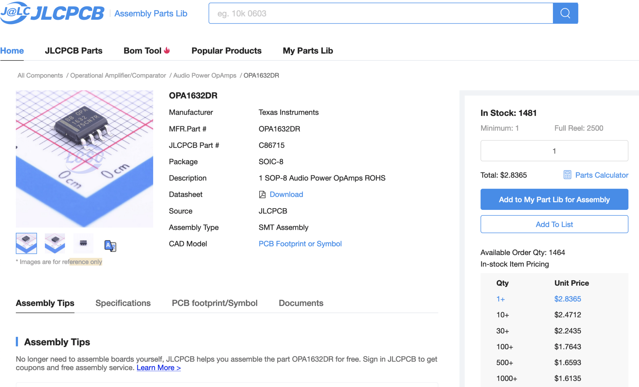

Out of curiousity, I cloned the repo and tried the order process at JLPCB. After I gave it the BOM and CPL files, I got this warning message:
Is this because those are the through hole components that I would solder myself? Or is there a problem with I uploaded the project to JLPCB?
FYI, the quote for quantity 5 seems to be $350 before shipping, so about $75/each? Does that sound right? Then there's also the additional through hole components.

Hello, sychan-San,
Your listed parts are NOP (Not Populated).
So, you can ignore this error message and continue your order operation.
(The next step will rotate parts...)
Of course, you need some additional TH parts and cards(if you need them).
CyberPit
My previous order was $378.83 (w/o shipping cost) At that time, the parts price was raised, which was the cause of the market shortage.FYI, the quote for quantity 5 seems to be $350 before shipping, so about $75/each? Does that sound right?
