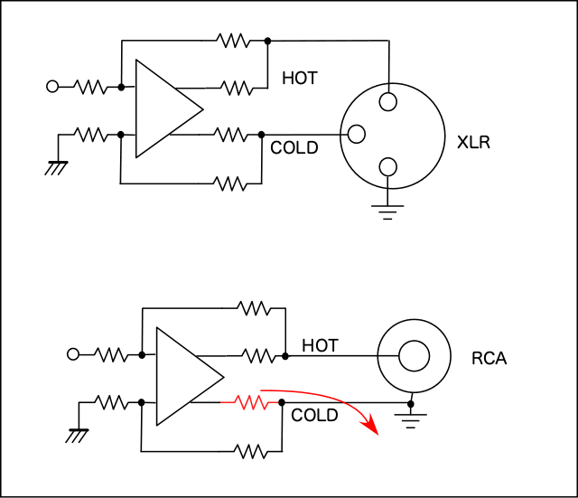

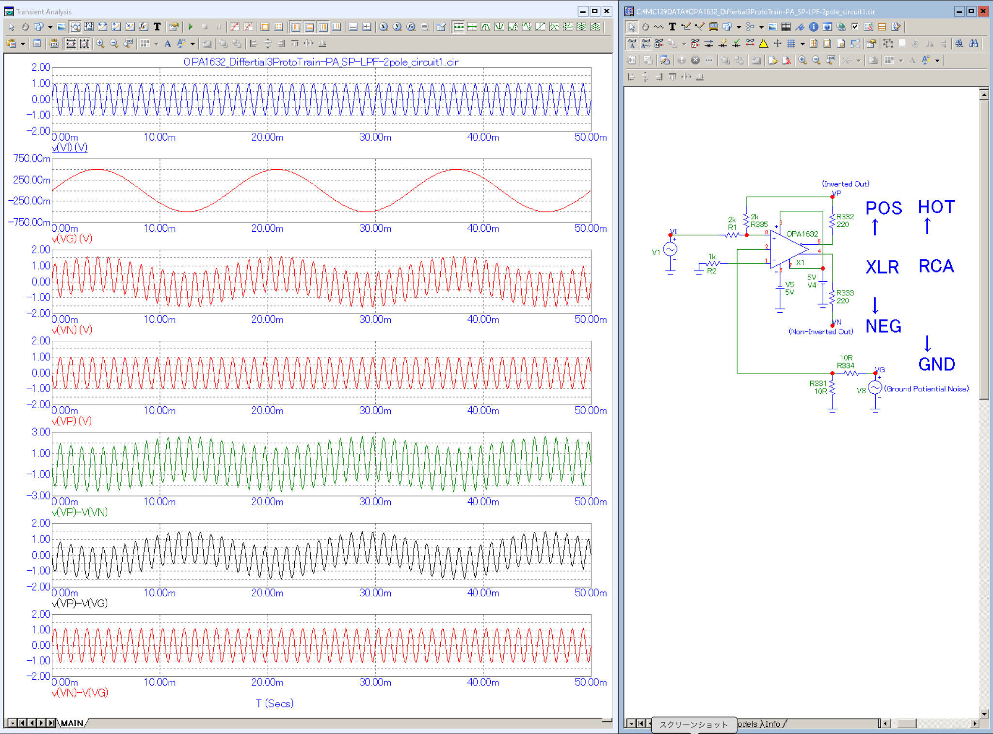

An unbalanced connection will connect the cold side terminal to GND. This connection has no problem.
On another hand, the Solidsate output circuit should connect like this...
The cold side output signal will be fed to GND through a low-impedance resistor. (shown in RED color)
This type of connection consumes so much power for termination. Now I'm thinking this does not make sense.

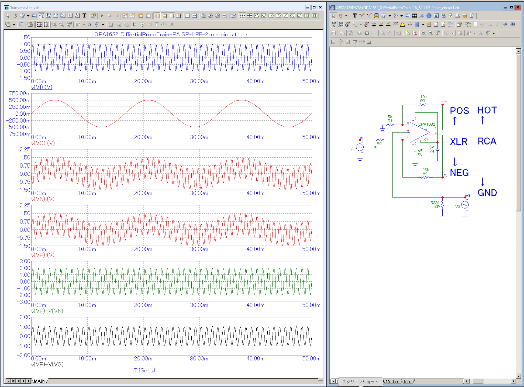

So I devised the following circuit for the differential output driver.
The simulated result shows the signal will be reproduced even if the target equipment's GND level has a differential potential voltage VG.
(This voltage VG should be inside of power rails)
Now I'm starting to design a new output driver circuit with this idea...

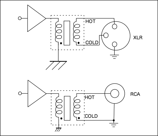

Ordinary transformer output can connect this way...I am not so familiar with the term "cold-side termination". Can you eloberate this?

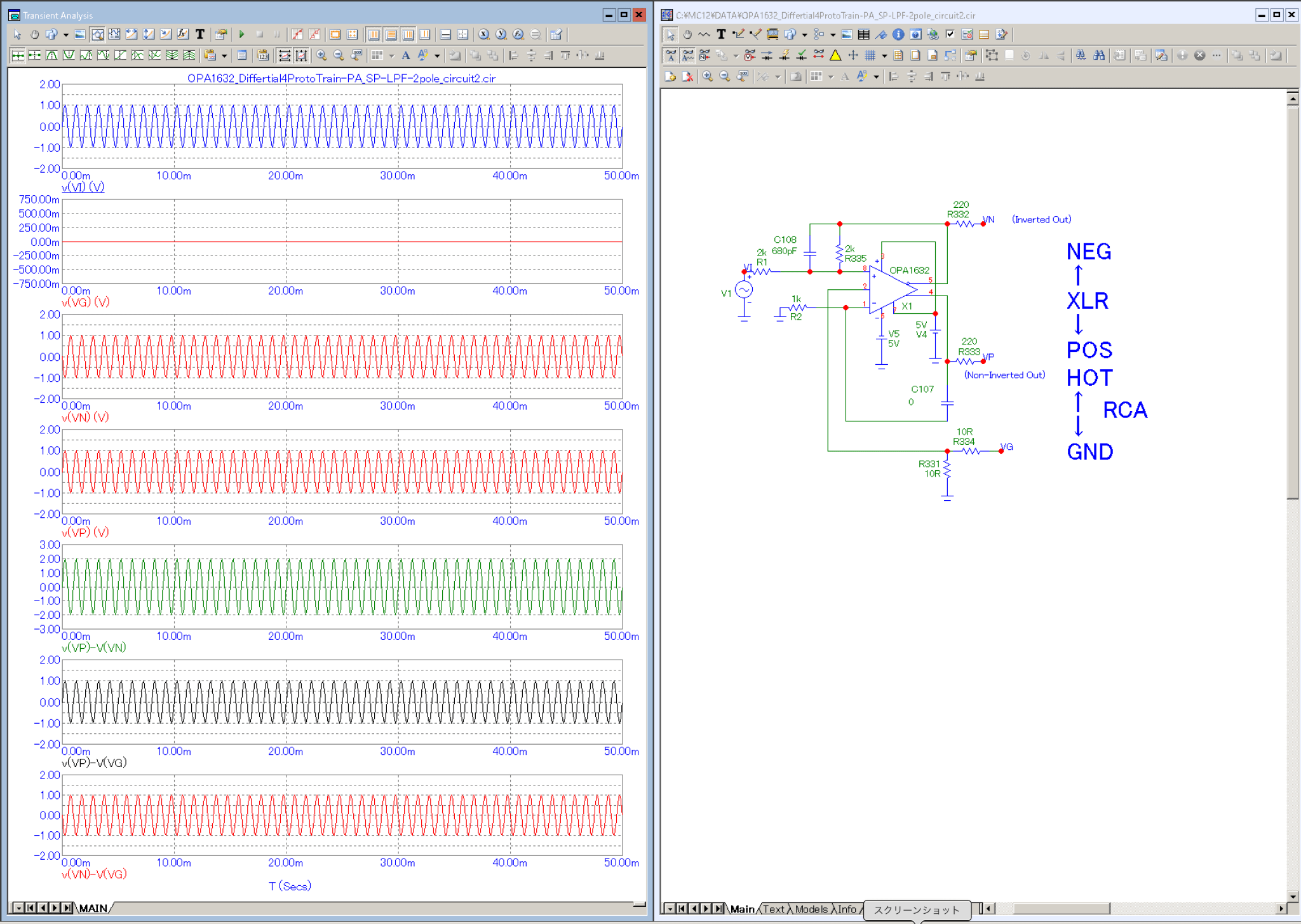

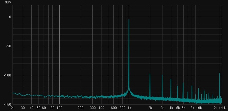

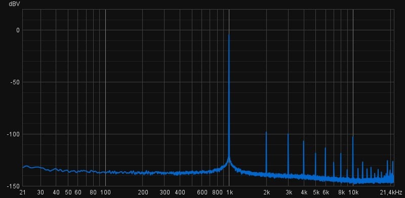

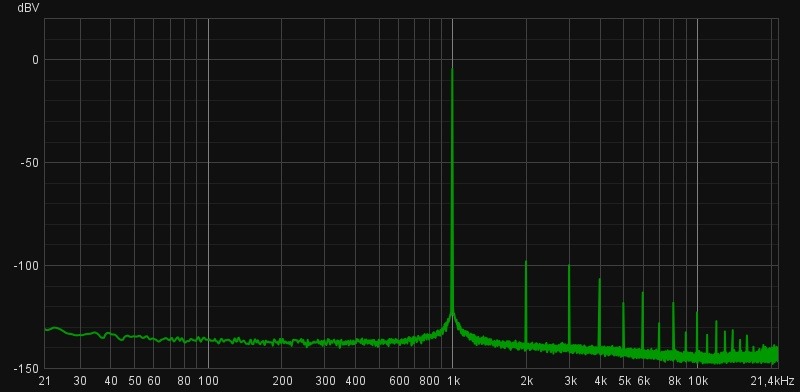

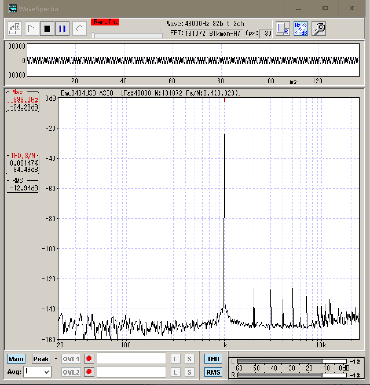

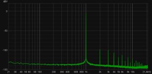

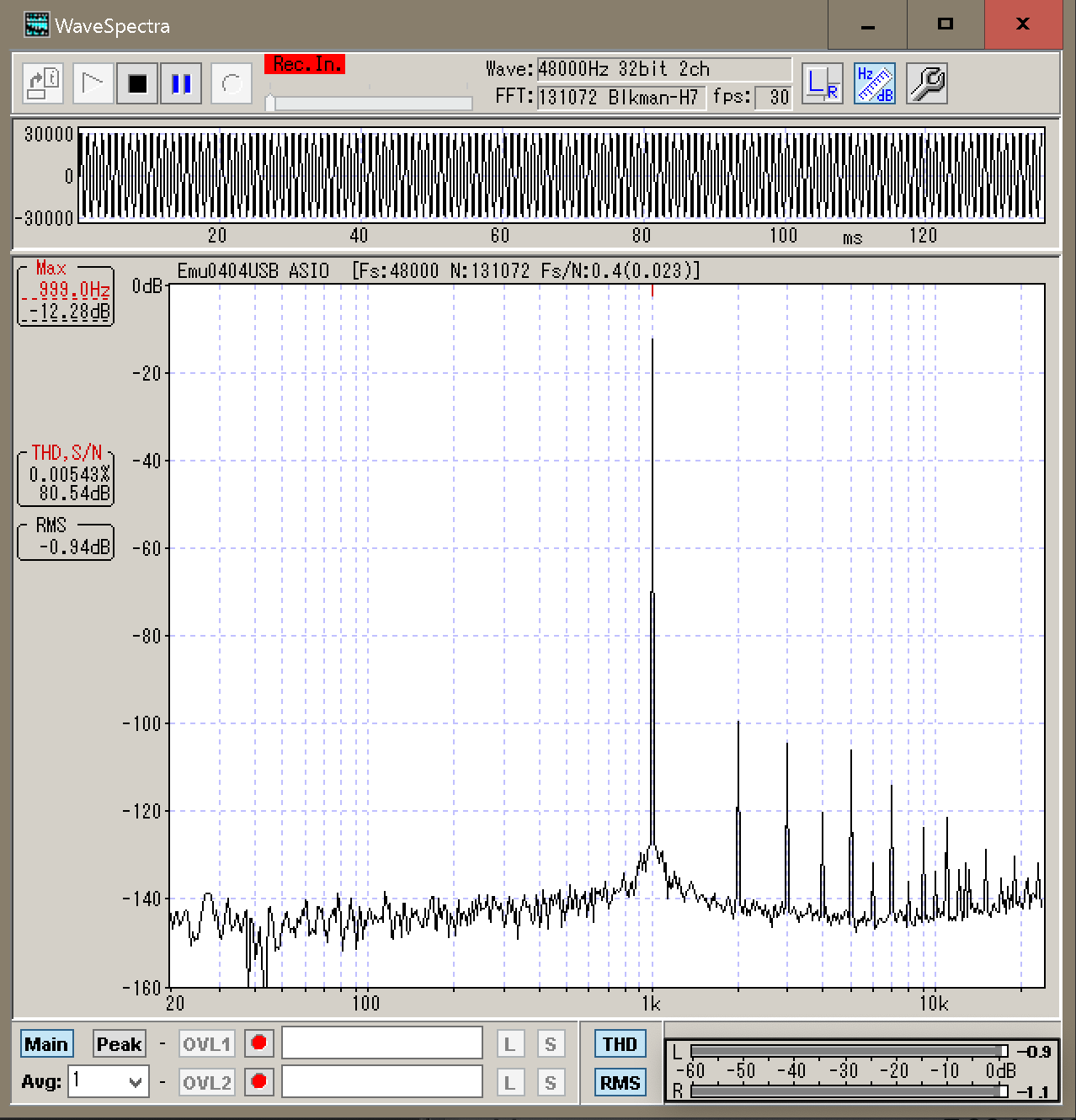

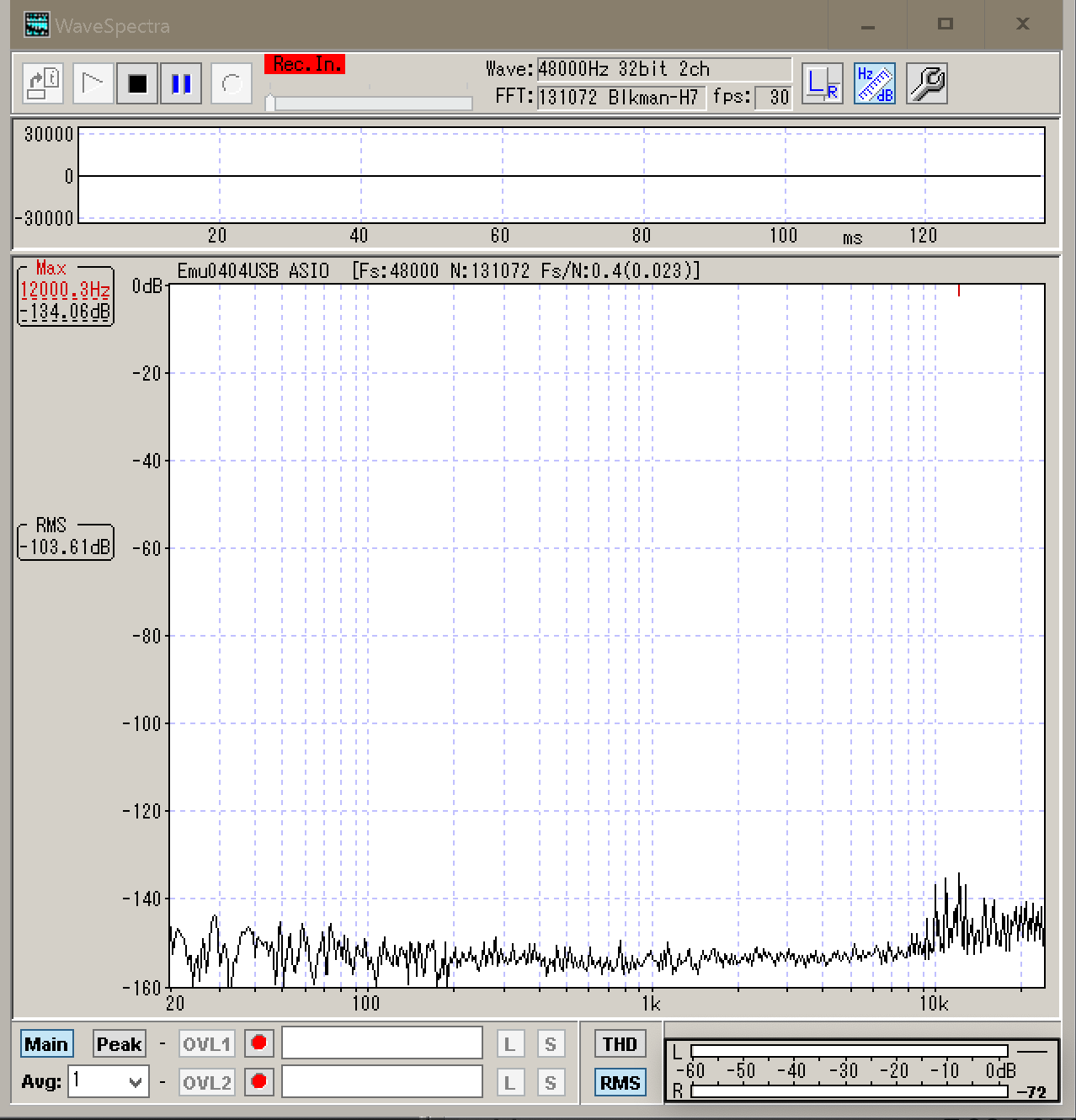

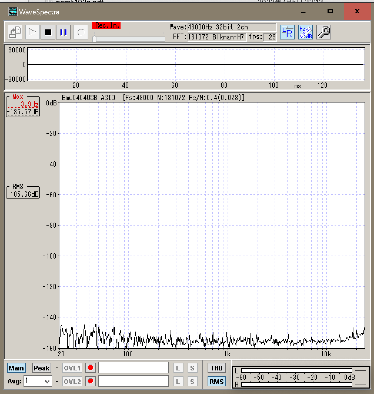

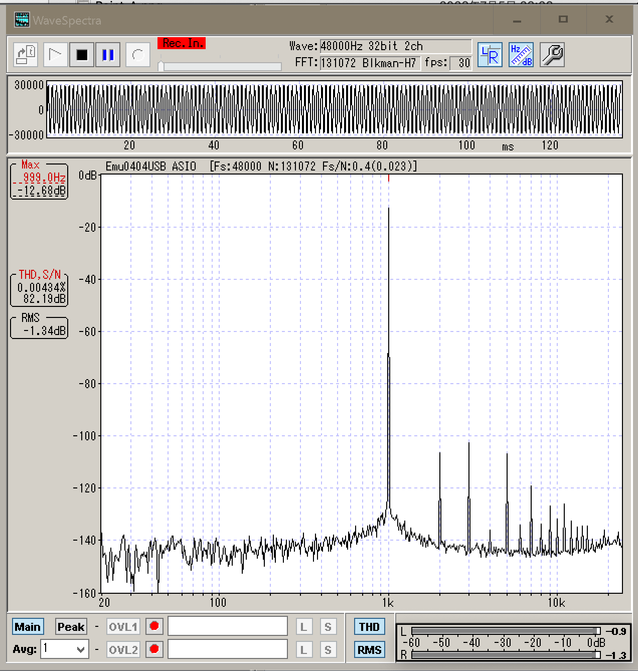

A piece of good news comes after trial work...
I evaluated the previously posted differential driver circuit. It was not stable and noisy when connected to the ground potential sens line.
So I gave up sticking to the perfect differential behavior design. The compromised design as below works fine with differential RCA output or XLR Balanced output (Not at a time, you need to use only one connection method)
Non-Inverted output(RCA pin output) only works as differential output, but it's enough for actual use cases. If you connect only XLR, this circuit will work as a typical balanced output design. No need to operate the switch or change components, you just unplug the connector and then connect another type of connector.
Here's evaluated performance information
Remain Noise
Full-Bit Output Distortion
Best THD performance@-12dB FS
I hope someone evaluates this circuit more if possible.
Remain Noise
I would like to start improving the schematic design.

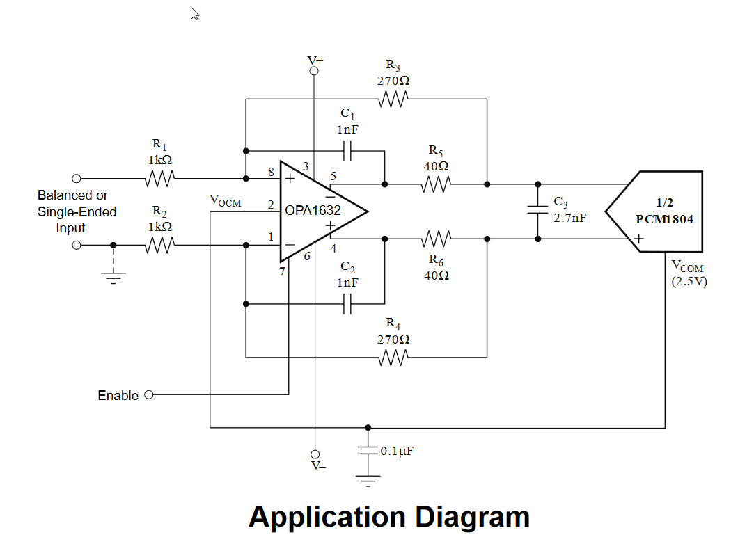

Hi CyberPit-San,
thanks for the explaination. I get your point now.
Maybe one thought regarding the stability issue on your initial redesign.
When I started creating the simulation I was also thinking about moving the low pass filter at the output of the dac into the opamp design. This should also improve stability. The only downside would be that this would not affect the non differential output, but here we could leave the pads for the current filter.
Basically like this example from the datasheet :

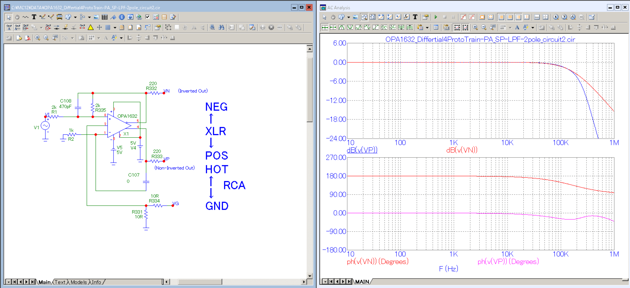

SubSoniks-San, Ludwig-San,
Thanks for giving comments.
The True transformer-simulated design keeps the same output voltage in Balanced and Unbalanced connections.
But I wonder, it is not a big matter. Just decreasing the volume by -6dB in the balanced connection case. This is not a difficult thing.

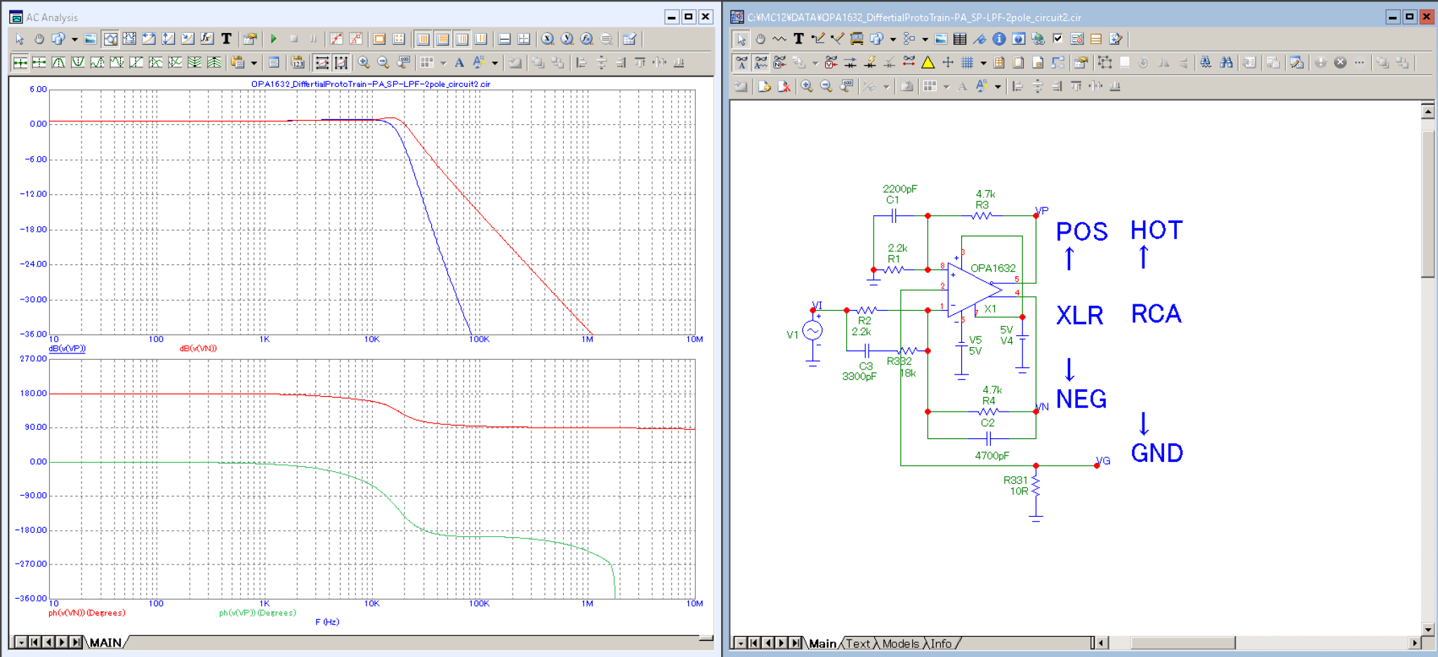

Now, I'm starting the detailed design of the Differential/Balanced output driver circuit.
Considering AC performance lead me to decide the compromised version.
I try to re-design the full-balanced version circuit. But keeping audible Hi-Res bandwidth is very very difficult.
Here's an optimized frequency response version design.
A low-pass filter characteristic requires a very complicated design. A small balanced output difference remains after tuning the components. And it not be able to ignore.
And here's a compromised version AC simulation
This design has no problem even if the Hi-res audio bandwidth application. According to the performance and number of necessary components, this version circuit has great advantages compared to the previous one.
I guess, now I can start redesigning the OVtAVIA's output driver circuit.

I forgot to upload the balanced output mode simulation.
This design will be a Differential RCA-pin output = 2Vrms, XLR output = +12dBV = +14dBv maximum.

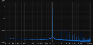

Here is an examples of crosstalk I measured today. I had a 1kHz signal on 32/33. One picture is without any other channels active, one with 10k on 40/41 and one with 20k on 40/41.
Regarding PCB layout. What was your reasoning behind goding for a 2 layer PCB? A 4 layer PCB is about 4 USD more expensive per board but offers much better capabilites for signal integrity and EMI. It also makes the routing easier in some regards. Maybe we should think about this too.

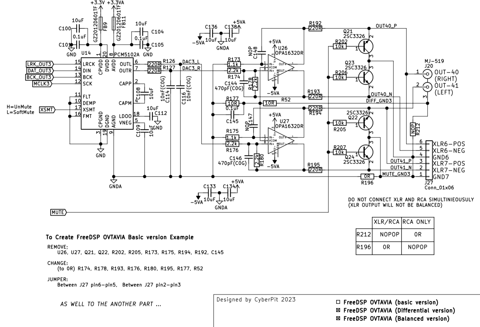

Hello guys, Here's the new version 0.3 schematic circuit diagram of FreeDSP OVTAVIA.
Due to the output circuit change, the quad DAC mode was deleted.
The changed points are...
The next step is PCB design.
The board will be changed to four layers PCB to increase the audio performance more.

Hi CyberPit,
I was trying to do some simulations and also rebuild your compromised circuit, but somehow I cannot get the same results. My VP is not a sine, i jumps from -4.4 to +4.4V which I would kind of expect since there is no feedback. What am I missing here?
Also, I read quite a bit about mixed signal layout and I often found that it is better to have one entire ground plane instead of separate split ground planes. What is your opinion on that?
Ludwig
Ludwig
