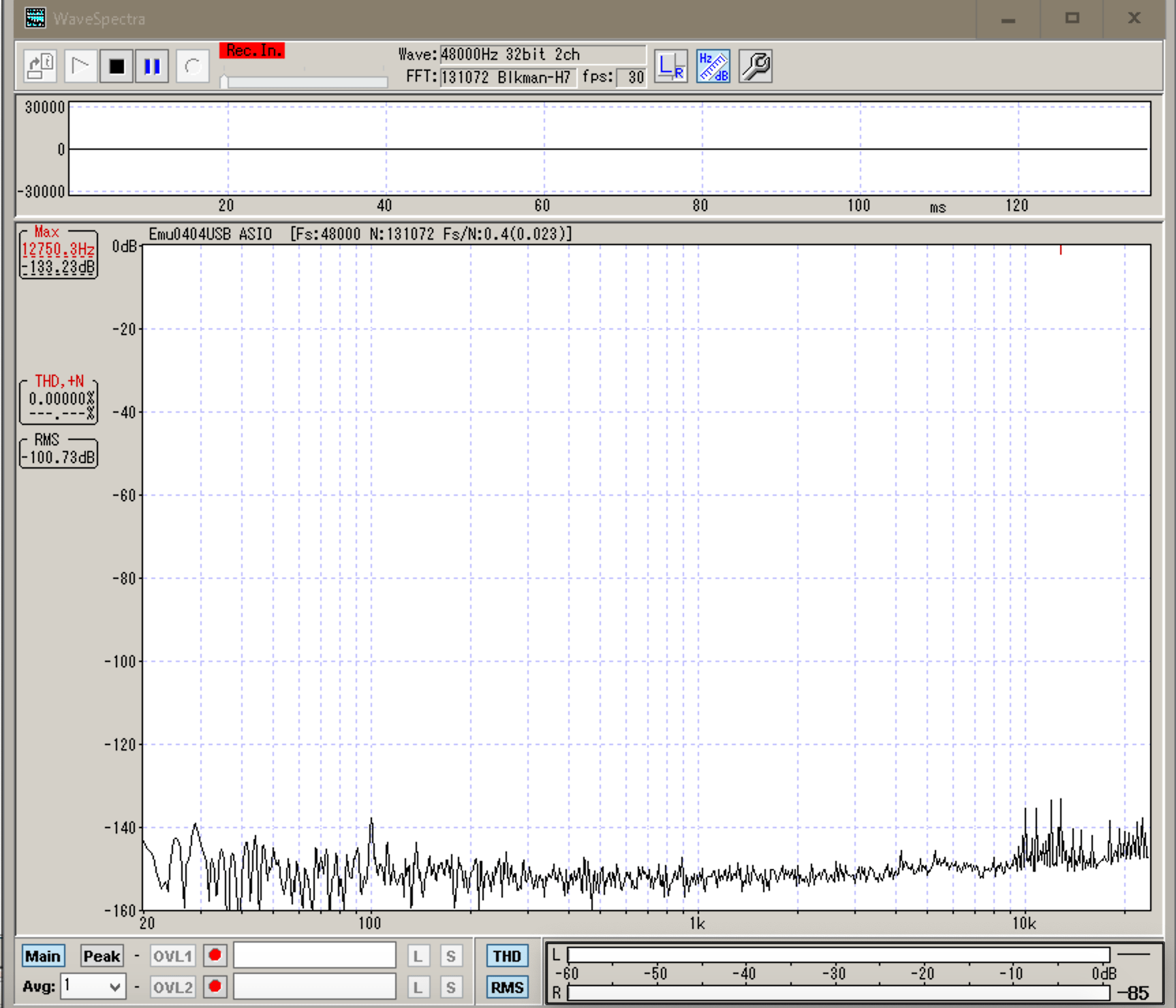

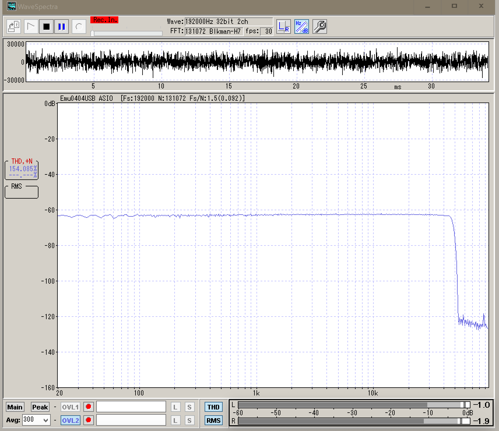

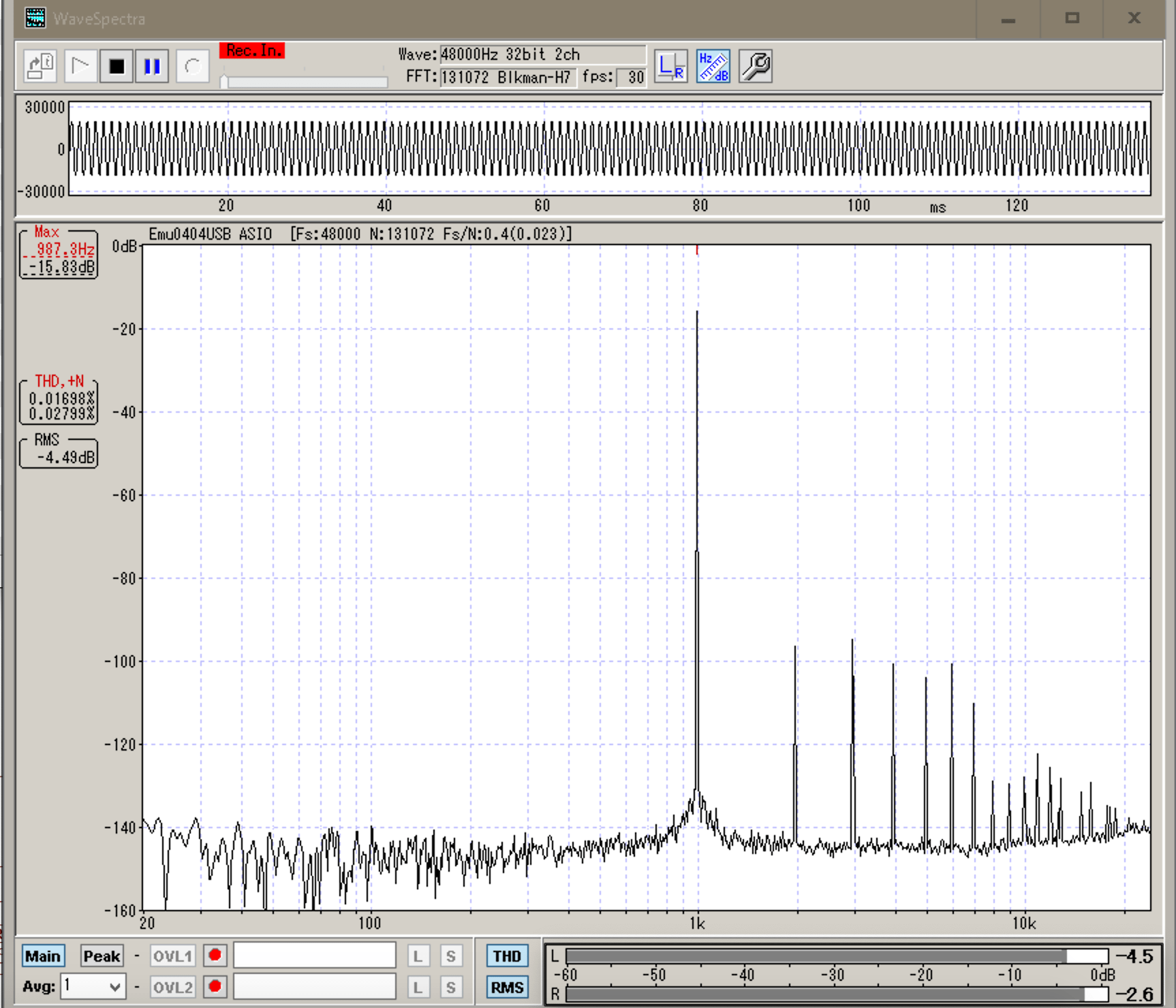

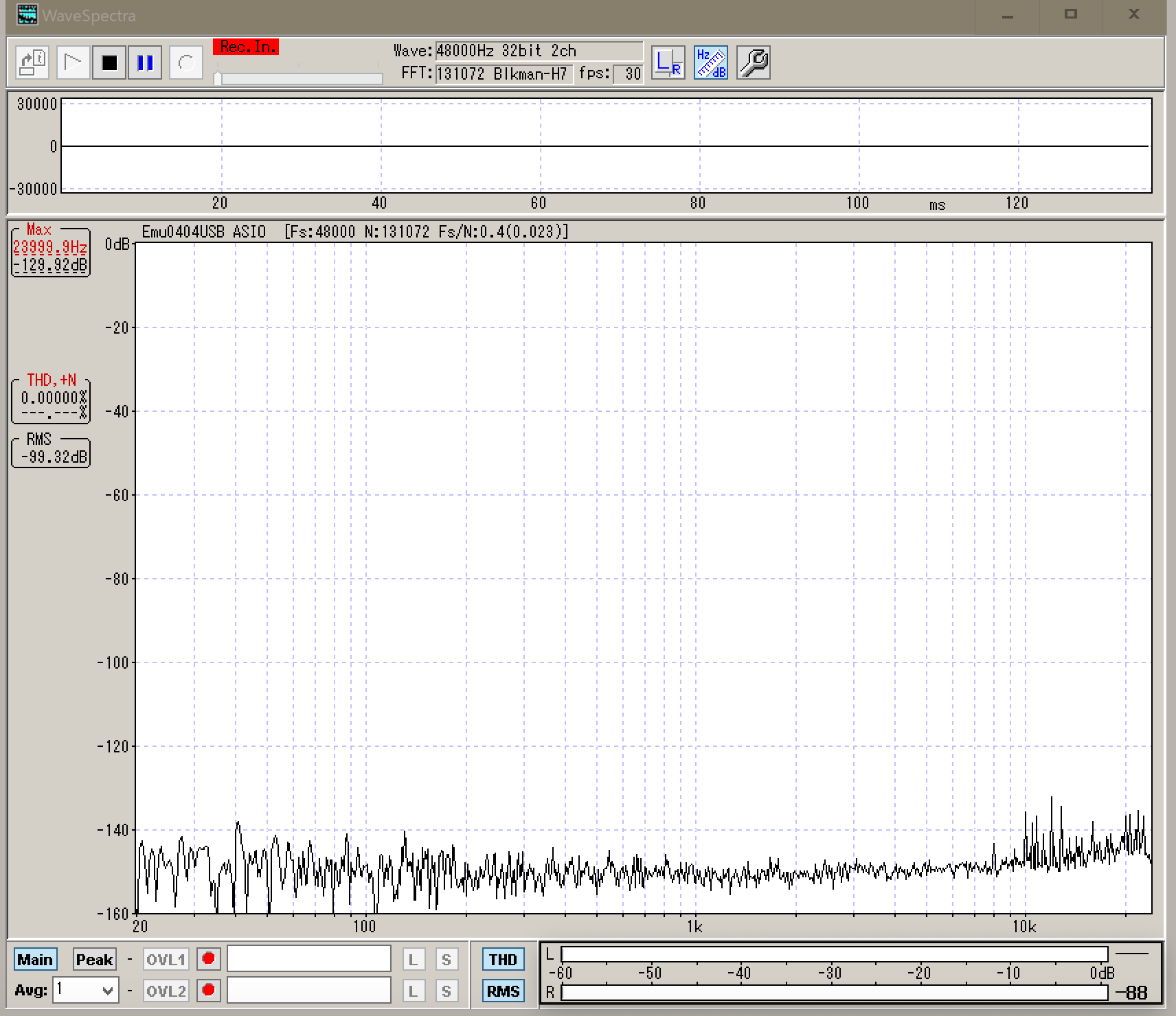

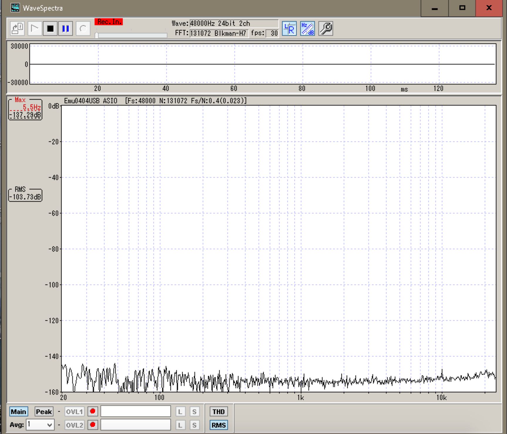

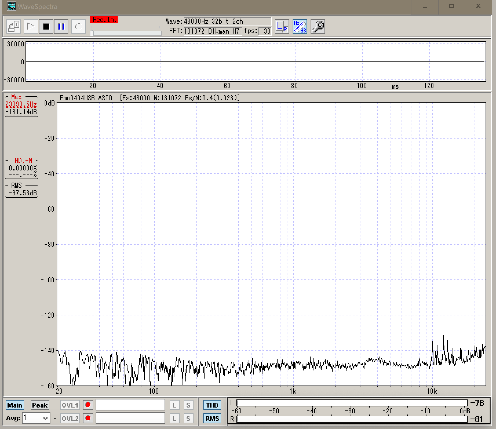

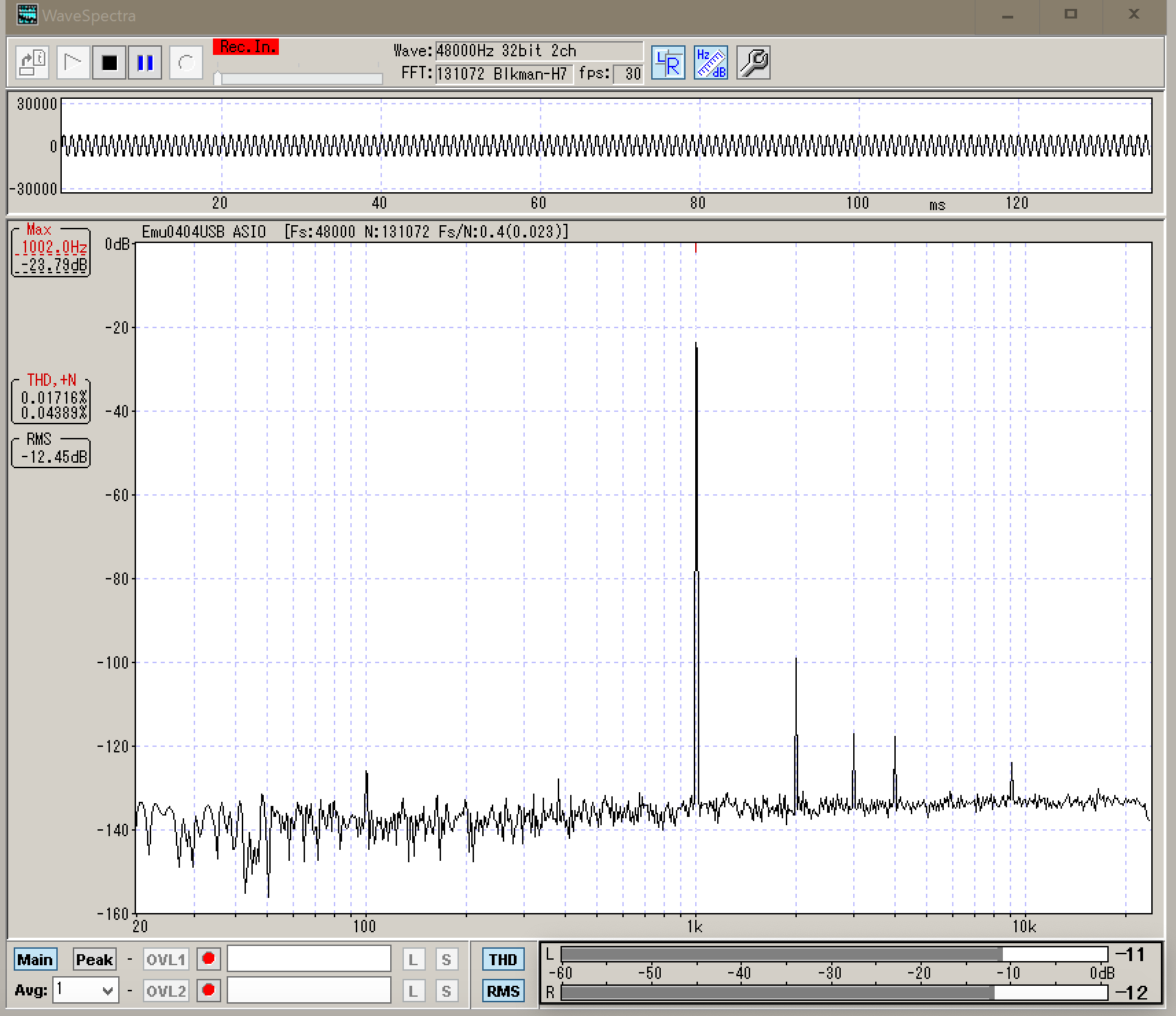

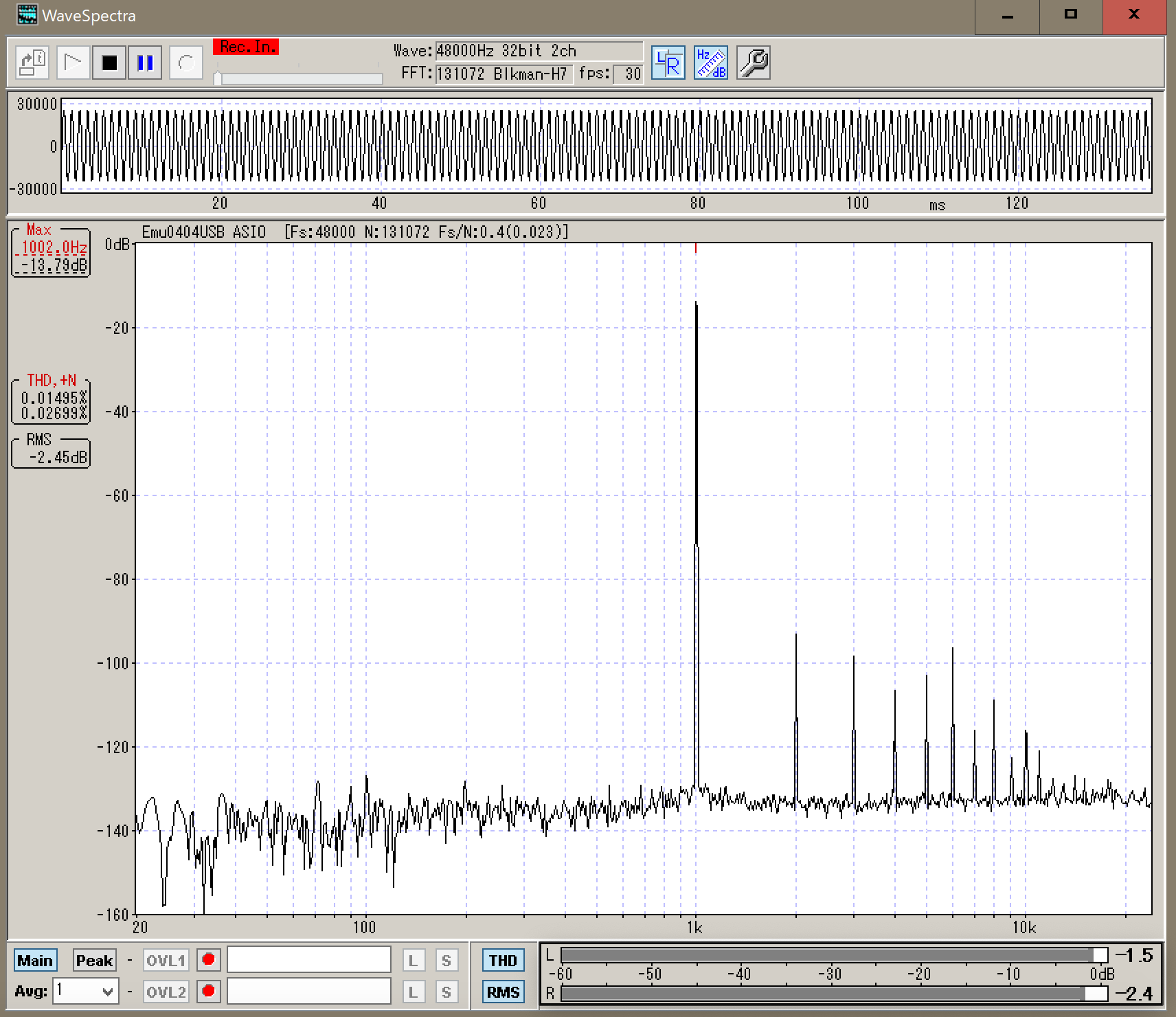

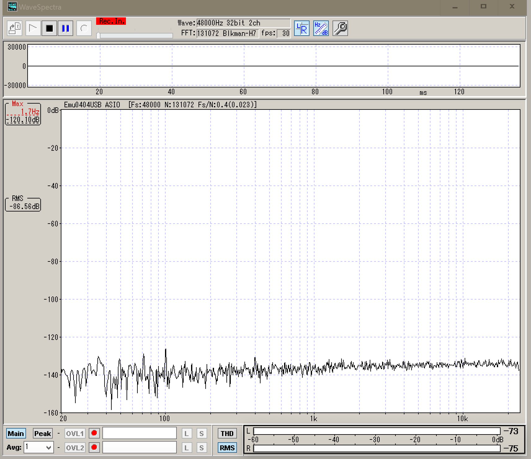

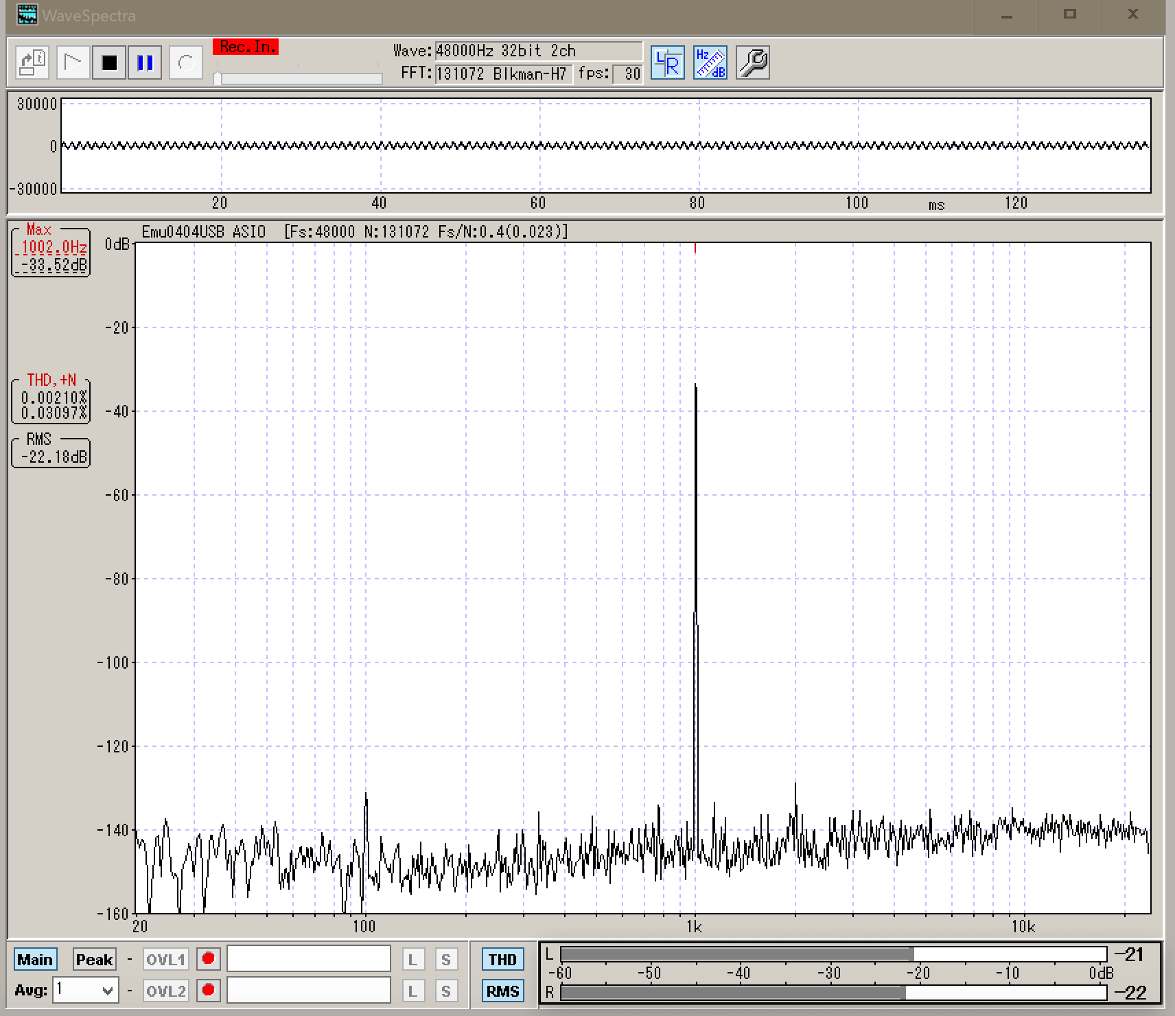

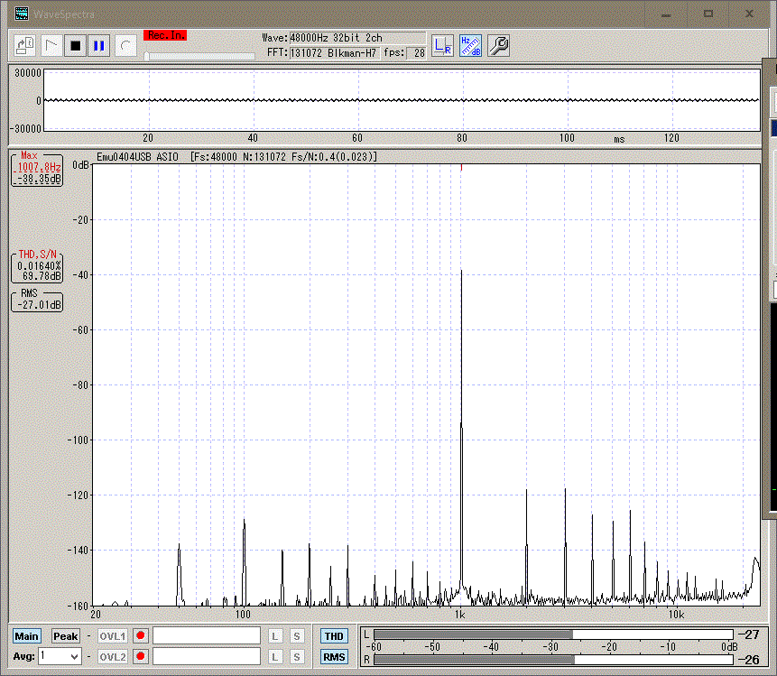

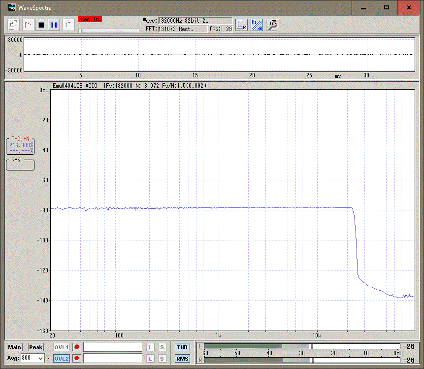

Hi Ludwig-San,
Well, it runs in stable.I run it all day long with Raspberry-pi Net-Radio Streaming with 2way Crossover.
In Japan, more than 90% of Audio equipment is Class-II (doesn't have a GND pin receptacle)
So I guess it will be nice to have an Earth-Terminal on Chassis. Because I'm using a differential output version, so sometimes I needed to connect each chassis. ( To limit the difference voltage within the power rail.)

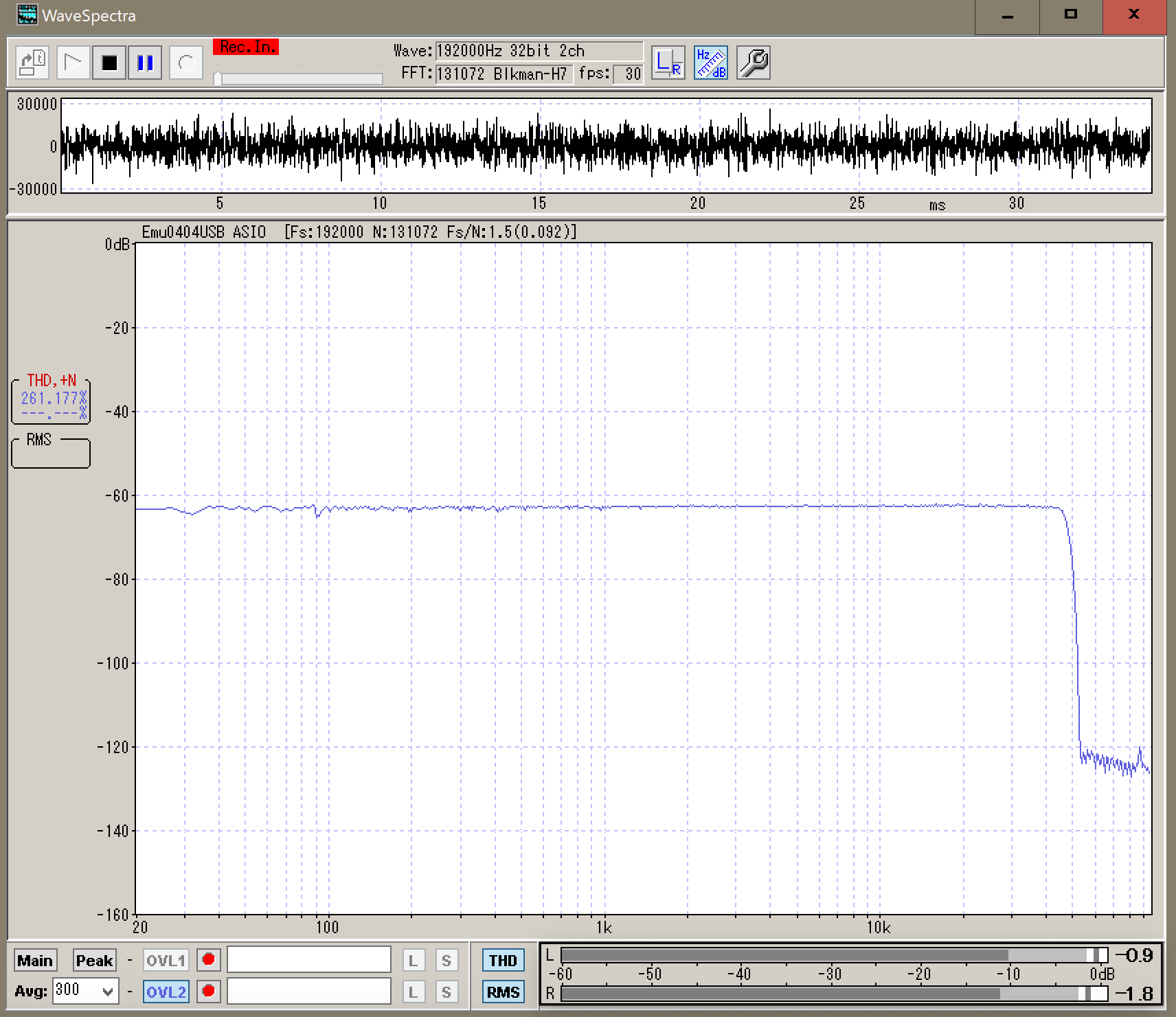

I measured some Audio performances...
If I turn on the Raspbery-pi, the ADC remaining noise will increases by 2dB.
CyberPit
CyberPit

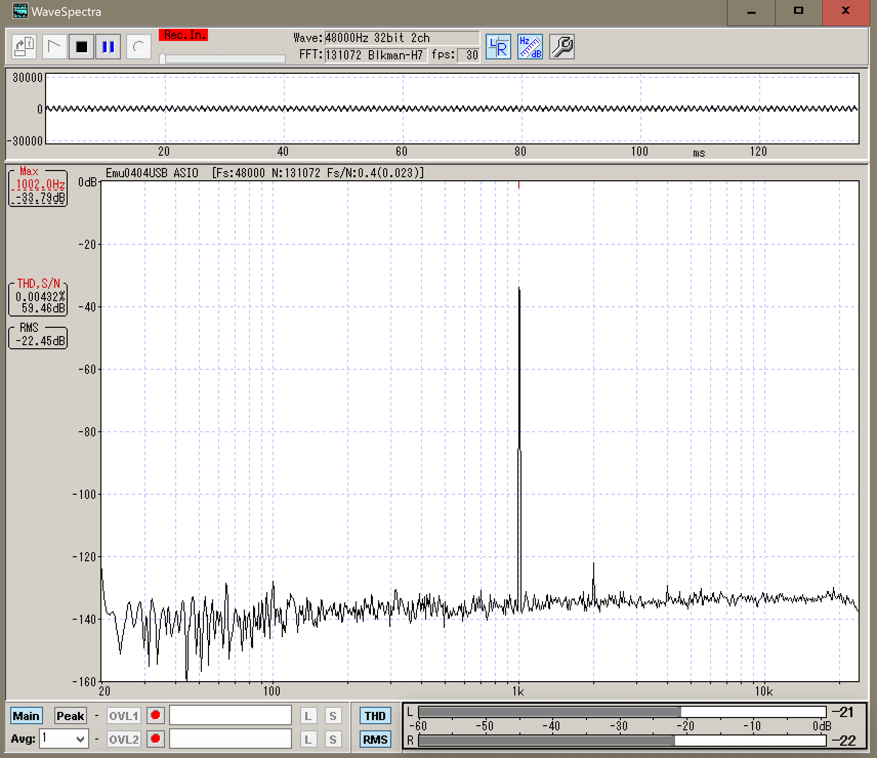

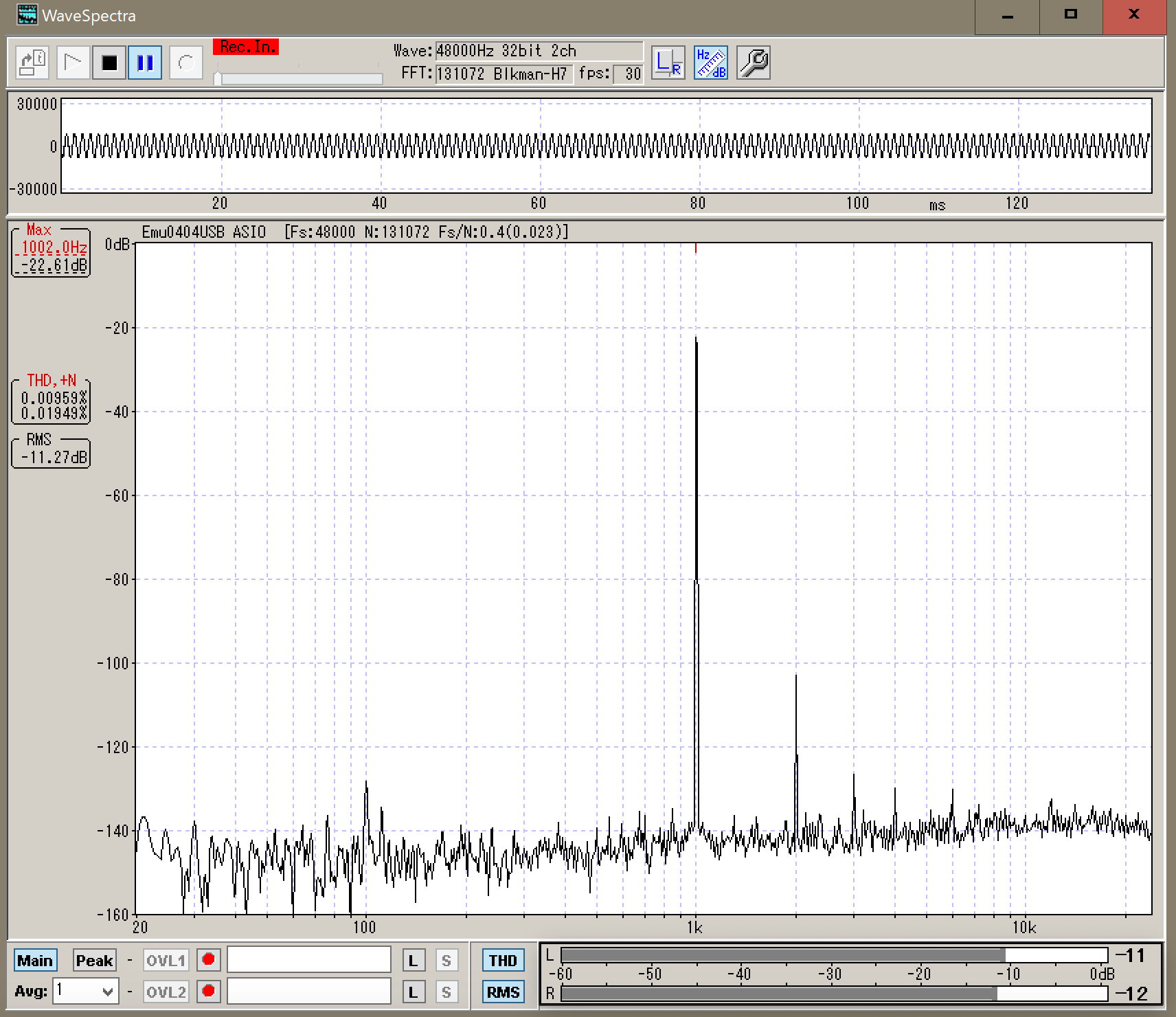

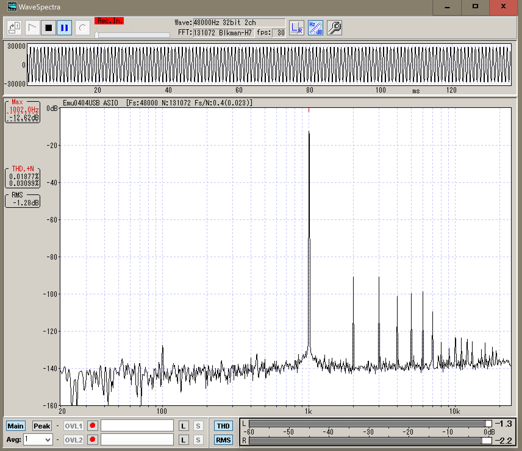

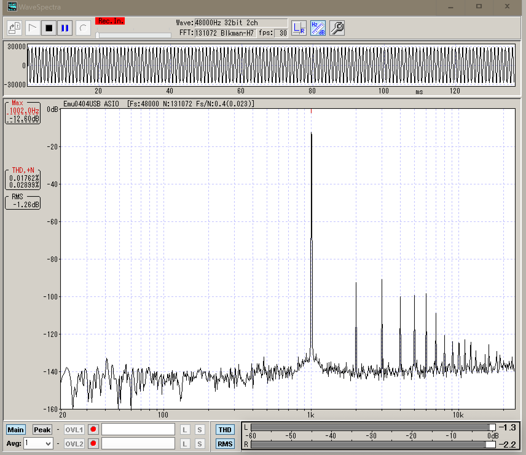

Hi CyberPit-San,
Thanks for your feedback and the measurements. I was wondering why are the THD numbers on the optical spdif worse compared to the pi playback measurements you posted a while ago? Spdif is purely digital so it should be very similar or am I wrong? Can you enlighten me?
What is your take on the measurements? It is always a bit tough for me to differentiate between the race to better and better THD numbers in the audio industry and how much you will really notice.
Ludwig
Ludwig
Joined 2018
Joined 2018

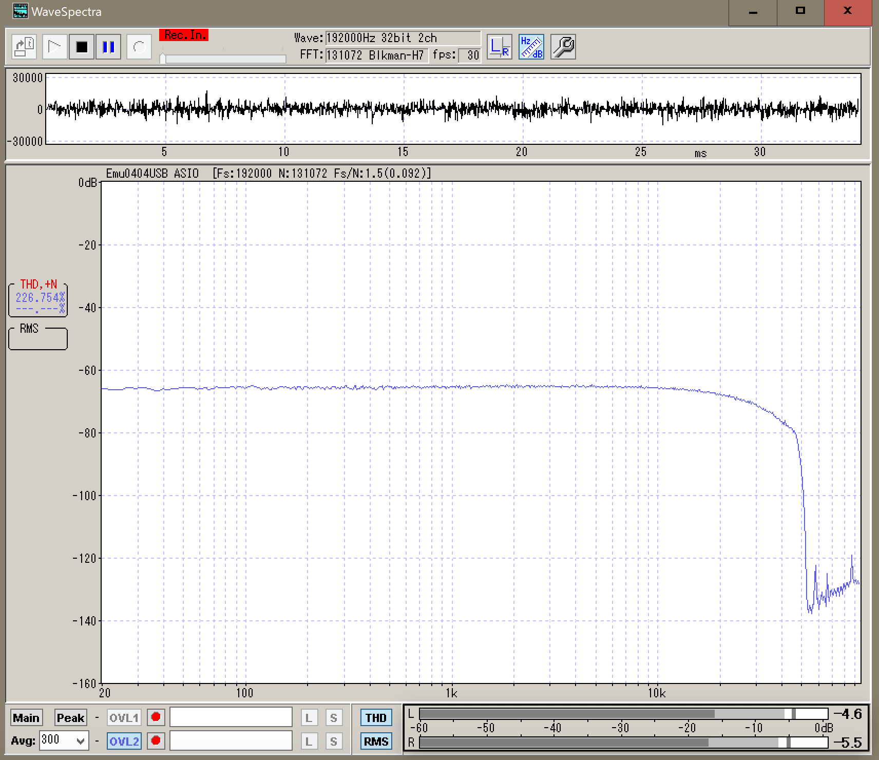

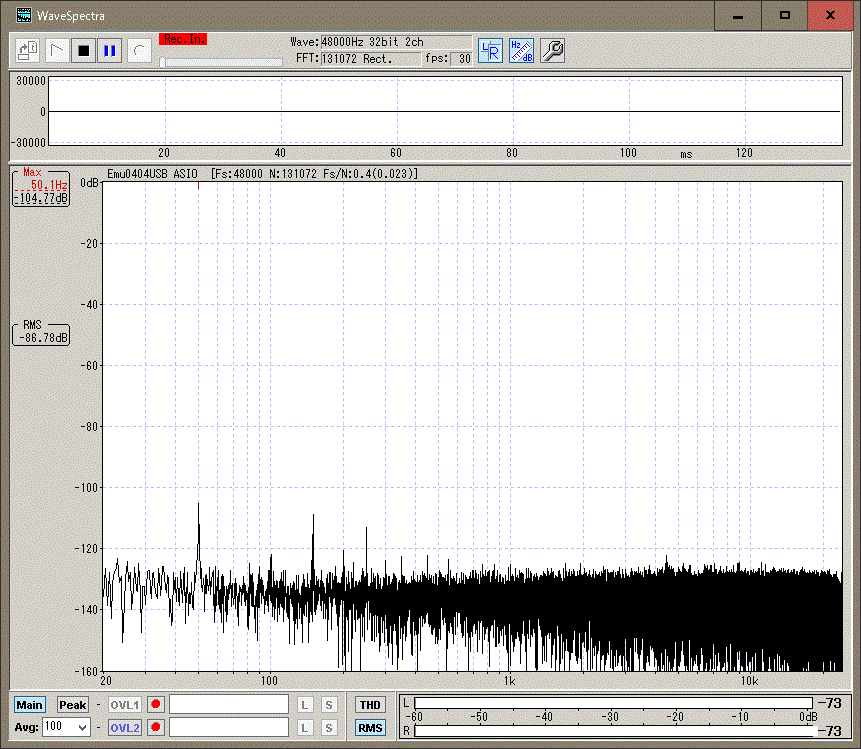

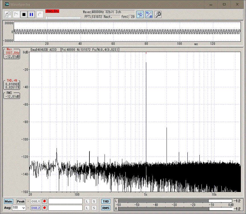

Currently, my OCTAVIA board configuration is Differential-Output. It needs to connect the signal source and target chassis to each other. So I changed the GND connection points between OCTAVIA and Measurement devices. Also, I update the USB Audio Interface driver.
The measurement result is changed...
My USB Audio Interface has some performance problems with the large input level. Just check the output level for @0db
CyberPit
CyberPit
Hi CyberPit-San,
that is quite the difference. Thanks for the effort I imagine the ADC results would look better now as well.
Ludwig
Ludwig

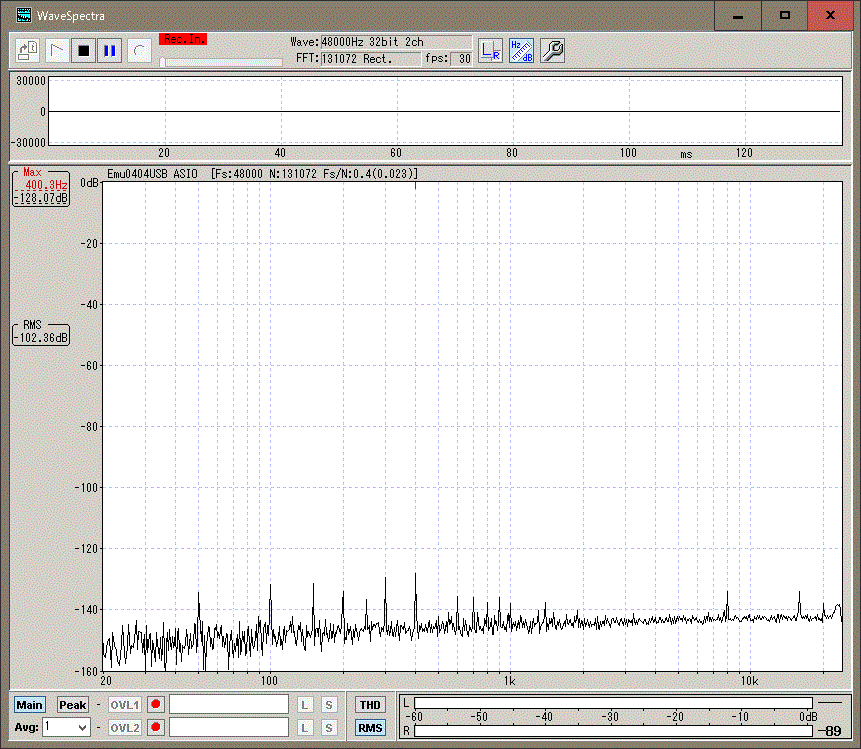

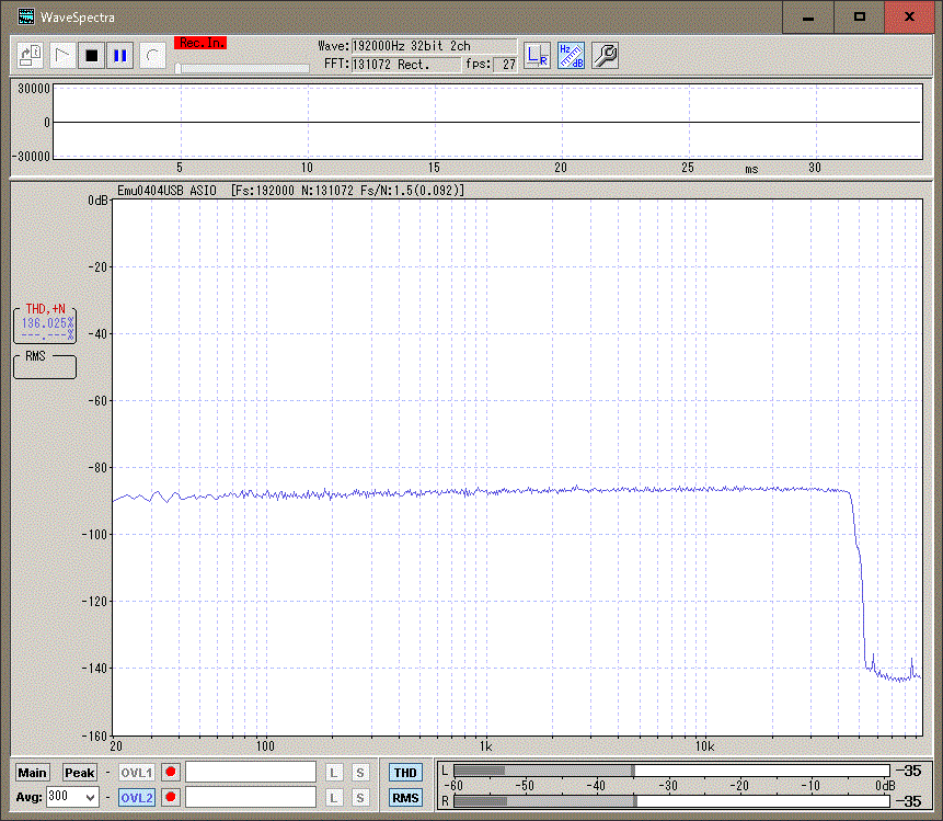

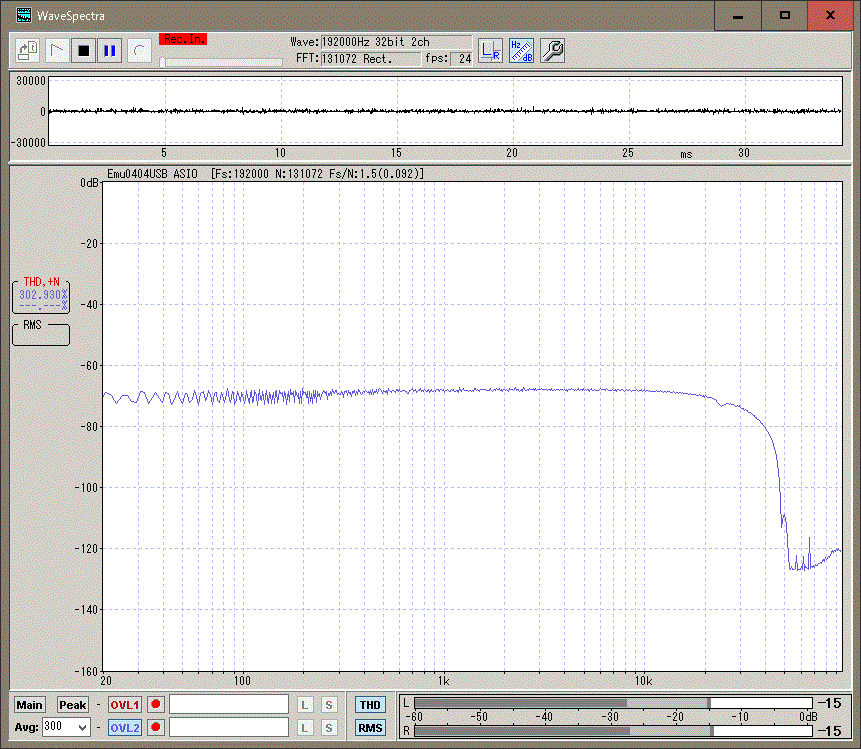

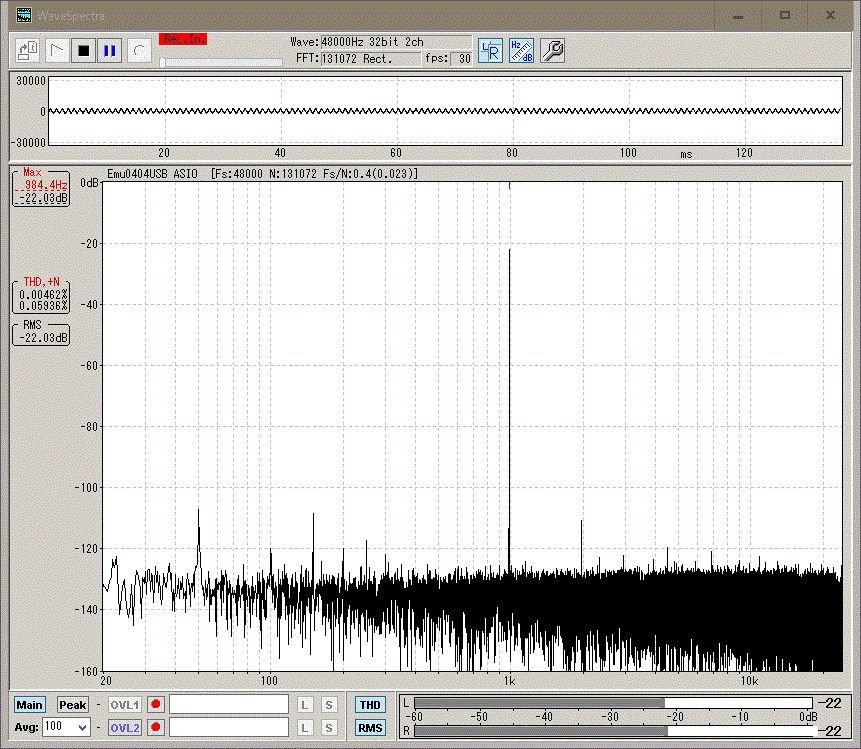

Here's the measured data update
ADC Analog Input
The results were not so much different. Because it's close to a single-end input ADC PCM1808 performance limit.
ADC Analog Input
Joined 2018

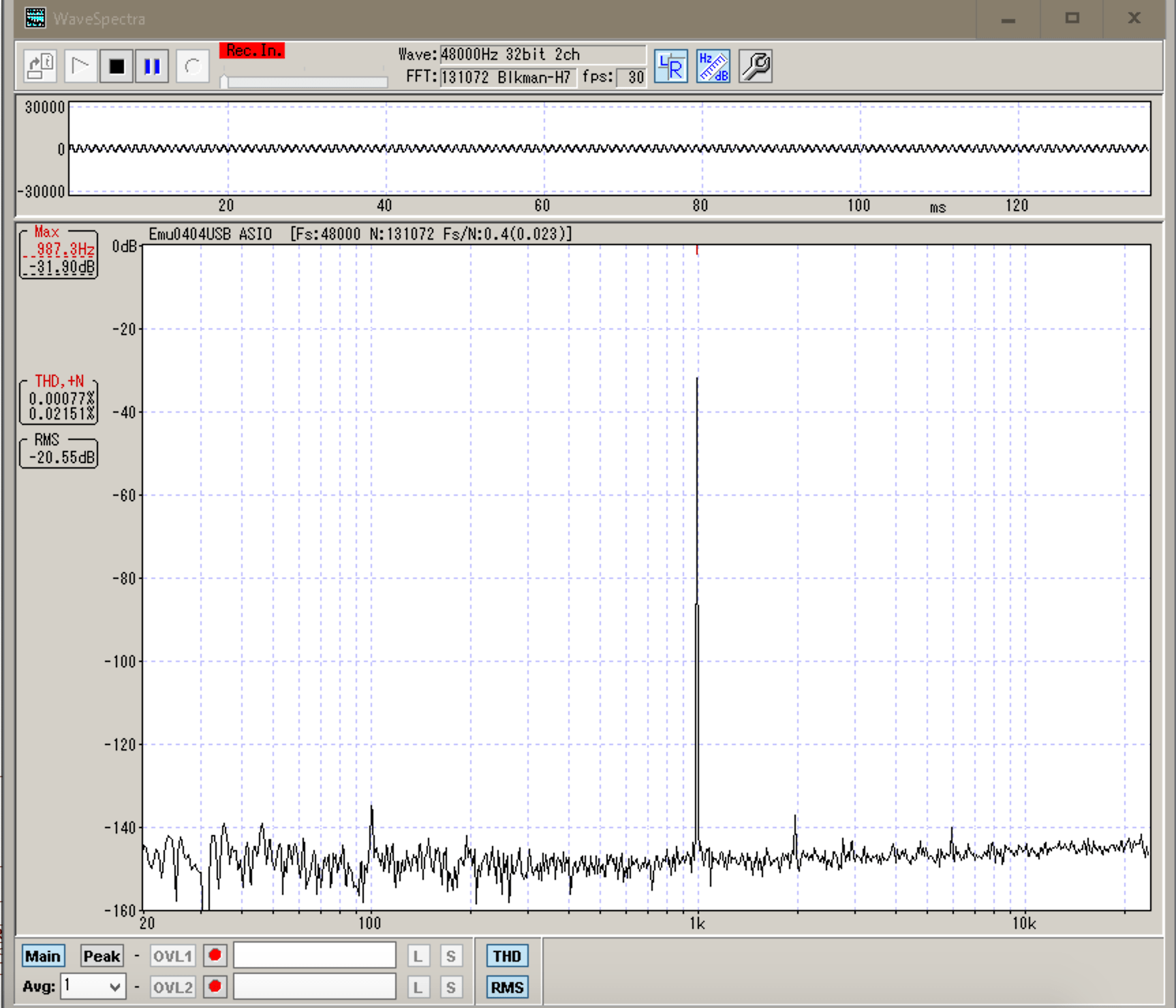

Also the USB input
Maybe my USB Audio Interface has some performance problems with the large input level. It looks always the same...

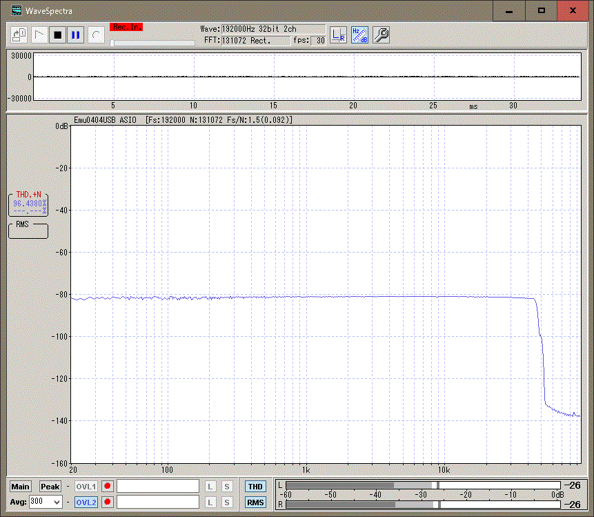

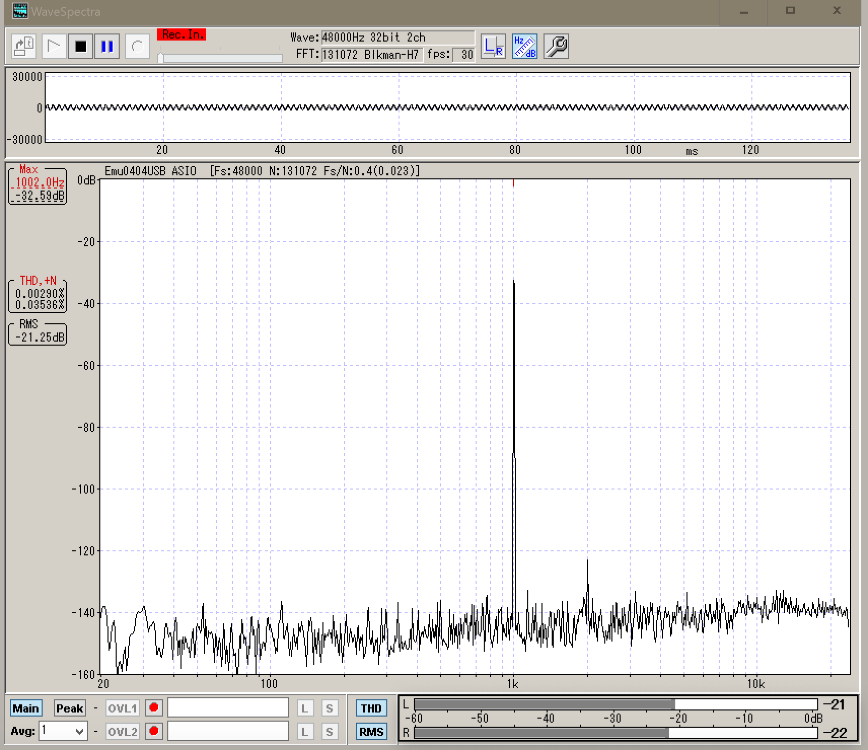

Finally the Raspberry-pi
Hi CyberPit-San,
thank you very much for all the measuements and therefore your time you put into this.
If the group buy is done I could make some measurements as well and see if there is any difference on my side. Or if you have an other DAC laying around you could check if you measure something similiar than we know if it is the USB interface or not.
Just to be clear, I don't want to sound negative or want you to get the impression that I talk bad about your results. Your work is amazing, no doubt. I just want to openly analzse the results., I guess this is the engineer in me, hunting for perfection 😉
Ludwig
I mean it is to be expected that there is not much difference between all the digital inputs. In all cases we measure basically the performance of the DAC (and of your USB audio interface). But I was also wondering why the harmonics are so much higher at large input levels. If you look at the DACs datasheet there is an increase close to 0dbfs but not that much. It could be your usb interface, i could be something else.Maybe my USB Audio Interface has some performance problems with the large input level. It looks always the same...
Ludwig

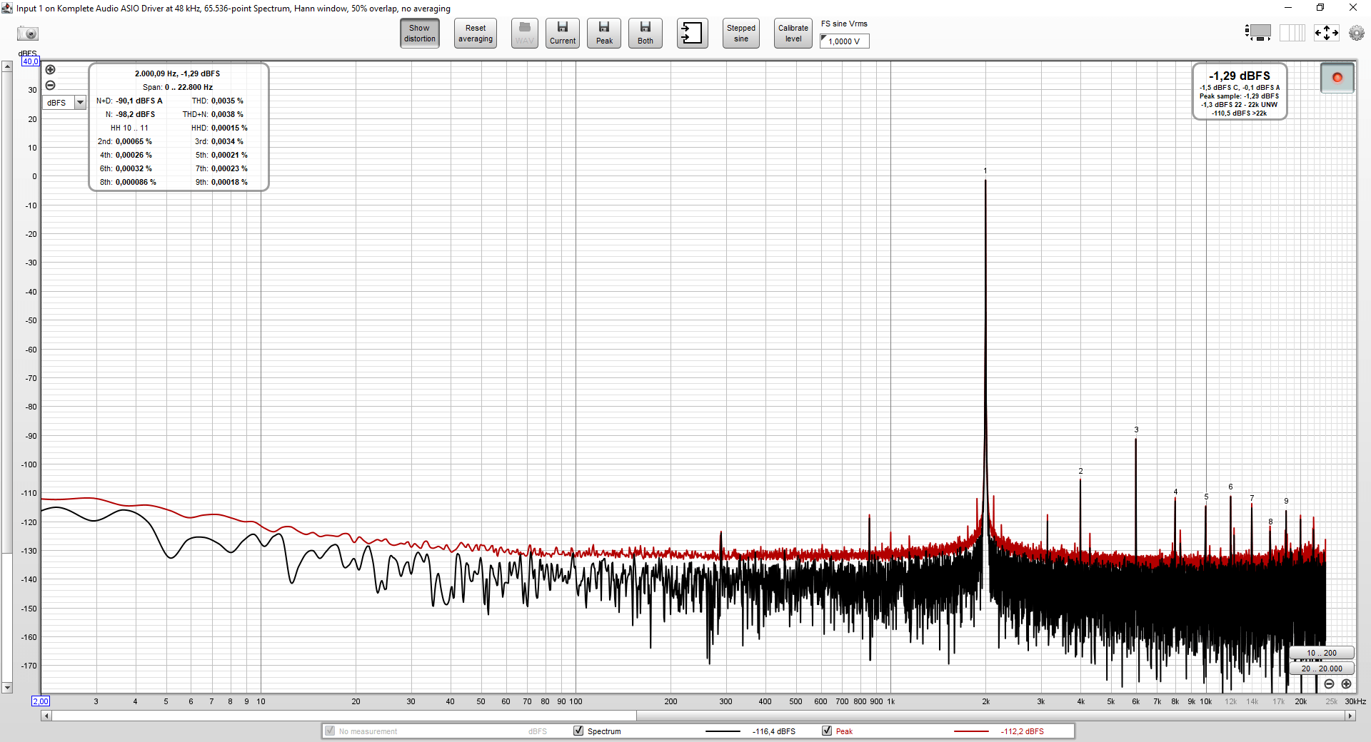

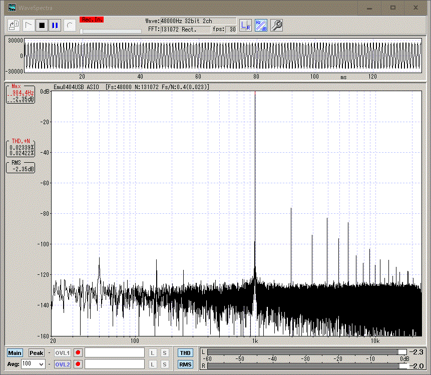

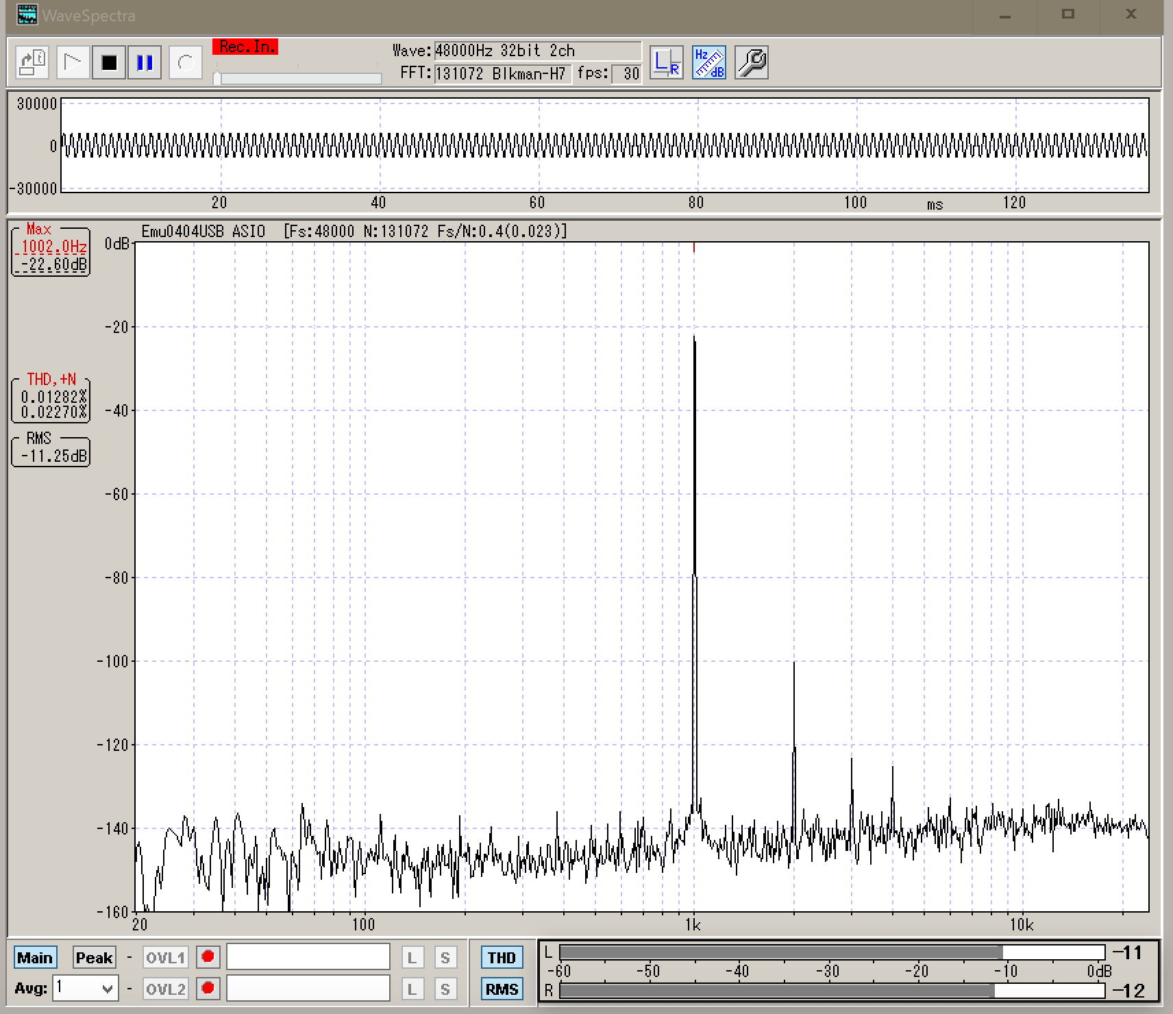

Alright,
first baseline masurement is in done. The numbers THD and THD-N look a bit better, but there is still room for improvement.

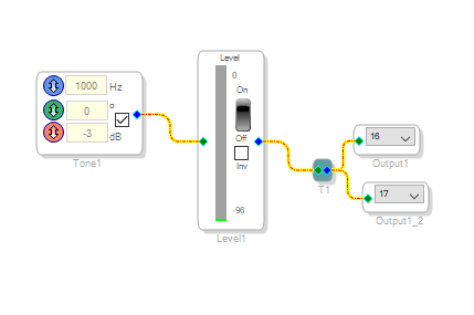

One thing is odd. I generated the sine wave on the dsp with the schematic below. I set the frequency to 1kHz but on the output I meaasure is 2 kHz. Has anyone an idea what might be the issue here ( I set up a new project since I am using the ADAU 1466) ?
Ludwig
