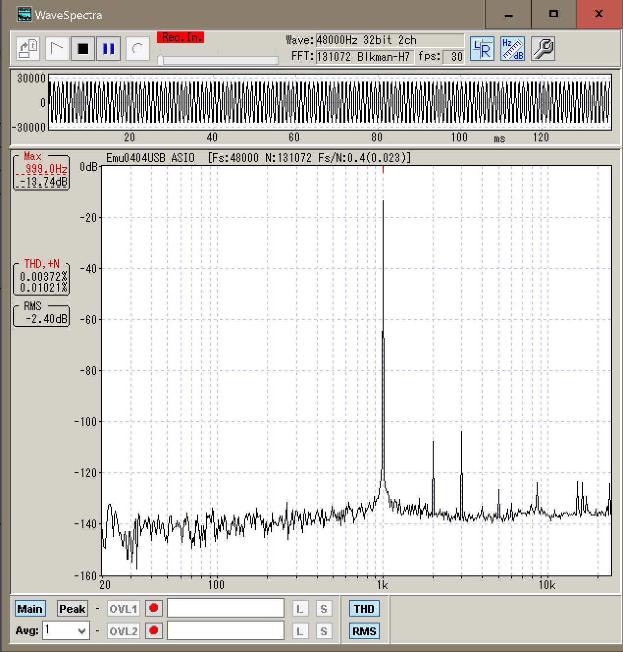

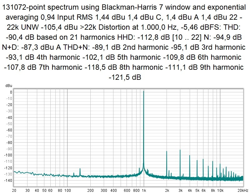

Alright, here are some first results ( sorry for the long post 😆)
My measurement setup:
Octavia board sitting without a case on the desk, raspberry pi 3B running. I connected the differential output from the header to my Komplete Audio 1 interface (MIC input). The interface has an THD-N of 0.001% and a noise floor of about -150db ( a bit higher at lower frequencies). On the desk are also monitors and a docking station. They might be responsible for some peaks in the measurement as well. I powered the board with a 12V MeanWell power supply. Don't have the lower voltage supply yet.
I measured the default ocatvia configuration with several input amplitudes:

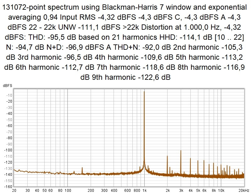

Very high input amplitudes (-3dbfs - 0dbfs): Here the THD-N is a bit worse compared to the optimum. On one side I get close to the maximum of my audio interface (komplete audio 1) and on the other hand has the DAC not the best THD-N at 0dbfs.
Input amplitued of -4dbfs to -8 dbfs: In this section I measured the best performance. This also makes sense when looking into the DACs datahsset. This graph shows a similair optimal range.
Here is the best measurement at -7dbfs I measured:

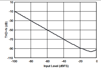

With THD-N of -91.8dB we are already very close to the DACs performance (-93dB at -1dbfs and from the plot above a bit better at -7dbfs, so maybe 95-96dB). The last few dBs could are probably a combination of lower noise and lower harmonics. Also this peak at 150Hz (probably caused by a device on my desk) makes the THD-N a bit worse. So I think the performance is not bad at all give the limits of the DAC.
Additionally, I tried a different LC lowpass at the output of the DAC with 470 Ohms and 2.2nF. I also used a film capacitor. This however did not seem to change the results. I migh do some more measurements in the following days.
I also tried 10k resistors instead of 4.7k resistors at the opamps. My Idea was to have higher load resitance. The harmonics did not change but the noise incereased, which was to be expected. So this is not useful either. I'll maybe try with 1k resistors as well. This could lower the noise a bit more and hopefully not increase the harmonics. Lets see...
Tomorrow I can remove some muting transistors and an opamp at work to do some measurements without them.
One thing I also noticed, when I power up the board the harmonics not so high and they will increase over time to a steady point shown in the graphs above. Maybe this is dues to heat? I have to see whether the measurements change when I point a fan at the board.
This is it for now. I'll keep you updated.
And if you have any ideas what I can further test, feel free comment 😉

Firstly congrats on getting the board finished and working! These measurements look quite encouraging 😀THD-N of -91.8dB we are already very close to the DACs performance (-93dB at -1dbfs and from the plot above a bit better at -7dbfs, so maybe 95-96dB). The last few dBs could are probably a combination of lower noise and lower harmonics
Do you think with a lower voltage supply the heat related harmonics may reduce?
Thanks for sharing your findings Ludwig!
I still have to confirm that the heat is the cause. But I will test again with a fan and a 7.5V source once it is here.Do you think with a lower voltage supply the heat related harmonics may reduce?
I am not sure. Everything in the audio path can cause distortion. So yes, the measurements can look better, but the noise can also be worse due to the nature of unbalanced connection. I will remove some muting transistors today after work and also change two outputs to unbalanced and do some measurements on this.Do you expect any differencs in performance from what is shown above between the balanced and unbalanced output versions of the board. If it does change, will it affect the noise floor or the harmonic distortion components?

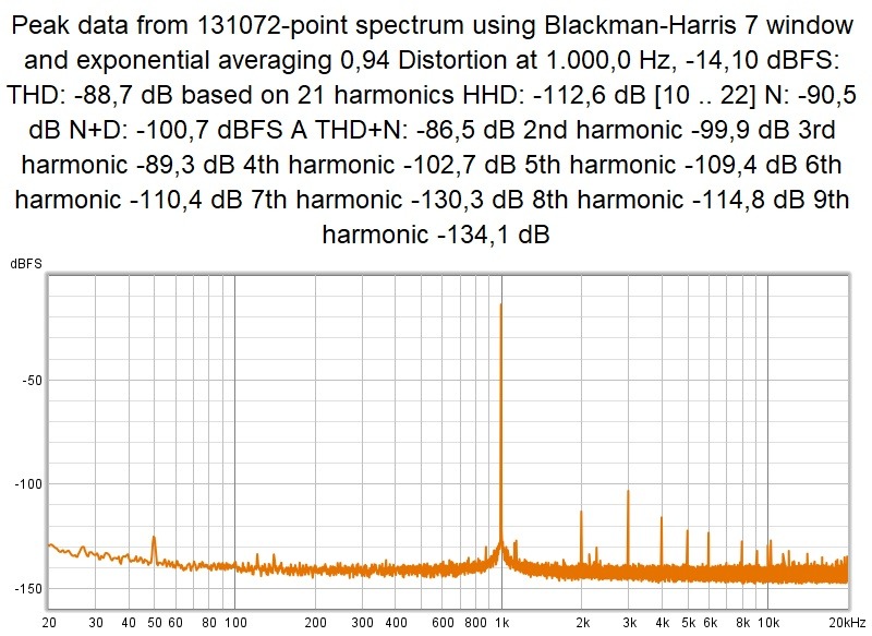

Then I measured an unbalanced output. At first I thought that the performance is much worse, but for the unbalanced output I have to use a different input on my audio interface, which has a different gain. Therefore the input level was much lower and THD-N worse. Then I reduced the gain with the balanced output to have a compareable input level in the measurement. The THD-N results are compareable, the harmonics look a bit different:
unabalanced - orange, balanced - green
The harmonics look a bit different (more on that later), the noise is a little bit lower with the balanced connection. Unfortunately, my audio interface limits my measuring possibilities regarding the unbalanced connection here, or maybe I can connect it to the balanced input somehow 🤔. I'll think about it...

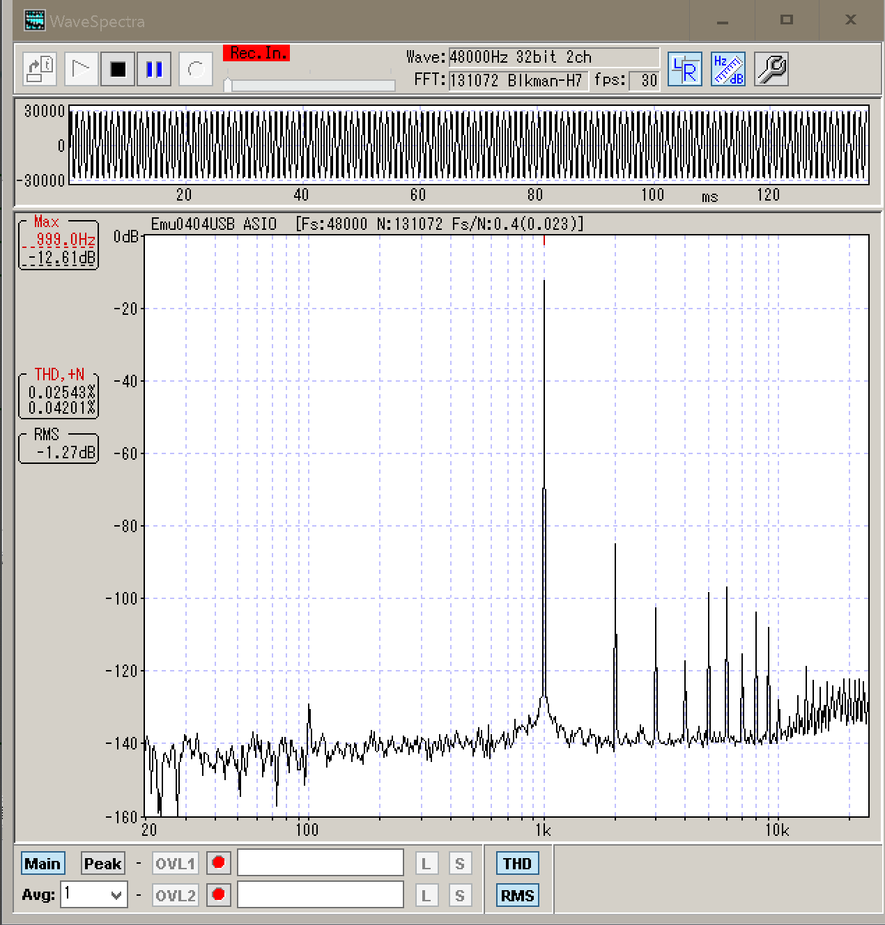

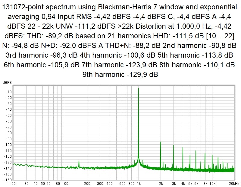

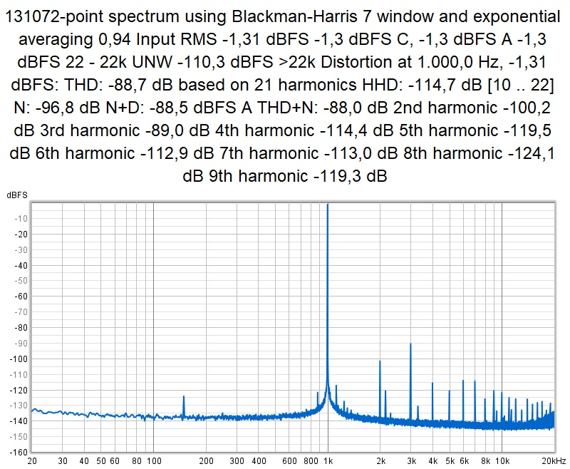

Now I have one more interesting finding. So I took measurement not only from one balanced channel and I noticed that they look differently:
Here for example are two channels, both with the original components:
channel32 - green, channel 16 - brown
The harmonics on both channels look different. On channel 16 (brown) the even harmonics (2nd, 4th, 6th) are lower compared to channel 32(green). Here I would say this is due to non identical pcb layout of both channels. As far as I have read from a TI note, symmetry of traces and components affect the even harmonics, which could be the case here. But please tell me if I am wrong here. By no means I am an expert here.

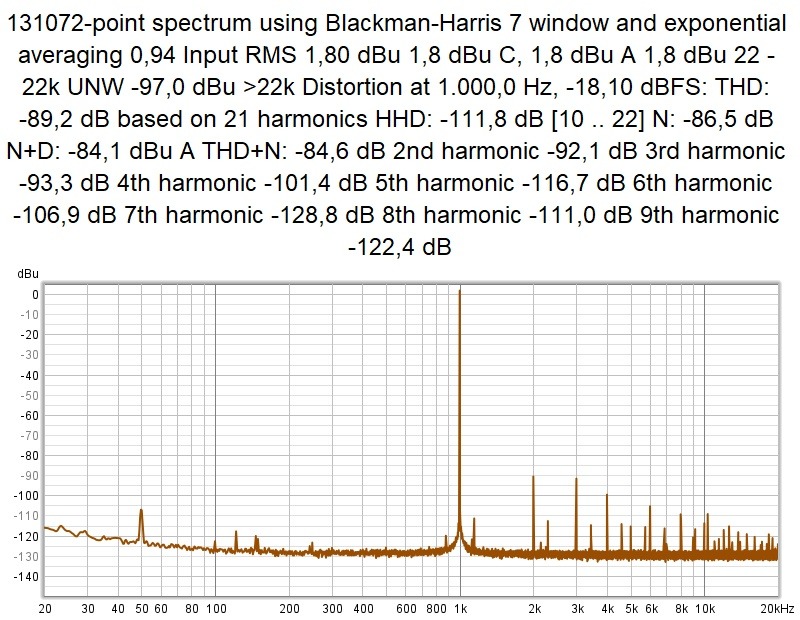

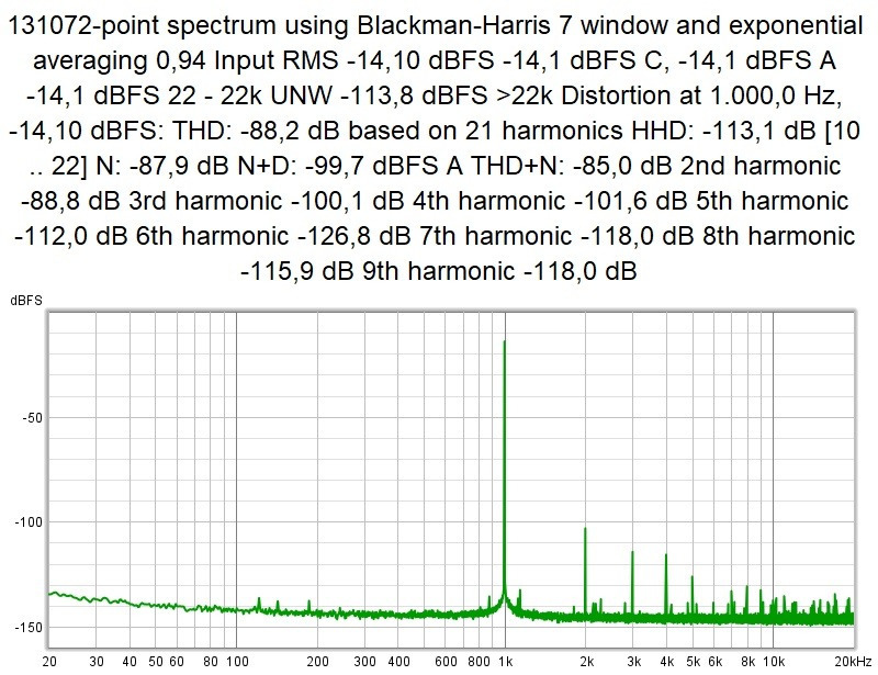

After thinking about it, my comparison of the unbalanced output might not be correct. Maybe I should switch from dbfs measurement to dbu. I'll test this again tomorrow...
Alright,
here is the update to the unbalanced conenction/comparison.
I was right with my little note yesterday, the comparison was not right. I need to have the same gain for both measurement, everything else makes no sense. And then I have to calibrate the levels of the two inputs on my audio interface. I found the option in REW to do so. Now I have a comparable set of graphs:
unbalanced - brown, balanced - turquoise
So harmonics are higher and the noise floor is higher on the unbalanced conenction, therefore THD-N as well. So unbalanced connection is not as good as balanced connection. But keep in mind that there are differences between the channels as discussed in my last big post. Some channels might look better or worse... Still, differential design helps to reduce noise and even harmonics so the result is quite plausible.
Ludwig

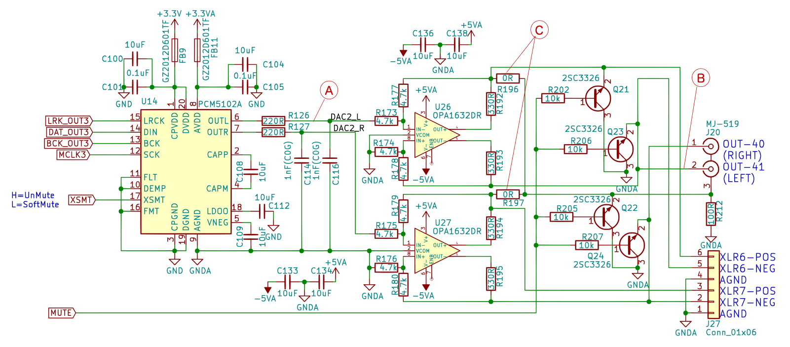

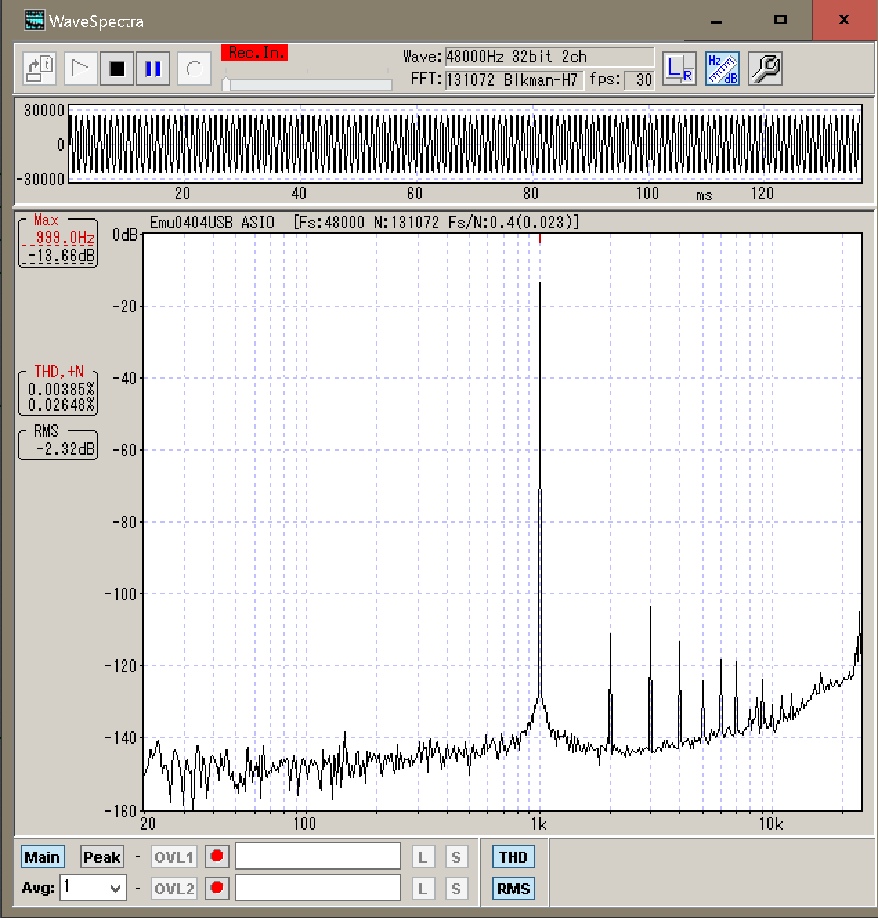

Hello Ludwig-San,
I've got something to tell you.
Point-A is PCM5102A output, and Point-B is Differential Driver Output. Resistors C are jumpers between Cold-End and RCA-Sleeves.
Point-A: PCM5102A DAC Output Distortion Spectrum.
Not so bad as of this point...
Point-B: Differential Driver Output Distortion Spectrum.
Distortion increased significantly.
Point-B: Resisrotors C Removed Non-Differential Driver Output Distortion Spectrum.
Distortion was not so increased.
According to those data shows, a significant large signal distortion was produced by OPA1632 driver circuit which is connected as a Cold-side termination. The last spectrum shows a heavy-loaded condition was released by removing R196/R197.
A differential output can reduce the hum-noise in many cases, but a large signal quality has some damage.
Perhaps we need re-think the differential output circuit connection.
