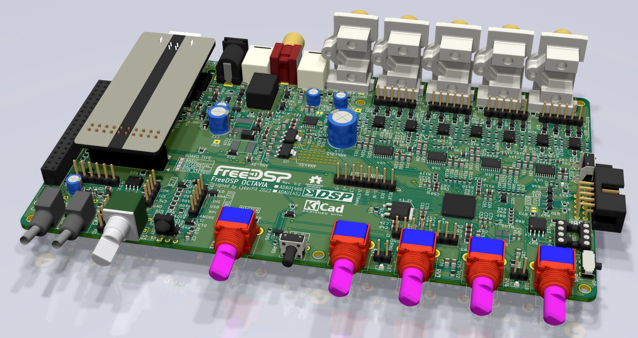

Hi CyberPit-San,
I'll look for a suitable 220µF cap then. What do you think, should we move C13 and change the footprint before we do the group buy?

That makes sense, thanks for clarifying.Well, To prevent the heat physically, I needed a long leaded capacitor. That was the only one I have at that time.
No other meaning of choice. The board should have a bigger footprint and be away from the heat source.

Today I found one more mistake on J13. The Anode side power (+5V) is connected to the same power rail of RPI. So the source position LED is not turned on when the RPI is not active. And one of the worse things is it's too bright😎
The workaround for this is to connect the Source Indicator LED's Anodes to pin6 of J3. (+3.3V)
This is the biggest mistake in this initial version 0.1😱
I want to fix the current issues, but it will take one week. I'll prepare the new PCBA Data if you can wait a week.I'll look for a suitable 220µF cap then. What do you think, should we move C13 and change the footprint before we do the group buy?

Hi CyberPit-San,
Thats unfortunate, but a complex design without a mistake is like winning a lottery 😆
But so far I would say these are all very minor mistakes. So you still did a very good job 👍
Maybe you can also integrate the header for the status LED while fixing the other issues?

elagil-San,
Thank you very much.
Ludwig-San,
ThePOWER/STATUS indicator LED had moved between the MAINS and RPI-POWER switches. This change comes from making space for an external RGB-LED connection header.
I fixed a mute control feature of Combo384 to PCM502A's XSMT. Additional some parts were needed for this change. Please include them for the precise cost estimation.

Ludwig-San,
I changed that tactile switch, but the space was insufficient for two switches. So I moved the "DSP-RESET" switch to the side of USBi connector. According to the TCP USBi support, the possibility of the use of USBi will decrease later in this project. Previously I implemented a GPIO connection jumper JP3 for the remote DSP-RESET feature. As a result of this, The shutdown/reboot/restart button remains in the middle of the MASTER volume and AUX1 POT.All the right angle tactile switches I see have some supporting pins like in the picture below. Do you have a footprint for those switches as well? I mean we could also cut the rear legs of the switch...

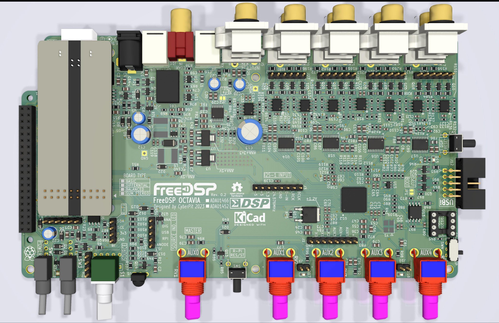

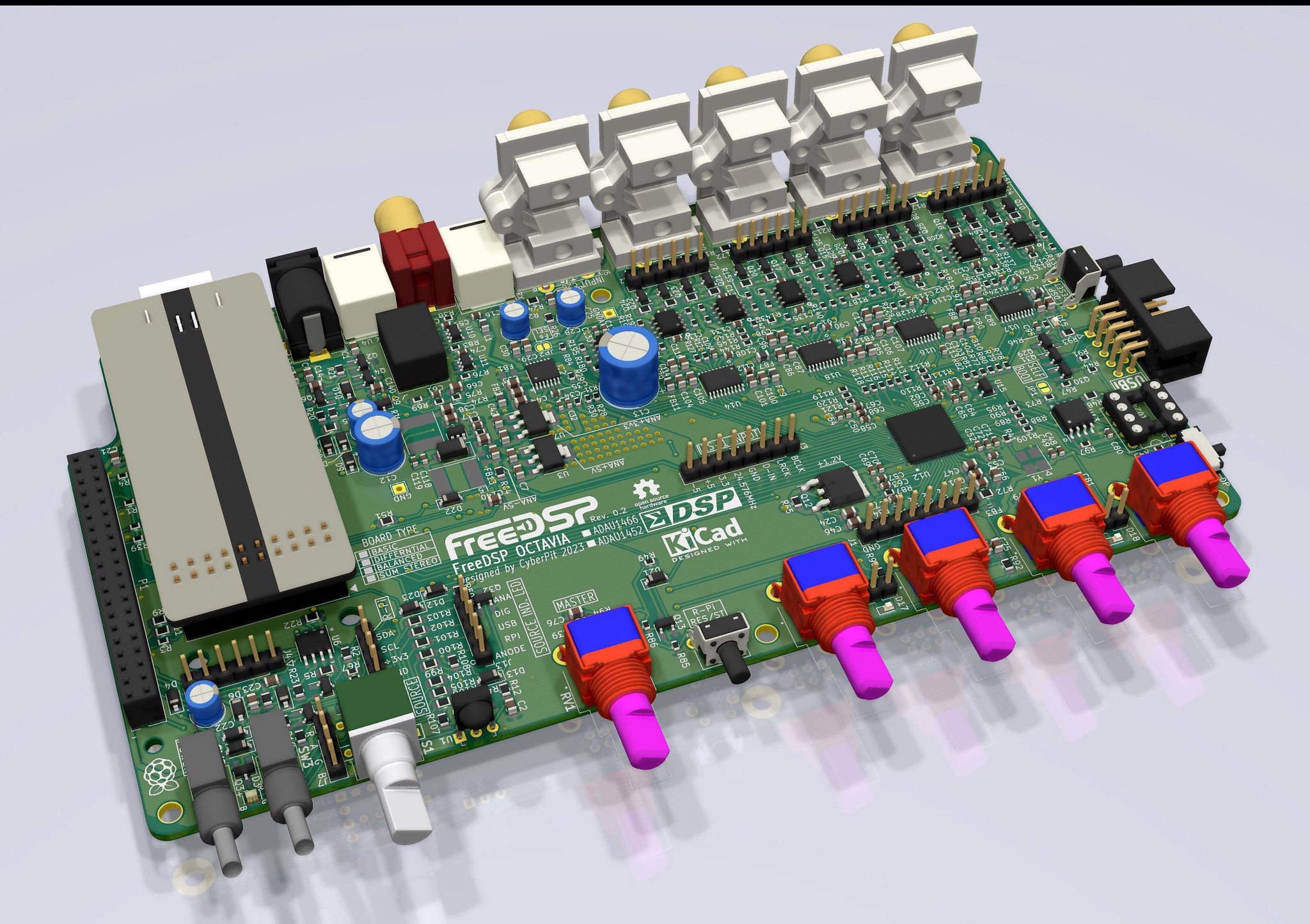

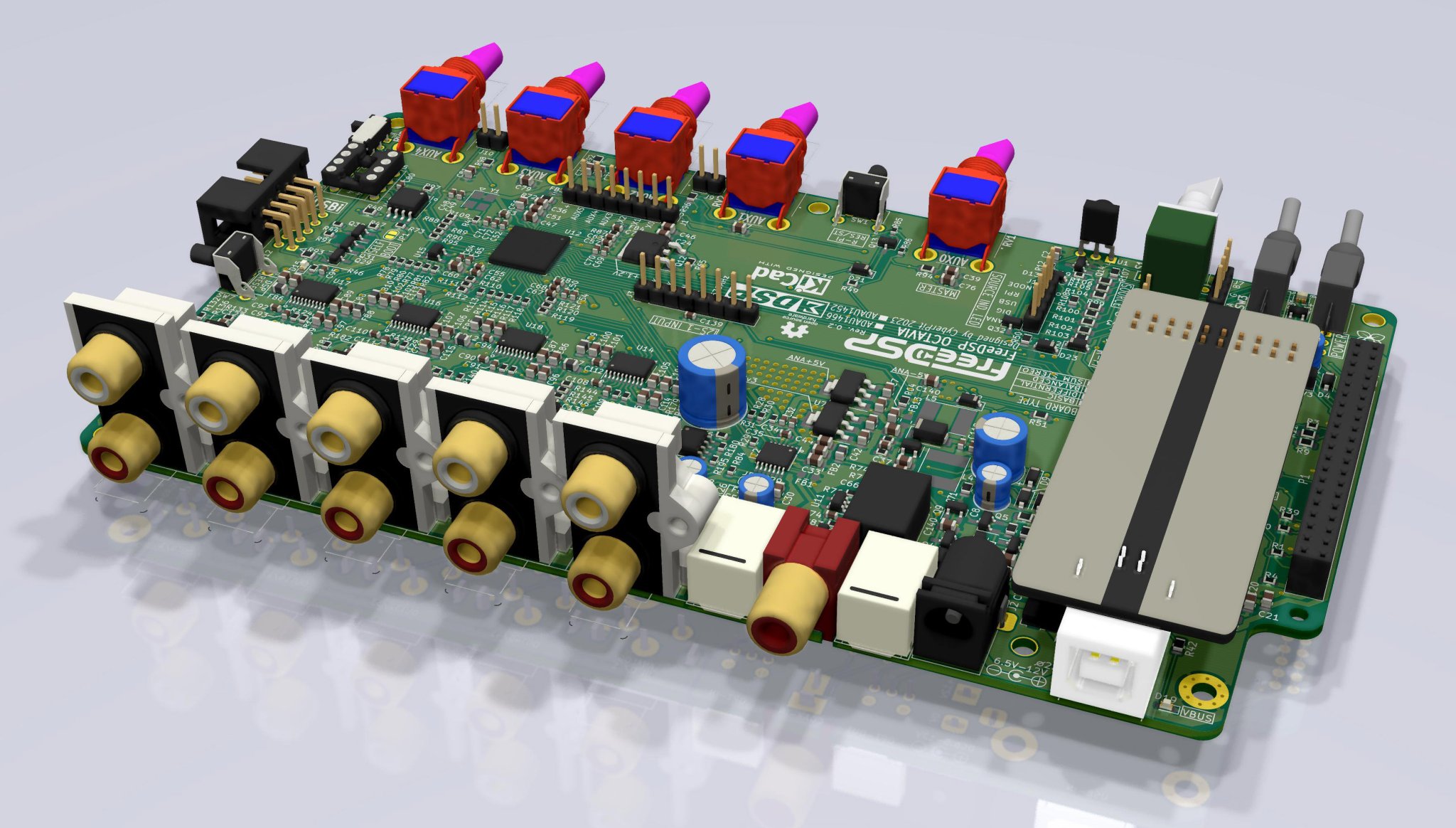

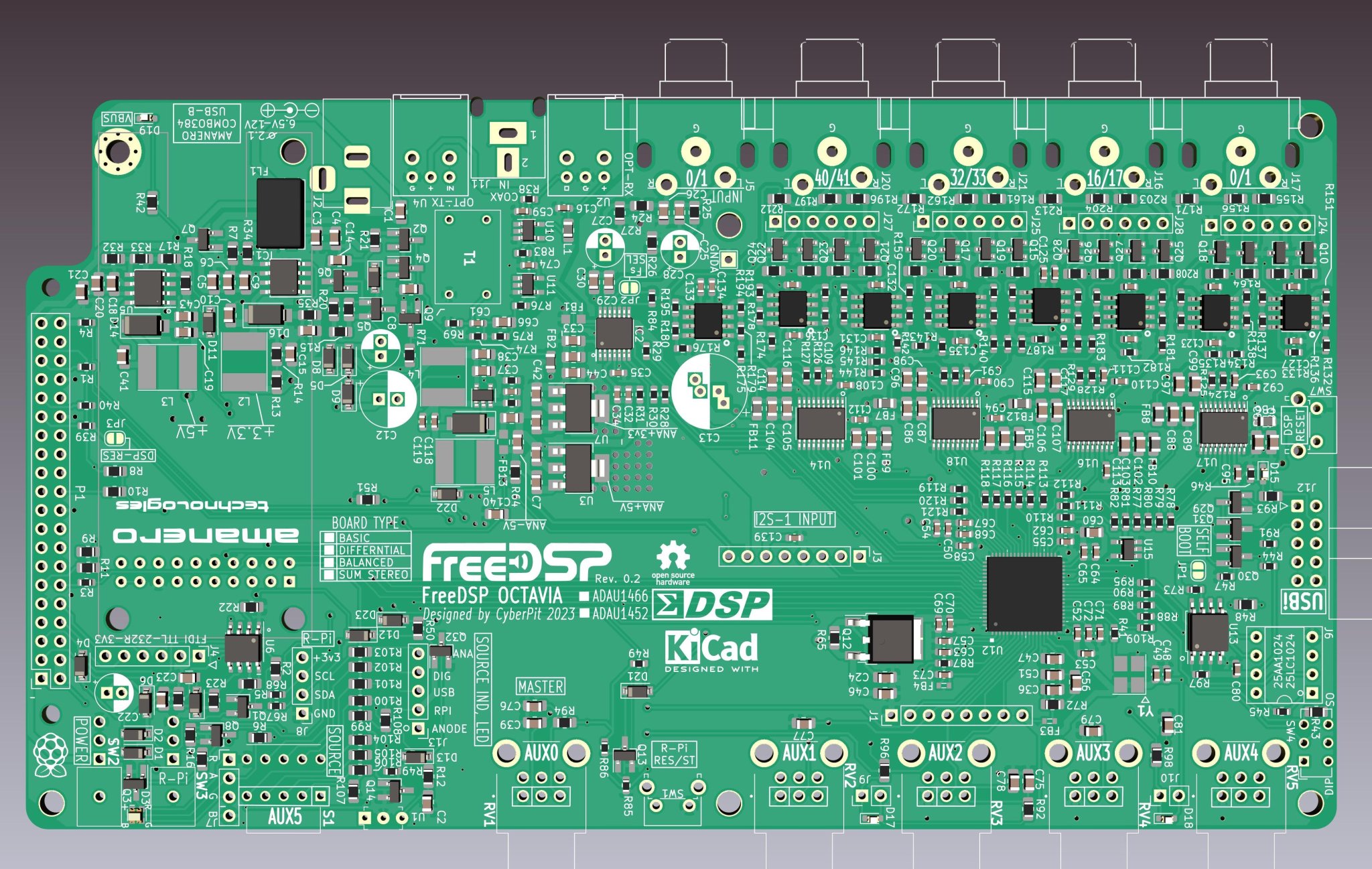

Hello Guys,
Today, I released the design of FreeDSP OCTAVIA version 0.2.
All the information and design data will be available following the Git-Hub page.
https://github.com/freeDSP/freeDSP-OCTAVIA
I tried to self-check my design many times, but If you noticed errors, please let me know the issues.
Enjoy DIY Activities!
CyberPit

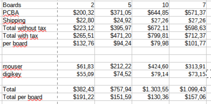

Hello,
Now here are some numbers for version 0.2.
So far 5 people are interested in a balanced board and 2 are interested in the unbalanced version, but they are fine with the balanced one as well.
So I calculated for different numbers of boards the prices:
Note1: The 7 boards is PCBA with 5 boards assambled and PCB with 2 boards assembled. Thats why it is more expensive per board as the 5 board version...
Note2: I shifted the componentes between mouser and digikey a bit to reach free shipping. Thats why some numbers seem wierd between different board numbers.
Note3: The price includes 5 stereo RCA jacks, 4 of them are not needed for the balanced version. Here the question is, if you still want them in case you want to change your board to a different version. I would handle this decission individually. So it gets cheaper by a few dollards if you want to leave them out.
Note4: There will be an additional shipping cost from me to you that depends on your country. If your are far away from Germany you might get cheaper if you find someone else in your are who is interested as shipping cost gets very high. If I remember correctly Germany to Australia was something like 40-50 EUR.
In the next days I will probably reach out to every one of you to check your individuals needs.
I will also calculate the price for 2 unbalanced boards, but for that I have to create a different BOM, so bear with me on this one...
Have a lovely end of the weekend or a good day if the weekend is already over 😉
Ludwig
