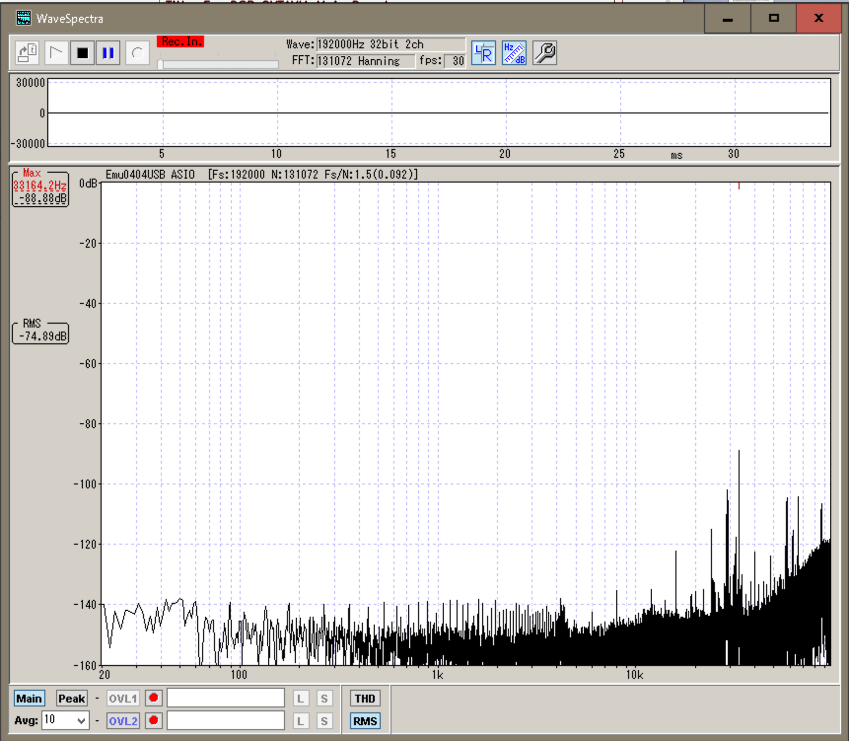

Selfboot is not ready, but the on-the-fly configuration is working...

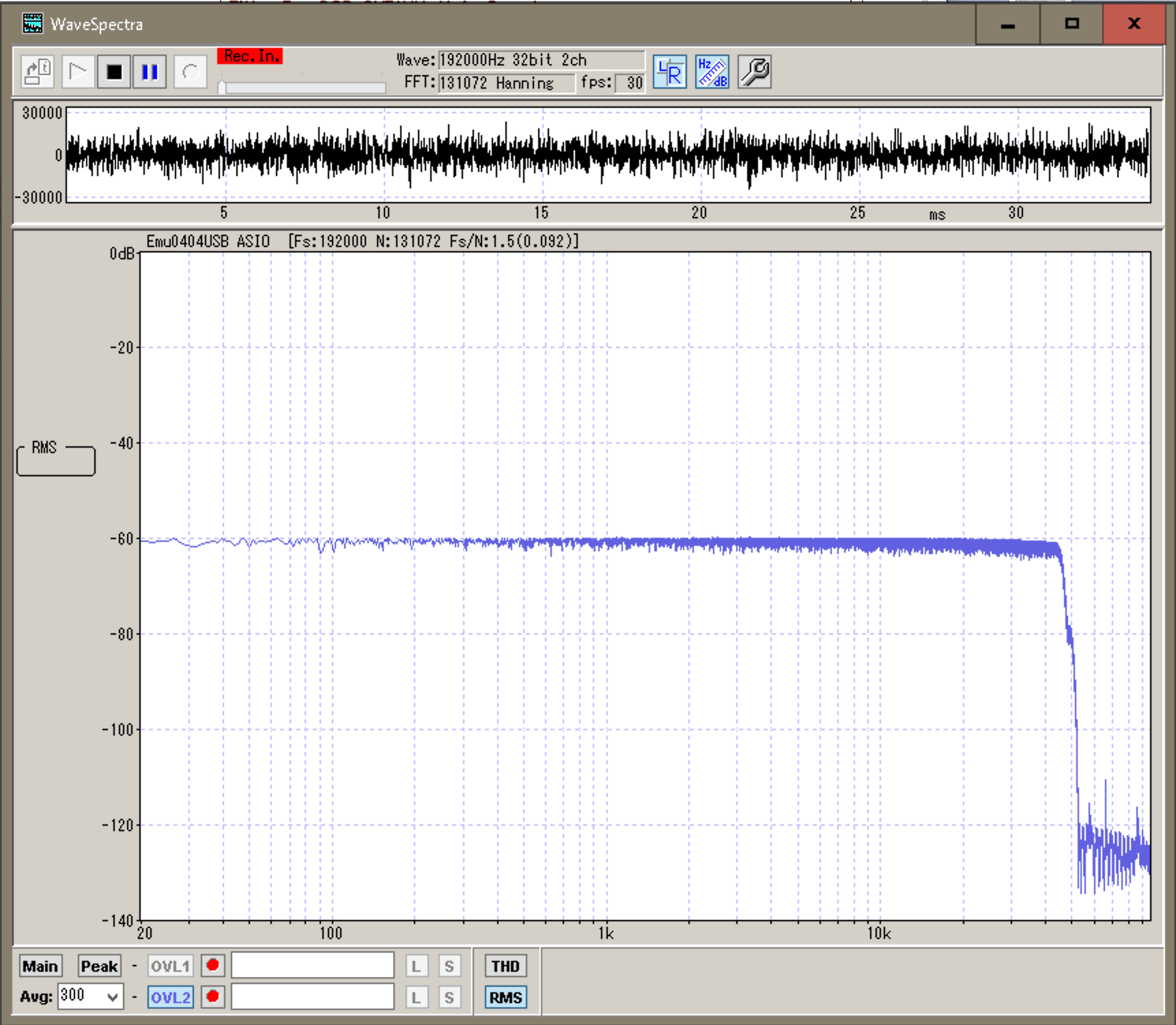

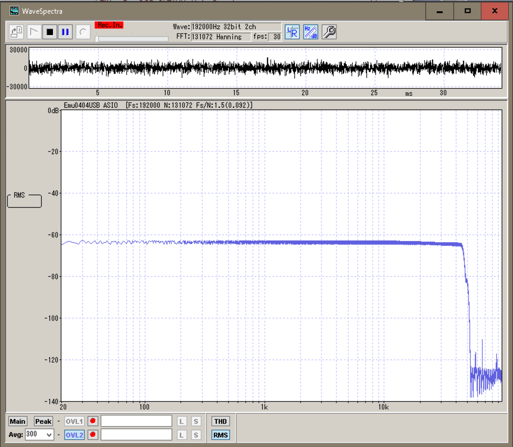

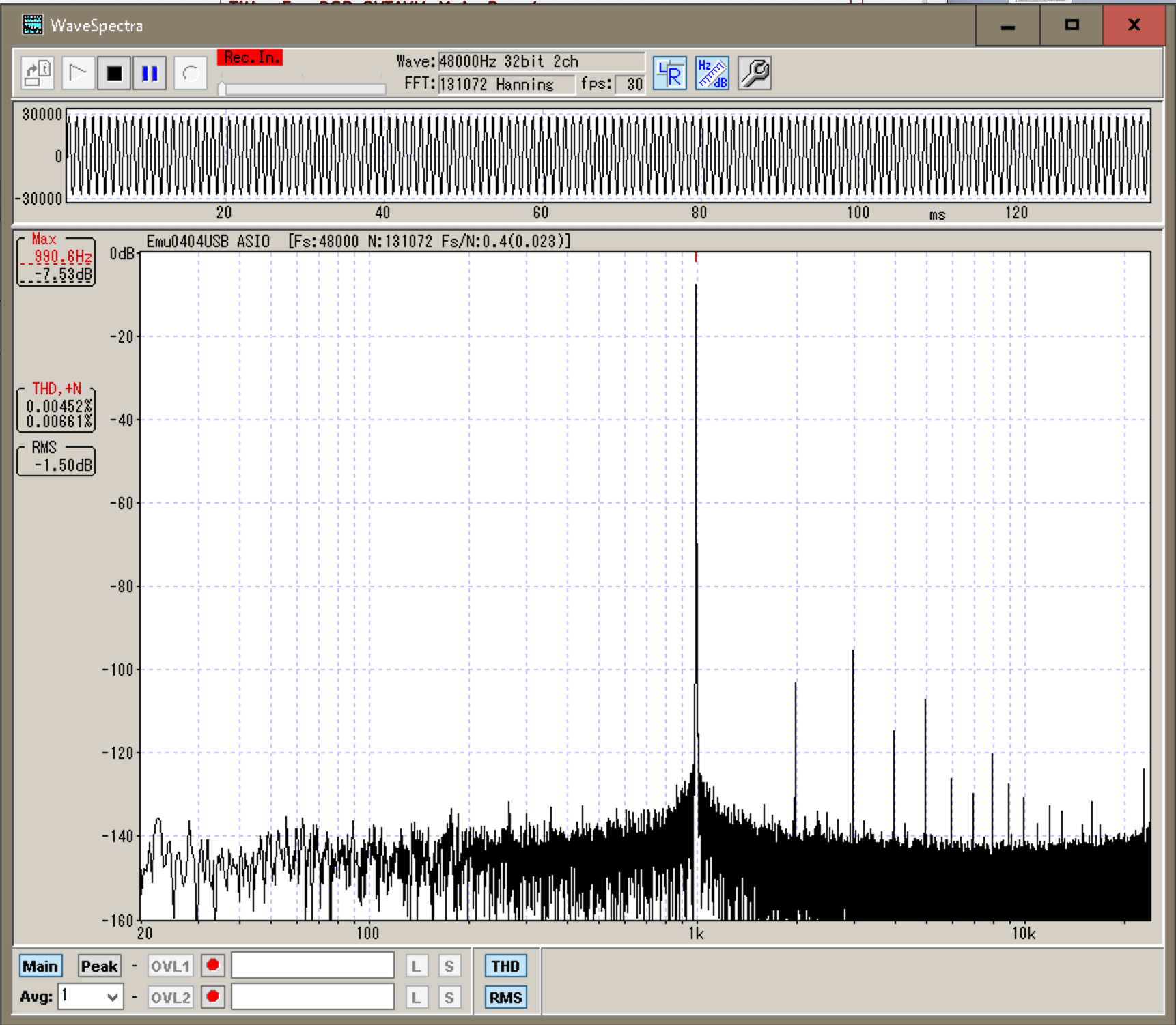

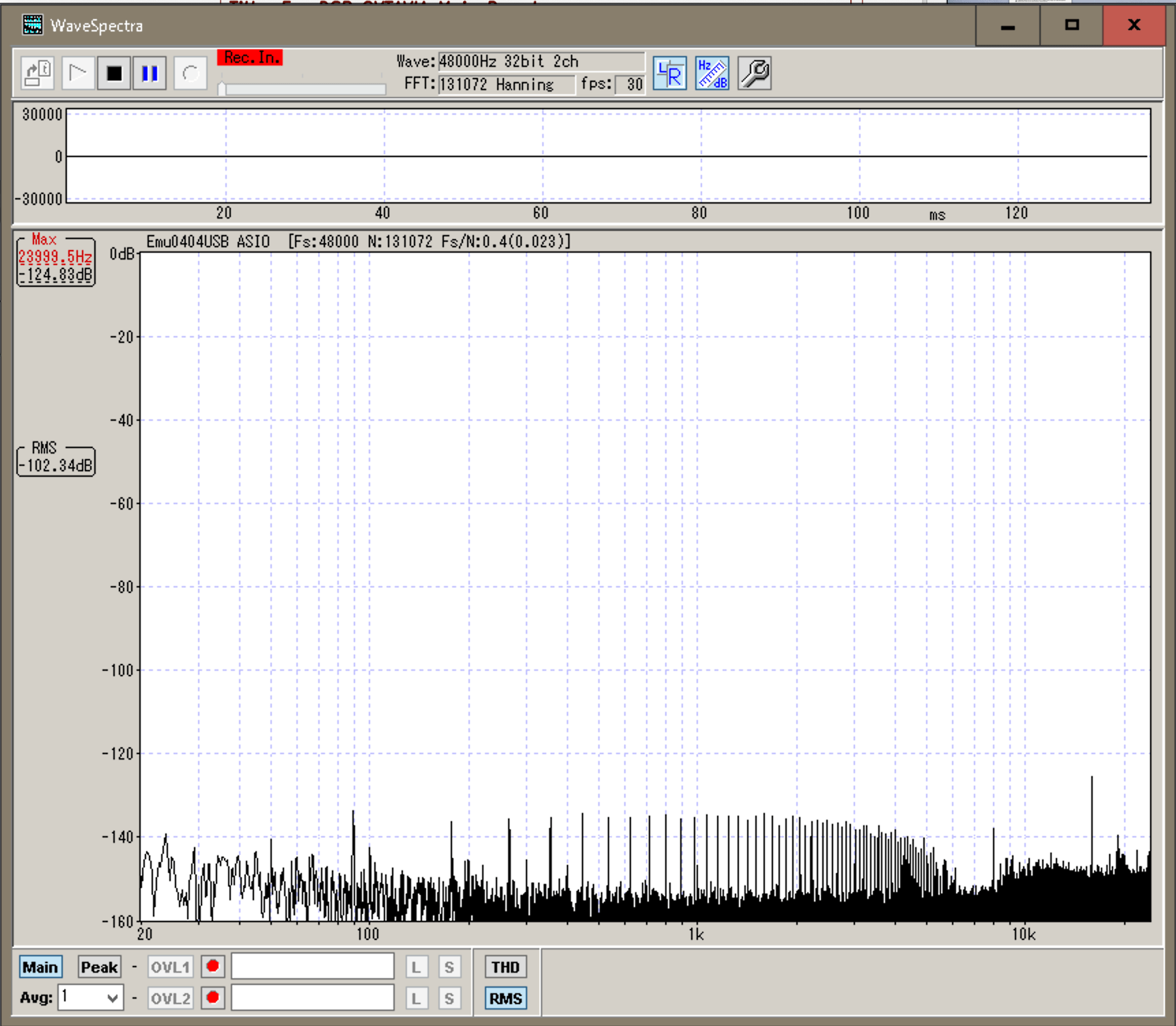

Quick check Result2: Raspberry-Pi to Output Channel 8 (DAC fs=96kHz)
The board was placed in the open space. Wall-power supply adaptor was used. So the shielding and GND line connection is not optimized yet.
Digital-Zero Remain Noise (BW 24kHz)
Digital-Zero Remain Noise (BW 96kHz)
Sampling-Rate 44.1k File Playback
Sampling-Rate 96k File Playback
Sampling-Rate 192k File Playback
44.1k 16bit SinWave Playback

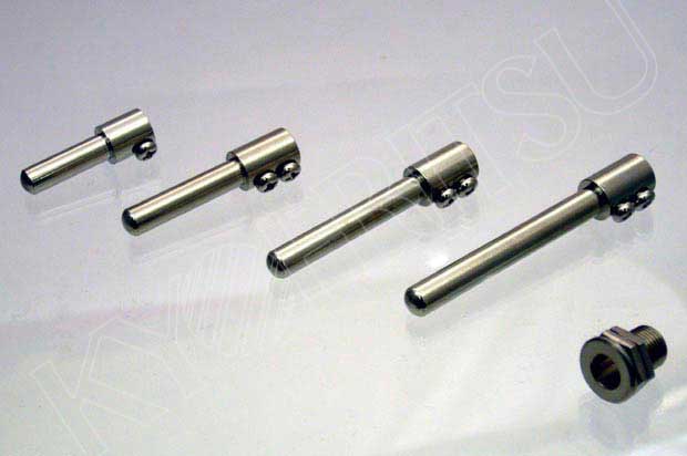

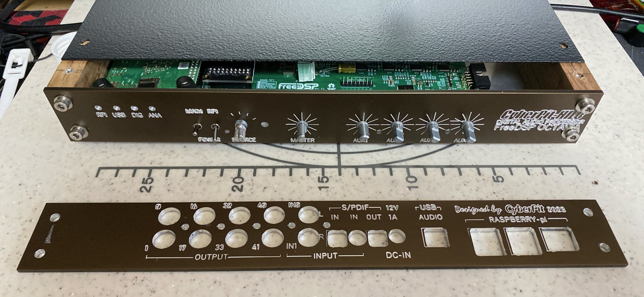

One thing came to my mind for all who want to integrate the PCB into a bigger case like an 19" rack case. Maybe one can have an additional assembly where there are pin headers (or some other kinf of connector) for the potentiometers/switches/encoders (basically all the things on one side of the PCB) to be able to connect wires and have them mounted onto the case.
@CyberPit Also I am happy to contribute to the project. So if there is a way I can support you, let me know.
Ludwig
Reactions: rrobot
Hello Ludwing-San,
It's my pleasure to involve the community. Many thanks who gave me comments, suggestions, requests, and cheers.
Well, I also think about the same thing. One idea for extending potentiometer shafts is something like this...
Another idea is to replace the onboard pots with 2.54mm pin header-pins or connectors.
Also, the toggle switches can be replaced with 2.54mm pitch header pins for wire connection. I guess extending LED light with optical fiber is not easy, so I would like to add extension header pin lands for the next version PCB design.

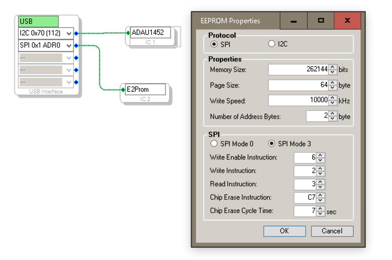

Today, I replaced SPI EEPROM with 25LC1024. But the result was not changed.
So I create a new SigmaStudio project again, then the EEPROM writing action works successfully.
I guess the project file had something wrong. The new file works great and the board can boot from the EEPROM!
I'll try M95256-RMN6TP later.
Anyway, now I can concentrate on developing the application. 🎉:cheers:
CyberPit
I would say this is the more flexible/versatile solution compared to extending the potentiometer shafts. 2x3 pin headers or box headers might already fit the footprint of the pots.
Sounds great.

Hello Pit.
Having header pins on the pcb should make the istallation very flexible i suppose.
Maurizio.
Thank you, everyone.
Today I established workarounds against all the issues.
https://github.com/freeDSP/freeDSP-OCTAVIA/wiki/Errata-and-Workarounds
All the input works as I expected. Other news was using 256kbit EEPROM M95256.
The EEPROM properties setting should be set as follows...
Now the board can boot from the onboard M95256 EEPROM.
I will commit the sample project files in a few days...

The milling takes more than 5 hours ... :radar:
Some errors occur. Anyway, now I'm ready for the final build...
