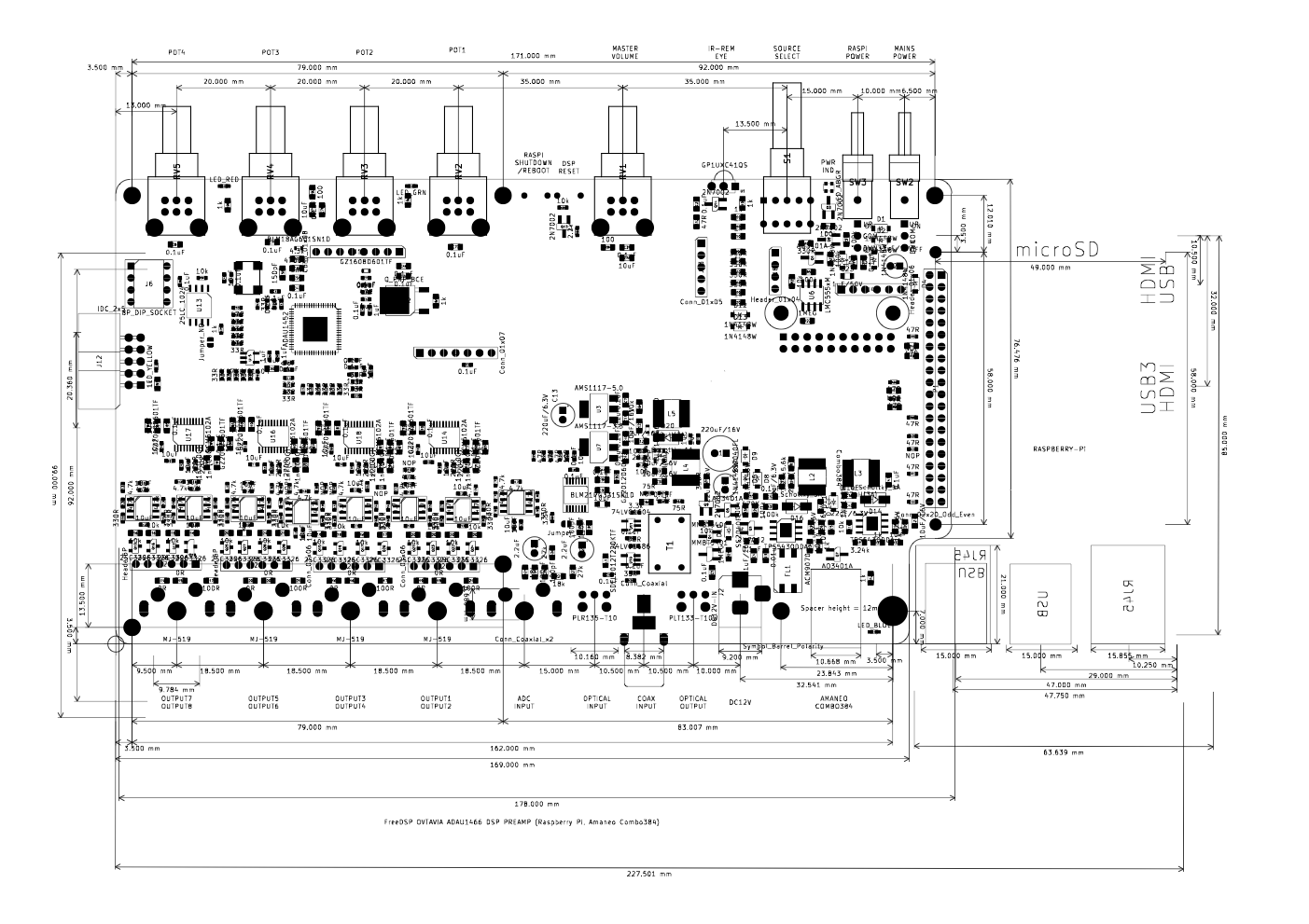

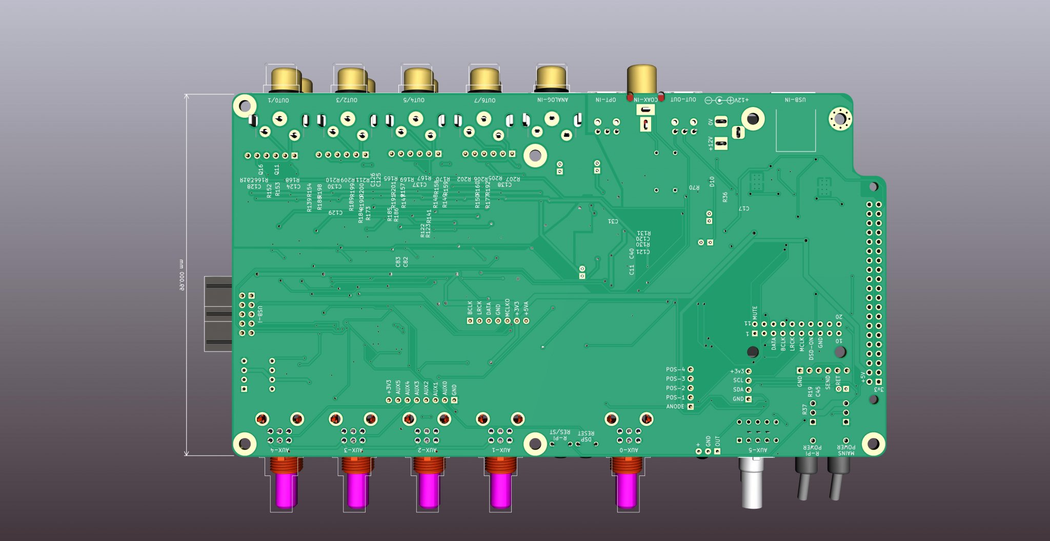

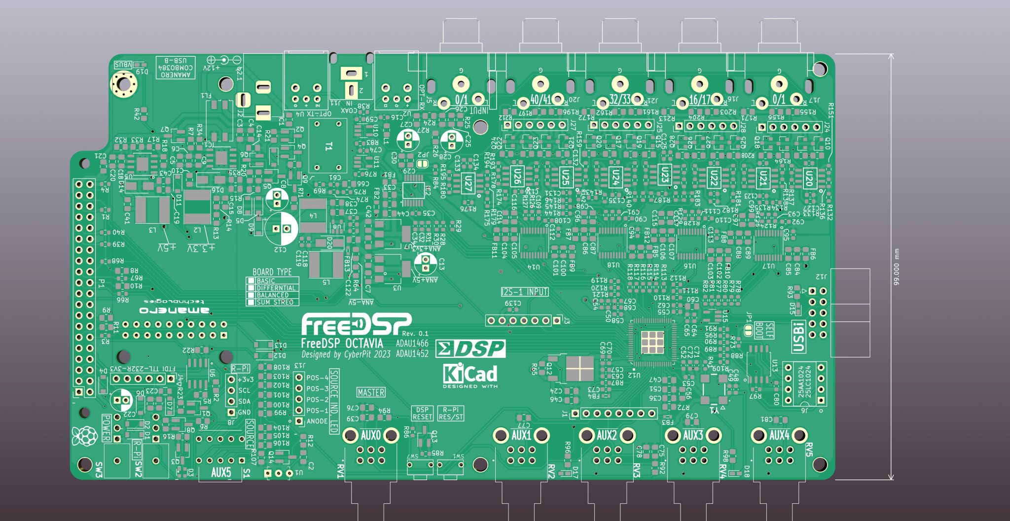

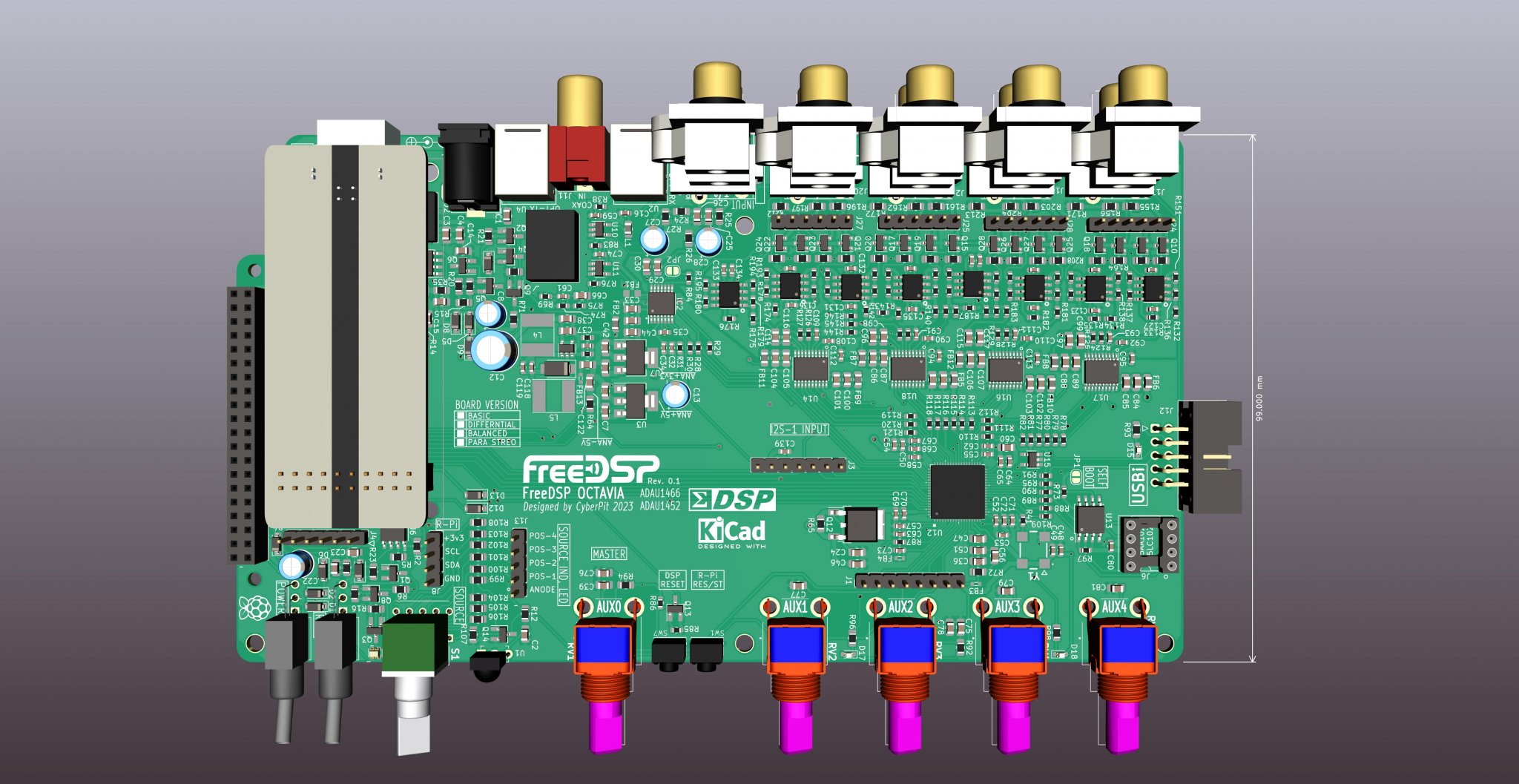

Now I complete the artwork of FreeDSP OCTAVIA version 0.1
Thanks, Subsonics-San, the reverse voltage protection feature had been implemented.
A very tight parts layout is needed, so we'd better use PCBA service when building this board.
The attached data will be committed to FreeDSP Git-Hub soon...
AES/EBU is pro - is this needed really. I'd say no. Board look impressive - congrats!

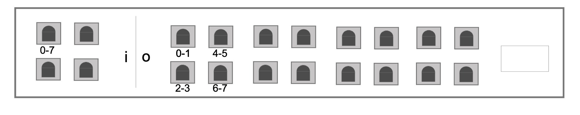

The pcb is 4 layers, right: signal, GND, VCC, Signal?

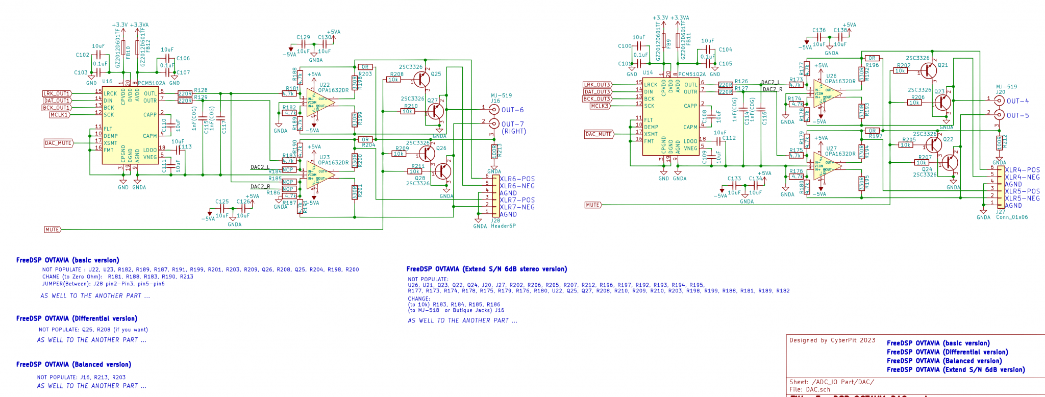

One question: I fully understand the need for the OPA1632 for balanced output, but they are not really needed for single line. Do you expect the buffering will have a positive performance improvement even though?
As for digital signals, I guess most optimal would be Dante ... routing whatever to wherever. At least for multi channel use. I'm designing towards my home theater and would have loved to be able to go from the processor all digital. JBL has introduced the SDP-58, which has Dante output, but it is so much out of my reach money wise 😉
This way you can skip one DAC - ADC step and you are also getting rid of all those input and output connectors, drivers etc. ... whish someone would make a cheaper alternative, as Dante is expensive all the way through ... but really smart 🙂
For going full active at the speaker, I guess you could have TOS-Link into both speakers (stereo into both) and then at the speaker chose if it the left or right channel with a small switch or something, telling the DSP which stream to use.

12+12 ch segmented bending wave corner line source project is interesting from the point of view Point-Source.
It does not need much effort to inherit the design ADAT to the I8S board from the freeDSPx-ADAT-IO-x4.
If you make a wishing thread for that project, Maybe I can support the hardware design.
Hi Baldin-San,
The board is designed in only two layers. So it's easy to order and build. (But quite hard work for design ...)
This board can use for four variations. Of course, single-end outputs are available as BASIC version.
Please have a look at the attached schematic part...

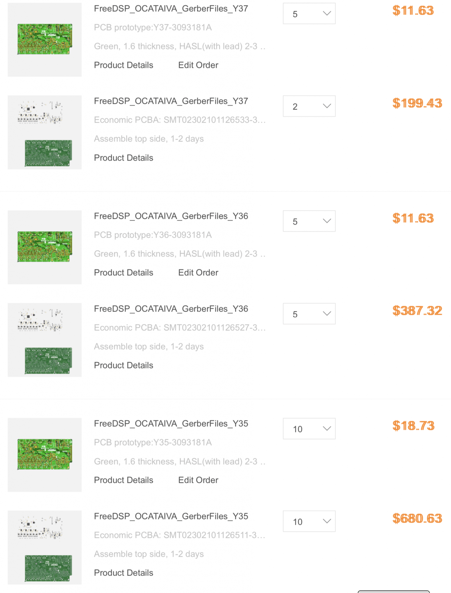

Hello Guys
I just estimated PCBA cost on JLPCB page. (SMT only, exclude hand mount parts)
I need to fix axis offsets some. But almost SMD devices are included.
2 of 5 boards' PCBA costs $211.06 (Shipping cost not included) --> $106 each
5 of 5 boards' PCBA costs $389.95 (Shipping cost not included) --> $80 each
10 of 10 boards' PCBA costs $699.36 (Shipping cost not included) -->$70 each
One-gate logic inverter and SPI-EEPROM were not in stock, so I estimated 32Kx8 devices instead of 25LC1024.
It's difficult to find SPI EEPROMs today, but I2C EEPROMs are not. So now I considering using I2C EEPROM for the ADAU1452 DSP self boot...
CyberPit
