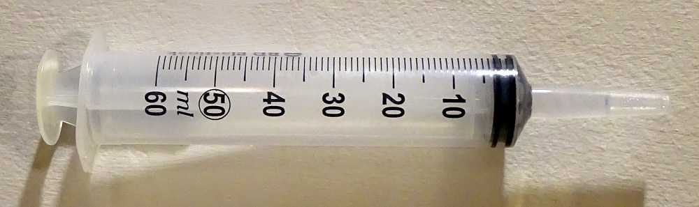

BTW, the Service manual will describe in details the use of this important instrument in TTT. During these hot days the daily water loss due evaporation is about 15 ml. One needs to keep the water level constant within 0.5 mm.
