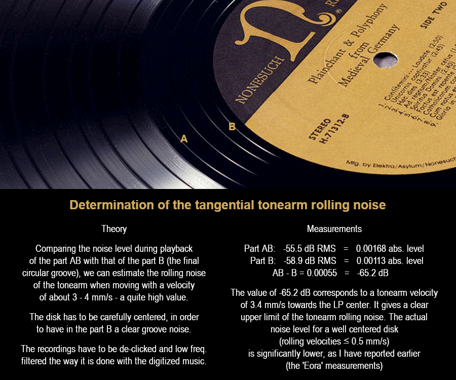

A measurement of the tonearm rolling noise.

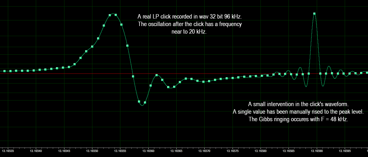

Even more oscillations:
What is called ‘tip mass resonance’, a mechanical resonance between stylus tip effective mass and vinyl compliance, occurs around 18kHz and peaks up treble sharply. In old cartridges this restored upper treble. In modern cartridges, notably Moving Coils, it makes for a bright sound overall and this can emphasize distortion from poorly recorded / cut or damaged LPs, and on inner grooves.
