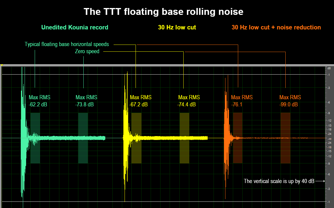

The Eora measuring installation
The installation could be named "Pendulum", but it looks more like a hanging swing, so I baptized it "Eora" - the ancient Greek word for swing. A 20 x 40 mm Plexiglass platform hangs on 4 thin (0.12 mm) threads from about 35 cm height. The TTT stylus lays on the platform with its normal tracking force of 2 p. When displaced from the equilibrium point, the tonearm system (with mass about 30 g) returns to the equilibrium with rapidly decaying oscillations. The return is recorded and the signal of the part with horizontal velocities ≤ 1 mm/s* is analyzed. The analysis refers to the original signal and those after 2 steps of my standard editing: the cut of very low frequencies and the noise reduction. In this case as "noise" I consider the signal when the tonearm is immovable.
The lower part of Eora is shown in Att.1 . A clip with a typical cartridge return to equilibrium is shown in the Google drive link .The waveforms and the results of their analysis are shown in Att.2 . The measured noise is quite low, so the signal is up by 40 dB, in order to be well visible. All the RMS values are unweighted.
It is clear that the floating tonearm movement noise is well below the groove noise levels, which are typically higher than -55 dB, therefore it is totally masked by the groove noise and removed after the music recording noise reduction.
* 1 mm/s are the maxima in the case of 0.3 mm record eccentricity. For a perfectly centered record the horizontal tonearm velocity is typically within 0.03 - 0.12 mm/s.
Eora 3.mp4 - Google Drive

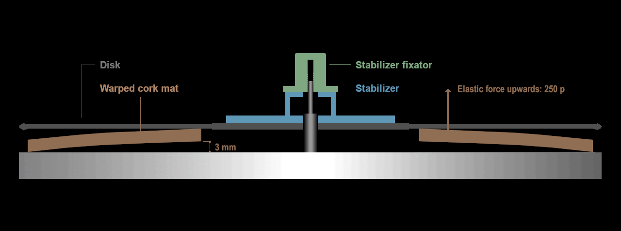

An warped elastic cork mat
After I glued a fabric layer to my cork mat, the result became slightly warped. The warp was 'uniform' - about 3 mm rise in the center hole. I was ready to try some way to fix it, but realized, that this form of mat may be beneficial for its better contact with the disk, after the use of the central stabilizer. This is due to the fact that the vertical force needed to overcome the mat warping is about 250 p and the pressure will be applied more uniformly across the 'mated' disk area. I use the mat this way. With the matt full down to the platter surface, naturally.

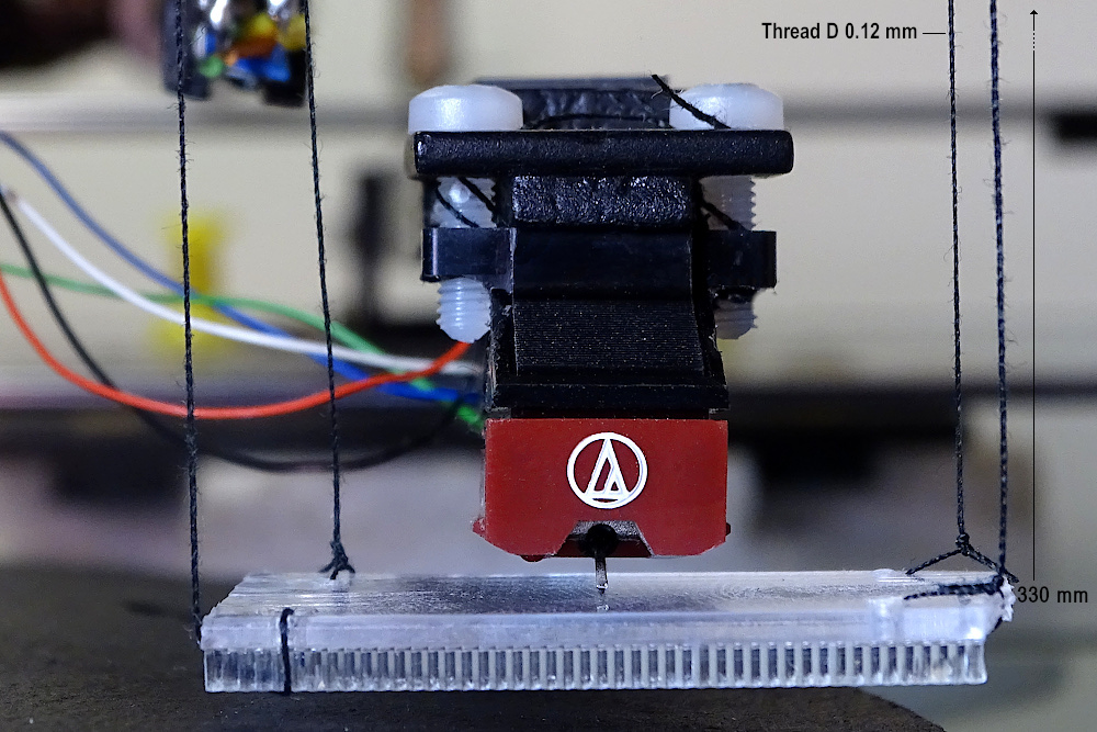

Eora pendulum 2
A quick analysis of the Eora oscillations decay (the last small movements in the video of my #173 post) indicates a tonearm horizontal friction force at the 1 mm/s velocity level well below 10 dyne. This is a nice and quite unexpected by me value, but I have to confirm and clarify it by building a better swing. The length will be 80 cm, so the pendulum period will become 1.8 sec (now it is 1.15 s), and also some weight (about 70 g) will be added, in order to have slower decay of the pendulum oscillations and better measuring possibilities. The enhanced mass will not change the friction force.
