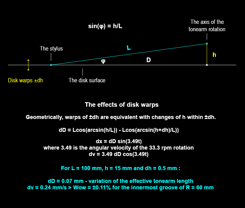

In the case of warped disks (and they all are, in one or another degree), the combination "short tonearm + high axis of tonearm rotation" (the second becomes a necessity if the tonearm is short) results in certain alterations of the effective tonearm length and a related sound "wow". In the scheme below I consider the most mild possible warp of ±0.5 mm - that with period of 1.8 s - one 33 1/3 LP revolution. In the real life, shorter periods and higher warp amplitudes are quite often.
The inner disk stabilizer helps somehow, but to really reduce the warps amplitudes one has to use both inner and outer (ring) stabilizer.

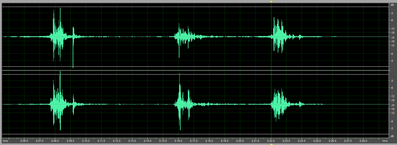

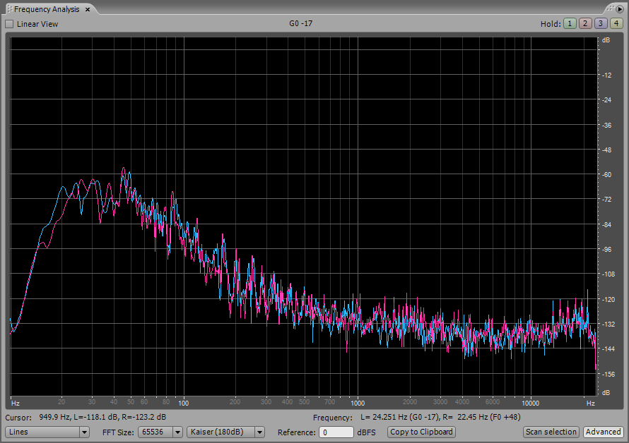

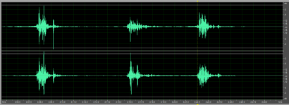

Well, ubergeeknz, thanks to your question I could make some interesting measurements.
First of all I started to apply some 'standardized' knocks to the system's basement and the most severe of them (with intensity never existing in practice) I could view some very slight water movements and measure their effect on the floating base (the 'boat'). But it was quite difficult to distinguish between the water movements and the turntable suspension oscillations. So I decided to go straight and measure the effects of water 'waves' directly introduced by actions on the water surface.
The tonearm arrangement is: the stylus down on an LP surface, the platter immobilized with respect to rotation. The stylus force = 2 p - the recommended for AT95EX. The effects are recorded in the usual manner (wav 48 kHz 32 bit) and edited following my standard procedure. The clip I supply contains 2 parts: the first one with the natural level of the recorded sound after 3 water activations (not audible) and a repetition of the same scene with the sound level up by +40 dB. The most important values:
Water surface amplitudes: maxima of 2 - 2.5 mm
Peaks of the recorded noise: -40 dB
Noise RMS maxima: -50 - -55 dB (for the three water movements. The second one 'knock' is not visible in the clip)
Decay rate of the noise: nearly -20 dB for 1 second
Typical noise frequencies: within 20 - 100 Hz
Noise level at 1 kHz: -66 dB with respect to the 50 Hz level.
Conclusion. The noise created by a severe disturbance of the water surface is practically not audible*. In the real life the "waves" of the aquarium water are nearly 2 orders of magnitude lower and the related noise - negligible.
* Let's have in mind the equal-loudness contours.
3 Waves Sound 0 dB +40 dB.mp4 - Google Drive
