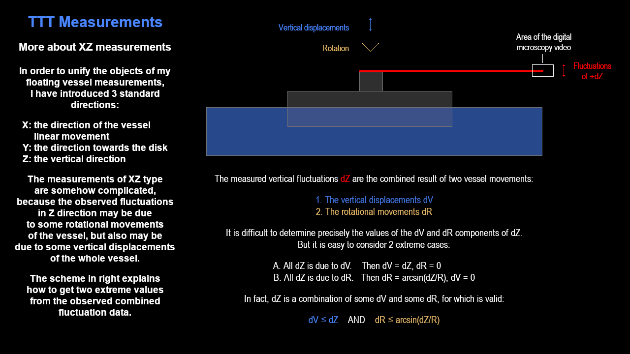

Later developments in the TTT project.
1. Magnet stabilizer. I have finalized the parameters of the adjustable magnet stabilizer. In "Stylus UP" position the distance between the magnet and the steel shaft is 4.8 mm and the attraction force - 4.3 p (pond, gram force). In "Stylus DOWN" position the distance magnet - shaft becomes 6.8 mm and magnetic force is reduced to 1.9 p. But now the stylus skating force is added, so the total attraction force is about 2.5 p. The static friction is about 20 dyn - a quite satisfactory value. It may be further reduced by changing the leading wheels bearings with new, of higher accuracy class and lower friction moment.

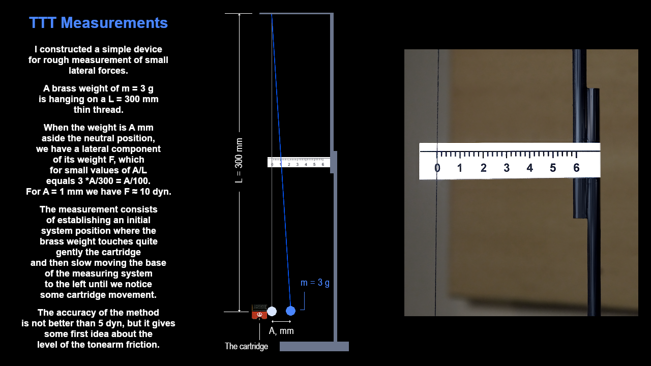

2. The method I use for rough determination of the friction force is shown in the attachment.
3. I have started a new series of measurements of the floating vessel displacements in various directions. In the first series I used intentionally an LP with higher eccentricity and vertical warps, in order to have an idea about the worst levels of the measured quantities. Now I use the procedure of eccentricity minimizing (with target of ±0.1 mm) and the internal disk stabilizer, to reduce the warps amplitude.
The results of the first measurement show variations of the vertical vessel position about ±25 microns and variations of the vessel's horizontality of the order of ±0.014 degrees - less than ±1 angular minute.

How scientific your method of measuring is very questionable. However, I assume they are all correct. So, your measurements are
Vertical movements=+/-0.03 mm
Lateral movements, dx=0.04 mm, dy=0.014 mm
In reality, all these movements on your arm base are combinations of these three. Your arm base moves in all directions. The magnitudes of your arm base movements are the same or larger than the size of the groove, and physical distance of 1 kHz signal, too. In reality, a lot of music information is above 1 kHz. So, the physical distances of signal cycles are getting very small. The movements of your arm base are much larger than the physical sizes of signal cycles.
Think about it. How possible to track groove accurately while its base moves in almost the same or larger magnitude and in all directions. Do a simple experiment. Try to put a stick into a small hole. If your hands are shaking constantly and in all directions, it will be difficult to put the stick into the hole. The vibrations from the cartridge are not effectively dampened by its base(bearing), so the stylus can’t track the groove correctly.

The skating force as known points toward the spindle, so it can not be added to the magnetic attraction force. Which force do you call skating force in this case?
The skating force is tangential to the groove in the point of contact with the stylus. What you name "skating force" is the lateral component of the actual skating force, which appears due to the offset angle of the cartridge with respect to the stylus rotation axis in the case of the classical pivoted tonearms. This component is partly compensated by the antiskating device, but the compensation can not be full, as long as it depends also on the level of the groove modulation.

You analysis neglect the fact that the main frequency of the observed vessel micro-movements is 0.555 Hz * - that of the 33.3 rpm rotation of the disk. They are very gentle and do not produce any audible artefacts. The tonearm does not 'ring' or 'jingle' in any audible frequencies and this is demonstrated by careful listening and waveform analysis of disk signals of sweeping frequency thorough the whole audible spectrum, but also with hundreds of hours of targeted listening to the sound.
* Due to this principal frequency, I would compare the 'problem' with that of a small length tangential tonearm, which axis of vertical rotation is necessarily well above the disk surface. Let's say a Clear Audio one. With a height of 15 mm above the disk and effective tonearm length of 100 mm, a disk warp of ±0.5 mm will cause a variation of the effective tonearm length of ±75 microns. A value much higher than the dY value observed in my TTT.
