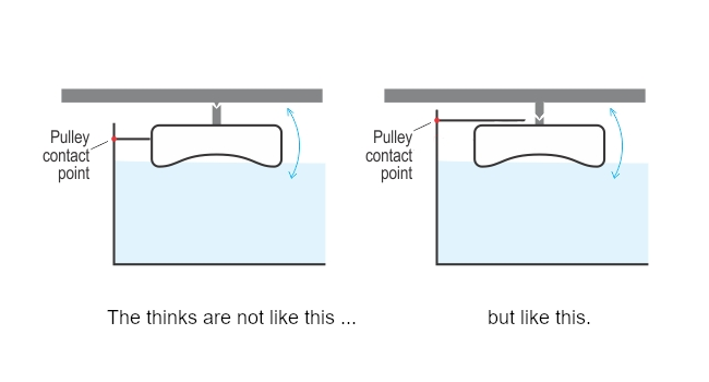

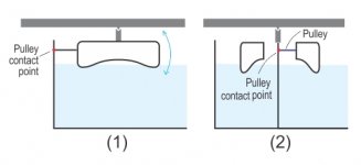

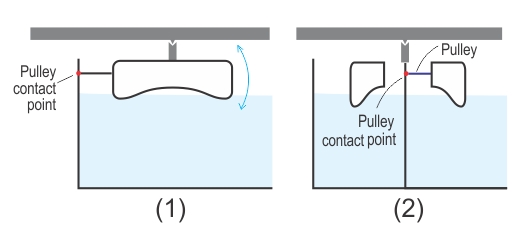

What I think is 'when' pulley engages with glass wall it makes contact point, which in vertical plane holds steady, so not to worry too much about boat movement on water.Why did you abandon the rails idea?
But if more refinement is required on stability (see first pic part with cyan arrows) we can move the pulley contact point near the 'Tonearm pivot' or if possible better still (if possible) just below the pivot (see second part of pic) this will make it rock steady I guess. as whatever miniscule movement of water+boat is will be hindered by that contact point.
Mind you these are just rough sketches, not to scale just to illustrate the concept. Necessary things like pulley point and stylus-record groove point at same level should be done.
regards

Thank you, Hiten. I will think on this catamaran variant (2). To be consistent with my thinking, note that in TTT the tonearm rotation axis is not as high, as in your pictures, but quite lower, at the level of the pulley. This complicates the things with variant (2)..

Yes. the movements were little amplified to illustrate the point.note that in TTT the tonearm rotation axis is not as high, as in your pictures, but quite lower
for posting pictures click 'go advanced' button. At second column in 'Additional option' below where you would be posting there is 'Manage attachment' button. click that and it will lead you to picture upload.

also in my newbie thoughts no need to have catamaran type of float too. to keep it simple at one side will also do. I guess.
