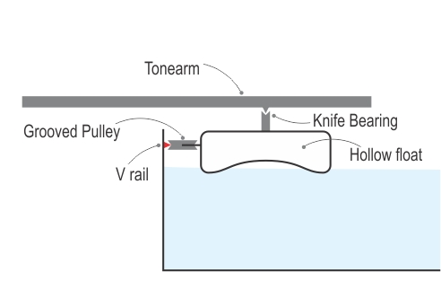

Solid Mechanical coupling of tonearm is always preferable.
But as others have said about water changing height of tonearm (probably by record warps) and friction of float moving across linearly see if following is worth any merit.
What I have done is put a v rail (Shown in red) acrosss the glass wall and v shaped pulley will slide on it. This makes a comfortably good coupling to restrict any movement vertically while tonearm moves across. The boat is curved below and is hollow so only edges touches the water thereby reducing friction. Will this improve the working ?

Joined 2019
Hi, Hiten. This type of boat directing in theory is better than the original one of the Ivanov, which I follow too. This may become true in practice if:
1. We have enough low noise of the contact rail - pulley. If both are metal, the noise will be (I think) higher than in the case plexiglass - glass. But a couple steel - Teflon could be quite silent. BTW, what are the conus angles of your rail and pulley?
2. We need also low friction of the pulley rotation. No matter what the bearings are, the friction acting to the boat will decrease with the increasing of the pulley diameter, so it is good to mount the pulley on the top of the boat and make its diameter as big as possible. In my case D = 40 mm. This will reduce also the length of the tonearm, which is a desirable issue.
I think that it is fine to experiment with boat profiles to lower the friction boat - water. We must remember that this friction has to be low in the direction of the principal boat movement, but in the other 2 directions - front-back and up-down higher values may be preferable. I like your catamaran idea, it is likely that it conforms with the goal described in the previous sentence. But, once again, I have to assure you that even the most 'trivial' boat profiles have boat-water friction levels of about 1 dyne, which is a VERY low value. The main friction problems arise from the pulleys.

I understand. Please dont take my picture literally for Conus angle and pulley position etc. This was just rough idea drawing. I am just thinking about if your design can have option/mods/improvements. The V rail just holds the pulley so as there is no vertical movement. If idea is worth exploring the position etc. can be arranged. Also I read somewhere there are coatings available which repels water I wonder if it can be used in curved bottom surface.
Regards.
