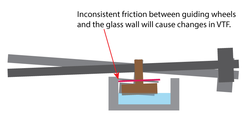

Sorry, I don't mean to be a party crasher. But the deeper I dig, the more problems I find with the arm.
Another problem with the arm is its various VTF. Inconsistent friction between guiding wheels and the glass wall will cause changes in VTF. Please see the image.

I posted detailed answers to your previous "problems" and I did not get any reply on them. You use the word "another" as if your previous "problems" are still unanswered!

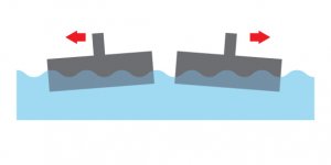

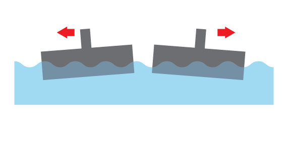

When a bass transient comes along, how does water react , does it not vibrate and move your platform ?
You might not see it, but it’s there.
Low frequency waves are moving your water platform unlike a rigid fixed mount gimbal or similar low friction arm bearing that has a mass resistance coupled to the moving platter center that will not move. You just made it easy to vary that relationship
I get it that it makes a sound, but an unstable pivot point in constant flux is not a bonus feature. The wheels don’t make it rigid with water underneath, Sshh !

When a bass transient comes along, how does water react , does it not vibrate and move your platform ? You might not see it, but it’s there.
1. The water will vibrate slightly, this way absorbing part of the tonearm's vibration and sending less of the bass burst back to the cartridge.
2. I surely will not see it, but maybe I will also not HEAR it? And if so, where is the problem?
3. I think that this Holy Dogma of the tonearm basis rigid with respect to the disk center has to be considered in the sense of it's AIM. Why rigid? Because {something A related to the reproduction quality} and {something B related to the reproduction quality} etc. If a non-rigid design satisfies A, B etc., then I see no reason to stick to the Dogma.
4. Is the Dogma violated in the case of unipivot tonearm? Is it in the case of the Maglev turntable? Is a 50 microns tolerance in a air bearing tonearm OK with the Dogma?
5. Considering the water, we must not forget it's surface tension property, which damps vibrations quite effectively.
