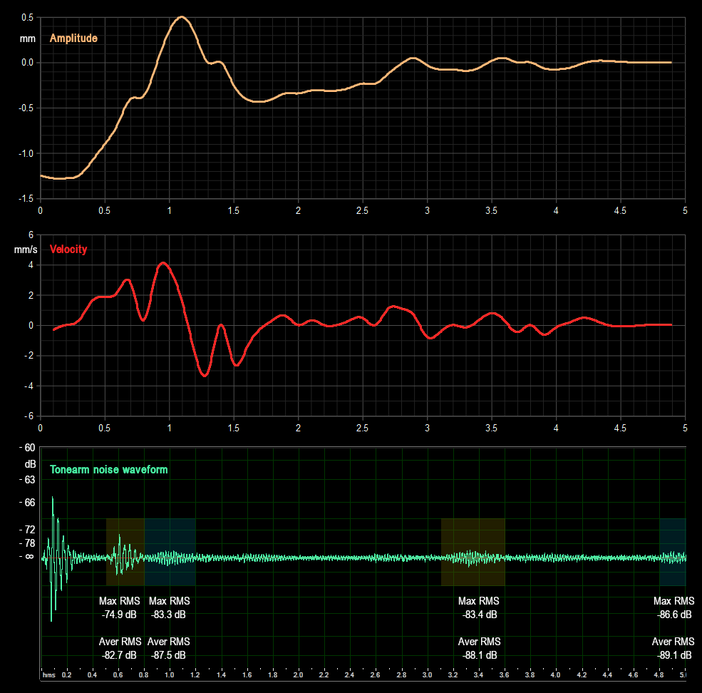

The Eora 3 measuring installation
The new swing has the same length of 33 cm, but 43 g are added to the swing base, so that the total moving mass rises to 75 g. This results in longer durations of the visible decaying oscillations. The friction force is not affected by the rise of the mass. The video is now taken with my digital microscope camera and allows higher measuring precision, of the order of 0.03 mm. I include a link to the microscope video. Another new feature is the parallel video and audio recording, so that the tonearm movements and the related noise can be viewed in the same time scale.
This audio-video comparison is shown in Att.1. We see the alterations of the tonearm horizontal position, that of the tonearm horizontal velocity and the noise waveform in the same time scale 0 - 5 sec. The horizontal velocity view allows to select a velocity region for the noise level measurements, while the horizontal position view allows a rough evaluation of the decay constant and hence - the evaluation of the friction coefficient.
All the noise levels in Att.1. refer to my own "reference level" - that of the highest peaks I observe in my LP recordings. Expressed in cm/s value, my "0 dB" corresponds to about 20 cm/s or 4 x the reference 5 cm/s level. So, to compare my values with some others, based on 5 cm/s 0 dB level, one has to increase them by 12 dB.
Given the above clarifications, I measure in the 'typical' 1 mm/s velocity level tonearm noise maxima of -83 dB in my reference scale and -71 dB in the "0 - 5 cm/s" scale.
All the RMS values are unweighted. If I weight them according to ITU-R 468, the noise values approach -100 dB "PK" or -88 dB "5 cm/s".

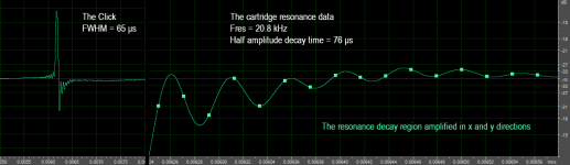

The "Good Clicks" Measurements
A click is "good" when it is very short and moderately high. These clicks are quite close in form to a very short single triangular pulse. They are also "good" from the Clicks Removal point of view: they are easily recognizable and reparable with a very low rate of false detection. Contrary to the "pops", which are a sort of very bad clicks by all means.
I selected a click of nearly 100 μs duration, with FWHM = 65 μs. The decay of the oscillations following this click provides us with information about:
1. The high frequency resonance of the cartridge.
2. The decay rate of this resonance.
The data are presented in the attachment. They refer to AT95EX cartridge in my TTT tonearm playing a normal quality LP.

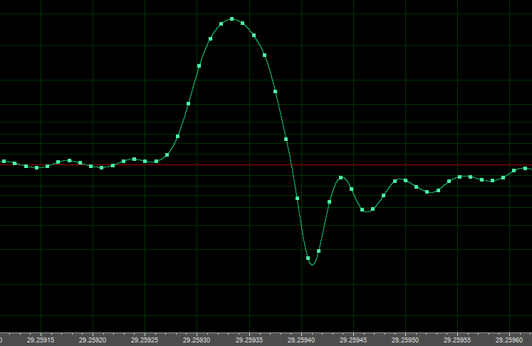

How does the cartridge know to resonate before the click?
Joined 2019
The cartridge can not know, so it is something else.. Let me guess.. Aha! This is a way of Adobe Audition presentation..? Let me try an artificial click, a DIY one. No cartridge. And still, something before and after the peak … With the quantization frequency / 2 (Att.1).
In my click there is a strong asymmetry, so I believe that part of the right side oscillations 'describe' some decaying resonance. The frequency there is NOT the quantization one / 2 = 24 kHz.
An example of an actual click with a very weak "cartridge prediction" is given in Att.2. Here the recording quantization is 96 kHz.

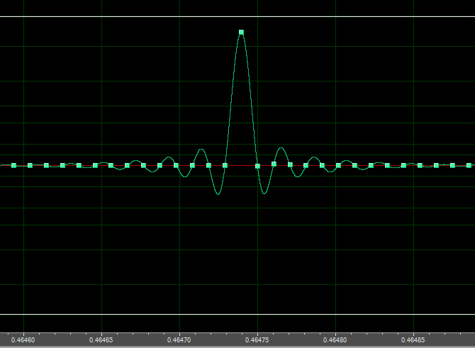

Dr. Kritidis, the left picture above appears to be the impulse response of a digital filter somewhere in the processing chain.
Joined 2019
This is the way Adobe Audition presents a single quantum peak. No processing. Only 2 steps:
1. Generate silence.
2. Change (by hand) a single value from abs. 0 to something near 0 dB.
Joined 2019
No processing.
I meant "no processing by my side". Clearly the way Adobe Audition presents the waveform in high time amplification.
Audition displays a virtual sinc reconstruction of the waveform. The Gibbs effect "ringing" is what you see.

I keep silence expecting some continuation. Because in my #192 I wrote about after-clicks ringing with frequency different from Fquant/2. In Attechment 2 - a really recorded click - the ringing F is close to 20 kHz - much lower than the 48 kHz of my "model click" in Attechment 1.
