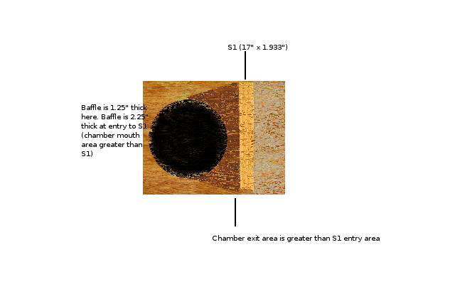

If I make the compression chamber similar to my crude drawing below will that work as well as mounting the driver offset (OD)?
attachment.php
It seems like it should be the same type of result as an OD mounted driver firing into a narrow S1/S2 area, since the driver cone is almost perpendicular to the path in both of these examples.
In this arrangement the driver would still be firing against the baffle wall opposite the cone (at a small gradually expanding angle), but note that between the cone and S1, the baffle material is cut away at angles allowing a compression chamber. A constriction exists at S1 since the compression chamber mouth area is greater than the area of S1. Some S1 attachment flexibility is allowed this way as the driver/chamber assembly can be folded back into the cabinet quite a bit.
Does this work as well as mounting OD? It doesn't violate the integrity of S1 being the beginning of the horn path, right?

I have no idea at all what's going on from either the picture or the description. All I can gain from this post is that you've set it up a lot more complicated than it needs to be.
If what you are trying to do is make a narrow throat chamber connected to a narrow S1, and have the driver firing into the side of the narrow throat chamber, then the throat chamber is actually part of the path length and should still be simulated as Od for a couple of reasons. First, to get the horn path length right and second, to accurately reflect the fact that the driver is not actually at the end of the line, so it will cause a massive dip caused by the wave bouncing off the closed end of the path and recombining with the main wave on the way out.
Usually we draw horn plans with a top down view of the side profile. Then you can see everything. Your picture doesn't have any details like where the closed end of the horn path is and it looks like S1 is a block of wood at 90 degrees to the beginning of the path.
Please redraw it with a top down view of the side profile so we can actually see what's going on, and it would help if you rough in at least part of the rest of the horn. It doesn't have to be to scale and it can be done is MS Paint or other similar crappy drawing but it will show a lot better what the actual layout is.
Maybe your picture and description is enough for GM to understand what's going on, I haven't got a clue.
DSL's DTS20 is fundamentally the same except a higher CR with a much deeper filter chamber if I understand his drawing/description, but a top section view would definitely help and in my usual haste these days, forgot to ask.

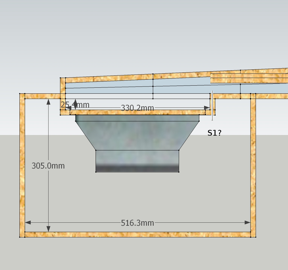

After rereading this several times I'm almost 100 percent sure that what you have here is an offset driver layout, but you are attempting to use the chamber as the first segment so it can be looked at as end loaded. This is bad for two reasons as previously stated, the chamber in this case would actually be the first segment in the horn flare and the sim wouldn't include the closed end reflection dip. There's nothing wrong with laying it out like this but simulating it as Nd is not the right way to do it. And you will probably find that the constriction at "S1" (which should actually be S2 in the sim) is going to waste a lot of cab space.
I've redrawn what I think you are trying to show from the top down side profile view. This has the constriction at where you had S1 and shows a bit more of the path, showing that the constriction will require an actual board and might be wasted space as a result depending on how the rest of the horn is laid out.
What I've drawn here SHOULD be simulated as offset with S1 being the closed end for the reasons previously stated. Then the chamber would be defined as the 1st segment, between S1 and S2. It will sim much more accurately if you sim it like that.
It seems to me that you are desperately trying to fold this and keep it Nd but if my pic is accurate this is not Nd, it's OD. And there's nothing wrong with OD, but it should be simulated as OD so the sim accurately reflects the actual path length and the enormous boundary cancellation dip caused by the end wall.
I found this image on another forum and I modified it. I labelled S1 at the constriction. This is not exactly as I drew earlier but is similar enough to be the same.
Edit: Aye... we were both posting at the same time.
Yeah, this is offset. S1 is the closed end and the constriction is S2. The chamber is the segment between S1 and S2.
If you sim this Nd it will sim wrong. It has to be simulated as OD if you want an accurate sim.
Here's the difference between Nd and OD. The closed end causes a huge notch because the wave is bouncing off the closed end. The distance between the driver center and the closed end determine where in frequency the notch will end up. If you keep the driver very close to the closed end the notch will be fairly high in frequency.
This random sim shows the exact same sim run as Nd and OD. The OD sim has a huge notch, the Nd sim does not. The OD sim is the accurate one when laid out as per the pic you showed. In this sim the notch is pretty high in frequency and doesn't affect your passband but it's still best practice to sim accurately.
It is possible to get the path length right for the chamber (if you do it right and sim it as a very long and narrow chamber) and sim it Nd but the sim won't show the huge notch that all OD drivers have so the sim won't be accurate.
Also the pic you posted shows pretty clearly what I said about the constriction leading to a lot of wasted space in the cab.
