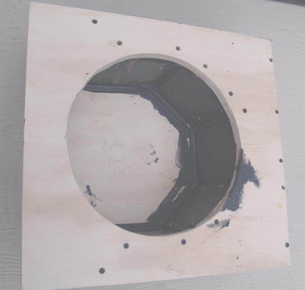

I was thinking a rear closed chamber to help offset some of the loading on the cone and to help control excursion.
The title of this thread is fitting. This is my first experience in DIY audio. I lack understanding of some of the basics. I am a dummy. Yet I am building my own FLH horn somehow. These are facts.
I understand that the throat adaptor attaches to the beginning of the horn path. S1 is the beginning of the horn path. S1 is 212 sq cm. Physically S1 will be a 15-17 inches slot depending on the necessary size of the cabinet.
I had an idea how to make the throat adaptor but being dumb I didn't know how important it is to calculate it accurately. Now I know even less than before. Initial bliss has now deserted my ignorance! Back to the books...

Understood, my point is more than 95% of the power delivered to the speaker turns into heat in the voice coil, which is absorbed by the magnet structure and (possibly) vented out the back of the magnet structure. Locating the magnet structure outside the compression chamber allows the heat to go to the outside air, rather than heating up the compression chamber.I was thinking a rear closed chamber to help offset some of the loading on the cone and to help control excursion.
A smaller compression chamber can keep excursion under control, but has less heat radiating surface.
The tricky part with reverse mounting the speaker is keeping the throat chamber volume small, otherwise the bandpass rolloff may be too low, and sensitivity will suffer. Better if the response extends at least a half octave or more above the crossover point.

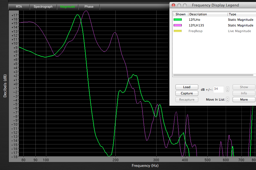

The measurement below illustrates how much change reducing the ATC had on the rear mounted example I posted previously, green trace was open, purple with the volume reducer pieces added.

Ahh, yes I get it now. You are right weltersys, I had not included the concave volume of the cone so my depiction is of a flat piston only. I included the volume within the baffle cutout only. Big mistake.

Well, I simmed some random volumes and it looks to me like a lower volume compression chamber than what I began with will allow some more improvement in the response. It looks like sensitivity may possibly increase if I do it well, so I have high hopes for that. Now I understand why most FLH are built as OD!! Makes your explanation of them crystal clear, just a guy.
When I get around to redesigning the chamber I'll try to tune the response a little better too. In every sim I have tried the driver has been very resistant to being nudged any lower than a 22 Hz knee, so I'm going to back off on my persistent nudging. I'll accept that 22 Hz knee with no complaint if I can get it relatively flat to LPF. Such are the realities with my old school high Qts stiff compliance car audio driver.

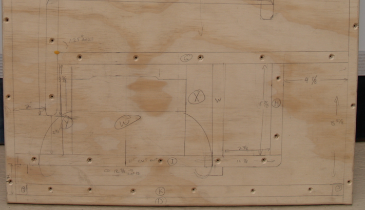

Alright I hit a couple bumps. A couple questions if I may?
Assuming a cabinet of 18 inches...
I calculated chamber volumes for driver cone volume, plus a 1 inch thick x 11 inches diameter baffle cutout. To that baffle I added a (212 sq cm entry to S1) 17 inches x 1.933 inches x .5 inch slot port volume of a throat adapter. That yields a total of 3394.4 cc, which I entered into the "Vtc" field in Hornresp.
My question is; what is the "Atc" field for, or what is the Atc calculated from? Hornresp says it is "Throat chamber average cross-sectional area normal to axis (sq cm)". Can anyone explain Atc to me in dummy language?
Also need your expertise and judgement concerning throat adapter types. I am thinking about a slot port as explained above. But a narrow slot port leaves most of the driver cone covered with a flat barrier. It seems to me like this could be a bad thing to do, since sound waves have such small area to radiate from, and escape from the cone is largely blocked. Is this slot idea as dumb as it feels?
Very simple. Vtc is the volume of the throat chamber in cubic cm. Atc is the cross sectional are of the throat chamber in sq cm. The last dimension is length, which you don't have to input. So Vtc / Atc = chamber length. Or chamber length x Atc = Vtc.
The throat chamber can only be square or rectangular in the Hornresp inputs so it's a simple volume calculation. The throat adapter doesn't have to be square or rectangular but the throat chamber does so the Vtc and Atc boxes are sufficient to describe it's volume.
Thanks,
This is EXACTLY why most flhs are laid out as offset, not end loaded. I told you it can be a PITA to fold an end loaded flh and this is EXACTLY why.
So, if you insist on doing end loaded for no other reason than that's what you want to do there are a couple of ways to make this work.
1. Make it a symmetrical layout as shown in the picture I posted. This will require more material which will make the cab slightly more heavy and slightly larger but it's easy to do end loaded in a symmetrical layout as shown.
2. Change the aspect ratio of the throat. This requires folding in three dimensions instead of two. It's possible but a lot more difficult and will likely result in wasted space in the cab. Just make the aspect ratio of the throat chamber physically square in your fold instead of a high aspect ratio slot.
3. Make a very large throat adapter that starts with a large CSA at the driver end and transitions to a small CSA at the S1 end. That's exactly how they did it in the image you posted.
4. Block most of the driver as you just described here. It's actually not a big deal, you can check pressure and velocity through the slot hole (and compare to an unblocked driver). It should be fine. It's going to be fairly unique as it's not normally done that way but it can work. The bigger problem is how to lay it out in the fold. If S1 is in the middle of the driver it's going to leave space on either side of the driver so unless you have multiple folds running along both sides of the driver there's going to be wasted space in the cab on one side of the driver.
