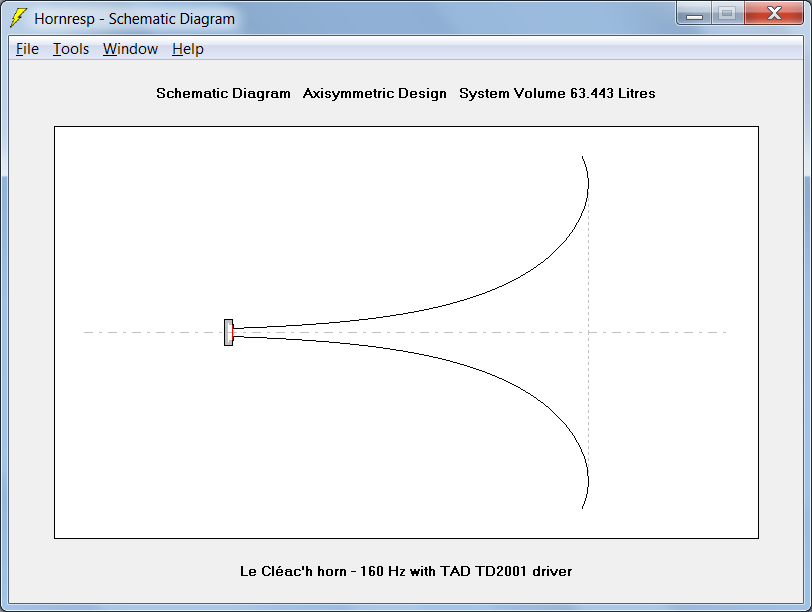

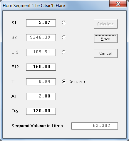

Hi just a guy,
Sometimes a user may wish to specify an axisymmetric horn with a particular throat entry angle to match a given compression driver, and / or specify a particular mouth exit angle. Also, Fta values along the length of the horn can be used set the tapers on individual wooden "slices" glued together in some designs to form the horn contour. It dramatically reduces the amount of manual internal smoothing required, particularly when compared to horns fabricated from a stack of simple stepped "slices".
Attachment 1 shows how to specify a 160Hz Le Cléac'h horn with a throat diameter of 1 inch, a throat entry half-angle of 2 degrees, and a mouth flare tangent angle of 120 degrees.
Attachment 2 shows the schematic diagram of the horn.
Kind regards,
David

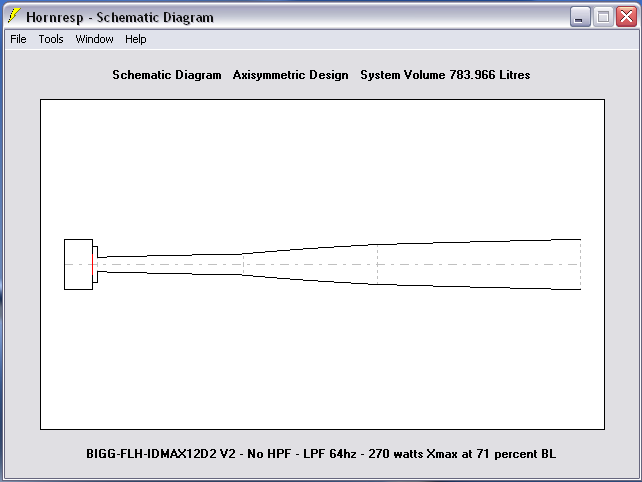

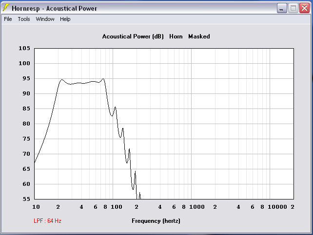

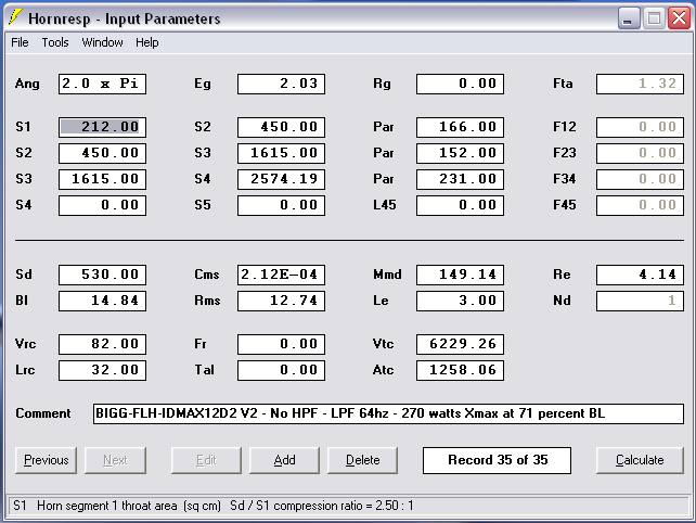

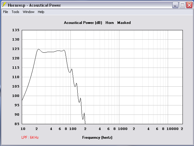

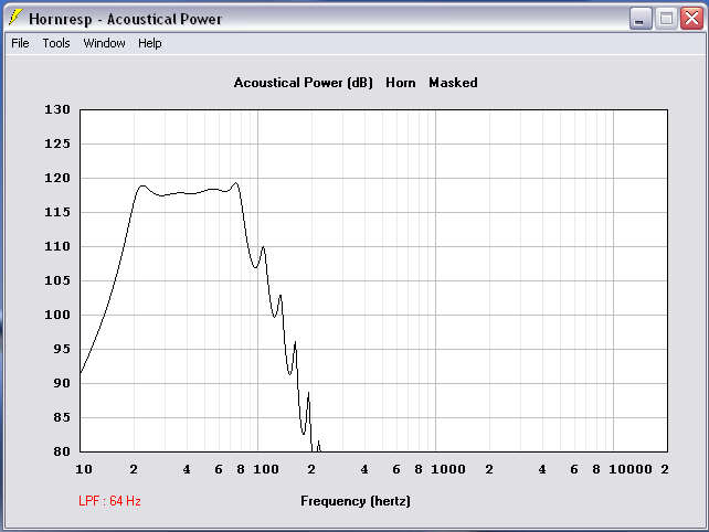

Thanks again jag, I'm looking forward to reading your comments. Do you like BIGG?
THIS:
Response at 1 watt with 64hz LPF - 2Pi:
Response at 270 watts - 2Pi:
Response at 270 watts - 1Pi:
... is a draft, er a horse... thats it, a draft horse... 😀 BIGG!
I don't think I have the throat adaptor/chamber right. It was done in my sleep several nights ago and I can't figure out how I did it. I don't want to correct it until I understand how it should be done, at the risk of screwing it up worse! I know a calculator was abused, but thats about all I can remember.
