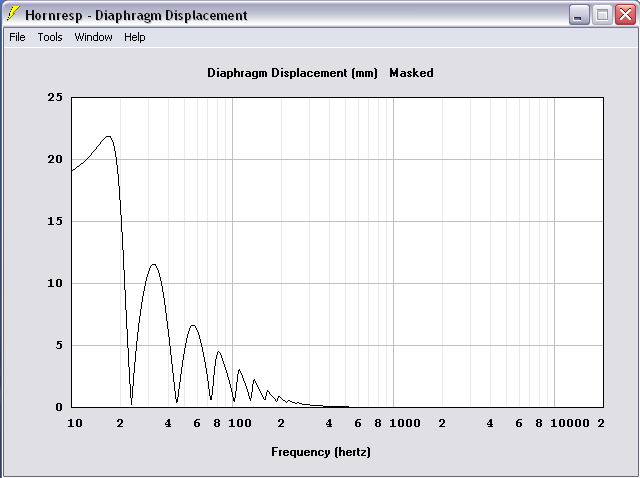

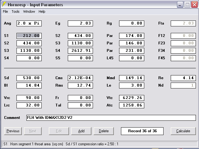

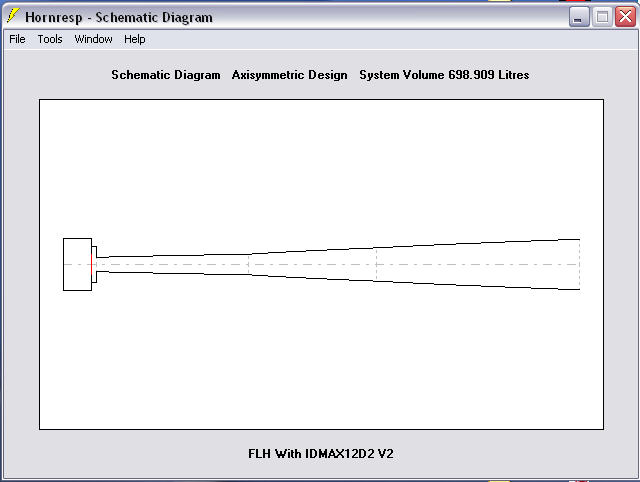

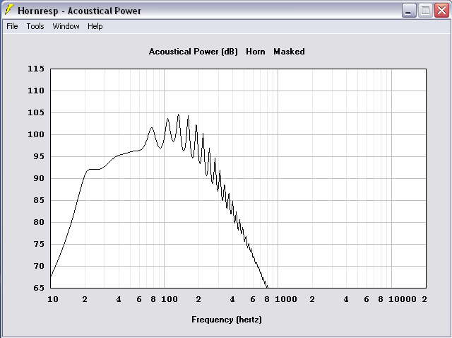

I just tried another sim with a goal to keep the horn under 700 liters. Barely made it... I don't have enough experience to know when its going to be oversize in Hornresp, so I'm lucky to have made the cut tonight.
There are errors in this sim I'm certain, cause the throat adapter isn't made right and probably other errors in there too. I'm a rookie, first saw Hornresp just over a month ago. Keep that in mind as you view the result.
Anyway, while working on this I discovered that I have been screwing up the designs previously, so I hope I've done a better job this time. Also, as I was working on this I realized that I had taken more off the bottom end than I had to... so next time I expect to have a similar looking sim but with greater low extension. I screwed it up. Maybe, just maybe the next one will be smaller as well!
No HPF was in place for Xmax, reached a bit out of band at 253 watts. As I said I think I can fix it. I expect about a 19 Hz knee at 92 db when its corrected. Maybe...
Shoot holes in it for me please!
THANKS!

One of the obvious errors I made in that sim is I made the S2-S3 segment shorter than I intended to and that screwed up the expansion for the entire horn from S2-S4. After I was done with it I realized the mistake there. Its got some crazy FTA going on in there... sorry about that.

You can't take the overlaid sims as definitive performance guidelines. GM's horn took 700 watts to reach xmax while my 3x smaller horn took 1000. As we have all be saying there will be differences in power compression that the sim can't show.
There is no completely accurate model for power compression so I don't even attempt to simulate the effects.
And power compression depends VERY heavily on the voltage level and also the type of music that you play. if you play music with very little bass, and what little bass that's there is very sporadic and dynamic then power compression isn't going to be a big issue and the sims should pretty accurately reflect what's going to happen. But if you play music that has constant bass similar to sine waves, and the frequencies of the bass line correspond to the frequencies where the driver is using the most power then there are going to be huge power compression problems and possible outright thermal failure.
This shows the actual power vs frequency that the driver is consuming when voltage is 49.84 V and power level is "600 watts". You can see that the driver is consuming VERY little power at 25 and 60 hz. But if you play a 48 hz sine wave at this power level for a few hours the driver will exhibit severe power compression and the voice coil will likely melt even though it's rated for 1000 watts RMS.
