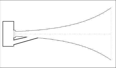

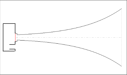

Here's a few pictures to illustrate the points I was making.
First let's look at a full size horn. This is the one that I mentioned was a stunning example of reactance annulling even though the compression ratio is too high (7:1) and the rear chamber is too small to be practical (although it is the same drivers and ~ same size chamber used in the Labhorn so it isn't THAT impractical).
This was designed by Hornresp's System Design tool, so it's an ideal full size reactance annulled horn for the drivers used in the specified bandwidth (19 - 190 hz) according to Leach's math. This horn has a flare T of 0.8 so it's a bit outside of the ideal 0.5 - 0.7 T range described in the article.
The red line in each graph is right at 19.31 hz indicating that the low knee frequency, the first impedance spike and the total diaphragm pressure minimum all occur at (or extremely close to) the same frequency.
Now let's look at the 568 liter horn that I posted early on in this thread. I changed the flare T to 0.7 to give it the best chance for success according to the article. The rear chamber is 75 liters.
Clearly the low knee frequency, the first impedance spike and the diaphragm pressure minimum do not line up at the same frequency.
The article says you should adjust rear chamber size until the low knee frequency is equal to the frequency of the first impedance spike so let's do that. Unfortunately this requires a rear chamber size of 20 liters to get them close, a reduction in chamber size of 50 liters, a full 2/3 reduction from the original chamber size.
The reason this is unfortunate is because the frequency response is now completely ******. There is a sizable 5 or 6 db increase in sensitivity right at the low knee frequency and the excursion is a lot lower and more controlled with the tiny chamber size but the wide 12 db dip right above the low knee is definitely a deal breaker.
To add insult to injury, the pressure spike at the low knee has not been reduced much (if at all) compared to the 75 liter chamber so there doesn't appear to be any advantage at all in trying to size the rear chamber for ideal reactance cancellation as per the article's empirical method of matching the low knee frequency and the first impedance spike frequency.
It does not appear that you can get any practical reactance annulling benefits from this massively undersized horn regardless of the rear chamber size, which is what I've been saying.

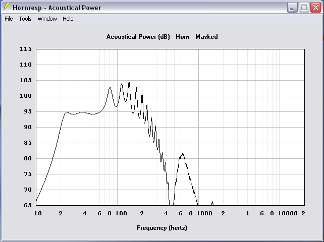

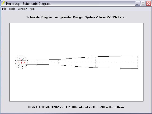

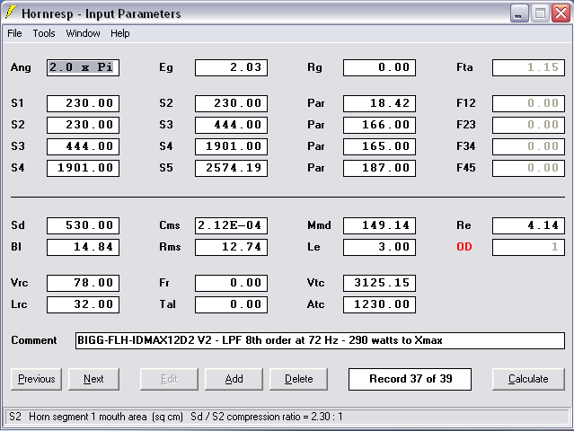

Yep weltersys. I am stubborn but once its beaten into me I come around. Was just getting ready to post this improved box when you posted. I'm slowly warming up to realities. Here 'tis, my latest, greatest BIGG. Looking forward to your comments!
My IDMAX can't handle 22 Hz, else the response becomes unstable. So, I'm rubbing up against 22 from above it as hard as I can, (just -1 db down to 22) from a stable knee at 24 Hz.
Accepting a higher knee at 24 allows a flat response, plus allows a lower compression ratio (2.3:1), plus increased sensitivity, a smaller sealed volume behind the driver, and gets all that done in a smaller cabinet. F3 is about 21 Hz.

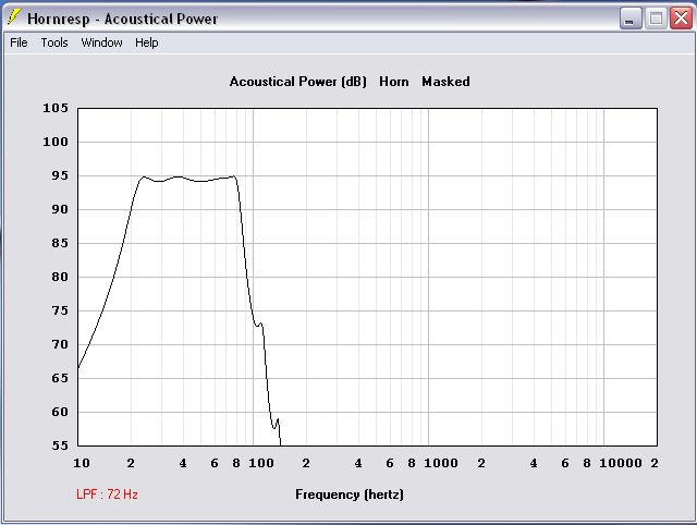

This one is ~753 liters. Its still BIGG, but its got control of the driver I think. I tried other structures on the 22 Hz issue, but none seem to get control of the driver as well as this one. I like it too, because its responsive within a wide range of tweaking. Plus, I can cheat a bit with my Minidsp 2x4 and dial in an 8th order LPF at 72 Hz and have a usable response from 22-80.
Xmax (21.9 mm at 71% BL) is reached at 290 watts using no HPF. This box does 119+ Db in 2Pi and over 125 Db in 1Pi space. There is more sensitivity available if I want to go after it... but then 22 Hz wouldn't be within the passband anymore, and will I really need more?
The last screen shot shows the response in 2Pi with 72 Hz/8th order LPF.
I hope to read your opinions of this box, good and bad. I respond most attentively while I'm being poked with a sharp stick, so have at it fellas.

Nice flat response.Xmax (21.9 mm at 71% BL) is reached at 290 watts using no HPF. This box does 119+ Db in 2Pi and over 125 Db in 1Pi space. There is more sensitivity available if I want to go after it... but then 22 Hz wouldn't be within the passband anymore, and will I really need more?
119 dB would be louder than I'd listen to in a home theater situation.
Outdoors, listening to music, I'd pick my Keystone design over the latest, greatest BIGG, it's half the size, and goes twice as loud (about +10dB), though does not go as low. But knowing how little of the music I listen to has much content below 35 Hz, that is an easy decision for me to make, but can't say what you really need more of, musical SPL, or rumble 😉.
