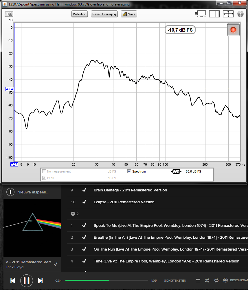

One final note. I analyzed Dark Side of the Moon, Track 1 intro because that's the only track you mentioned that you have with low bass. That's the track with the super deep bass everybody goes on about isn't it?
This first one is right near the beginning, from about 15 seconds to 30 seconds, after it's ramped up a bit in volume but still nothing but heartbeat.
This second one is about 10 seconds near the end of the intro where there's all kinds of stuff going on but before the actual music starts.
After the music starts there's not much at all below 40 hz.
I was wondering if there was something wrong with my track so I did a quick search. it appears there's nothing wrong with it, there's just no low bass.

You might want to analyze some of you low bass tracks to see what's really there. You can gain a huge amount of sensitivity if you raise the tuning and keep the box size the same.

When this thread started i actually listened to the dark side of the moon album with one eye on the REW spectrum analyzer. The heartbeats you hear in "Speak To Me" and "Time" are really the lowest parts of the album, a 25Hz knee would cover it!
I did a lot of listening with REW, and even most of the new music doesn't dig down to 30Hz, I'm personally very happy with a knee of 35Hz.
I think you'd be very pleased with a higher sensitivity -3dB 25Hz box...
Keep in mind that the lower frequency, the harder it is to hear.
