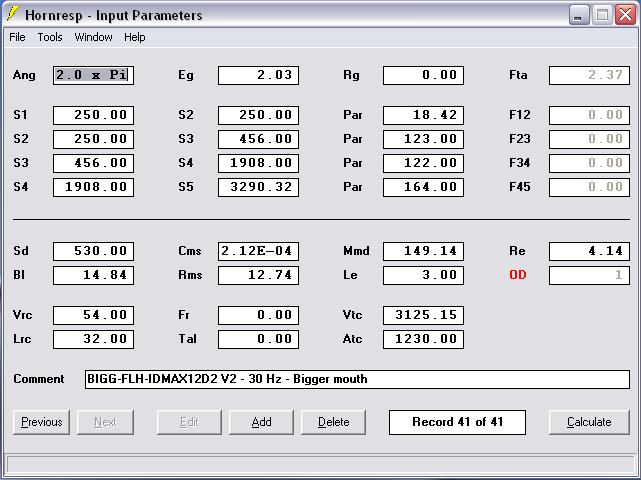

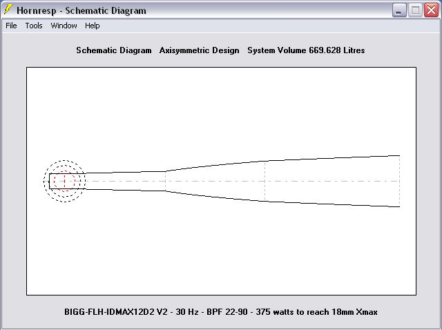

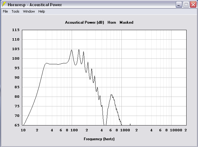

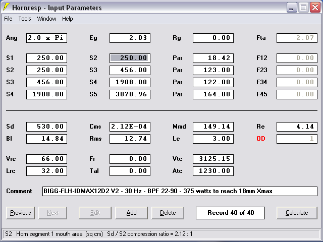

This one is 669 liters tuned to 30 Hz with 97 Db sensitivity @ 1 watt. I wasn't fussy about a super flat response but it was flattening out right away so I took it. I'll sim a bigger one when I get time and decide if another decibel sensitivity is worth the sawdust.
Compression ratio is 2.12:1 and I tightened up the sealed volume some more behind the driver. I am using 18mm for Xmax in all sims now rather than the 24.9mm claim from the company or the 21.9mm claim from the DUMAX.

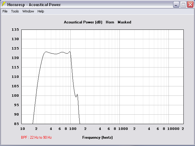

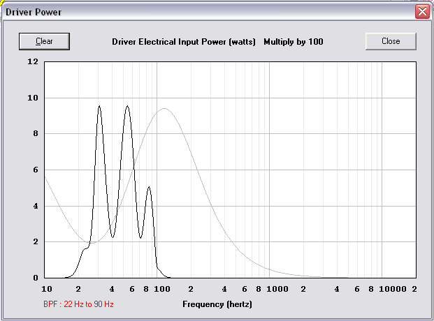

I am simming this one with an 8th order bandpass filter from 22 Hz to 90 Hz. With the filters active it takes about 375 watts to hit the 18 mm excursion limit (123 Db, 2Pi). The last screen shot shows this.

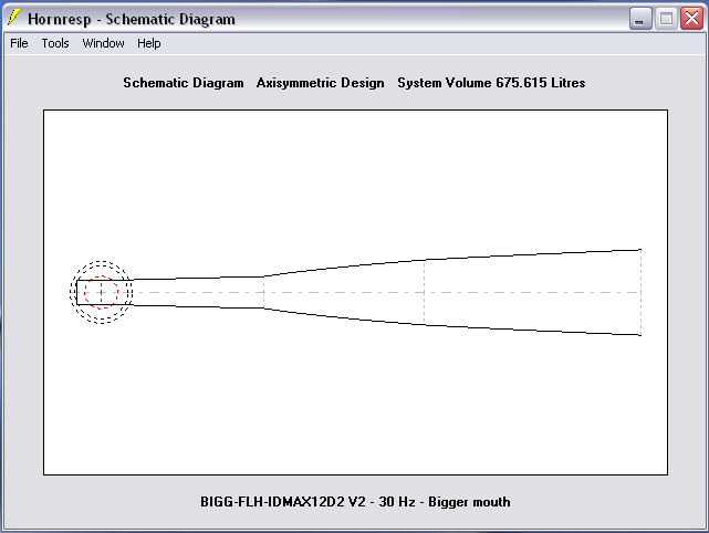

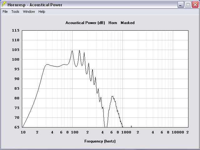

Just for fun I tried the same sim with a bigger mouth (17" x 30") and tightened up the rear chamber some more (to 1.9 cu ft) and well... it flatlined some more, stays above 97 Db all across the band. My copy of Hornresp don't seem to make ripples very well! 😀

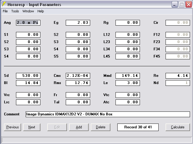

Anyway, here's some pictures to outline the issue as it's easier to see that way and I did them anyway so i might as well show them.
First is OP's driver in IB (IB vs free air with no baffle gives virtually the same impedance and driver power so I chose to show IB instead of free air) vs a small 75 liter sealed box with qtc = .62. Both shown with the same input voltage.
Driver fs is 27.67. The AES test signal would be bandwidth limited from 27.67 hz to 55.34 hz. At fs the IB is drawing about 100 watts less than the small sealed box but at one octave above fs the IB is drawing about 200 watts more.
On average it seems the IB and the .62 qtc draw similar amounts of power when averaged across the octave from fs to 2x fs, they just draw different amounts at different frequencies.

So it would appear that I as wrong about AES bandwidth limited signal being 1/2 as intense as a sine wave (RMS). But the difference between measuring consumed power in free air (or IB) vs in any given enclosure would seem to be entirely dependent on the enclosure type and tuning frequency and test signal freqeuncy. The free air driver could end up consuming a lot more than an enclosed driver, or it could end up quite similar on average as shown in the first example. And if tested at only a single frequency it could end up being exactly the same amount of power consumed by both or a difference of several times more for one vs the other depending on the test signal frequency.
Let me know if there's any problems with this analysis.

JAG,At fs they are both consuming the approximately the same amount of power but at all frequencies between fs and 2x fs the small horn is drawing a lot more power.
No problems that I see, but when comparing a free-air driver to one in a bass reflex tuned to Fs, the impedance disparity can be large, more than double the impedance average over the pass band for the free-air driver, which would require down grading the AES rating by 3 dB.
