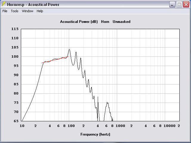

I'm trying to get a handle on optimum response shape for outdoor use. While on this subject I'd like to get a handle on an optimum indoor response as well, particularly the differences in each.
Is this the sort of rising response shape something a person may use for an outdoor sub? If not, how should it be improved for outdoor use? Would it need EQ to flatten it oudoors? Would it be more suitable indoors?
attachment.php

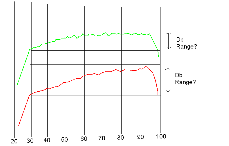

Next is a drawing showing two types of responses:
attachment.php
Note that the green response rises gently until about 45-50 hz then flattens out. The red response continues to rise all the way to the highest frequency. Are either responses useful indoors or outdoors and if so, why?
I assume that the green response may work best in a room with the lower frequencies getting a lift and levelling out the response overall... while the higher frequencies would be less affected by a room. Is that generally a correct assumption?

Outside in the middle of a field there is no room gain, no room modes, no reflections of any kind. So if the subwoofer has a flat response you will measure a flat response in that environment.
In a room things get a lot more tricky. There are reflections everywhere, very strong room modes causing massive peaks and dips in response and below the Shroeder frequency (below the modal region) if the room is stiffly constructed and well sealed you will have room gain. You could have up to 12 db/oct room gain starting at the Shroeder frequency as frequency decreases in a sealed concrete bunker, it's usually a lot less though.
How to estimate any room's gain profile? Impossible. You can make assumptions but it will be pretty useless in practical terms, once you measure any given room it's just a huge mess.
You can use a simple sealed subwoofer with known anechoic or 2 pi response curve to actually measure a room's gain profile, but it will measure differently at different points in the room.
Ideally for a built in subwoofer that won't ever move and for a given listening position that won't ever move, you can measure the room and make the subwoofer's frequency response the inverse of the room gain curve so that they sum to flat. But if it's a sub that isn't built in and will be used in multiple locations all you can do is design for a happy medium.
Take a look at this data-bass article on room gain. See the massive room mode spikes and dips and the room gain? It's all there but it's all but impossible to predict. You have to measure it.
Data-Bass
So for outside use if the sub has a flat response it will measure flat when measured outside. But in room all bets are off, the response is wild and unpredictable and response will change between different rooms and even in different spots in the same room.
That pic from the data-bass article says a lot. The black trace is an outside measurement of a sealed sub. The other trace is the in room measurement of the same sub taken at the listening position. The DIFFERENCE between the two traces is the measured room gain profile. There's 30 db of gain at 4 hz and 0 db of gain at 20 hz and wild fluctuations everywhere. At a lot of frequencies it's a negative gain.
And it's a mess. Not at all what you might expect from simplifications like assumptions of 12 db/oct room gain below the modal region and room modes predicted based on room dimensions. It's just a huge mess and there's no way to predict it.
And it will measure different in the same room if you move the sub OR the mic location or both. And it will measure completely different in different rooms.
I have a friend with an old Klipschorn. In his basement the sub sounds good, but upstairs in a room its junk. He has to run a fill-in sub upstairs just to hear the entire frequency range. Its a mess as you said it could be.
So, for the outdoors if I build a sub for flat response, it should play flat. Indoors a gently rising response on the low end may be optimal (dependent) on the gain the room provides. Indoors its a crap-shoot what you get.
