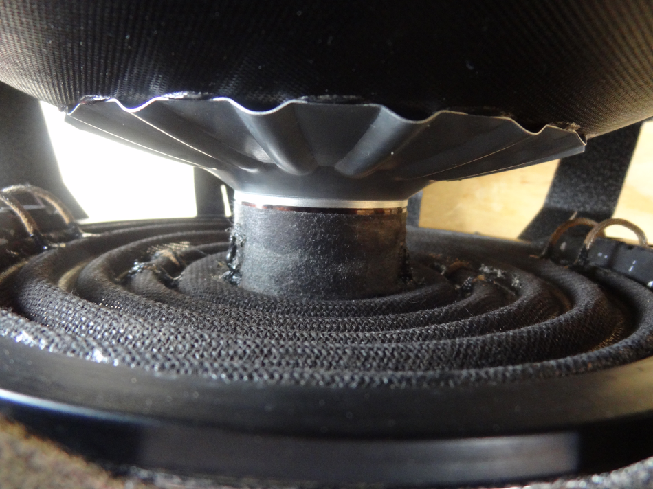

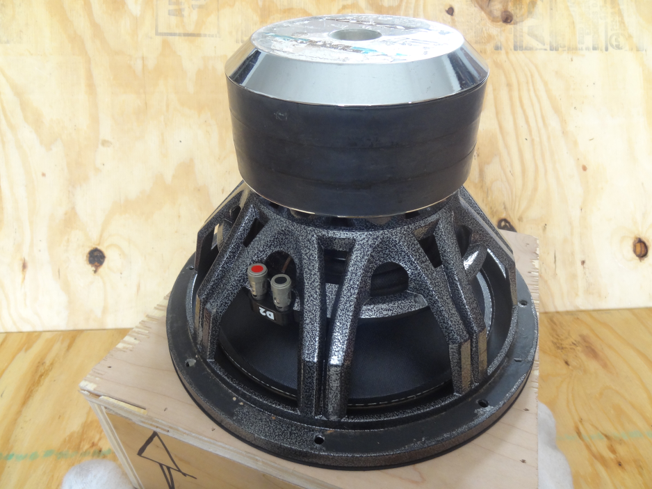

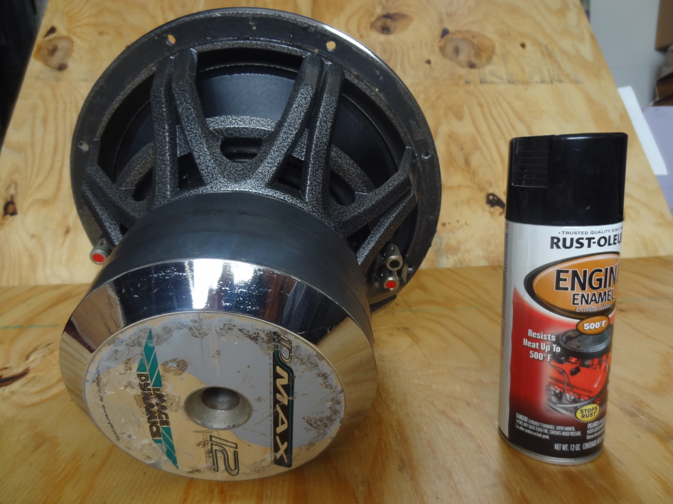

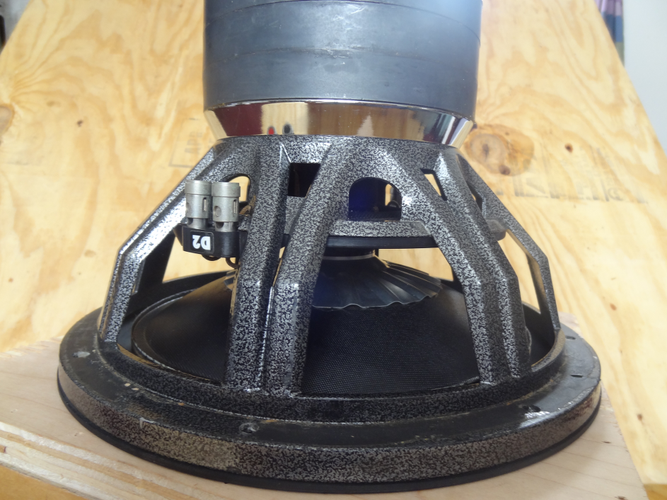

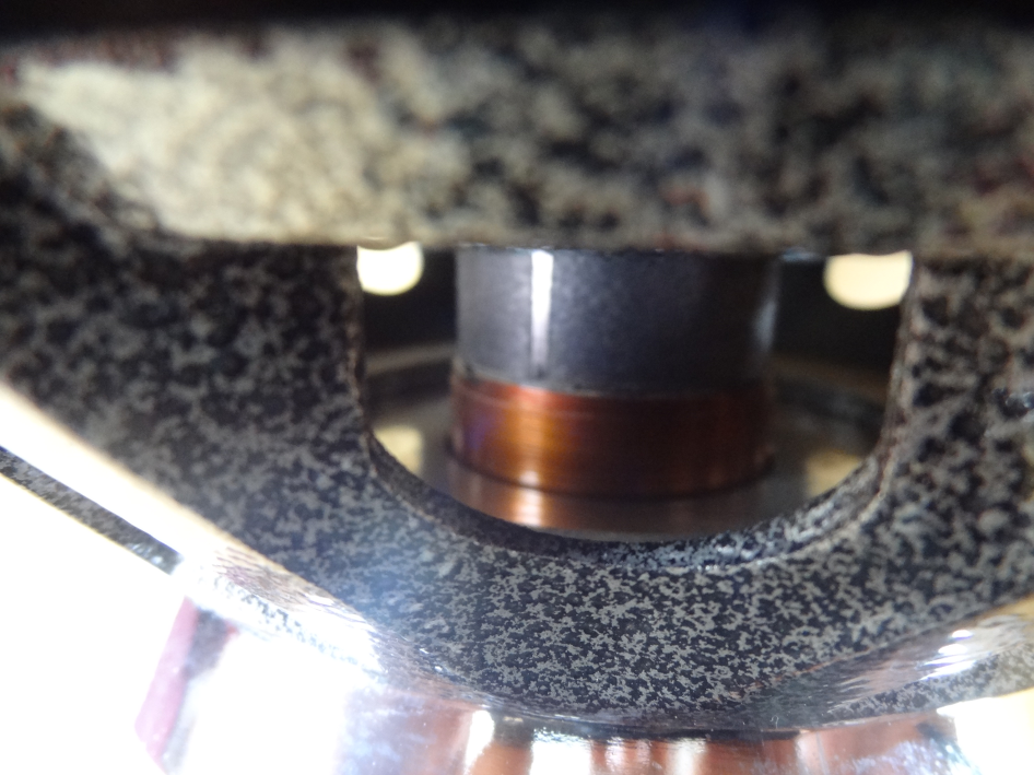

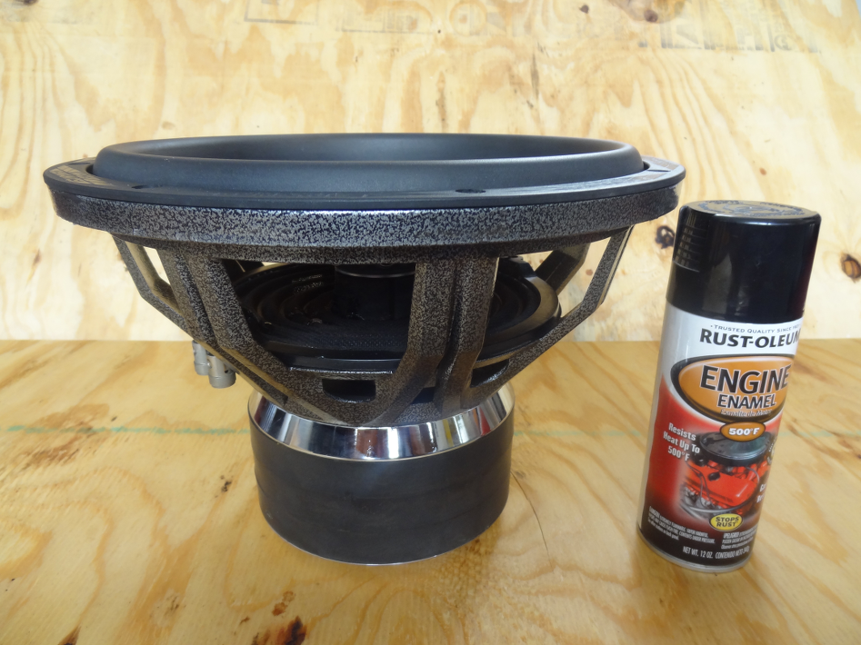

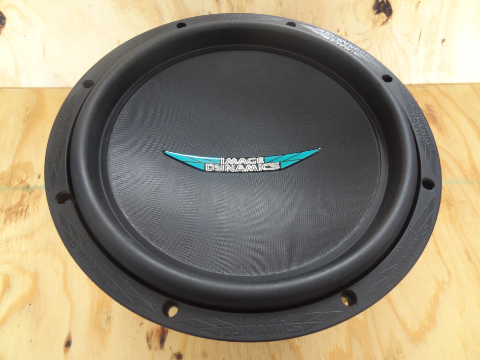

Some driver pics I just took. Not relevant to this build but I can, so I am. 😀
attachment.php
attachment.php
attachment.php
attachment.php
attachment.php
attachment.php
attachment.php
Old skool... Thats my storage box in a couple of those pics with cutout for the driver in the top, the lid isn't shown. Thats a 2 inch VC, nowadays they are bigger. Magnet stack is 3" high x 6.5" diameter. Cast aluminum basket. Thin, high roll rubber surround. Woven fiber (unknown material, I forgot) one-piece cone, less than 150 grams and stiff as a brick. Weight is over 24 lbs on my cheap bathroom scale.

This Large Coil issue was pretty fun to study, it took a couple of weeks of very long days and my dog spilled a cup of coffee on my laptop so the keyboard was not working. I did the entire study, including all the sims, calculations and writing the paper by clicking the mouse using the on screen keyboard located in the MS accessibility menu. THAT was super fun. I didn't even think to use a usb keyboard at the time as I was actively trying to fix the laptop as I was doing the study and I thought I could fix it. It's still broken but I do have a usb keyboard now.
Yes, I will pretty much guarantee your driver is one that is affected by the Large Coil issue. You don't get that much stroke without consequences. It might not be that bad, but without having a published Le spec you can't even estimate how bad it might be.
The worst driver in that study was one of the Fi drivers with normalized inductance (Le/Re) of more than 3. That's ridiculously high inductance and it didn't sim accurately at all. My adjustment method fixed the sims right up though, for all the 22 drivers that were studied. The generic adjustment isn't perfect but it's a lot better than ignoring the issue, and the curve fit method (that you will be doing) gives the best results possible that I am aware of.
Well, hopefully mine won't beat the FI then... Le/Re ratio >3, yikes! Good thing I didn't wager a new UMIK-1 on my prediction huh...
