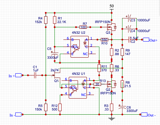

Built a circuit in Ltspice using your schematic and after changing a few values come up with Nelson's distortion and CLG values and frequency reponse almost exactly.You mention no R6,I left the circuit as you have it plus I added a gate stopper on the lower mosfet.Why do you say no R6?

Could you please explain how you did the OLG,I have a circuit here and have no clue how to do this measurement in LTspice.I have looked online and they insert a 0 volt source in the FB loop,i'm just not sure where it should go in the circuit I have (essentially the same one posted on this thread.)

I about to present the circuit equations for the F8 and show how to derive resistor values if the parameters of the various FETs are known.
Interestingly, I found some values which give similar (simulation) results to the published F8 specs with 8R load but are much better at 4R.
I noodled on how to approach calculating the jumble of physics that balanced bias level and cancellation and transfer and . . ... I gave up 😕.
I know EUVL said in the J2 thread that if he added current sources in the input stage it would lower the distortion below production J2 levels, but that was not really the point of the excercise.
I cheated anyway . . . I'm sure not a novel solution, but satisfyingly novel to me. And the schematic now has sexier symmetry and dreamy (simulated) numbers at 1 watt while keeping dissipation at about 35W per mosfet.
It deviates a bunch from the F8 simplified schematic. If I find it sounds great and if anyone is interested I will open its own thread and stop polluting here.

Hi Oreo382,
Open this comment again
https://www.diyaudio.com/forums/pass-labs/358672-watt-f8-9.html#post6374021
Open the picture, you see in the upper line
V(out) divided by the difference of the ( V( at the node of J-Fet(s) input gates - V( at the node oft the J-Fet source point, where the feedback resistor ends)
This gives the OLG.
This can be done in a real circuit too, with high V(out) let us say 10V AC 1kHz and a DMM with very high input impedance.

Thank you! for your help.One point,when I measure my circuit I get about 15db? My CLG measures about 14db.Does this sound right?I see your OLG measurement was up to 75db,mine is ruler flat 15db.I took my measurements at the same points as you said.
