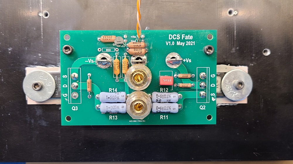

First Watt F8
Finished PCB on heatsink.
Patrick
Thanks for postulating a DC variant and sharing it Patrick!!! :cheers:
A simple IRFP240 version will work but the IRFP150 is even better (than the IRFP240).
Something in the back of my mind keeps asking me why would Papa go single rail and coupling caps for the F8 when it is a small change from the J2 to this? Did he leave the door open on purpose or are there undiscovered mysteries and a trail of clues left behind still?
would it be possible to do a DC version "a la UDNESS" using a N Jfet (2sk209) and P mosfets at output FQA9P25?
As a first step in Spice, I've been trying for a few days to simulate a version with readily available components from the work of Patrick. However, that is far from finished, maybe someone here would like and above all know more to develop this further?
