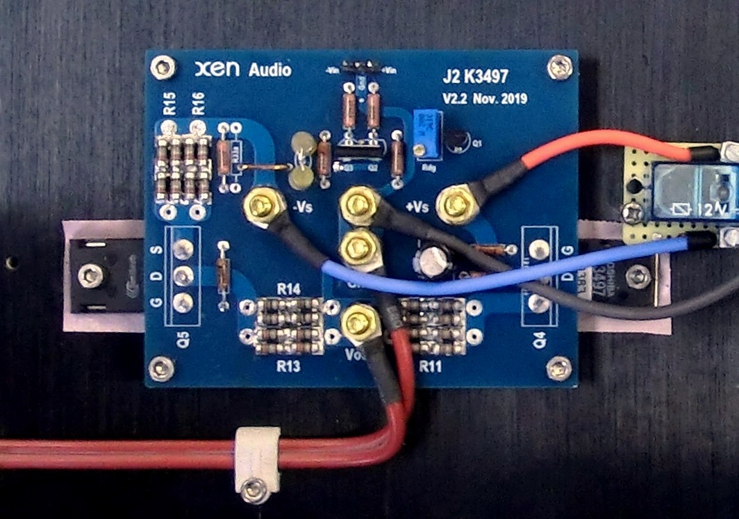

Finished PCB on heatsink.
Patrick

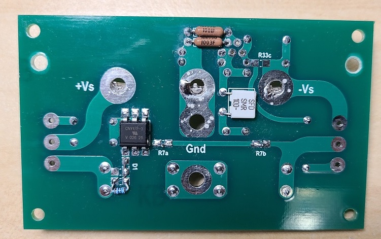

Nice PCB layout, but where are the R1 and R2 input resistors and the optocoupler? Are they on the backside of the PCB?

The circuit is published, so are the photos of both sides.

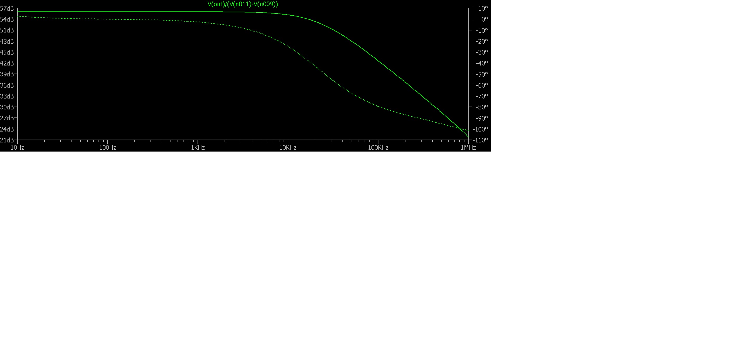

Just for fun, I published a couple of simulations files :
First Watt website update
If you are skilled with LTSpice, you will have no problem opening the asc files and play with the circuit.
Then someone else was brave enough to put the simulation into hardware, successfully.
But that he did with his own skills and understanding of the circuit.
And of course anyone is free to do the same.
