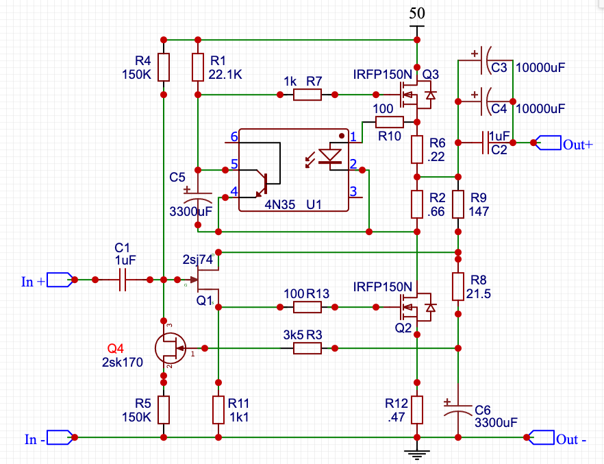

My equations are not matching the simulations and neither achieve the THD levels without open-loop-gain about 12dB-20dB above what has been suggested for the F8. generg has similar results
Should there be a source resistor on the semisouth Jfet? that would reduce the open loop gain.
This is done in the J2, in this way the OLG is around 50dB. But the nice new thing is that Nelson eliminates the source resistor for the Semisouth in the F8 and seems to compensate this with less gain in the F8 frontend.
I estimate in Spice that the source resistor at the Semisouth in J2 reduces the OLG about 6dB.
Ok generg, I removed the source resistor and biased the front end to lower the gain. The open loop gain is 5db less than what you said was the j2. Distortion is .02. I could still try and lower the front end gain more and change the optocoupler bias resisters to improve distortion.
Thinking R11 should maybe be smaller, maybe around 1k.
I think understanding and solving this is the critical problem.
I think I get why 2.6k at R11 sounds clearly better. Please correct me if I'm off here. R8 and R11+jfet create the divider for feedback. When the jfet is most resistive, more signal is sent to ground. When its least resistive, more feedback is applied and you have distortion because of variations in gain. The higher the signal voltage, the higher the ratio which explains steadily climbing distortion as you go up in power. Setting R11 to 2.6 minimizes the percentage of resistance the jfet contributes. Going higher, the jfet starts running out of juice.
My thinking was I can send a portion of the discarded feedback signal somewhere as feedback ??? which also varies with the amplituted? (way out of my element as to what to call it. Maybe resistive modulation?). Simple change. I think this schematic fixes that specific issue. For the first time I am able to split the output resistors to the ratio like the ones on the ACP+. If you're liberal with your definition of V with a circle around it, it matches the simplified schematic too.
The shape and value of the simulated distortion at 1k matches the F8 manual well. R3 has a great deal of impact on the phase of distortion. 7.5k is a much better value there than 3k5 I think.

Built a circuit in Ltspice using your schematic and after changing a few values come up with Nelson's distortion and CLG values and frequency reponse almost exactly.You mention no R6,I left the circuit as you have it plus I added a gate stopper on the lower mosfet.Why do you say no R6?

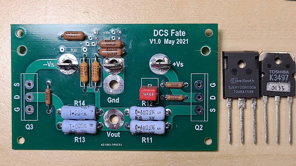

August last year, I posted a spice file of a DC coupled "F8".
First Watt website update
First Watt F8
As said before, it is purely my speculation and bears no relations to the original.
I don't have a F8. I have not seen one. I have no idea of the original component values.
But a brave guy went ahead to build one according to the above schematics.
To quote him :

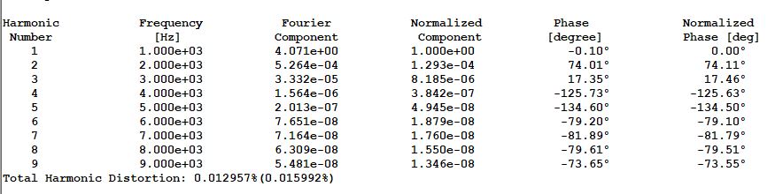

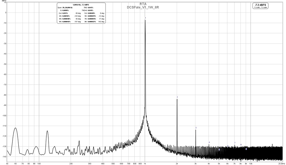

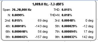

"I have built up Patrick's board and no surprises but it is quite close to the sim.
I just used standard values and let it come up to temperature.
Bias started at 1.40A and didn't change much as temperatures stabilized.
THD matches the sim even down to the phase angle (relatively close).
I used 0.68/0.68 and 1.0/1.5 values for the 3W positions.
THD is 0.015% and is pretty much all H2 (negative phase).
H3 is almost 30dB down from H2.
Heatsink temperature stable at 47C (about the same size as diyA store 4U/300mm).
DC offset started at 15mV and stable at 20mV after fully warmed up."
And we called in DCSFate.
Patrick
